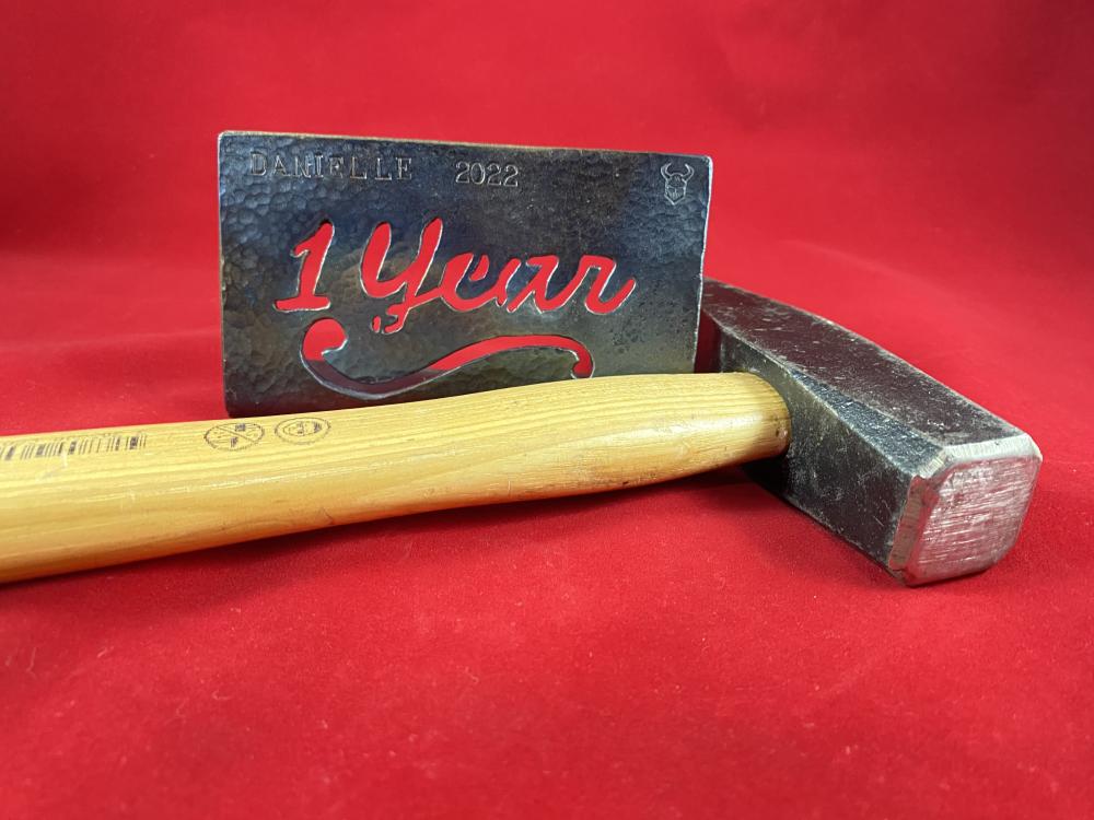

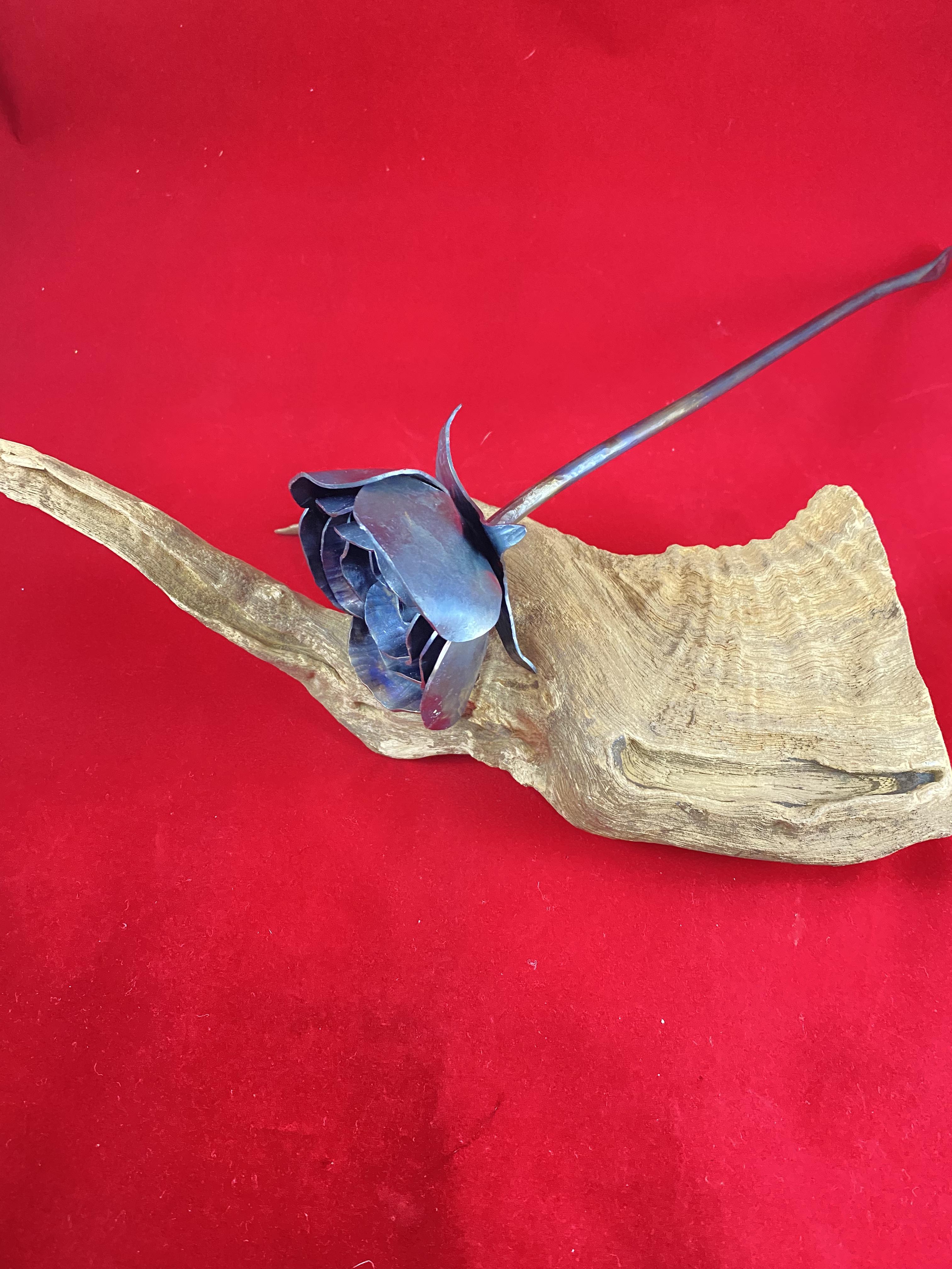

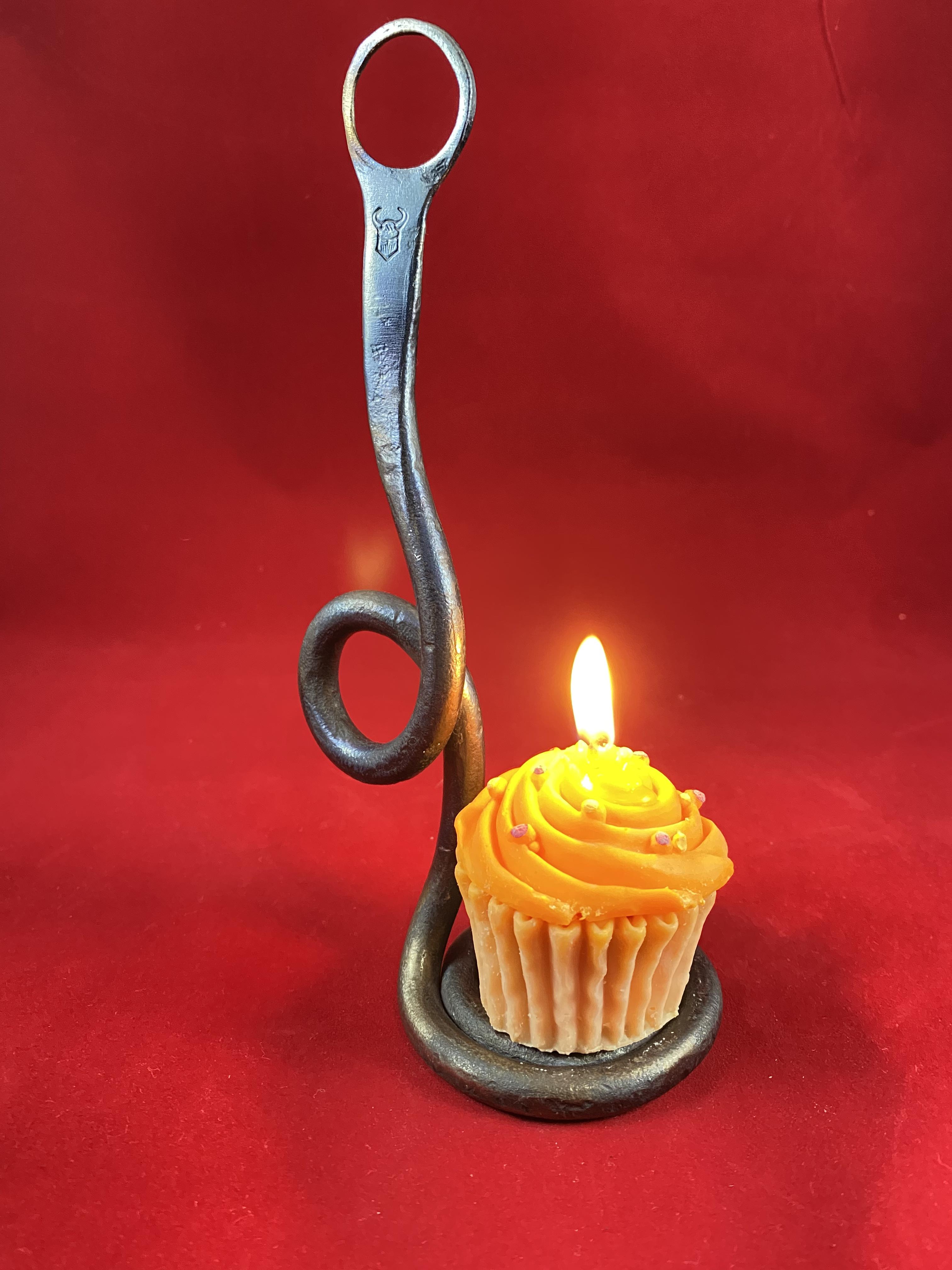

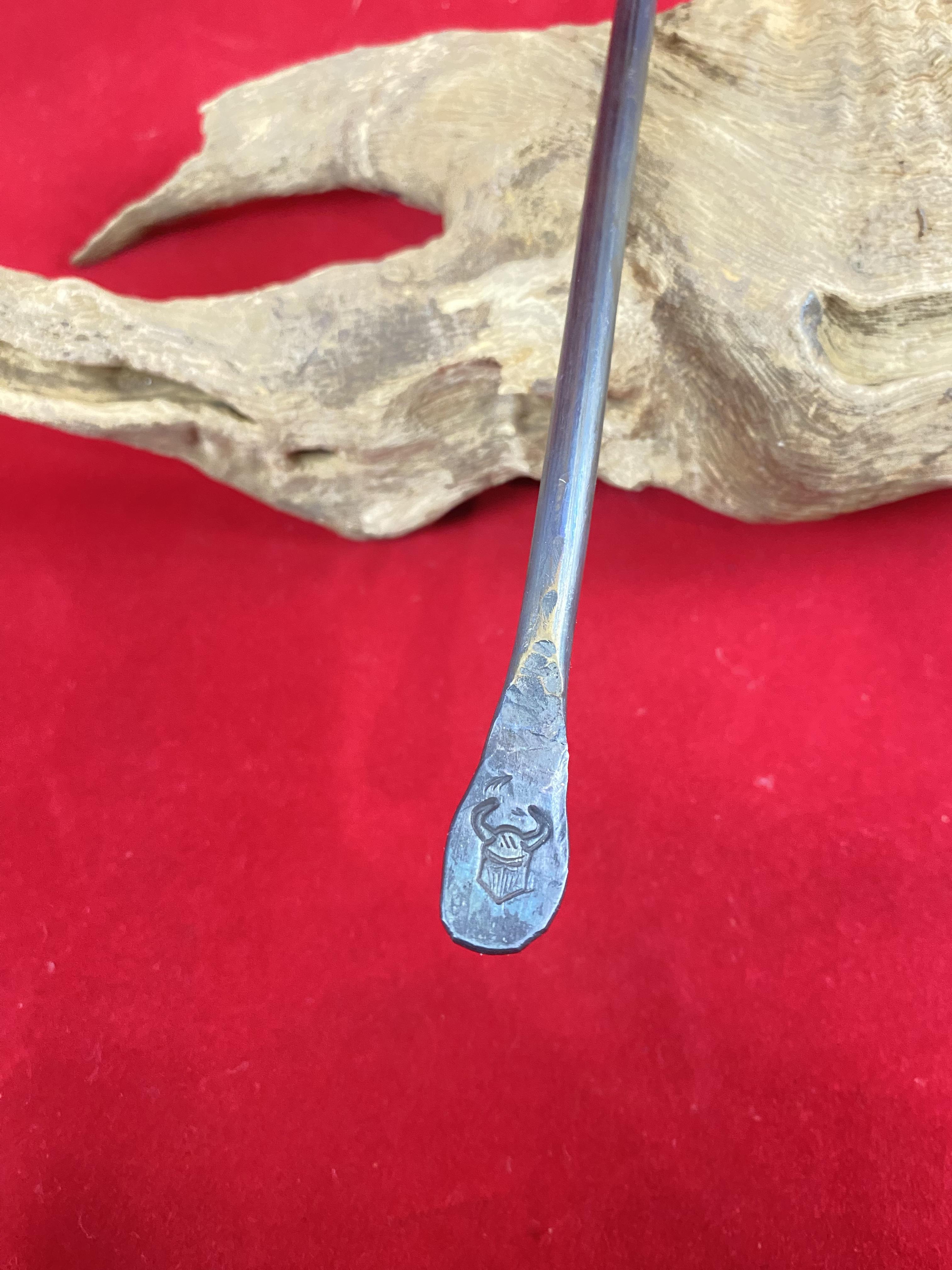

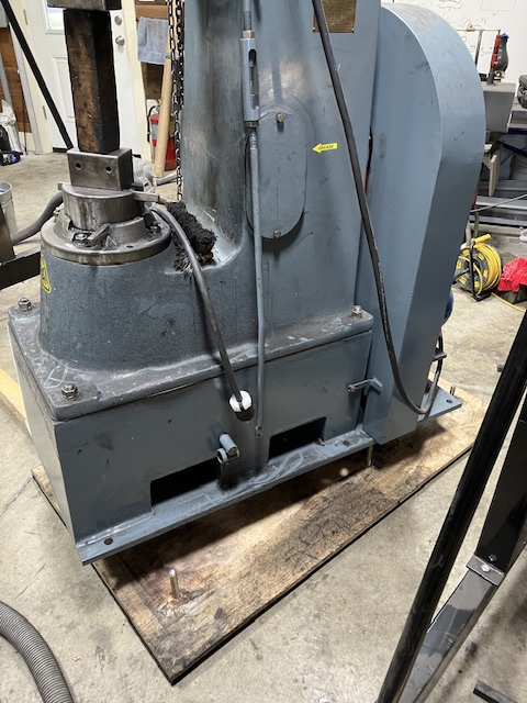

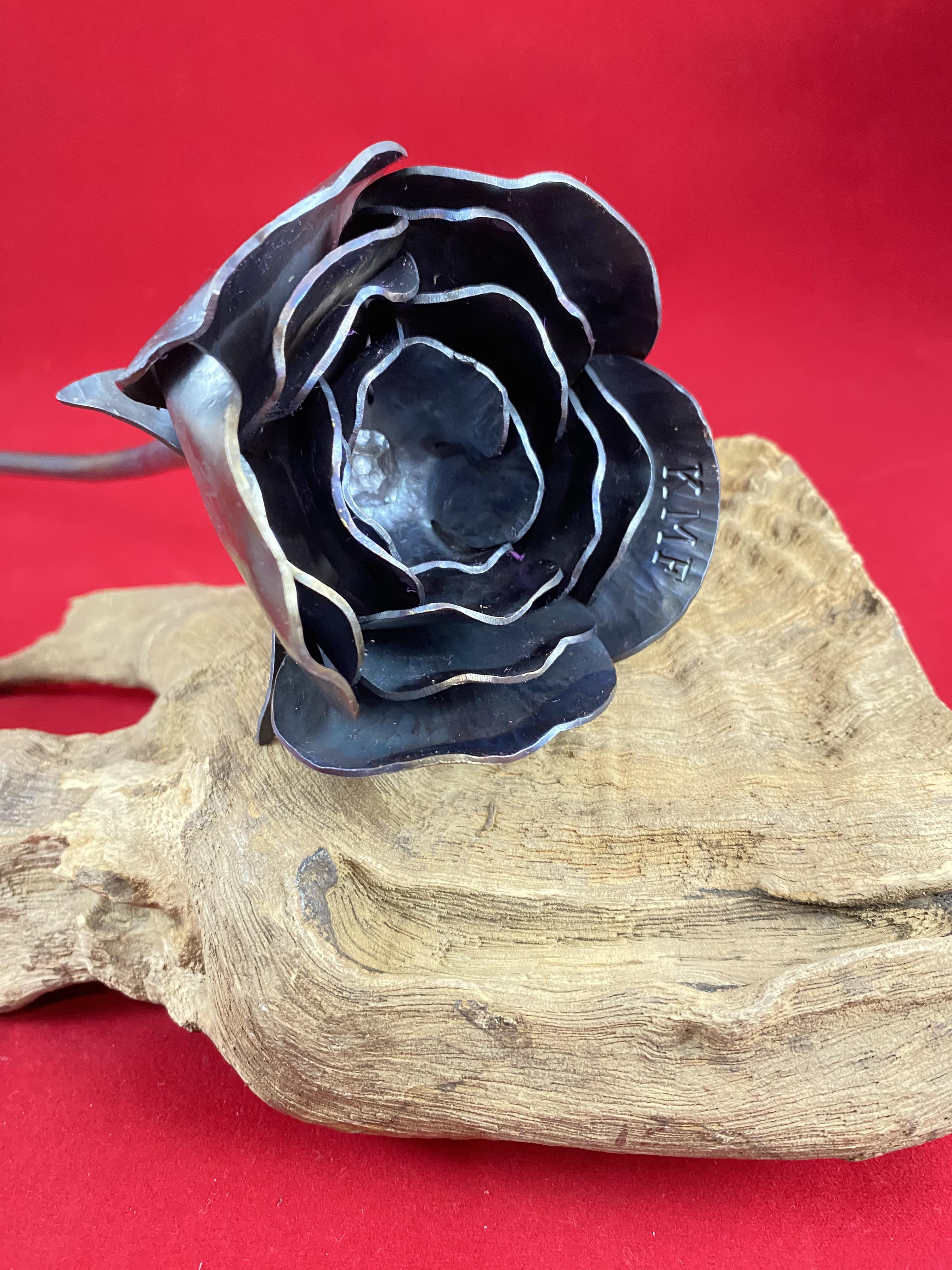

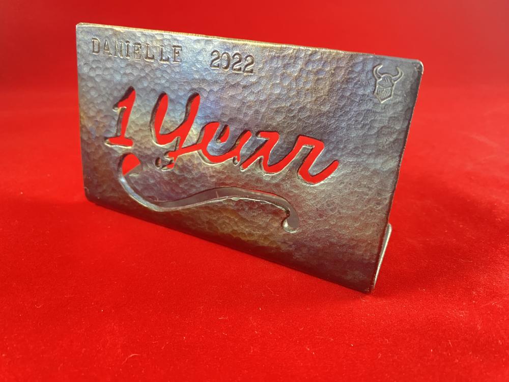

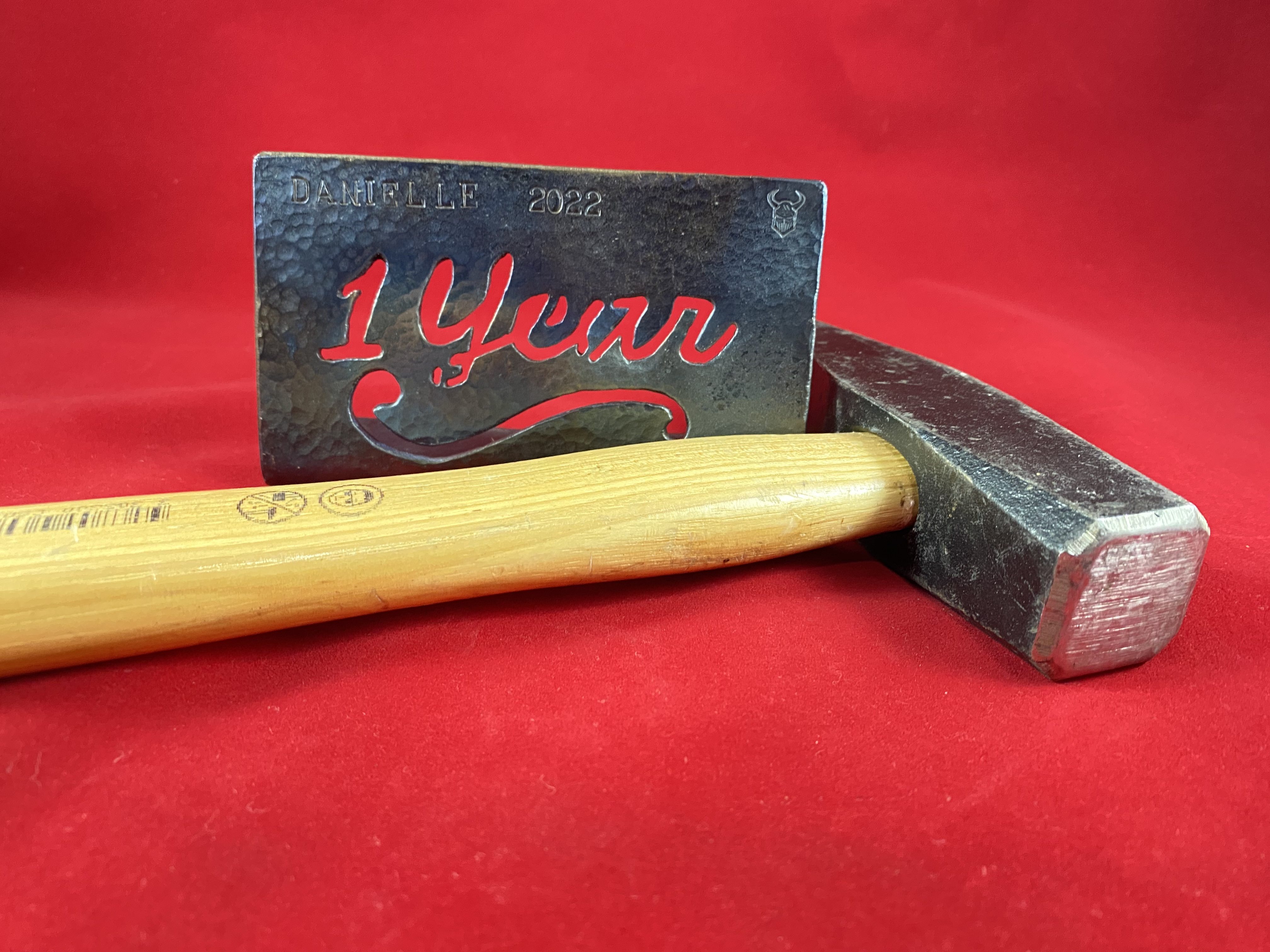

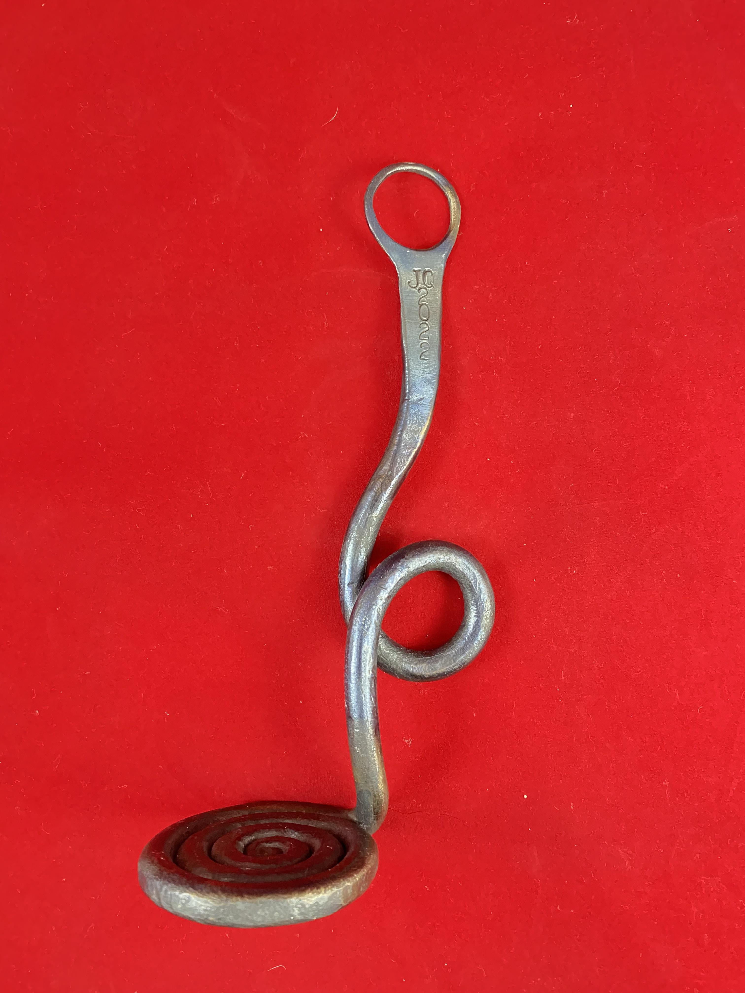

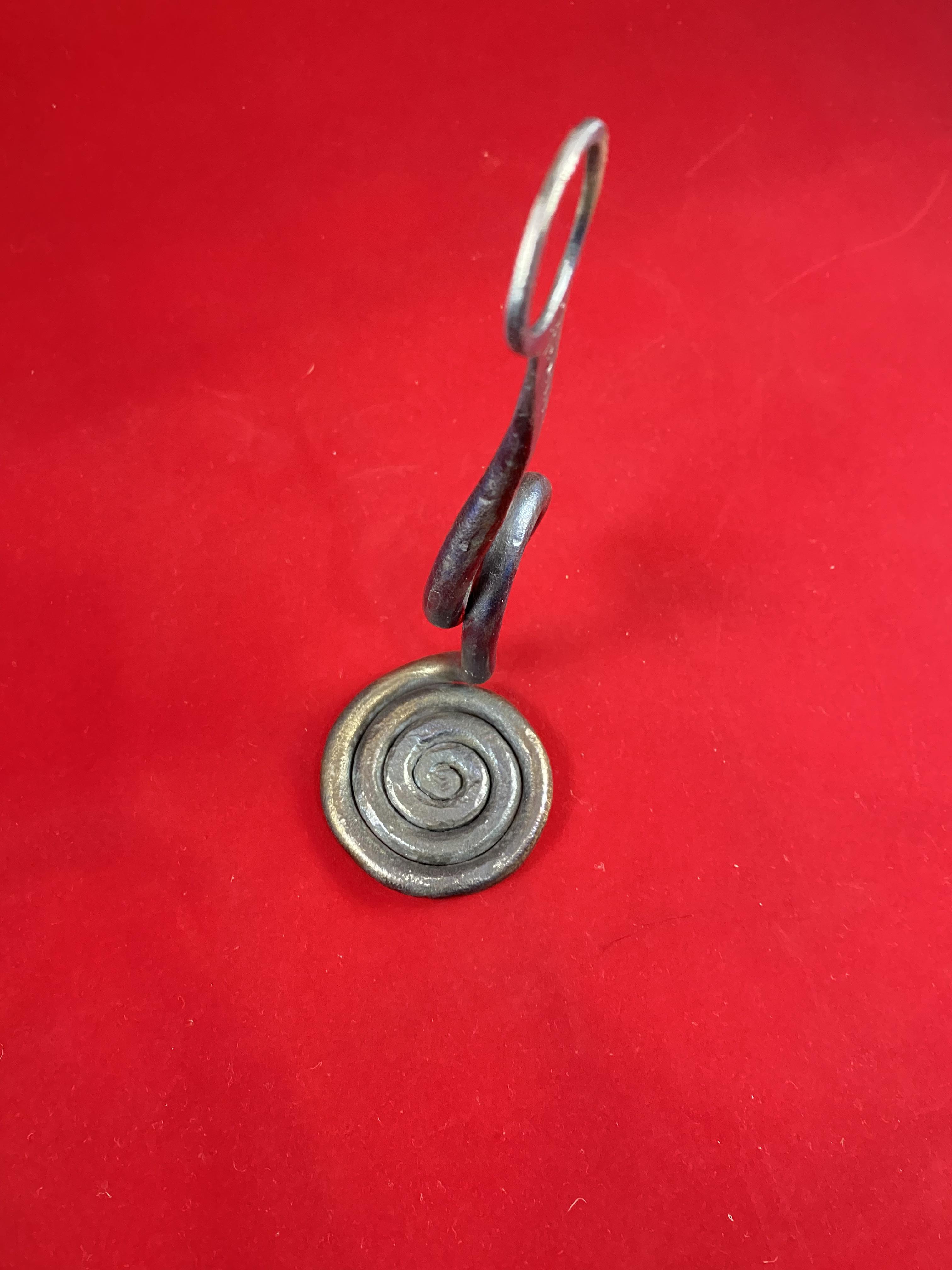

Pat Masterson Posted December 14, 2022 Share Posted December 14, 2022 Wishing you good health and happiness Thomas - hang in there. Goods, that hammer is a beauty. Definitely a dream of mine to have one someday. Also got another little gas Forge off Amazon. It was so cheap I couldn’t resist and it has a larger working area than my current one. I coated the kaowool with Greenpatch 421 though - really good option if anyone needs to insulate a new or repair a damaged forge lining. Once I wet down the kaowool a little it spread on very easy. It comes premixed which is nice. I wanted to use most of it to line the new forge but my old one needed a little love so I just put a thin layer over the old refractory and man does this stuff help retain the heat. Some of my latest stuff below. Really happy with the one year plaque - I love the way temper colors come out on plate steel. They always seem to be more colorful than bar stock. Maybe just bc it’s more surface area. Quote Link to comment Share on other sites More sharing options...

Daswulf Posted December 14, 2022 Share Posted December 14, 2022 Pat nice work. I like the cupcake holder. When I make the spiral holders I like to start with a point and angle it 90° then start the spiral so when you are done you have a little spike to keep the cupcake from sliding off. Quote Link to comment Share on other sites More sharing options...
Les L Posted December 14, 2022 Share Posted December 14, 2022 Pat, good work. Your rose is looking good Quote Link to comment Share on other sites More sharing options...
ThomasPowers Posted December 14, 2022 Share Posted December 14, 2022 I have a flat plate with an angle iron welded across the bottom. Drill hole right next to the dependent leg. Place in post vise. Spike goes down hole and gets trapped by angle iron/vise jaw. Wrap spiral on top then heat and "expand". Quote Link to comment Share on other sites More sharing options...

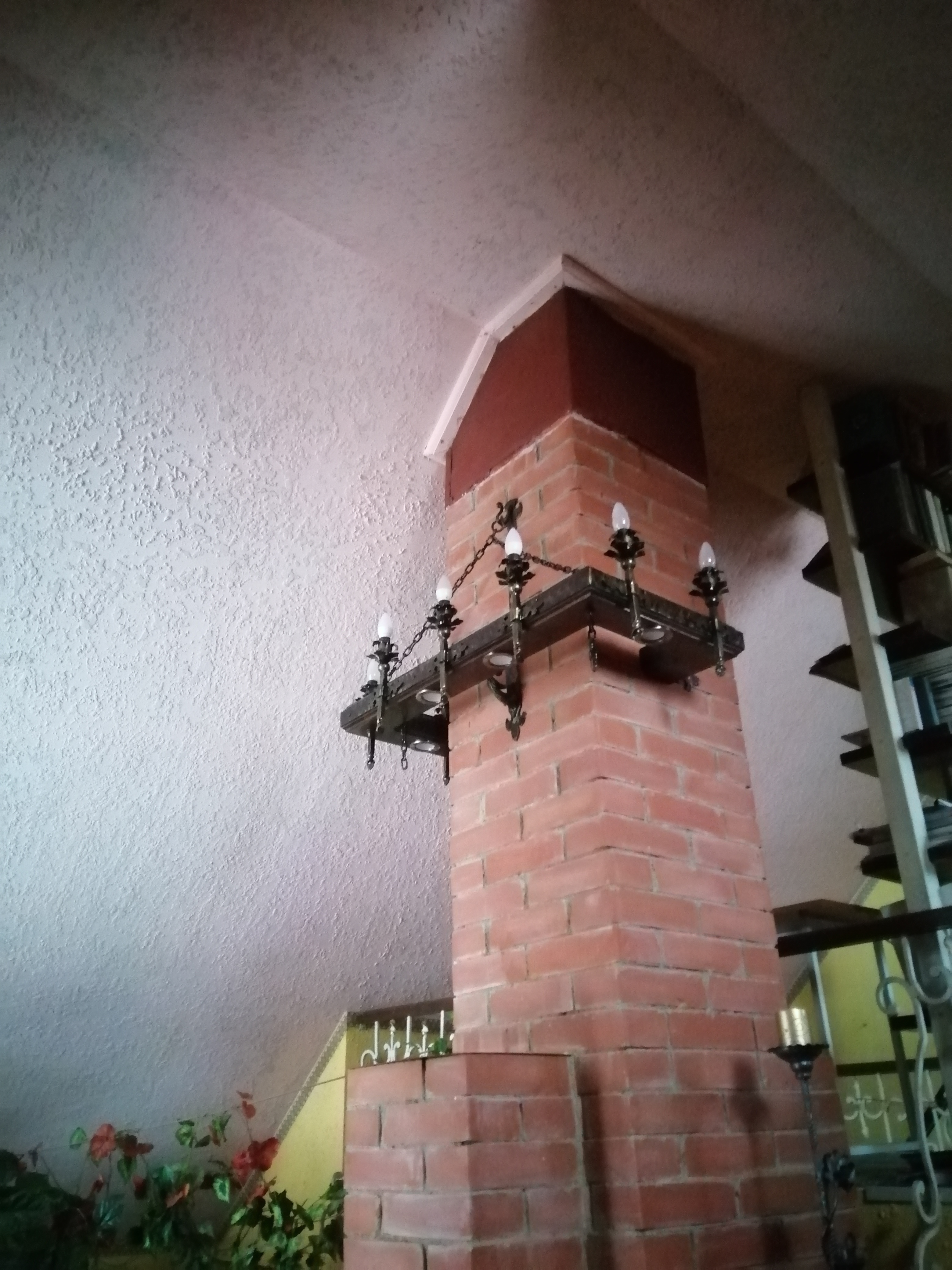

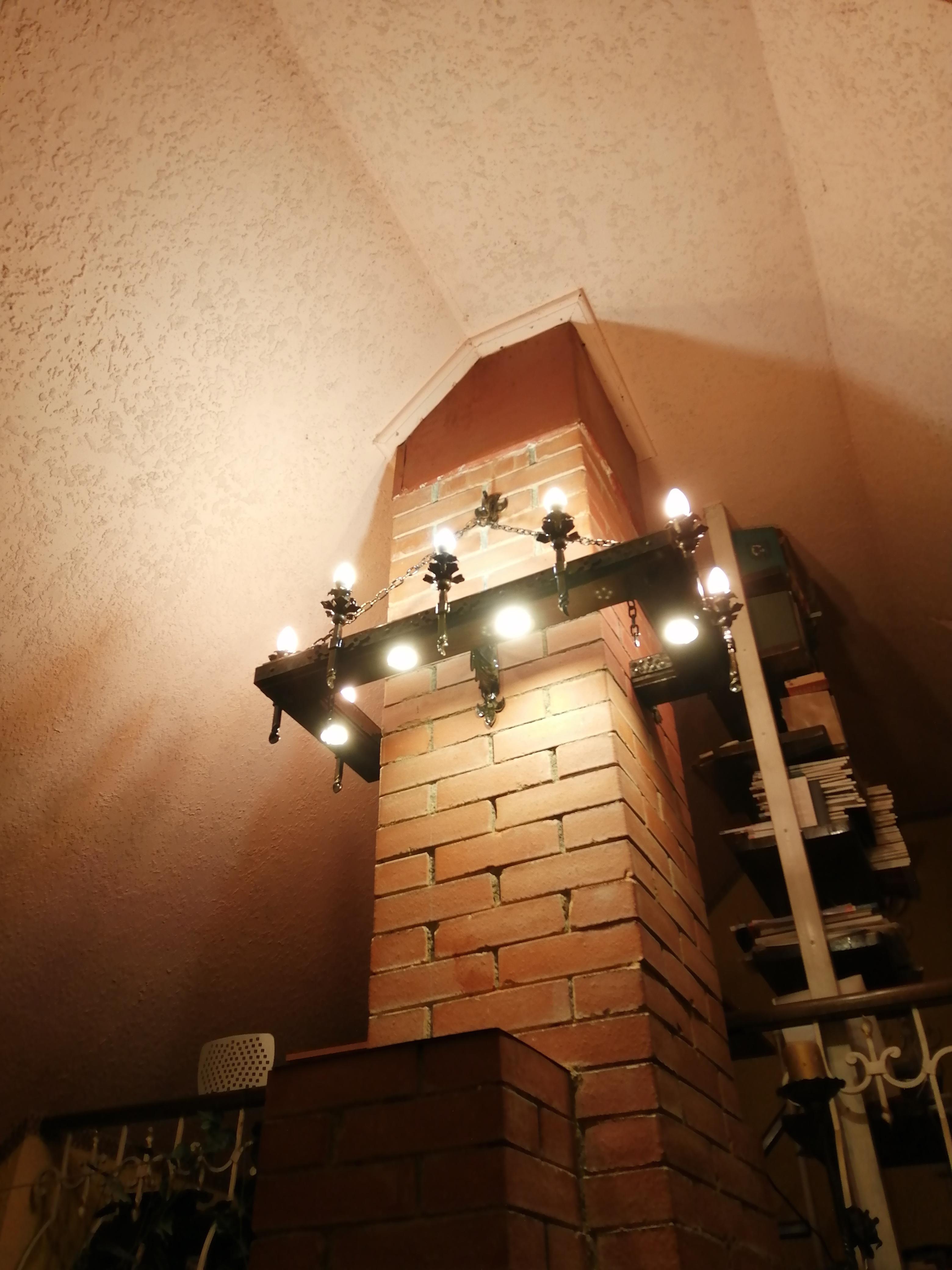

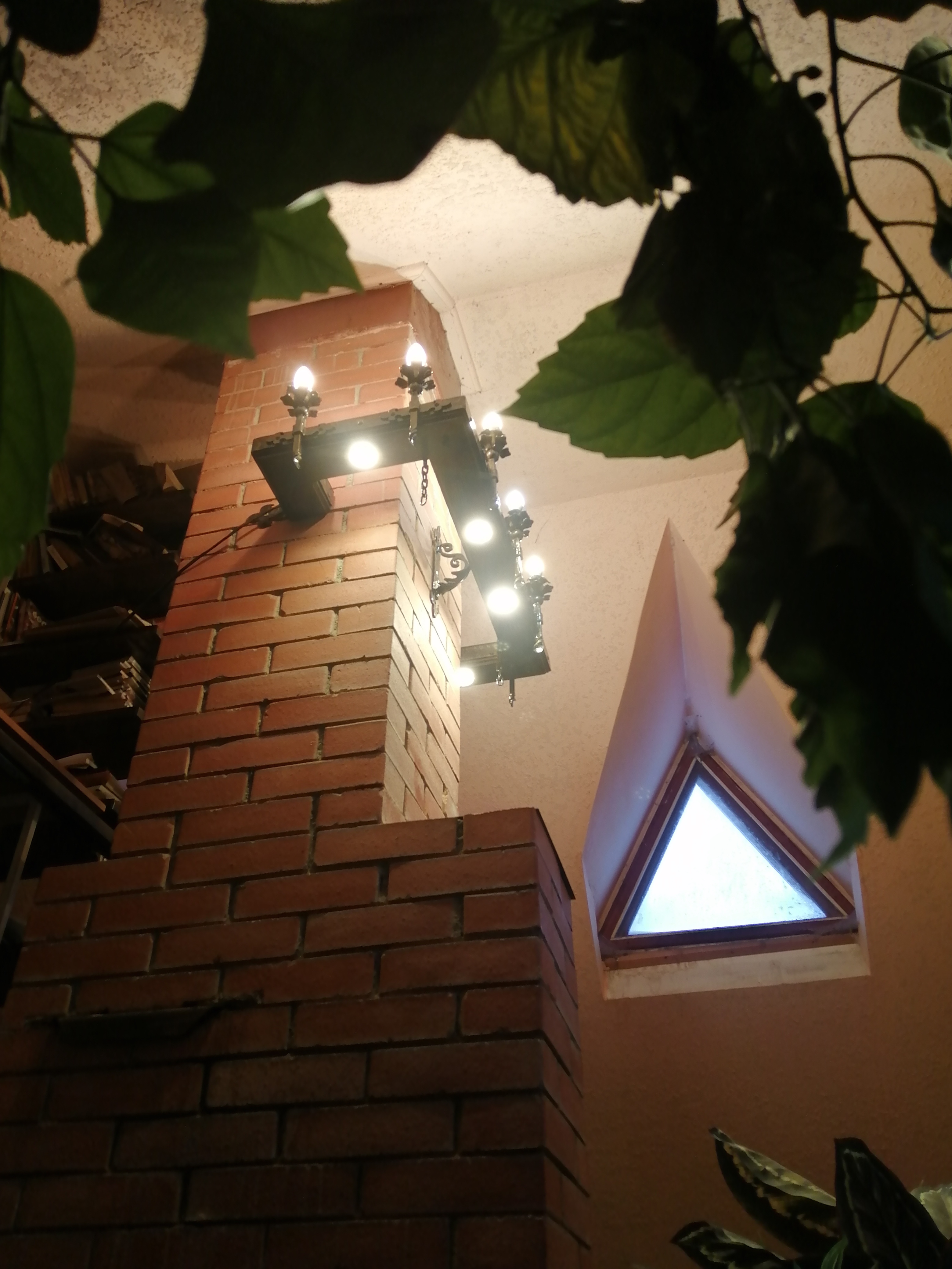

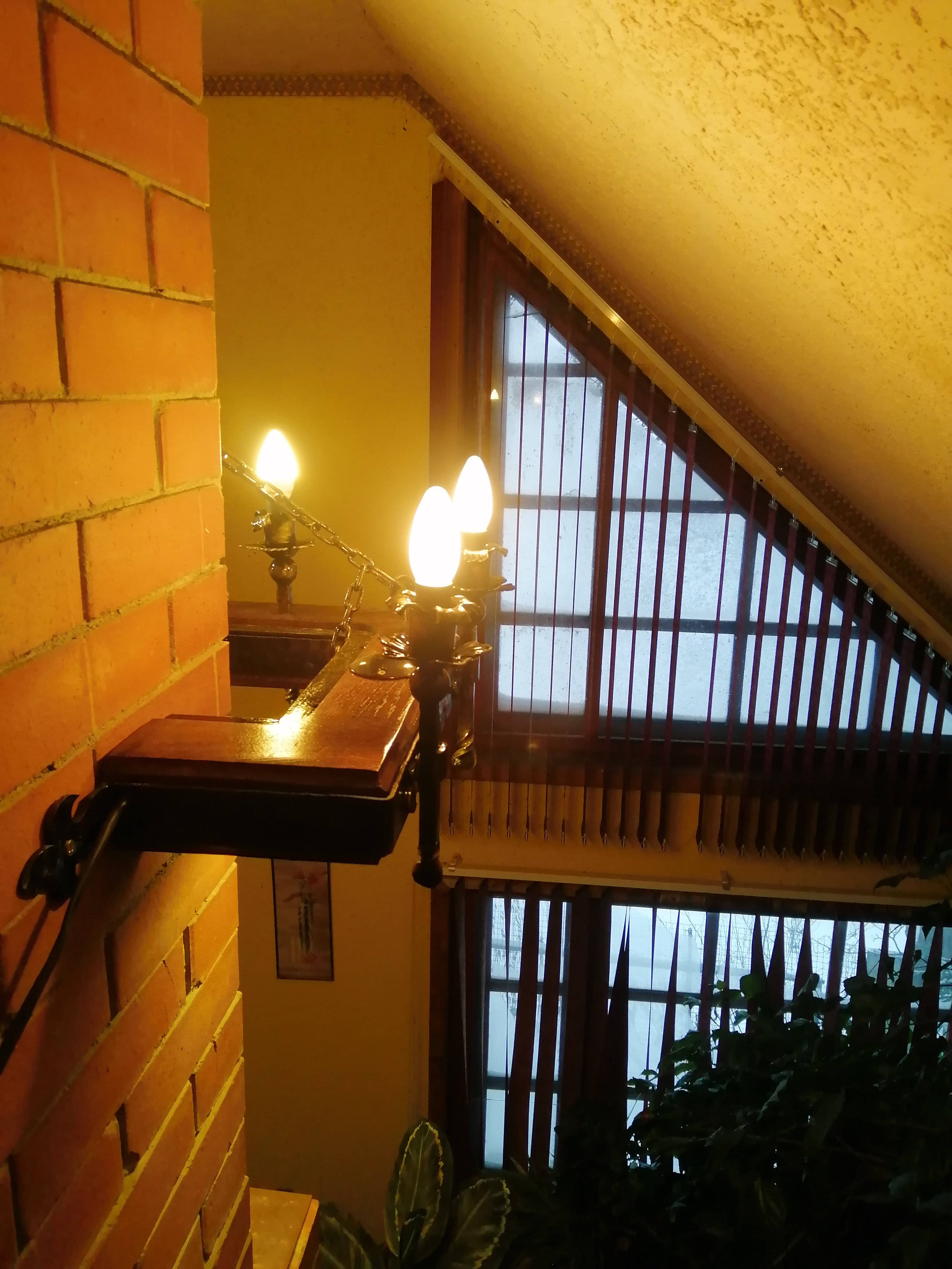

alexandr Posted December 14, 2022 Share Posted December 14, 2022 I made myself a present for the new year. Chandelier on the second floor. Quote Link to comment Share on other sites More sharing options...
Frosty Posted December 14, 2022 Share Posted December 14, 2022 Simple, elegant and beautiful Alex. If it were bolted to the chimney would it be a "Chimney Sconce? Frosty The Lucky. Quote Link to comment Share on other sites More sharing options...

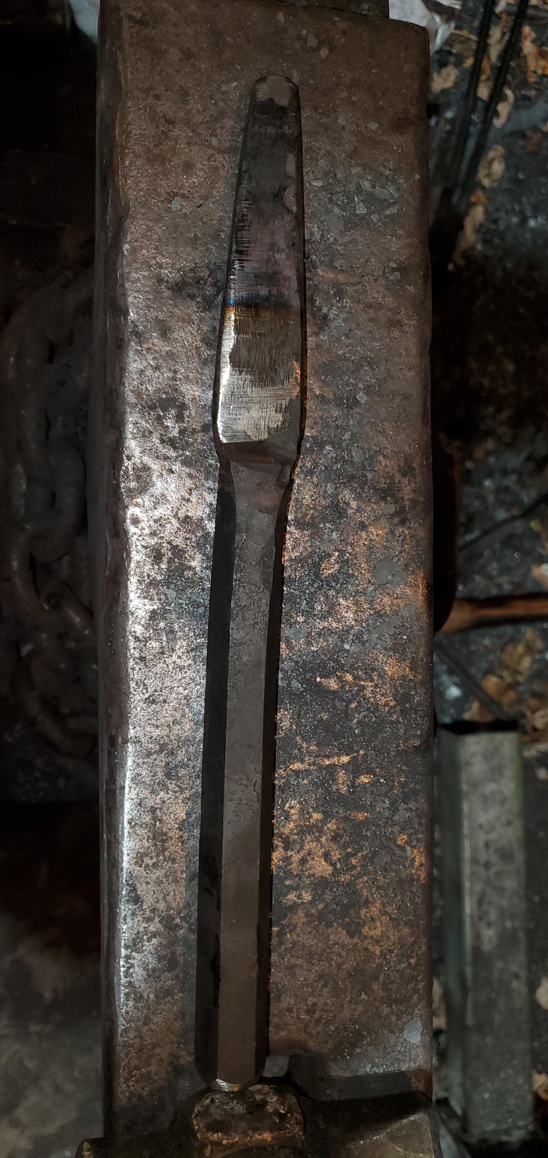

Chad J. Posted December 14, 2022 Share Posted December 14, 2022 The drift I made the other night to help forge the new guard on my sword attempt. This saved me hours of filing. The guard fit up very nicely. Now doing the handle again because the wood cracked when I tried to force it. Going to make a thin chisel to speed that along too. Alex, that is another amazing piece. Quote Link to comment Share on other sites More sharing options...
Les L Posted December 14, 2022 Share Posted December 14, 2022 Alexandr, I saw pictures of the chandelier , while you were working on it, in some of your previous pictures and was trying to determine how it would be used, I knew you had a great idea, but I didn’t know where it was going to be installed. You continue to impress me with every picture of your work and how you can design something for a specific job Quote Link to comment Share on other sites More sharing options...

alexandr Posted December 15, 2022 Share Posted December 15, 2022 21 hours ago, Frosty said: If it were bolted to the chimney would it be a "Chimney Sconce? Guys, thanks! Jer, the chandelier is fixed to the chimney with self-tapping screws. Quote Link to comment Share on other sites More sharing options...

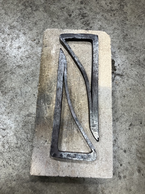

Goods Posted December 16, 2022 Share Posted December 16, 2022 Got a couple more hours in the forge tonight and made two brackets as a start of a tong rack to go on the wall by the forge: Not quite as refined as I’d like, but there forged out, now the rest is fab work… Keep it fun, David Quote Link to comment Share on other sites More sharing options...
