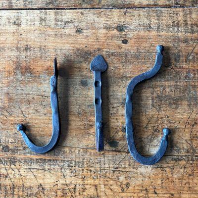

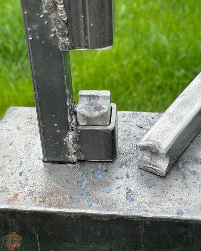

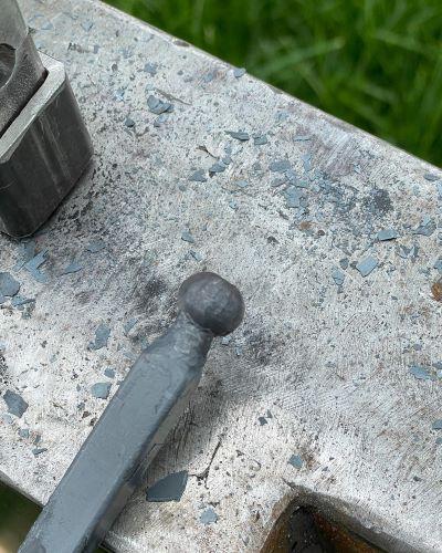

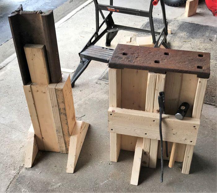

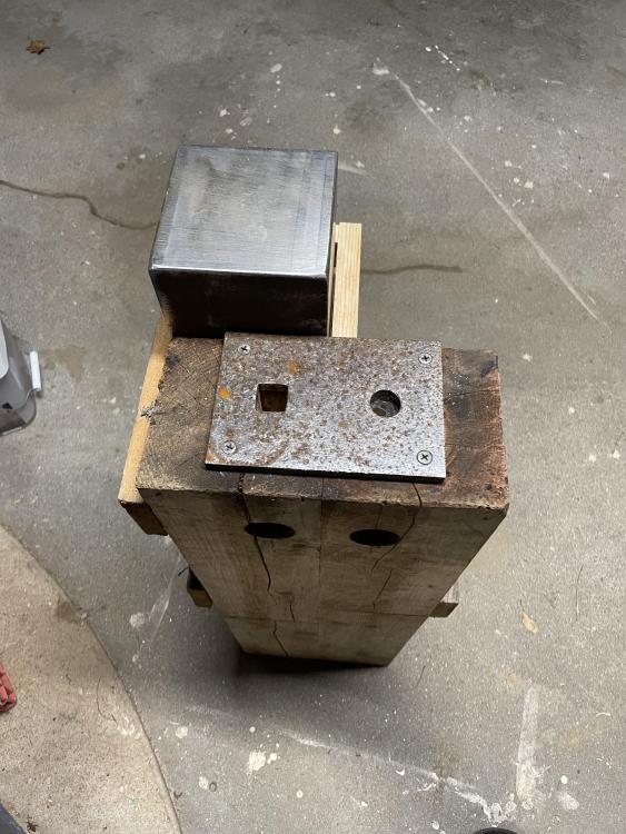

  2. Nice work everyone! It's always inspiring to scroll through this thread! I made a set of ball end dies from 3/4" square to fit my little guillotine tool, and forged a few hooks to try them out.

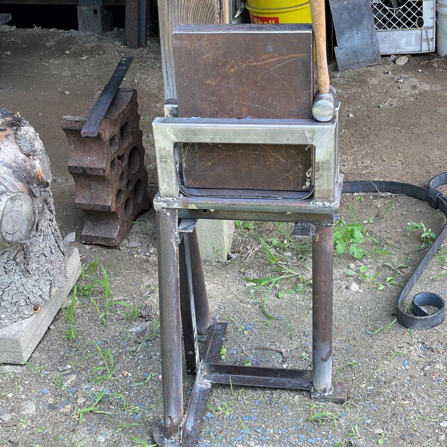

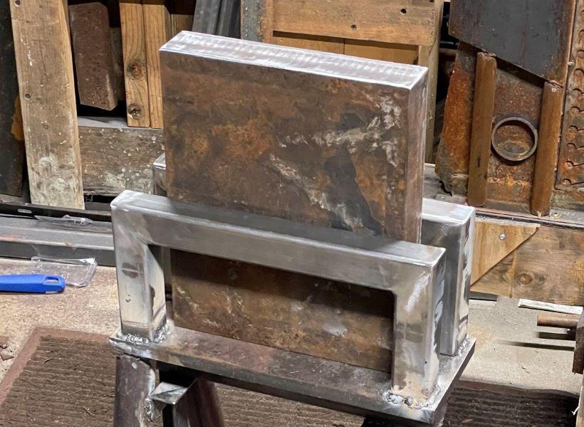

  3. A 10" x 12" piece of 2" plate from the drops section of a local steel supplier, 69 pounds for $59. It will double as a portable anvil and swage block. The stand is mostly drops from the same place and holds the block with any edge up, or flat across the rails. I took it to a friend's house for a few hours of forging and nothing on the stand moved so I can start working on the block next. I'll add a couple of fullers to the top and radius the edges. Then a couple of swages in the side. Eventually some tool holders on the stand for the hammer, tongs, and some punches.

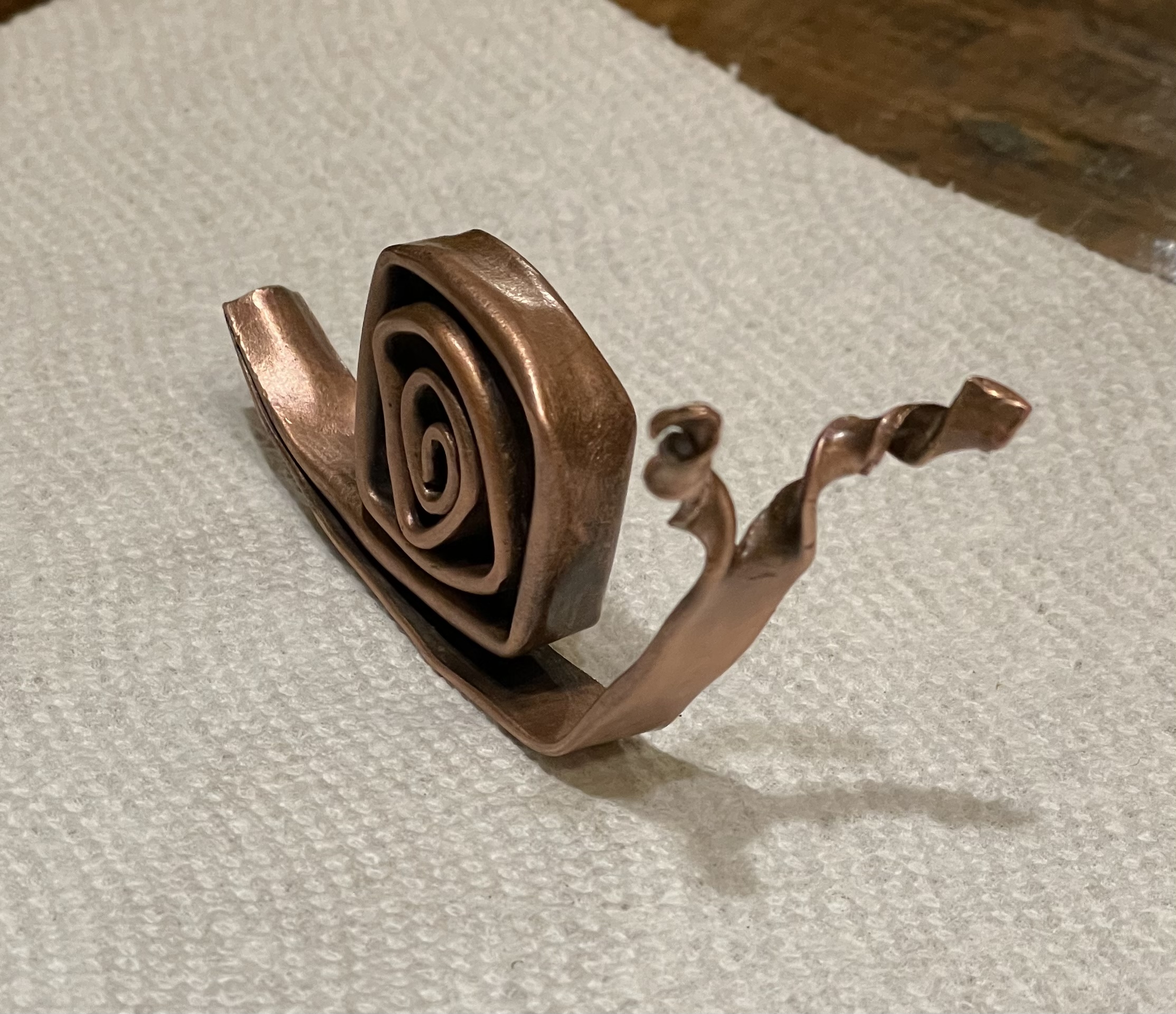

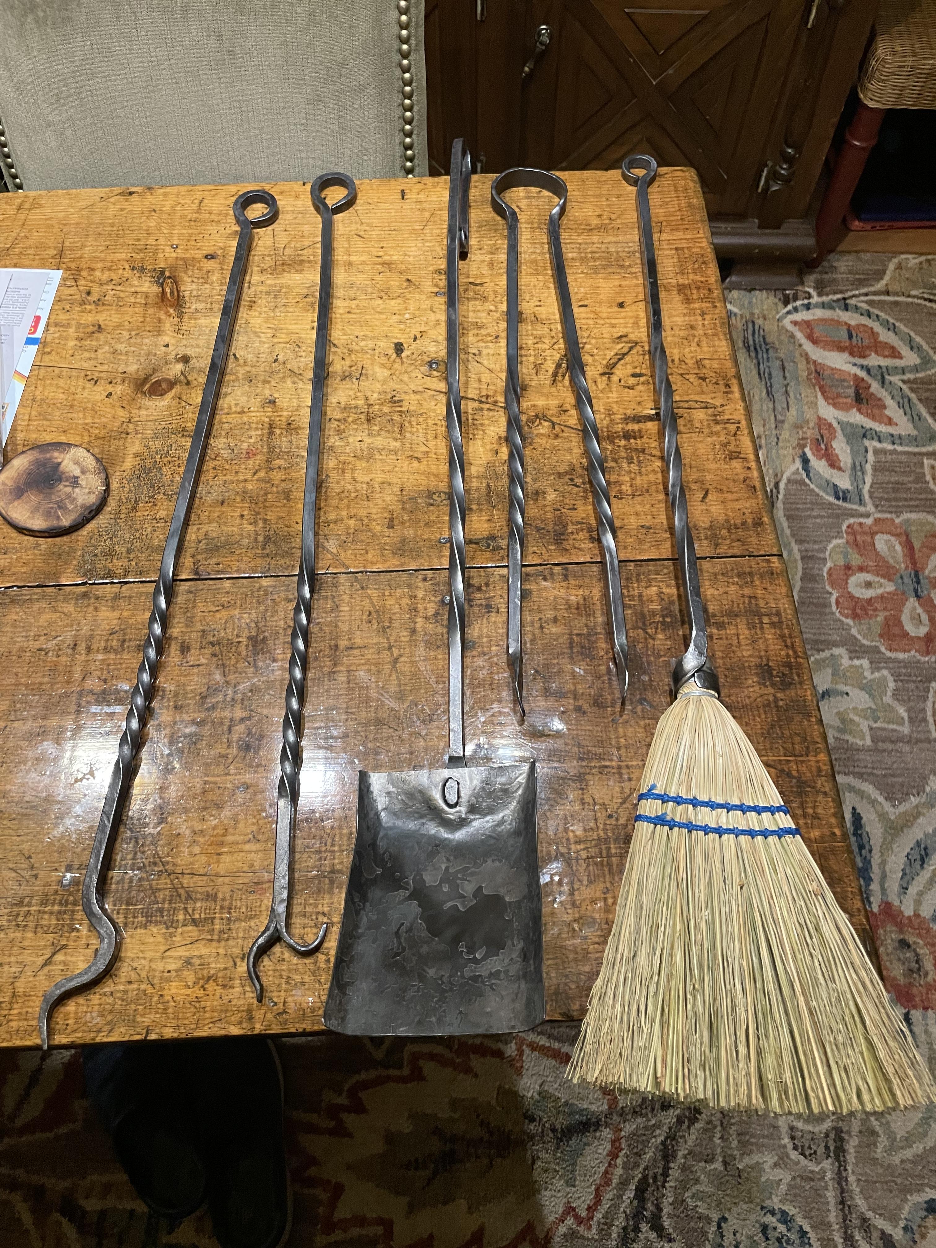

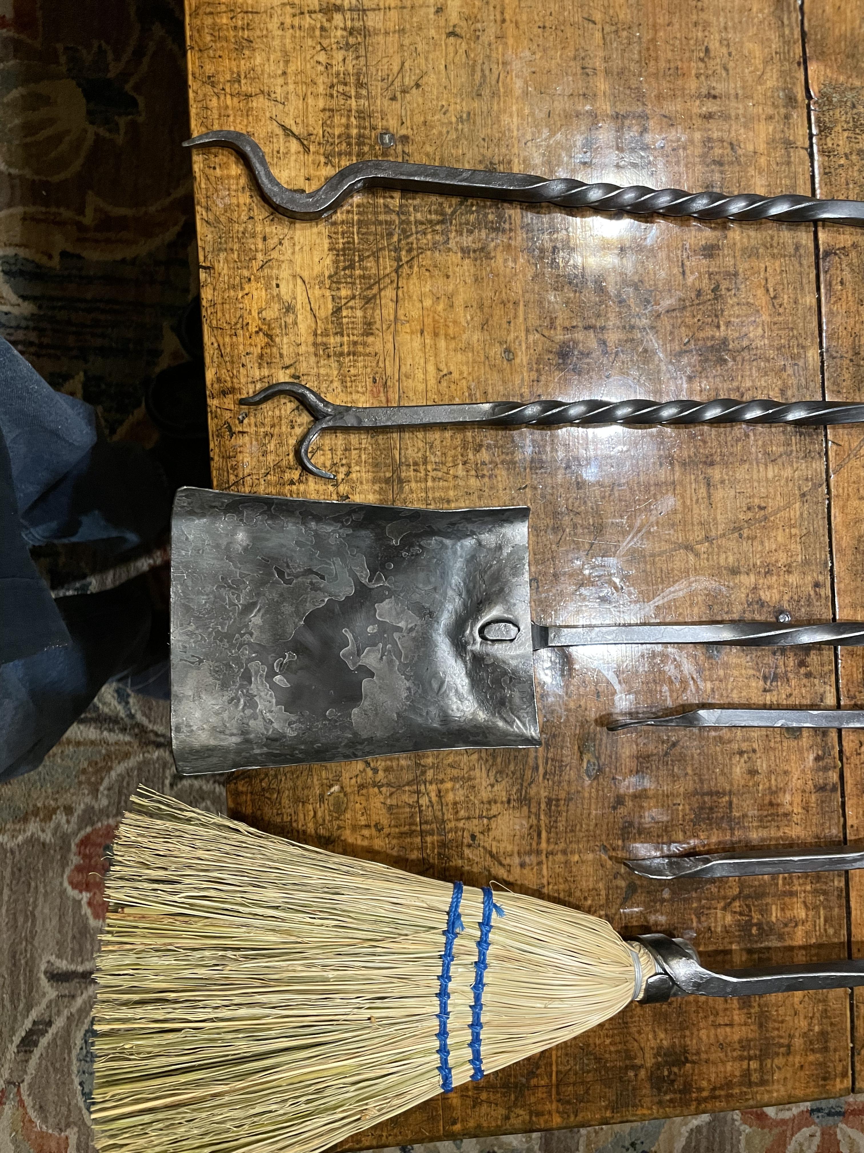

  5. Thomas, I wish you a swift and uneventful recovery! Great work everyone, as always! Here’s a couple of my humble additions that I wrapped up this week. I made a fireplace set for my parents plus a fire poker for a neighbor who’s been inviting us for drinks around his fire pit. These are my first fire tools so I’m pretty happy with them: I also tried working with copper for the first time and made this little snail from 1/4” tubing:

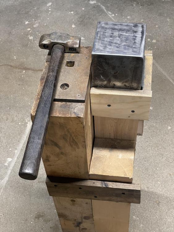

  6. Here’s my third improvised anvil, 4.5” square by 5” tall and about 28 pounds: I ground three edges to 1/8” radius, the fourth is 1/4” radius on one end and 1/2” on the other (roughly.) I had a 3/8” plate with two 3/4” holes so I filed one square to hold tools. The stand was cobbled together from cedar fence post off cuts (also 4.5” square) and other scrap wood. It should hold long enough to figure out if I like this arrangement then I’ll build a better one. I haven’t had a chance to forge on it yet but when I tap it with a hammer it is far quieter than my chunk of rail so I might be able to use it without annoying my wife or neighbors…

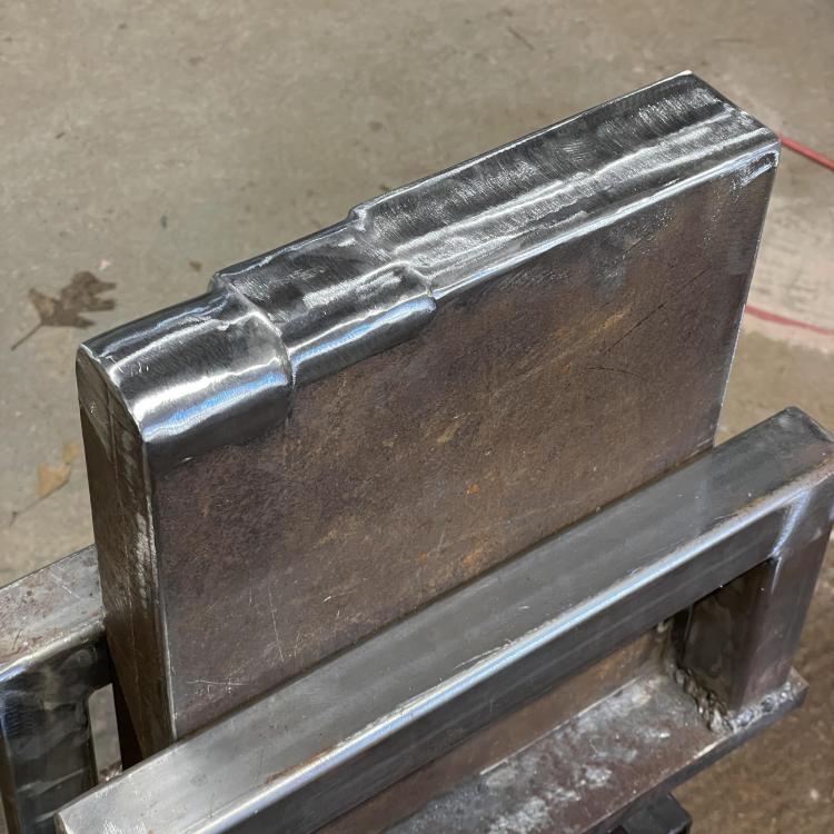

  10. I found this 90 pound piece of 1 3/4" plate in the drops area at the local steel supplier. It's roughly 9" x 18" with a 2" x 4" cutout on one end and some 3/8" plate welded to the other end. I cut off the 3/8" plate and welded on some pieces of bed frame so I could lag it to a stand I made from some 4.5" cedar post scraps. A piece of an old floor mat is sandwiched between the plate and stand to mute the ring. In the cutout I added some 1" tube to create a 3/4" hardy hole and reinforced it with a piece of 1" round bar and pieces of the 3/8" plate that had been welded to the chunk. There's an opening so it won't fill up with scale/slugs and so I can tap out tools from the bottom if they get stuck in the hardy hole. I'm very new to welding so it's not the prettiest, but I tested it with a hammer and it seems solid. If any of the welding gives out I'll just take it as an opportunity for more practice. I like the Brazeal style plate anvils with multiple dies so I'm planning to grind a 1 3/4" diameter fuller on one end for drawing out stock but since I can make tools for the hardy hole I'll stick with mostly flat for now.

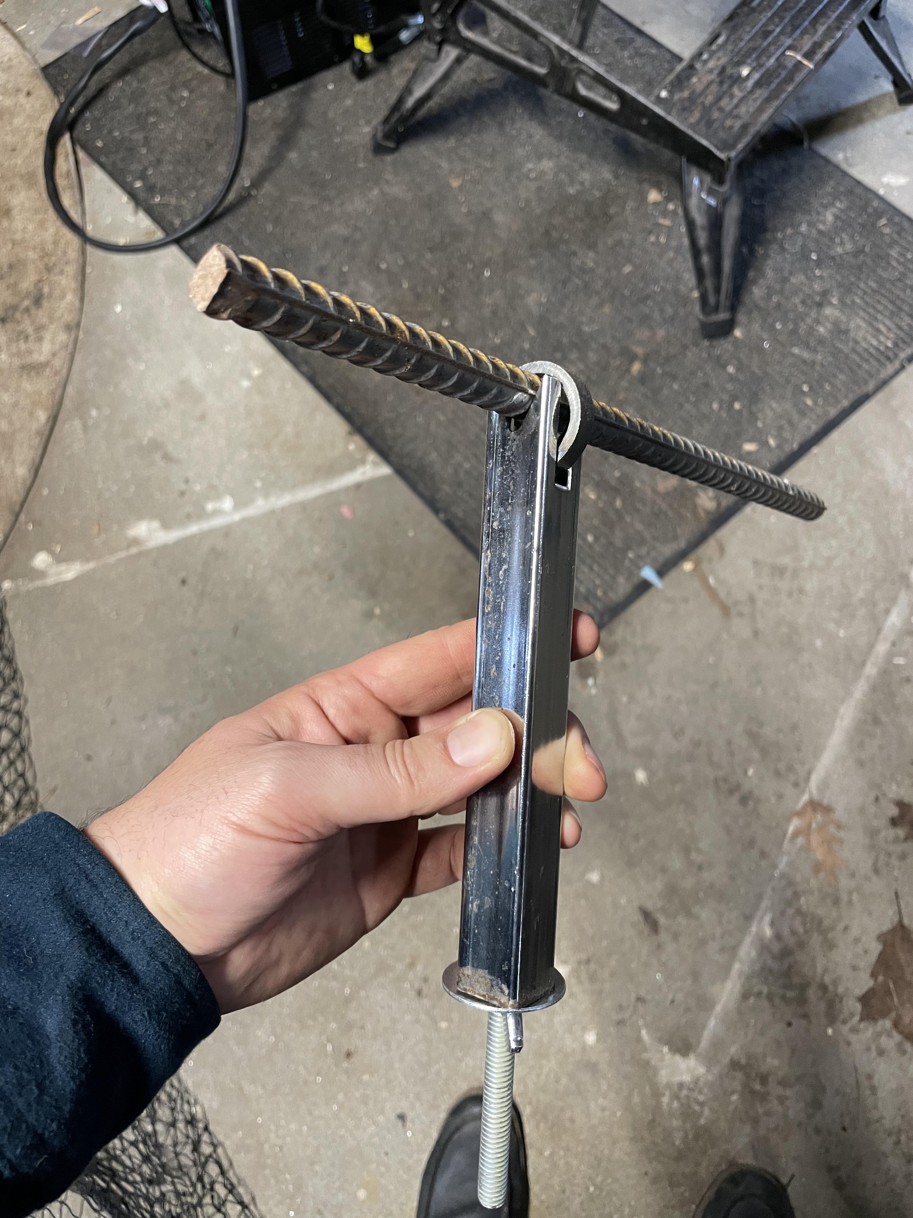

  14. I made a tool holder so o can start making shorter tools. It will hold up to 1” diameter. I’m planning to make a few more so I can have multiple tools ready.

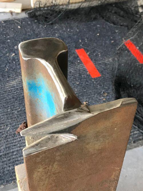

  16. I have a roughly 50 pound length of rail for an anvil and a turnout plate that I'm using as a tool holder. I took some ideas from Charles R. Stevens' thread on rail anvils to build a few tools into mine. One end was unevenly torch cut and I left some of that unevenness in place. The web fuller is a little higher than the flat face and there's funky half round which has been handy. I've since cut away more space under the horn, leaving a catch near the web so I can bend things over the base of the horn. I might eventually grind the web to have a more varied radius, and the bottom is still untouched but for now I'm using it as is until I decide I really need new features. I also have this piece of lighter gage rail that I cut a round and stubby square horn into for when I need something bigger than the mini-horn on the other anvil. This picture is from before I mounted it.
