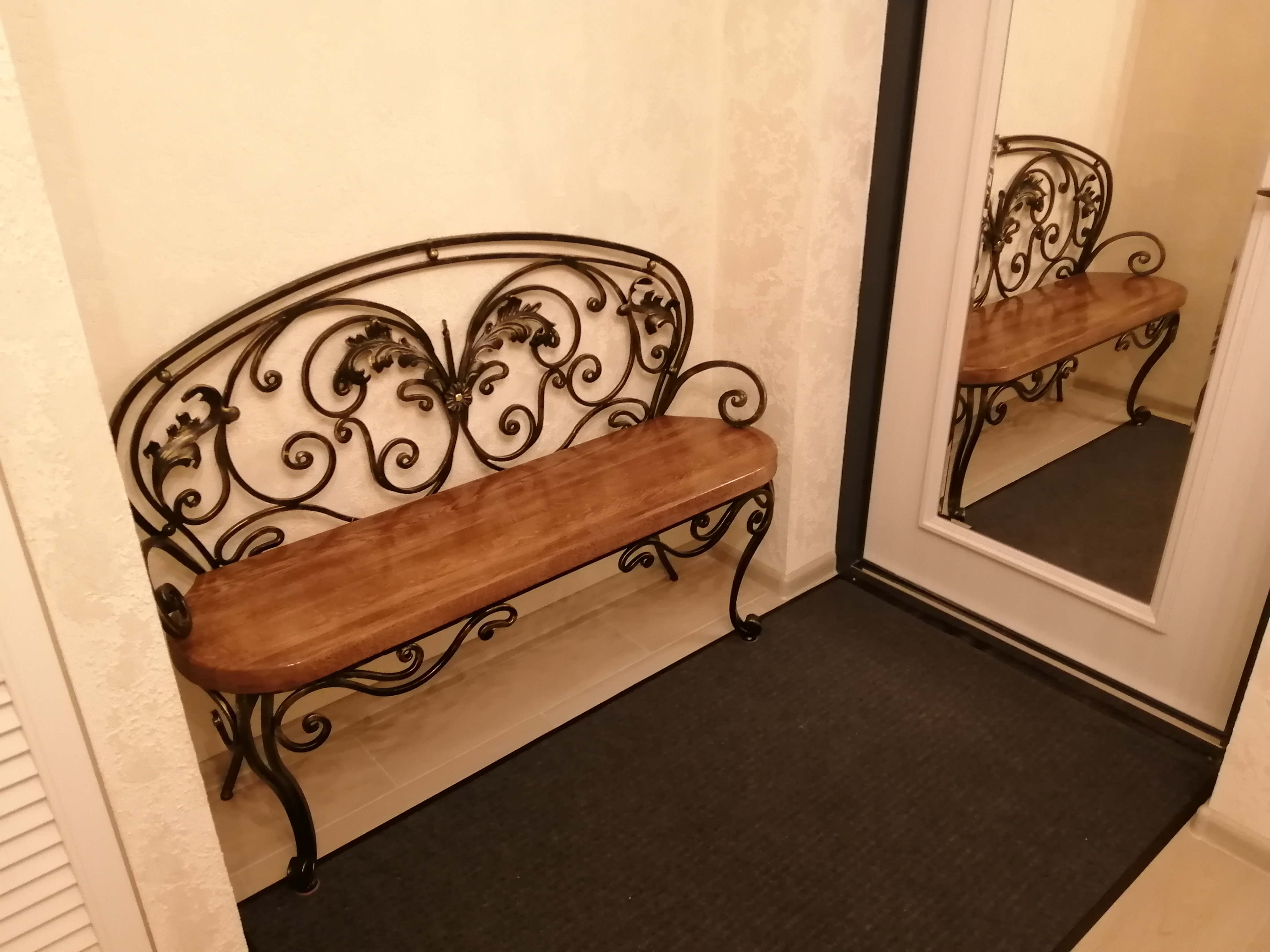

alexandr Posted December 11, 2022 Share Posted December 11, 2022 On 12/8/2022 at 10:51 PM, Frosty said: Sunday! Back at work. Quote Link to comment Share on other sites More sharing options...
Frosty Posted December 11, 2022 Share Posted December 11, 2022 I wonder how many visitors to those homes bump into walls and furniture because they're staring at your work Alex? I wouldn't want to put a cushion on that bench even though it'll probably have wet boots on it before long. Frosty The Lucky. Quote Link to comment Share on other sites More sharing options...
