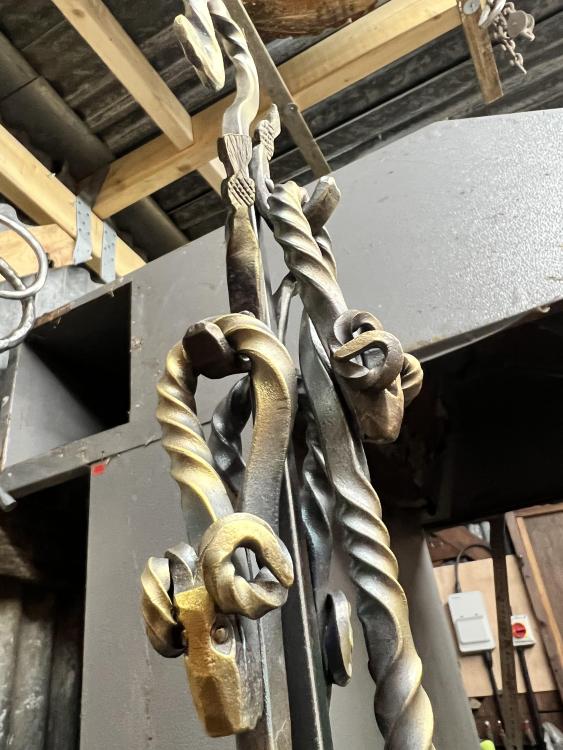

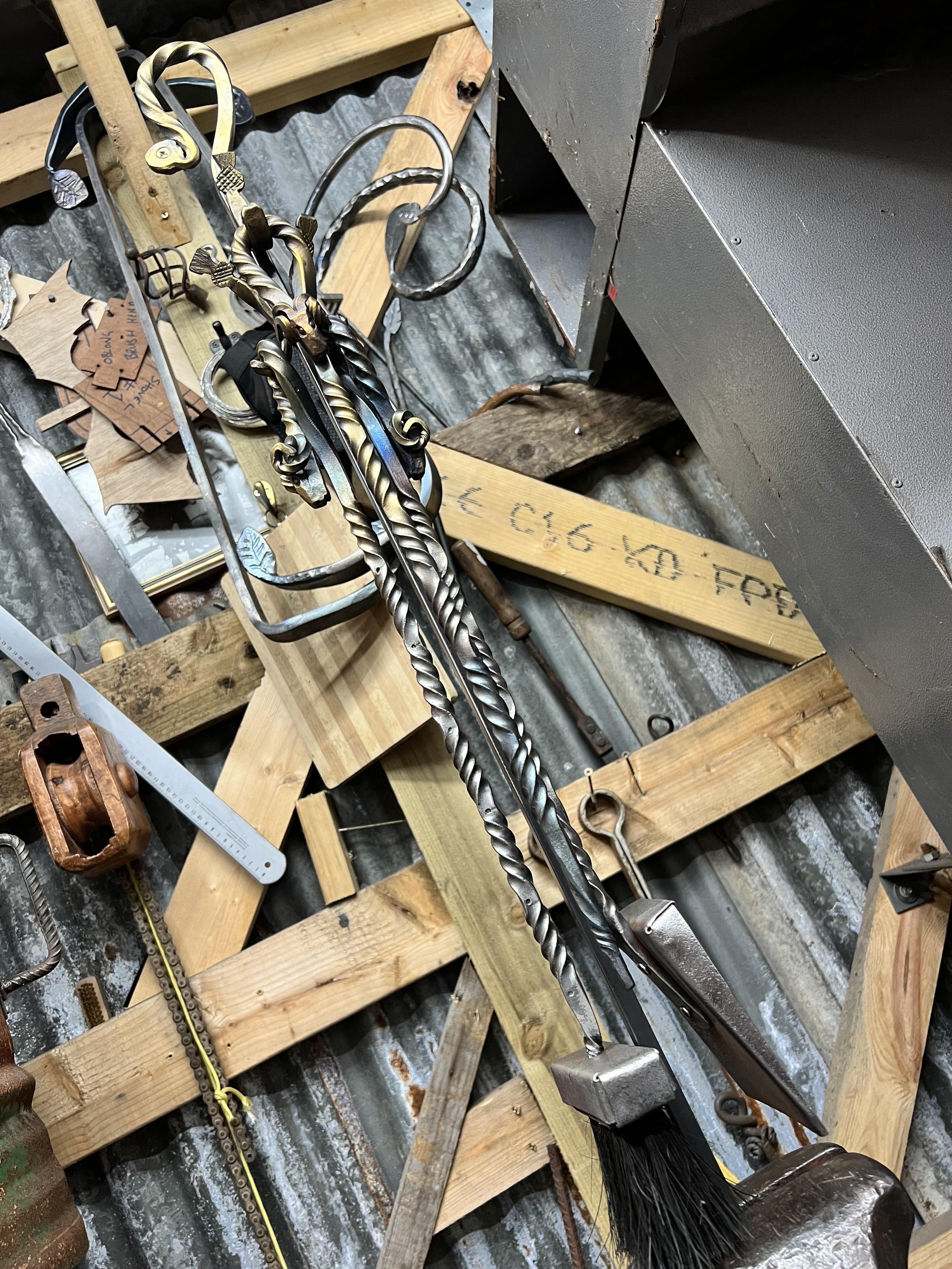

Thanks for all the inspiration.  Some great work here I’ll surely copy. I got stung,  big job, sample  all good then went and bought a lot of stock and started work before I asked for a deposit. Customers hit a big roof problem And ran out of cash. First casualty, fancy bannisters. These things happen, nice people and they told me as soon as they knew. Ah well, this afternoon went back to fireside sets :unsure:
Bummer MacCleod. Look up, YOU don't have to have BIG roof problems and you still have the stock! Maybe make some gate, railing, widow grate, etc. samples to show folks with the fire sets. If you use up too much or all of the stock to make the fancy bannisters you can restock. AND being so successful I'm sure they'll happily pay the deposit on the more expensive bannisters.
Or you'll probably do what I do and cut them a break considering how much a new roof costs if they come back. I am NOT a tough businessman.

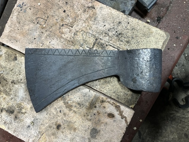

Ok, so I got the forging done on the 3rd hawk and it’s now normalizing:
I may need to make more, because I kinda want to keep this one…

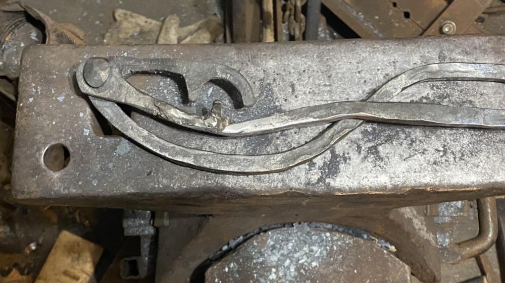

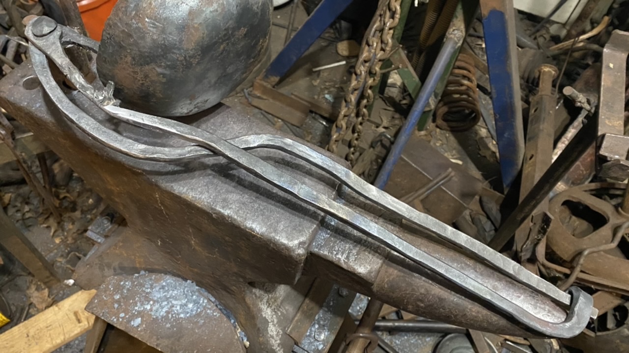

Reverse bowl tongs, Mark II. A critical area got too thin from grinding out cold shuts, broke, and required some (admittedly sloppy) welded reinforcement, but otherwise, I’m pretty happy with them.
Since the reins are rather springy, I added a built-in tong clip, which you can see in lower right-hand corner of the middle photo.
John - Beauty is as beauty does, I say. Neat design. I like it. I've never done any bowls but when I get caught up I'm going to have to try building one. I could see that being useful for sheet metal form shaping and stake repousse'.
I like the design John, I'm looking forward mark IV pics. MAYBE a shot of them in use?

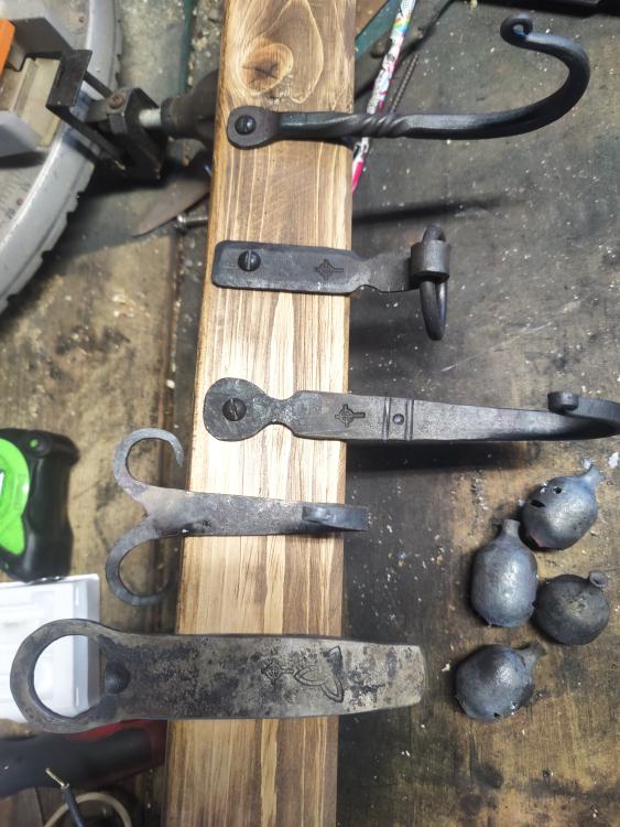

Made a rack for my kitchen to hang by yearly forks from and the hooks. Tried working a bit of wrought as well into a bottle opener. Kind of clunky and rough looking but for the first thing i ever made from wrought turned out better than i was expecting. Managed to keep the metal from splitting and falling apart. I really expected it to fail when punching or drawing out the loop. Also made a few more pumpkins. I can not make these things fast enough. I have gotten faster though i can make 4 now in the time it was taking me to make 2.

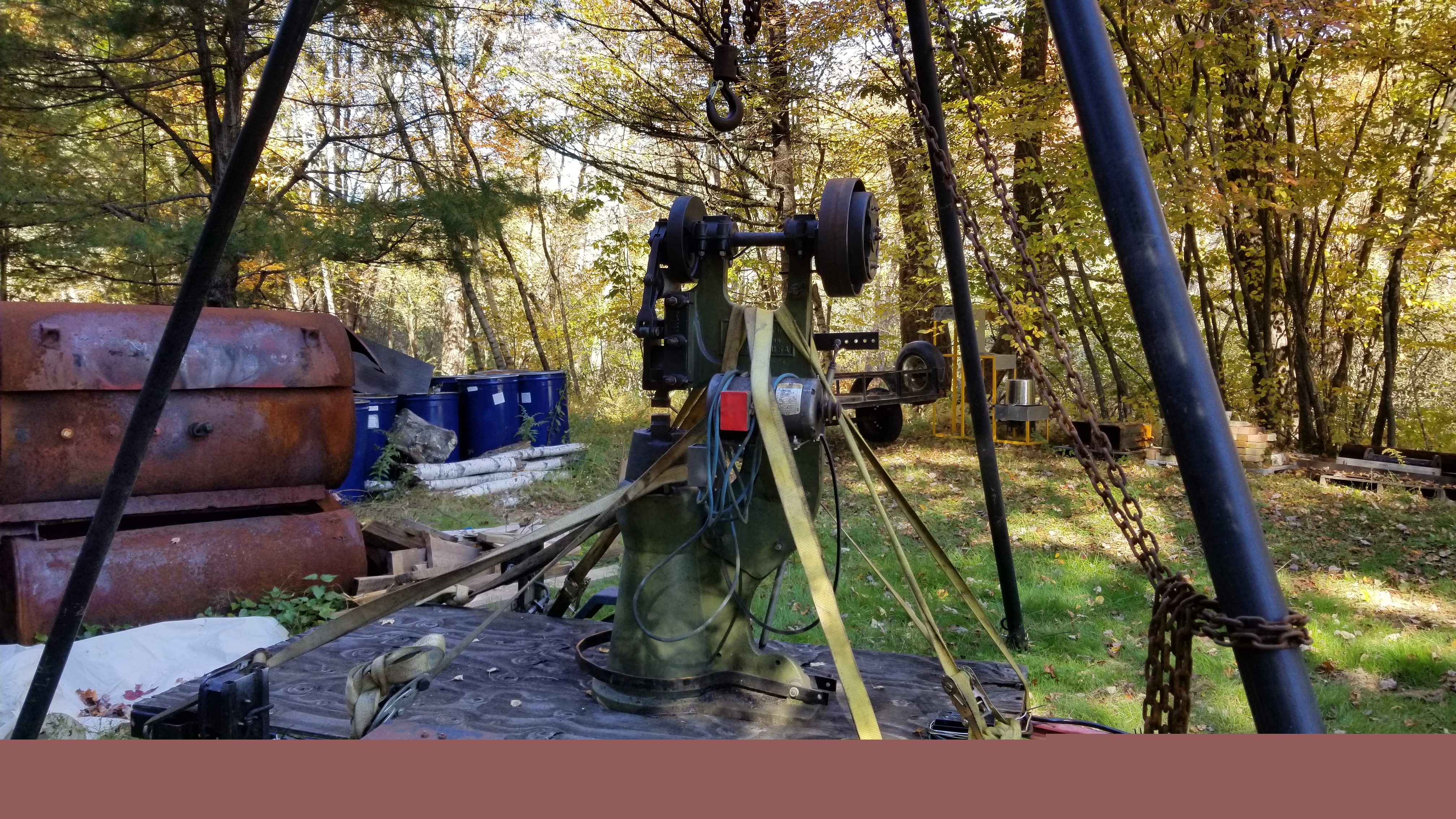

I went Saturday and picked up this little giant 25lb donated by Petras.
A younger smith who was leaving for SD.
Person in the photo redid the hammer for his own use but shortly thereafter bought a KZ75 Which he loves.

I agree with you, it looks great!

David, that is a great looking hawk..
How long did it take you? I imagine your doing most of the forge work on the hammer now..
billybones.. I love all the hooks..  Great product board.
Thanks Les and JLP. Not quite everything I wanted for it, but it’s my best to date!
JLP, I probably have eight hours in it. My desire for a perfect item, doesn’t match my skill set just yet! Not that it’s perfect, but I try to do better with each one.
Yes, I did use the hammer one these. Using a side set, I got the set down in front of the eye really clean, but not in the exact right spot every time. My large flatter also helped keep it nice and clean. Honestly though, maybe only a 1/3 of the forging was on the hammer and a lot of the was me trying to draw down the eye to 1/4” evenly. I’ve got this image in my head of how I want the eye transition to look (almost like an upset corner), but haven’t got it right just yet. Most of the important forging on these is hand hammer work. I sent more time fiddling with they eye than anything else.

David..  I hear you on getting things set first..   Preforms in the forging world are more important and very seldom talked about..    Knife, axe, scroll, hammers..   All preforms..
In 40+ years of smithing I have never been completely satisfied with anything I have ever made..   I always see room for improvement..  This aspect alone might be why I continue to forge..
Interestingly that naturalness to forge to the exact shape each time is my goal..  Make it look easy..
