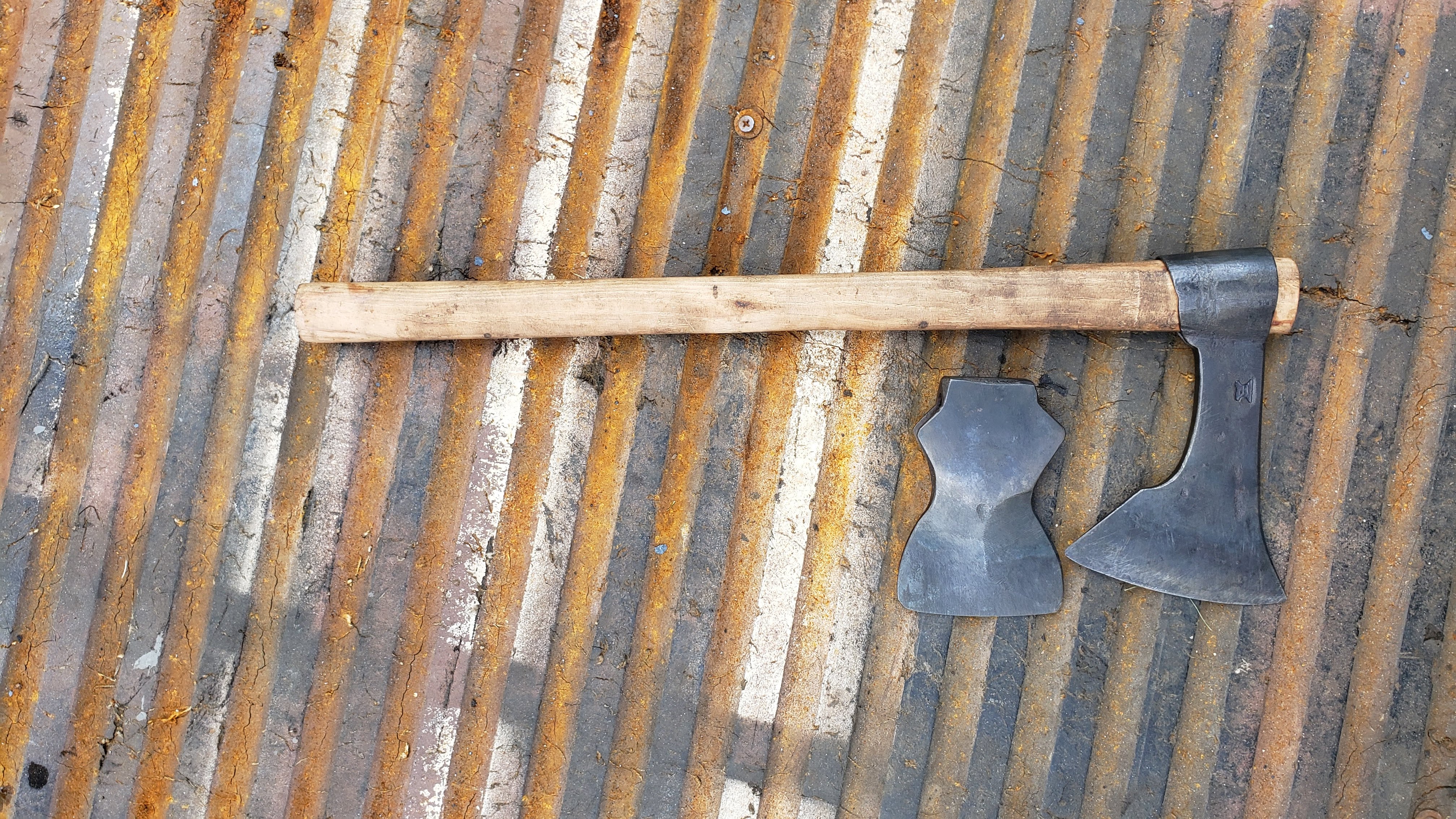

I started on my next hawk tonight.
E977F888-5630-4343-B903-5601CA23C8DA.jpeg.6e7552eb5152d2ca50e2dc280e01e632.jpeg5953CF19-3467-4853-A46F-9D770433FD8A.jpeg.11c945396942361067a4fd2b975e11c0.jpeg
Not real happy with the results. The eye is a bit big, and the weld split while welded the bit in. I never thought the weld would break then. I already set the step in and the weld held then! I think I got the weld to take and some of my hawk handles are a bit oversized, so time will tell. Let see if it survives the final bit of forging, but that will have to wait a couple days.

imma thinkin bout messing with tomahawks this winter, what kinda material are ya usin for yours?
I was think bout usin big ol rasps folded in half an welded but I haven’t spent time yet an looked into axe makin to see what’s easiest to work with yet,
I’ve been using cold rolled 1018 for the body and forge welding in a high carbon bit. Current batch has 1095 for the bit just because it’s what I have that works. I’d rather use 5160 and have a huge leaf spring lay around that would work, if I could ever get it to forge weld. I swear it’s cursed! (Could just just some crazy weld hating alloy…).

David I prefer 5160 on nearly all my working steeled items..   I have recently fell into Lawnmower blades but have no idea what they are made out of.   Super tough steel..  Could be the heat treatment but dang.. I've straightened 1 blade cold maybe 7times before it let go while in use.   I started on the lawnmower blade because it was all I had in the trailer and to lazy to walk to the stock pile for the 5160.
The dogs head hammer was faced with lawnmower blade and the last knife I did was lawnmower blade as well.  Will get 60Hrc
5160 doesn't really like to weld to itself.. Can be tricky there, but to mild steel or any other metal it's not bad. One of my favorites for sure.
Are you preforming the eye with the taper or adding it as you forge around the mandrel?
Twisted Willow, not a huge fan of bent and welded rasps..  The lines are weak points.. cut and added between some mild steel helps some to stabilize the cutting edge..  but find while cool looking and for ha, ha's.. its good but..
John Deere is alleged to use 5160 in their lawnmower blades.
My last hatchet was punched and drifted from a chunk of mild steel with a piece of file welded in for the cutting edge. Worked quite nicely.

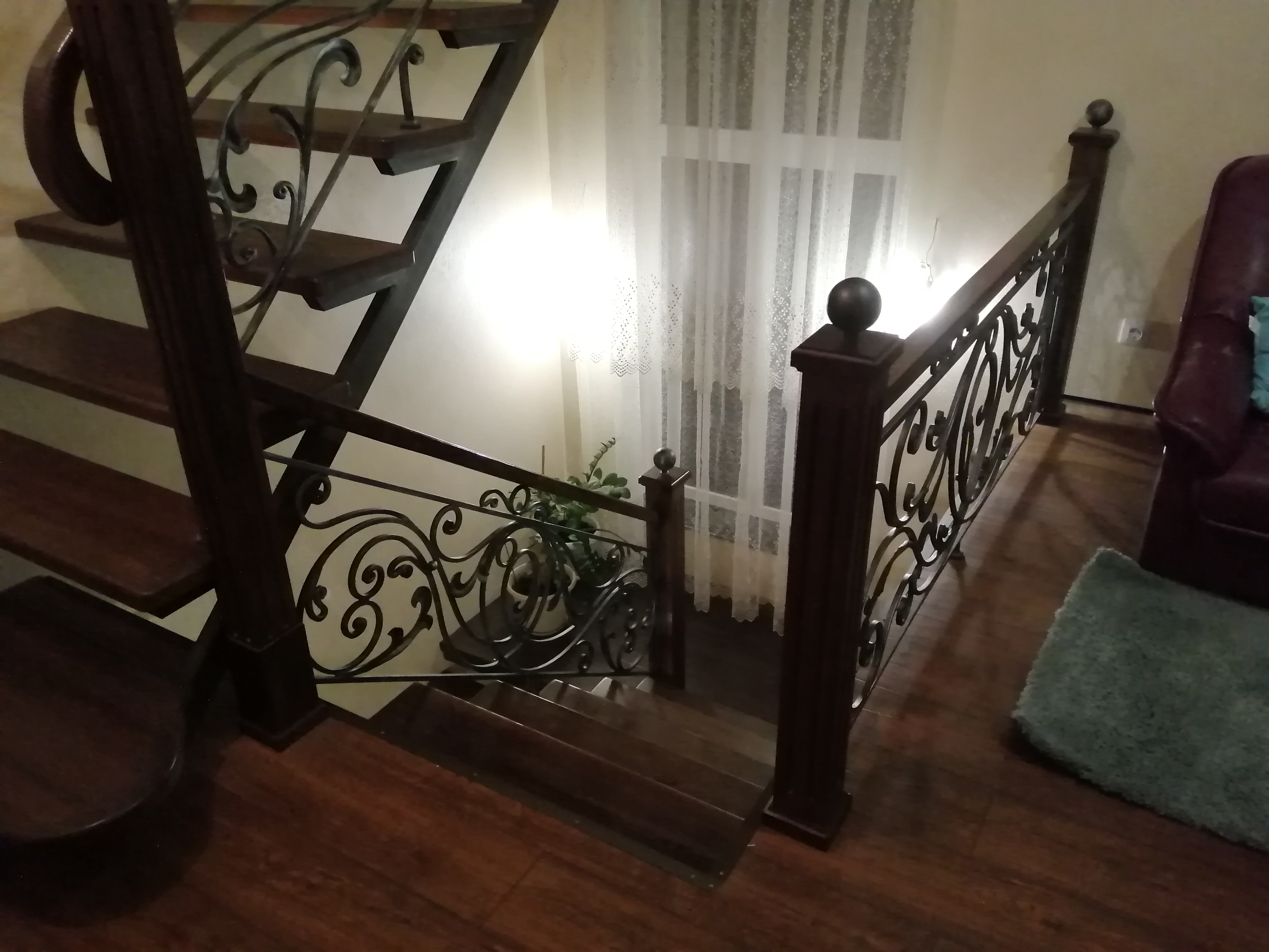

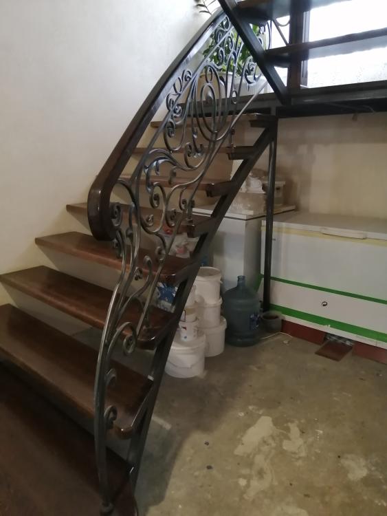

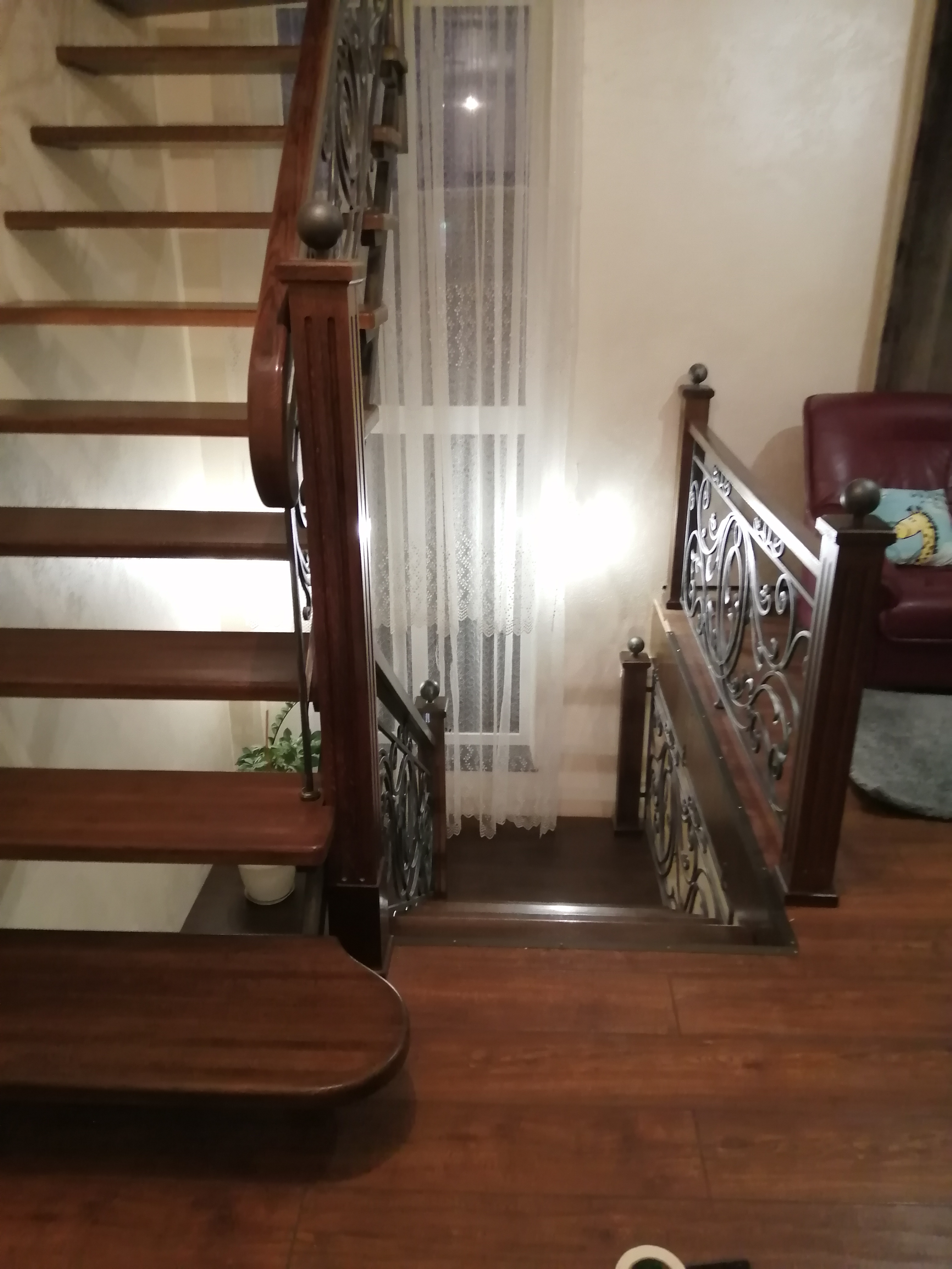

3 years, slowly, did the stairs.
Finally finished today.

Alexandr, you may have taken your time finishing the stairs, but you did an exceptional job

Another beautiful stair case Alex, thanks for the look.

Alex great work..  it still blows my mind how productive you are..
JLP, it depends on what you mean by preforming. I’m using 3/8” stock, so I forge the eye down to 1/4”. Similar to how one would do a wrapped axe. I personally like how it gives a defined point for the weld. (But it does mean I have to get the material measurement for the eye correct!) I’ve also been working on getting the shape developed for thickening the transition point at the front of the eye. Honestly, it’s just a looks/preference thing, but haven’t gotten it to be what I want yet. I just keep flattening it out somewhere in the process.
On the other hand, if you mean preforming as putting a little bend in the eye material to setup for the taper of the eye and cupping the same area to compensate for the top and bottom of the eye flaring out when wrapping, then no. I always think about doing that. Then skip over those steps in the “heat” of the moment. I really need to remember that, it would definitely be a time saver on the back end, and I think it will result in a cleaner forging.

David,  Thank you very much for the kind words on the videos..  Really appreciate it.. Makes such a world of difference getting feedback..  Once the school is up, I'll start making videos again..    Making them in the trailer is super tough.. Lighting, sound etc, etc..
Yes I was referring to the eye portion and taper..  I spent some time trying to get it right as a preform before it was bent in a U but never had consistent success..    I never cut paper to work it all out.. It's  a strange bend..
The long pole on this medium beard is an example of what I was trying to do..

Alexandr, the railings look worth the wait.
