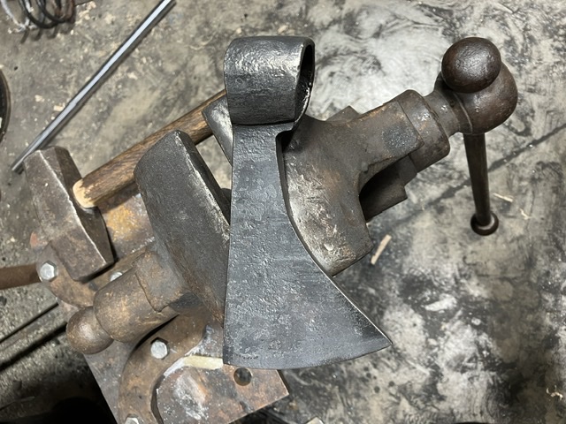

I got the first of 3 or 4 hawks wire wheeled tonight. Forged and anealed(sp?) yesterday. 627915BF-7527-4FB9-B768-27CF7705D72B.jpeg.b67d46165308e71c89c2999e0bd8dc5d.jpeg2F15802B-AA18-4B6E-93E5-195A1B6A2EAA.jpeg.aac77105892bf63fdecb35d668d5571b.jpeg9310075F-CDB0-4D09-8C68-3188DC1E7EF6.jpeg.cd3c3d9c538c5d002a88552dd11dceb4.jpeg
I’m going to have to leave a little more material for the eye. I thought I measured it out as 4” and checked before wrapping, but still had to draw out the eye walls quite a bit and popped a little bit of the weld.
Should have added 1/4” in length to get to a centerline measurement, but it seemed like more than that. Maybe I’ll try 4-1/4” next time. I’d rather bet short than long.

David really nice hawks..
Thank you. They're acceptable as a prototype, but I messed up forging the inside jaw (lots of cold shuts). I think I'll make another pair now that I have the basic idea down, especially once I've given them a try and see how they behave in use.
Interesting detail: these were forged out of some long triangular scrap from an early iteration of my welding-tank cone mandrel project. Since welding cylinders are generally made from 4130 and since I've got a lot of this particular scrap, I think I'll be making some more tongs from it; they've got a lot of strength for their weight.

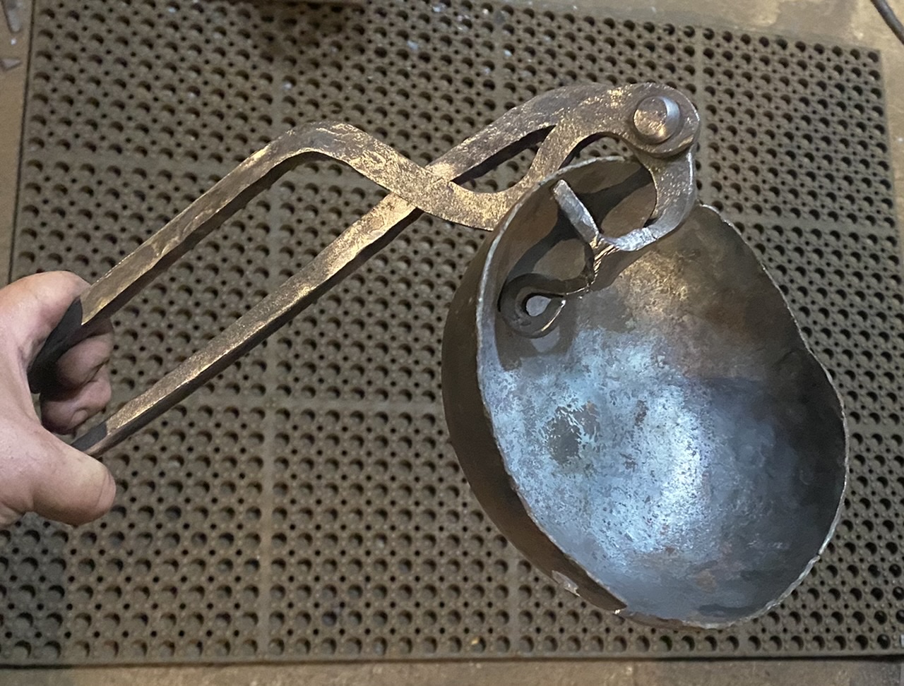

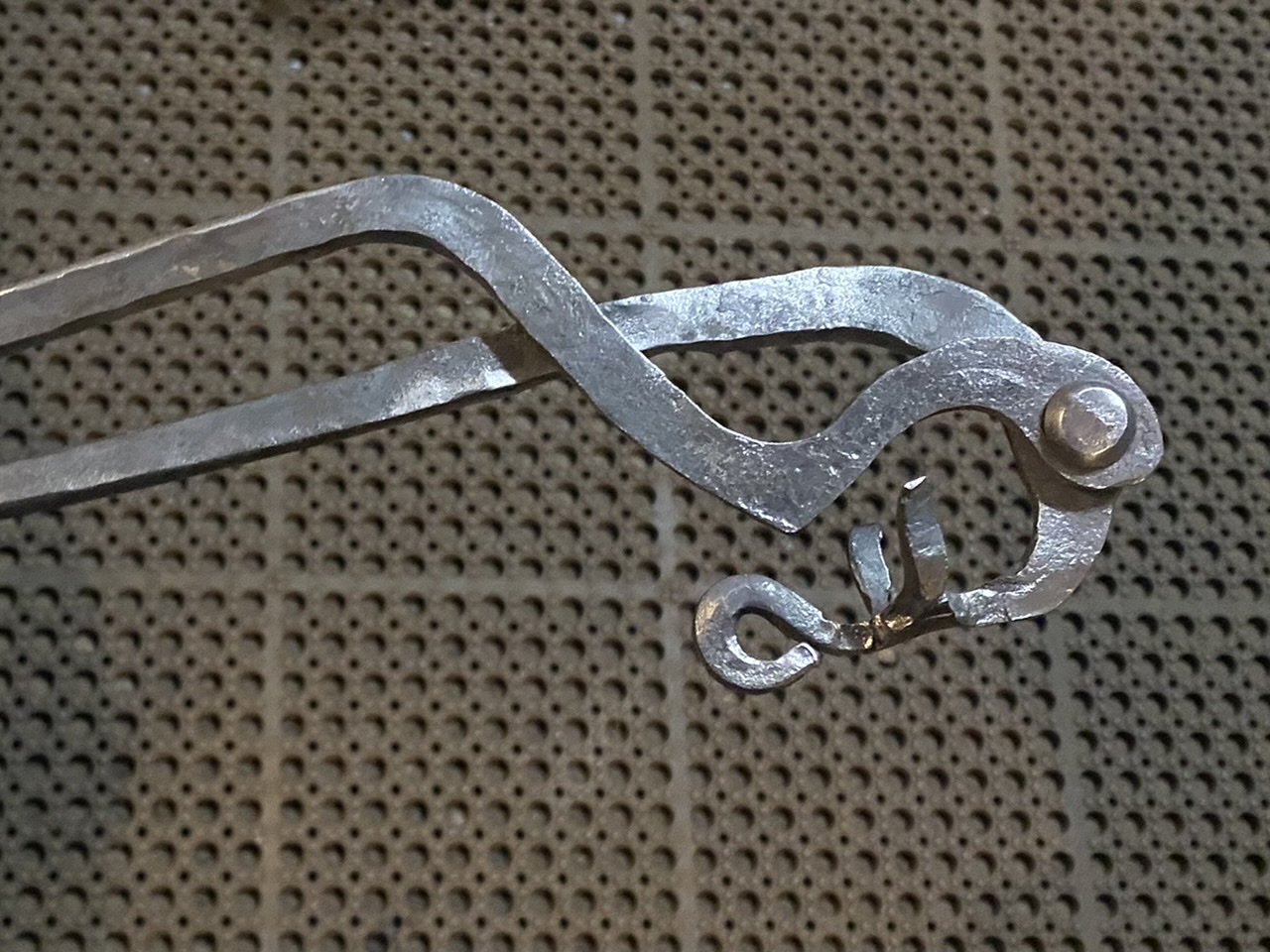

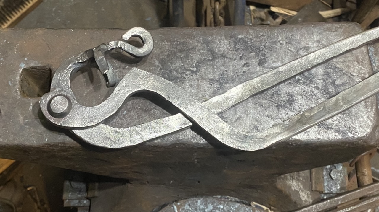

I think I can guess how the idea was hatched.  Doing a number of bowls, pots, and other dished forms I have noticed that they all seem to make a *great* parabolic IR emitter that for some reason tends to have a focal point where the hand is gripping the tongs holding it.  John thought to turn the Martian Heat Ray around....
I adjusted a pair of tongs I picked up at Q-S, (hot); added 5 more sacks of coal to the pile in my shop and dumped the water bucket as we are expecting a good 1/4" rain today and a couple of hundredths most days the rest of the week.  (Yes out here it's normal to get "expected accumulations" of rain in the .03 or .04 ranges; you see one over 1 inch and there's  rush on gopher wood and bitumen!)
On 10/3/2022 at 11:19 AM, anvil said:
Lol, I'm not going to ask how you got yer mind to that point.
Well, I'm going to tell you anyway!
The starting point for this was thinking about hot-raising sheet steel. A lot of the tutorials I've seen online for bowl raising on a stake have the rim pointed away from the smith, who works the metal from the bottom of the vessel towards the rim, hammering away from themselves. These have mostly been cold-raising nonferrous metals, though, where it's easy to hold and position the workpiece with a bare hand. If you're hot-raising steel, on the other hand, you have to hold the piece with either tongs or some kind of heavy glove. Gloves are bulky, clumsy, and not particularly effective. Standard tongs require you to have the rim and the reins pointed in the same direction. Towards you is comfortable to hold, but means that you're hammering towards yourself, and you're not able to use most standard stakes (other than ball stakes). Away from you is easier to hammer, but means that you have to reach over and past the workpiece in order to hold the reins.
As I pondered this, I realized that part of the problem is that the jaws and the reins of most tongs point in opposite directions. Therefore, a possible solution would be to get them both pointed in the same direction. With that idea in place, it was simply a matter of thinking through how I could make tongs with the jaws pointed back at the smith.
My first thought was simply to make some tongs with a 180° bend at the boss. I then realized that there was no need for both halves to go through the full arc, as one of the gripping points could be on the handle side of one half and the rivet at the end, rather like a nutcracker.
The next challenge was to consider the gripping surfaces. Here, I realized that the most secure option would be to have three contact points on one side of the workpiece and another centered between them on the other side. That way, regardless of the curve of the bowl, the tongs would still grip it securely without any wobbling within the jaws.
Many sketches later, I got a working drawing that I was comfortable with, and set to work. Forging presented some unexpected challenges, which I hope to address on the next pair.
