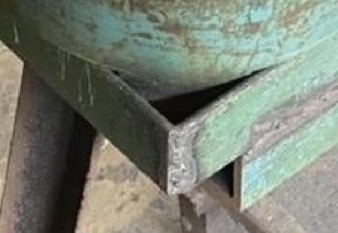

lary, those are pieces cut from the side of the dishing form in the same post, which I made from the bottom of a big welding tank (about 10" in diameter). I notched the sides so that it would fit into my swage block stand, as you can see in this closeup:

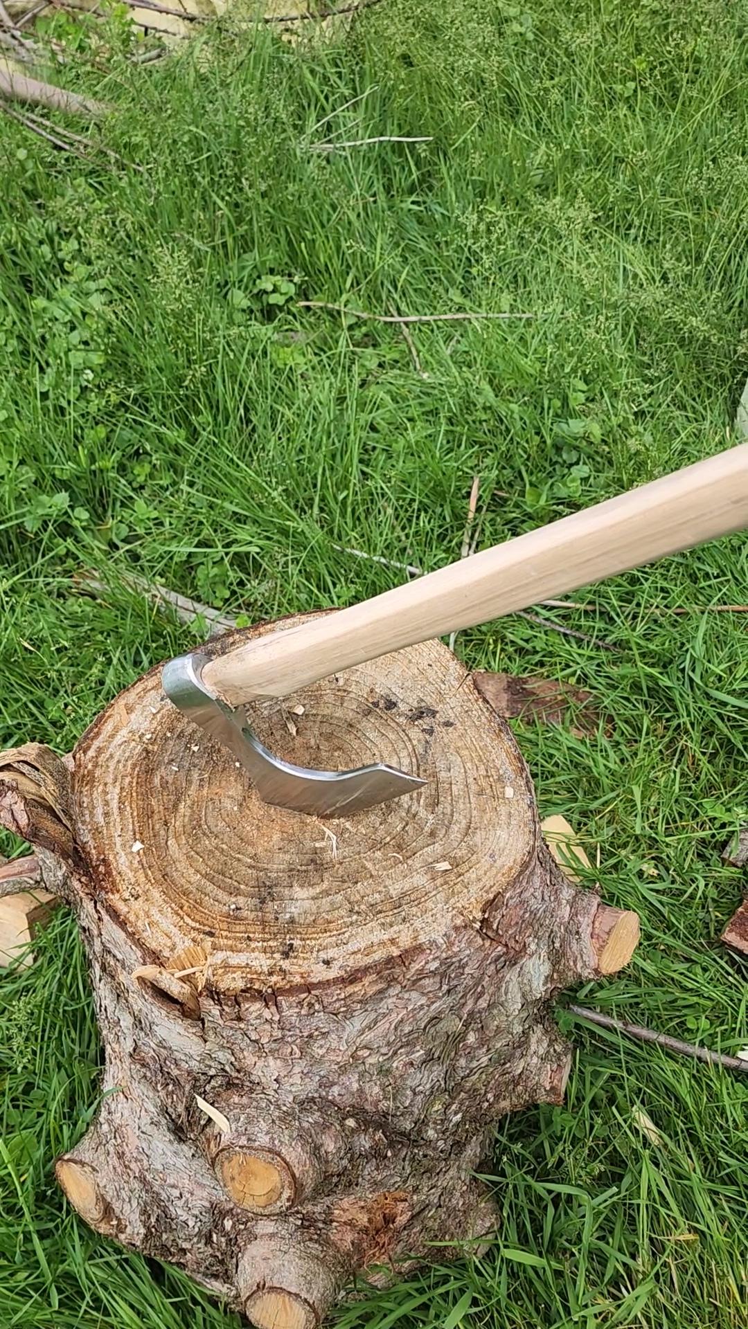

I've also been working on an axe, it's nearly done so I'll take some pics when it's all ready.

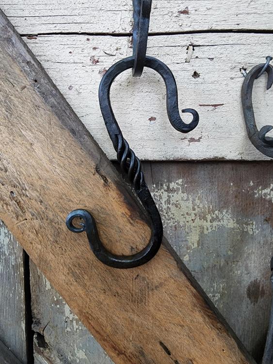

Made a small basket twist S hook.   I went with 3/8 inch round stock and 1/8 round for the basket.  5 inch length on each end and the basket was cut to 3 inch.    I used my stick welder, much more reliable than forge welding for me.  Since it was so hot today I mainly stuck with project prep.
Jobtiel1 I really enjoy looking at the combination of blacksmithing and wood working skills. Thanks for posting.
Chad J. that's funny you posted that basket twist s hook, I've been working on the same thing with similar welding technique. I'm to cheap to run my little gas forge up to 20psi to find out if it will forge weld. Not to mention the destruction of the lining after the use of borax. One of these days I'll have to start forging with coal. Lots of great stuff on this thread.
My little horbart did just fine and leaves it hot enough still to work the ends to what I want.  I tried forge welding again over the weekend in my coal forge.   No dice.   It's getting plenty hot,  lemon yellow with sparks just starting but maybe I'm not getting it clean.   I'm going to have to go watch Jennifer's chain making video again to see what I did wrong.  But I want to try and get to a couple craft sales this summer and I'm in a push to get stuff finished
