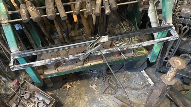

Cleaned up some bowl blanks and rebuilt part of my hammer rack.
And added hangars for C-clamps:

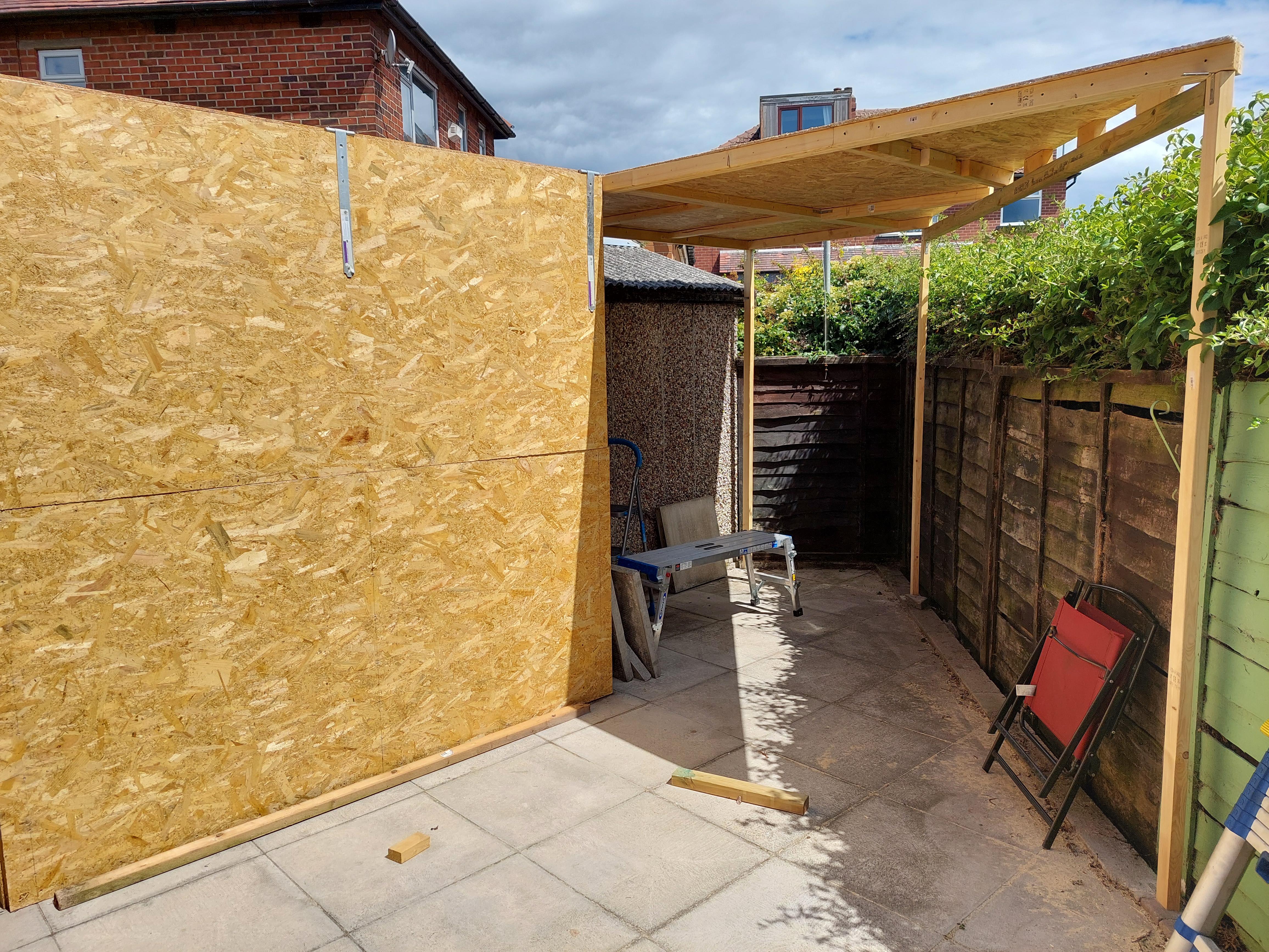

I'm moving my shop home so the last few weekends have been building a shed for the workbench and tools with a lift up door to give a bit of weather protection and a covered area for the forge and anvil to sit under. It's only a small back garden and the Mrs still wants to be able to put the washing out so I think this is the best use of space.
It means I can just walk outside to play rather than drive to my work, unlock 6 locks, set up and climb the ladder to my shop (it's in a 10 foot storage container on top of a 40 foot storage container), forget something so back down the ladder. Repeat the ladder process 6 or 7 times until everything I need is up there then work alone for 4or 5hours. Since my heart attack last year I'm not liking the idea of working alone with no one in the area.
Long covid means it's taking far longer than it should to build but it's getting there.
I had to do at least a triple take but the angle of your pics make it look like the roof is sloping towards the sheet metal roof by the house. I assume it's the camera angle and the inside corner making it look that way. I HOPE I can assume the roof is sloping towards the neighbor's yard instead.
Looks like a workable space and not having to climb ladders is a plus. Won't you miss the good old days though? Your old shop ranks up there with Dad having to walk through chest deep snow uphill both ways to go to school how happy he was for the privilege. Well . . . okay you might have to embellish a bit.
Looking pretty good Dax, enjoy your new shop. I hope this time next year it isn't full of plants.

It Slopes towards the narrow bit at the back. That bit of garden is fenced off and left wild and the water from the flags drains there already.  Your right though the photo does look like it Slopes towards the garage. The roof to the side is my garage roof, they are concrete / asbestos roof boards.
Sounds like a good plan and a good start, Dax. I know what you mean about long covid, you just gotta make up your mind to outlast it. Hope you are hammering soon.
