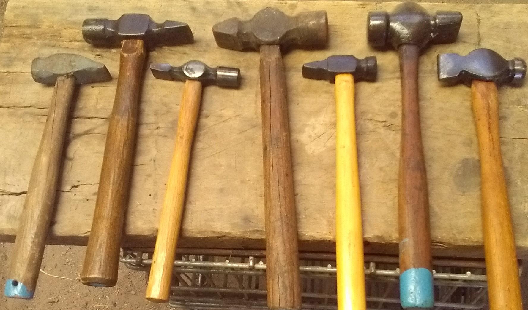

Maintenance:  grinding chips or mushrooming on hammers I have acquired. (24 oz Craftsman ballpeen for size.)
Finally someone asked me to post a picture of some of the Non-ball ballpeen hammers; so grapped a few that were to hand and...(both commercially made and hand made.)

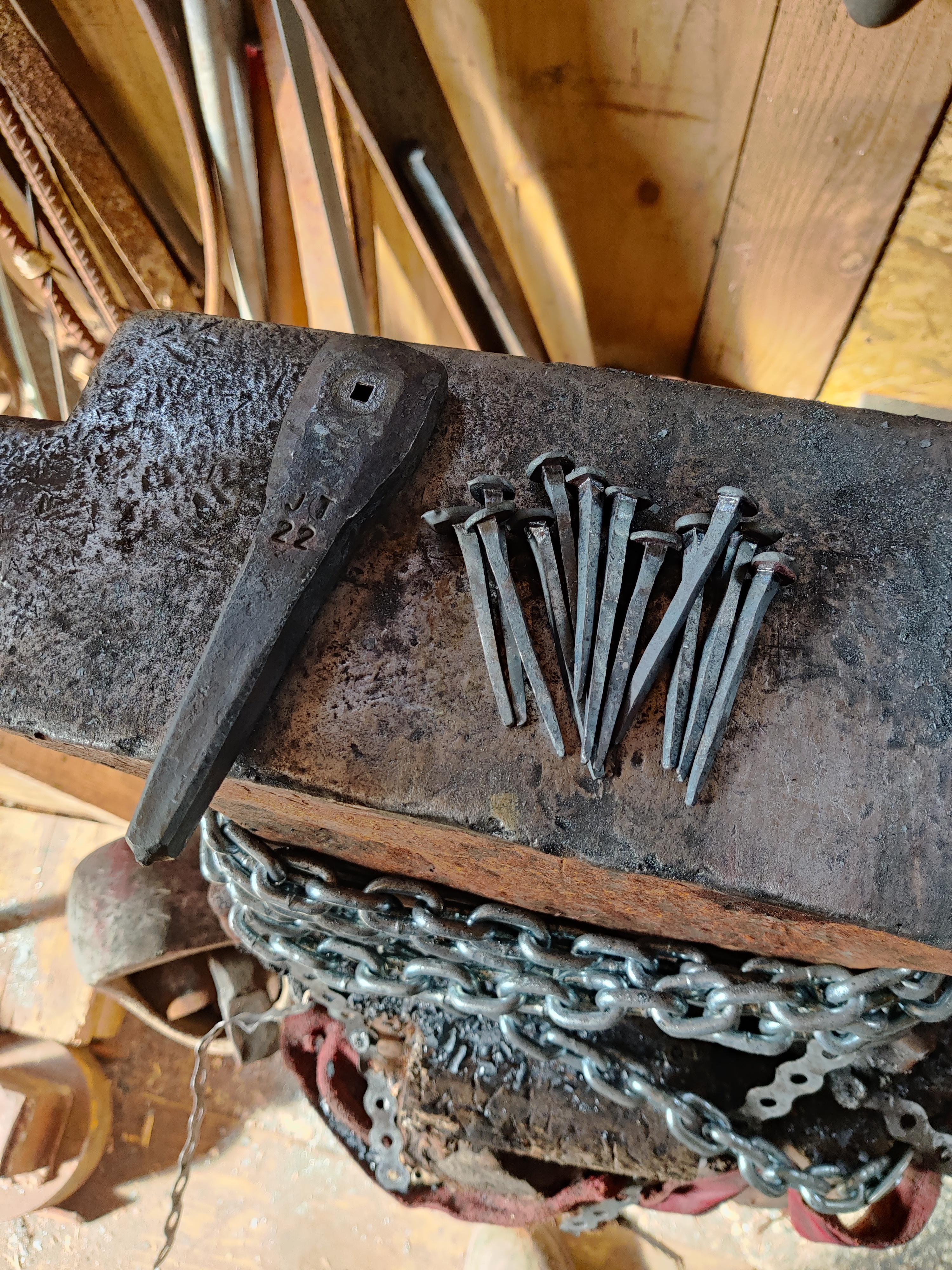

I also (finally) made a nail header today, this has been on the list for a long time, for I've been making a small amount of nails in the vise jaws. Forged from 27 mm hex 4140. I made a couple of nails for the  chest body, and still need a couple more for the bottom, as well as some smaller ones for the hinges and maybe the handles.

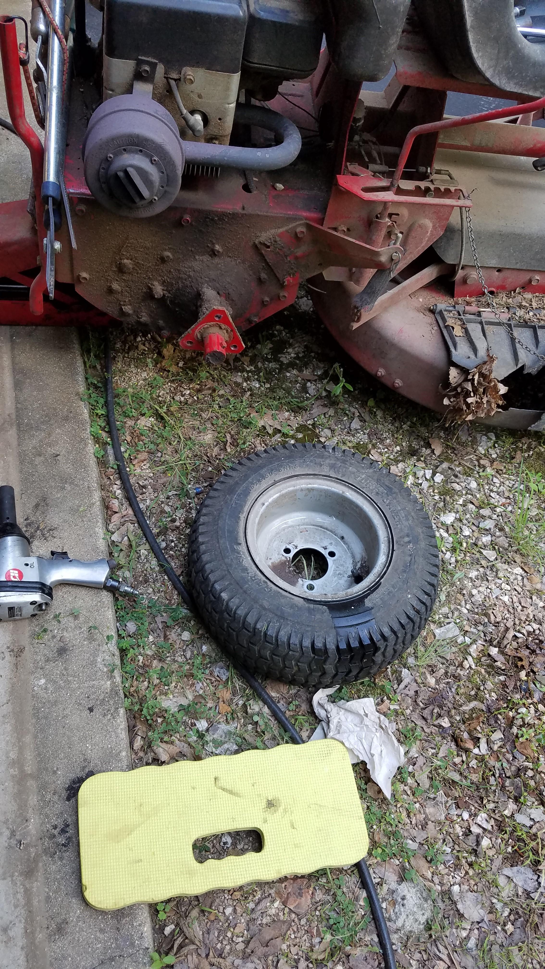

Planned to mow the yard but my Snapper mower said fix a flat first. Usual find the leak a little soapy water and bubbles will show up. Nope must be on the inside sidewall so I took the wheel off. No leak the inside. Humm check the valve stem and sure enough it was leaking so replaced it, no more leak.
Billy is not the only one who tears apart lawn mowers.:D
I like it! I started making one last fall an never finished lol

  Nice nail header Job.

Thanks guys, I was planning on drawing out the handle a lot more. But it was 4140, and alone it was not nice to draw out. Maybe I'll draw it out further once I have a striker coming over.
I have seen a nail header in the Mastermyr find book, which had a short handle as well, so let's call this one "historic" then ;).
