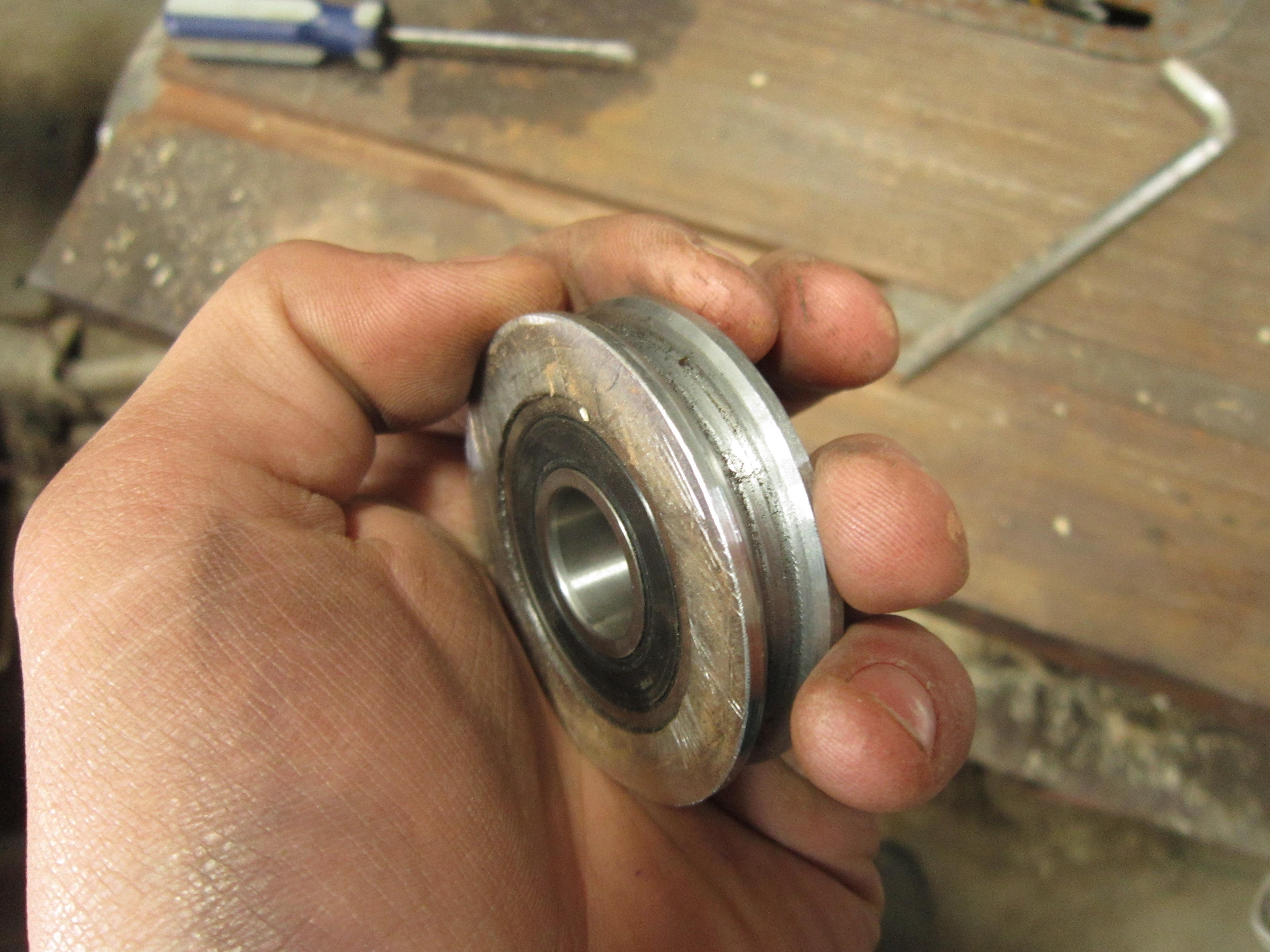

also spent quite a few hours Sunday aligning and then making  a pulley for a zipline bored out to have about .001-.002" friction fit with the bearing

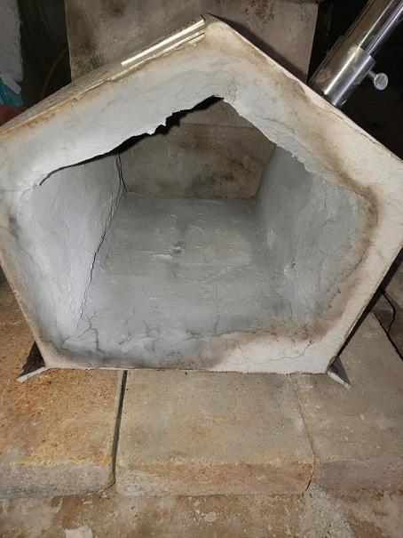

SO last week I started putting the Mr Volcano Forge Together.  Finished the last coat on Saturday.  Sunday the software installation went from 6 hour to 11 hours.. wasted my whole day.
BUUUUUUUUUTTTT.....
yesterday and today I have been curing the refractory.
I started as per instructions, 45 second - cool for 5min and added 5 sec to each burn.
My cooling cycles were probably more than 5 minutes, I was trying to do other things.  And each cooling there was little or no heat left in the forge when i fired them back up.
The ForgeCuring Photo is probably the 3rd firing, first two I did not think to close the back up.
Then the Forge-Curing2 is when i finally thought lets close up the front also.
I ran it this way until I finally called it quits and the result is Forge-Curing3
Close up of the inside. Forge-Curing 4
So what do you think?
look ok?

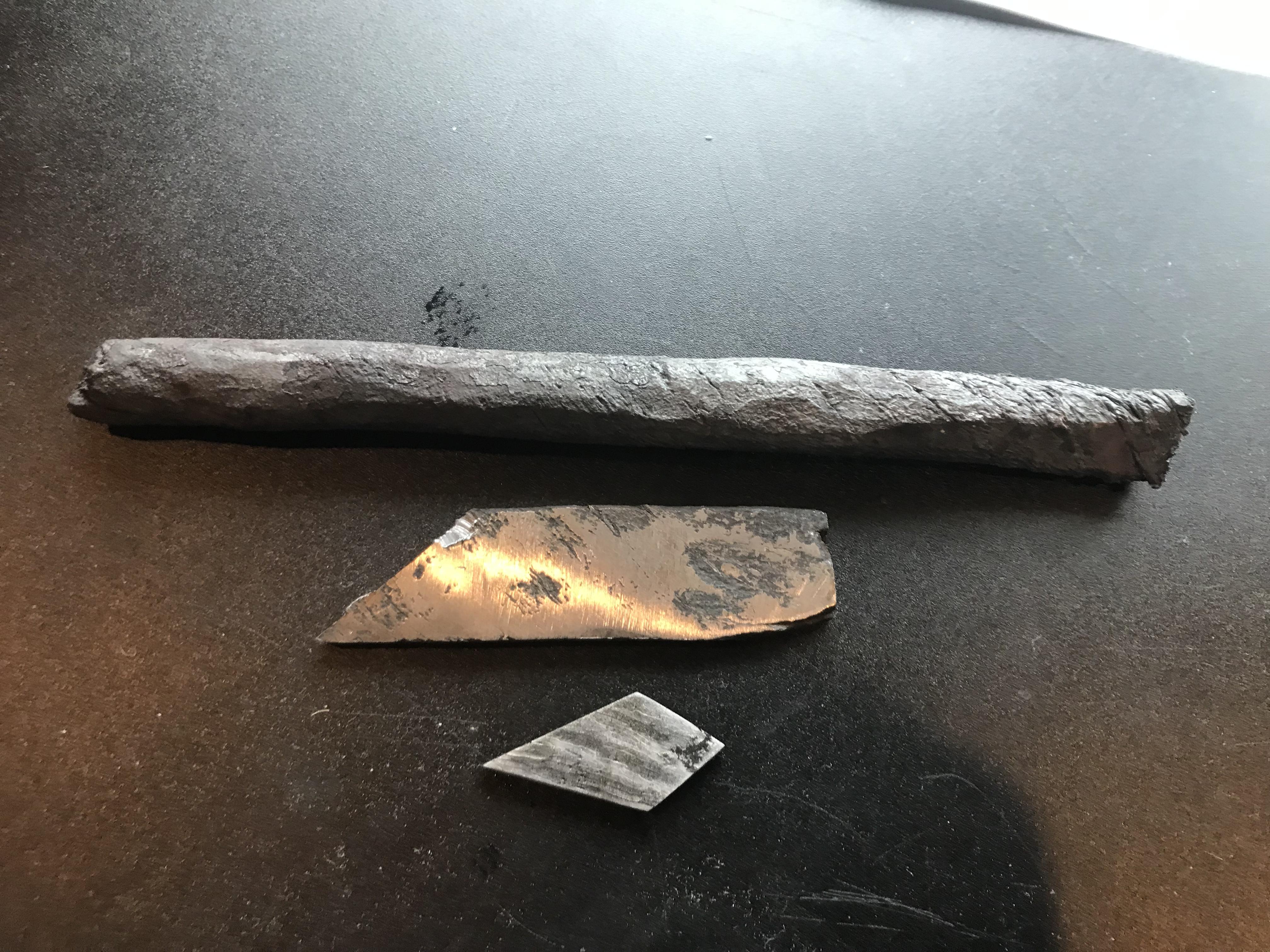

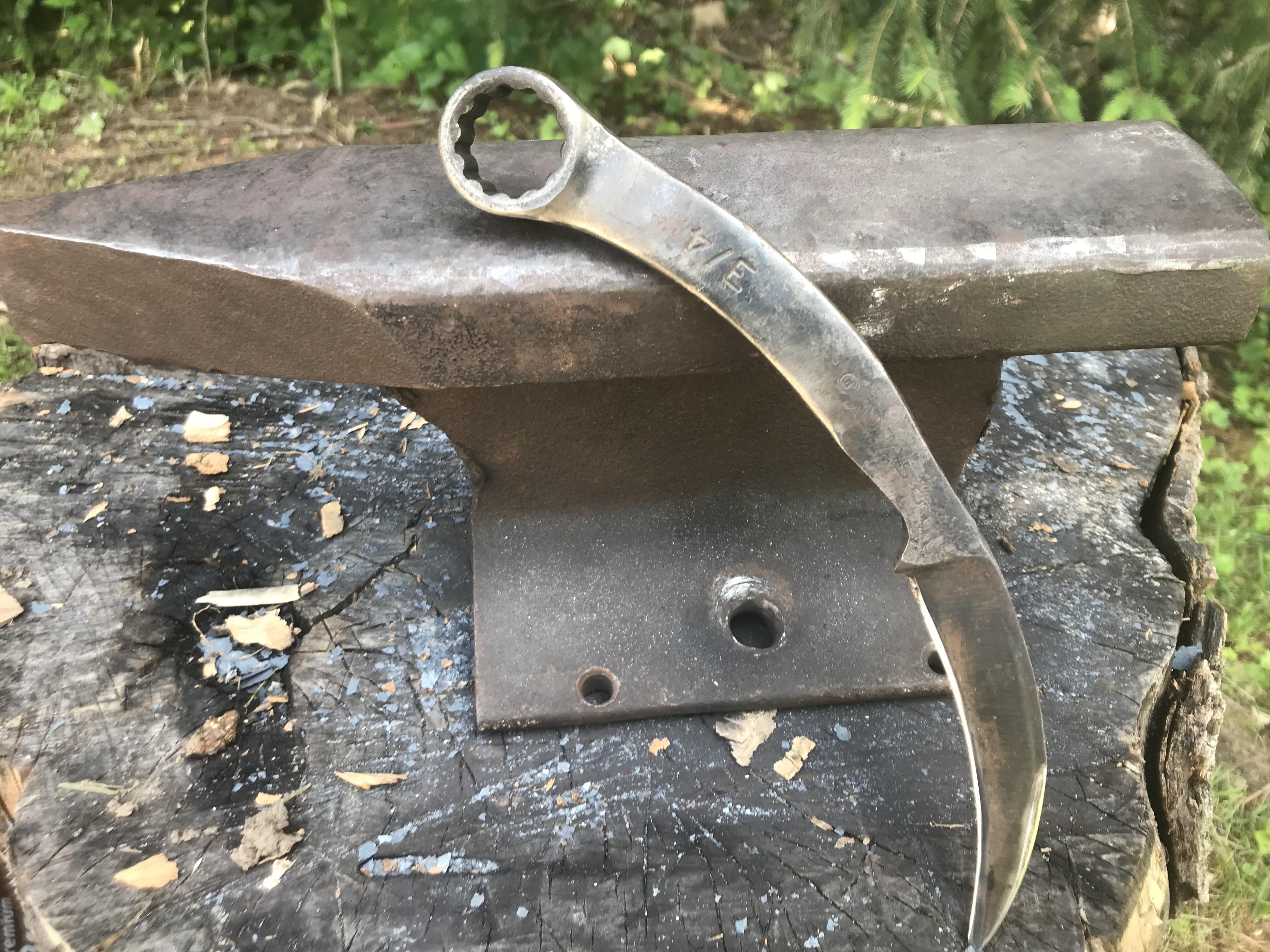

Then I had a friend ask if I could make a karambit. Here is my first try at it, with mediocre success. Forged from 3/4” wrench (friend is a mechanic). I think I’ll try again with a 1”, as the hole was a little small to get my index finger in.36E5869B-6E00-4742-9EA9-38D304987200.thumb.jpeg.886cfd47b1ae4a81cffdfe9f4871c564.jpeg Finally, I got my first real success at making cable Damascus. Originally 1.25” cable. Forged down to about .5” round. I’m really struggling to get a good etch on it. I’m trying 40% ferric for 18hrs, and that does something but not much. Maybe I just need to leave it longer?5EBD4243-4CF8-4330-841B-741A3456587C.thumb.jpeg.9e2a2624075f1ee8b0555933dc2a7a21.jpeg

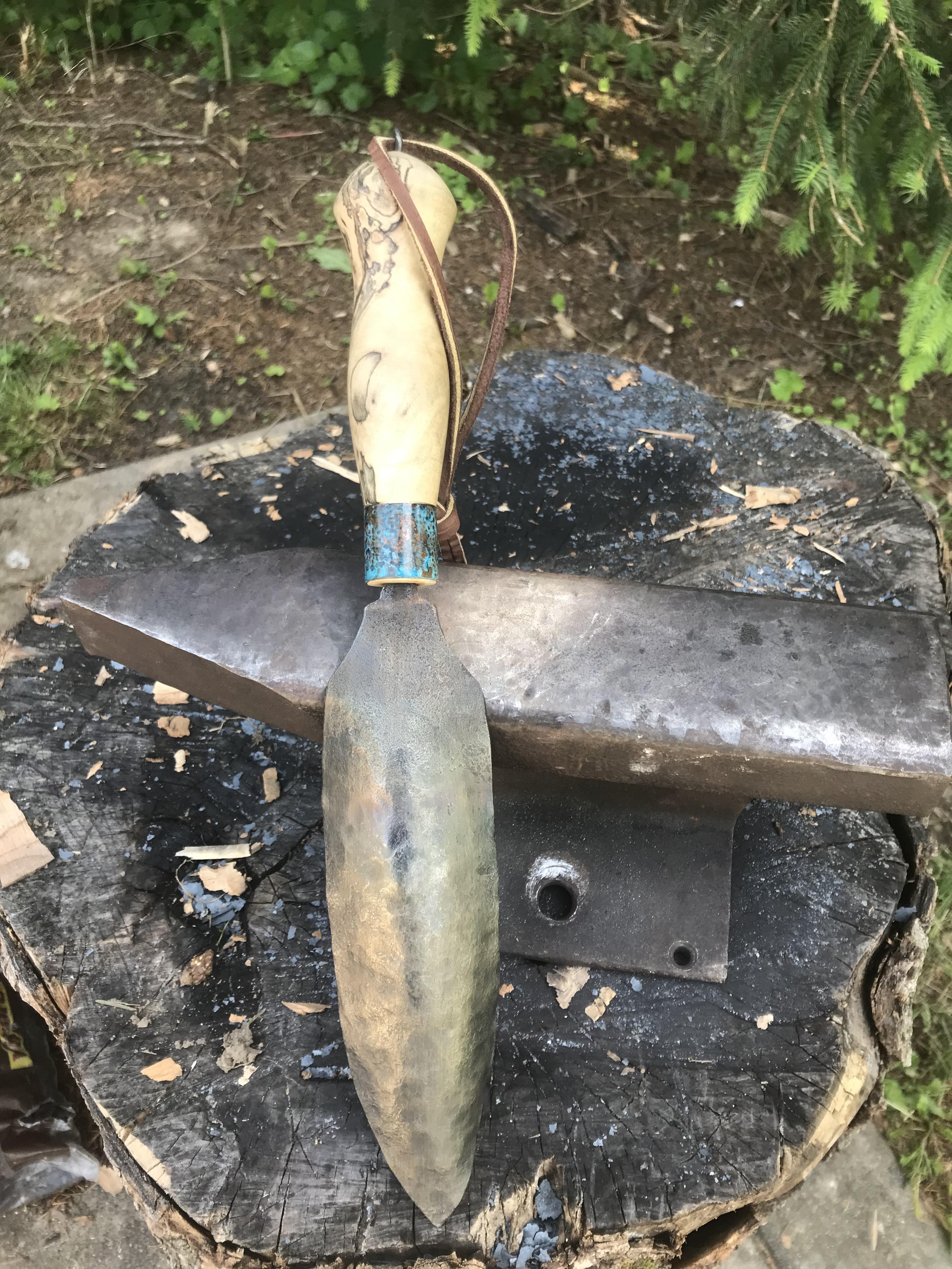

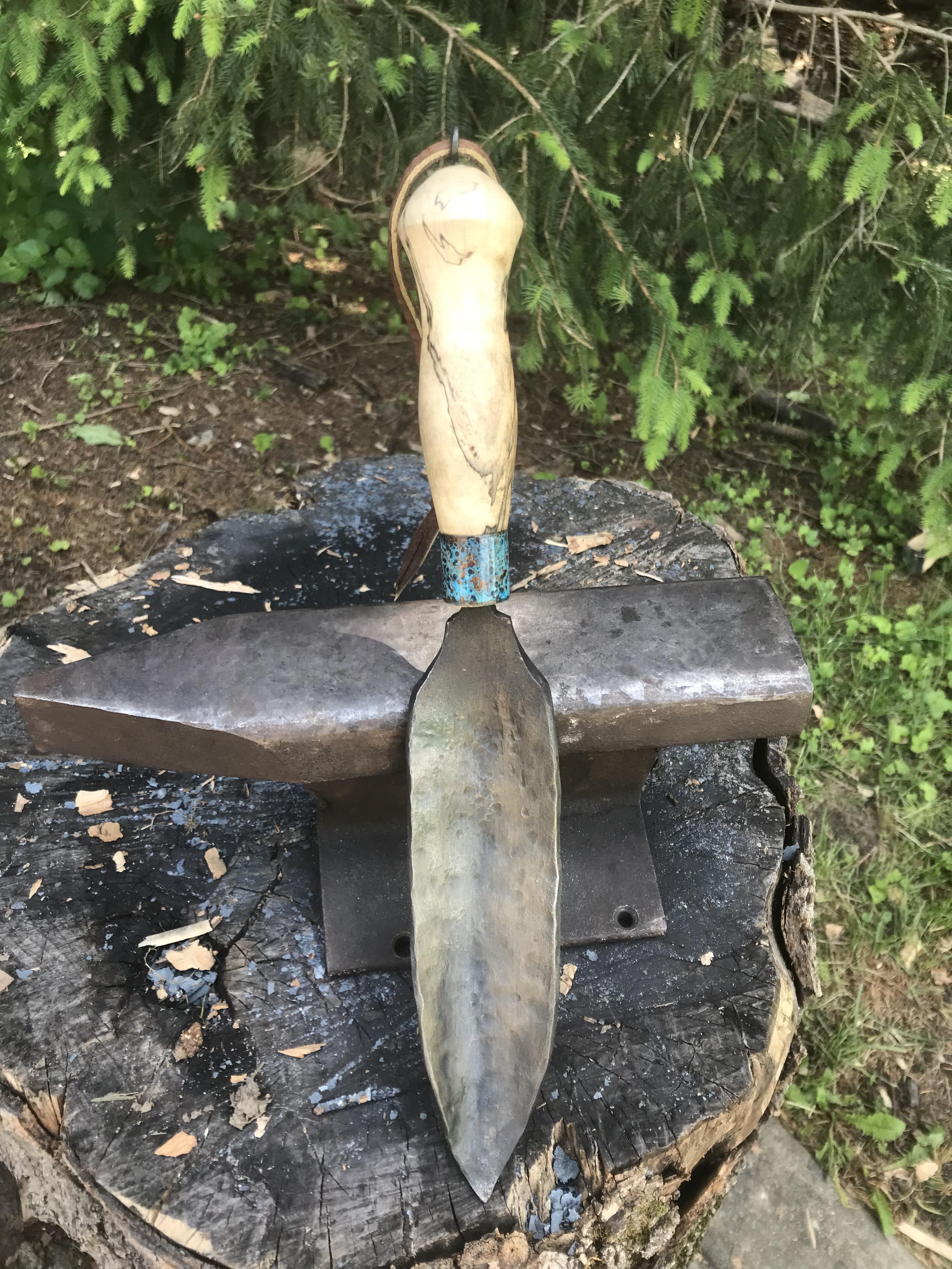

 Finally, my brother is in town, so over the past couple weeks we made my mother a garden trowel as a late Mother’s Day/birthday gift. This is probably my favorite project I’ve ever done. It was a big challenge, but here we are. The handle is a piece of wood turned spalted tamarind, with a forged and brass brushed blade. It's all finished off with a blue patinated copper collar and a leather loop. We started by trying to use a piece of 1.25” round bar and work it like a giant leaf, but that didn’t work so we turned to a leaf spring. It’s thicker than I want, but overall I’m very pleased.
Sorry for the super long post :)
