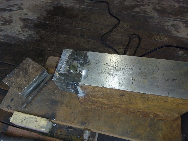

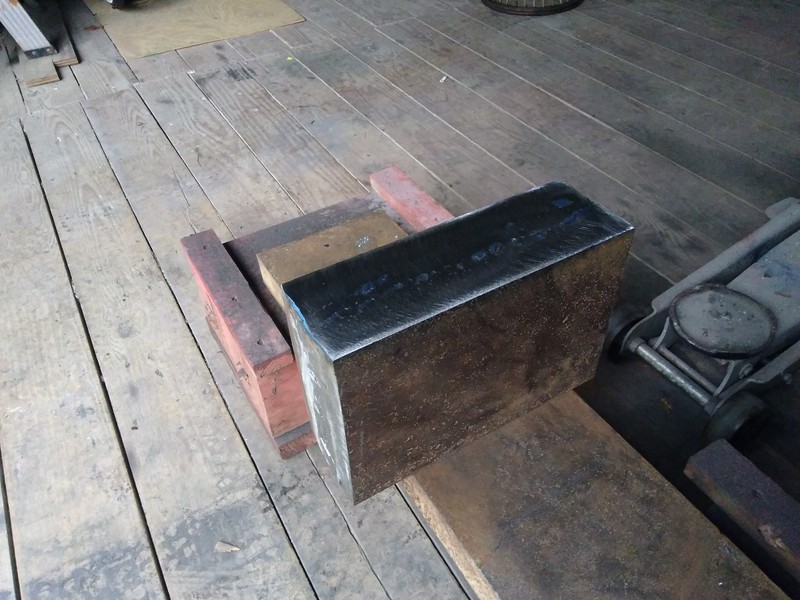

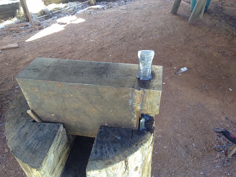

My anvil is a chunk of steel, 4"x8"x12".  I came into a need of a hardy hole, so I added one to it.  I welded a chunk of 2"x4"x4" to it, after I'd cut a 7/8" square slot in it. \

Blue rooster, I'd have suggested atleast severely V-ing/ notching it out for a more penetrating or atleast holding weld, but if it works, it works. Good job improvising. If it holds up no loss. If it does let go, deeply v out each welded edge. Then do a weld pass in the inner most V, and then build from there with zigzagging welds till it is flush.
Das, the parts were beveled at about 35 degrees or better. And about half the thickness of the metal.  Then welded, with 6013, and topped off with 7014.  It's been holding strong for 2 years now.  I've welded a few loader tracks, that 40 years later have yet to fail. (but they did wear out and get replaced but the weld is still there)

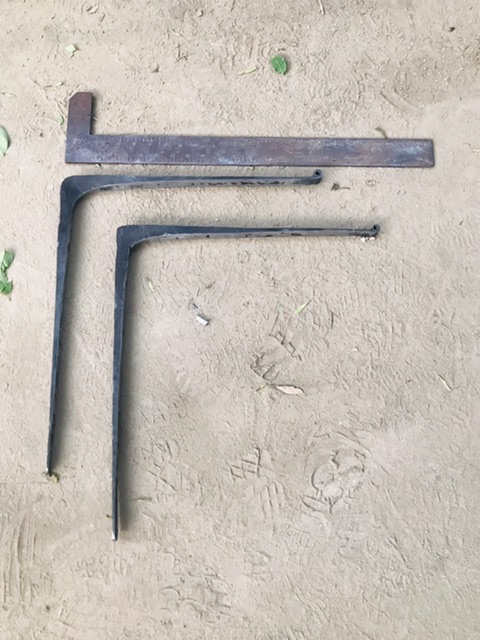

Past couple of sessions I’ve been working on some brackets to support the flue is my new forge (not done yet...). One is still a little wonky and needs some straightening. Then, I have to make the angle scroll for additional support and aesthetics.
Those look really nice, Goods.

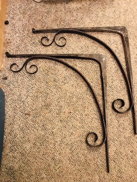

Today I went to a local smiths forge to visit and work on my flue brackets. Only have to weld the scrolls in and put some finish on. I’ll probably go with BLO.
Unfortunately I have to dig the welder out of the basement...

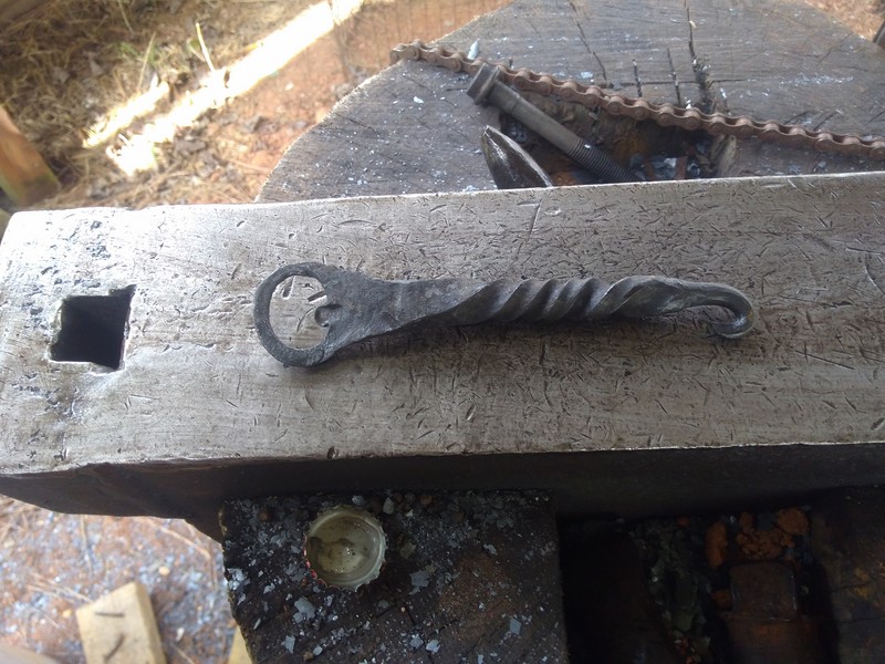

Got in the shop after work for the first time in over a week.  Just made some steak flippers, a bottle opener, and started in on a rat tail handeled knife,  and a large serving spoon.   I don't have high hopes for the spoon but how do you learn new stuff without trying?  I don't have a swage block so I'm going to try forming over the hardy hole and a piece of wood.  Anyway,  I'm having a cookout at the house Sunday and I need to make sure the shop looks good and somewhat organized so probably no more hammering this week.
