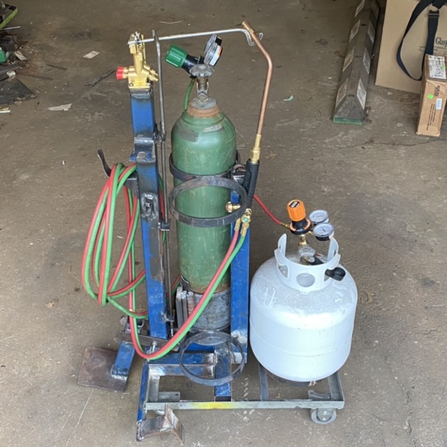

JHCC Posted May 22, 2021 Share Posted May 22, 2021 Finished the welding cart/torch stand. More details HERE. In the process, I also had occasion to cut a chunk of mild steel on the chop saw. It worked a LOT better than when I was cutting up the pickaxe. Quote Link to comment Share on other sites More sharing options...
