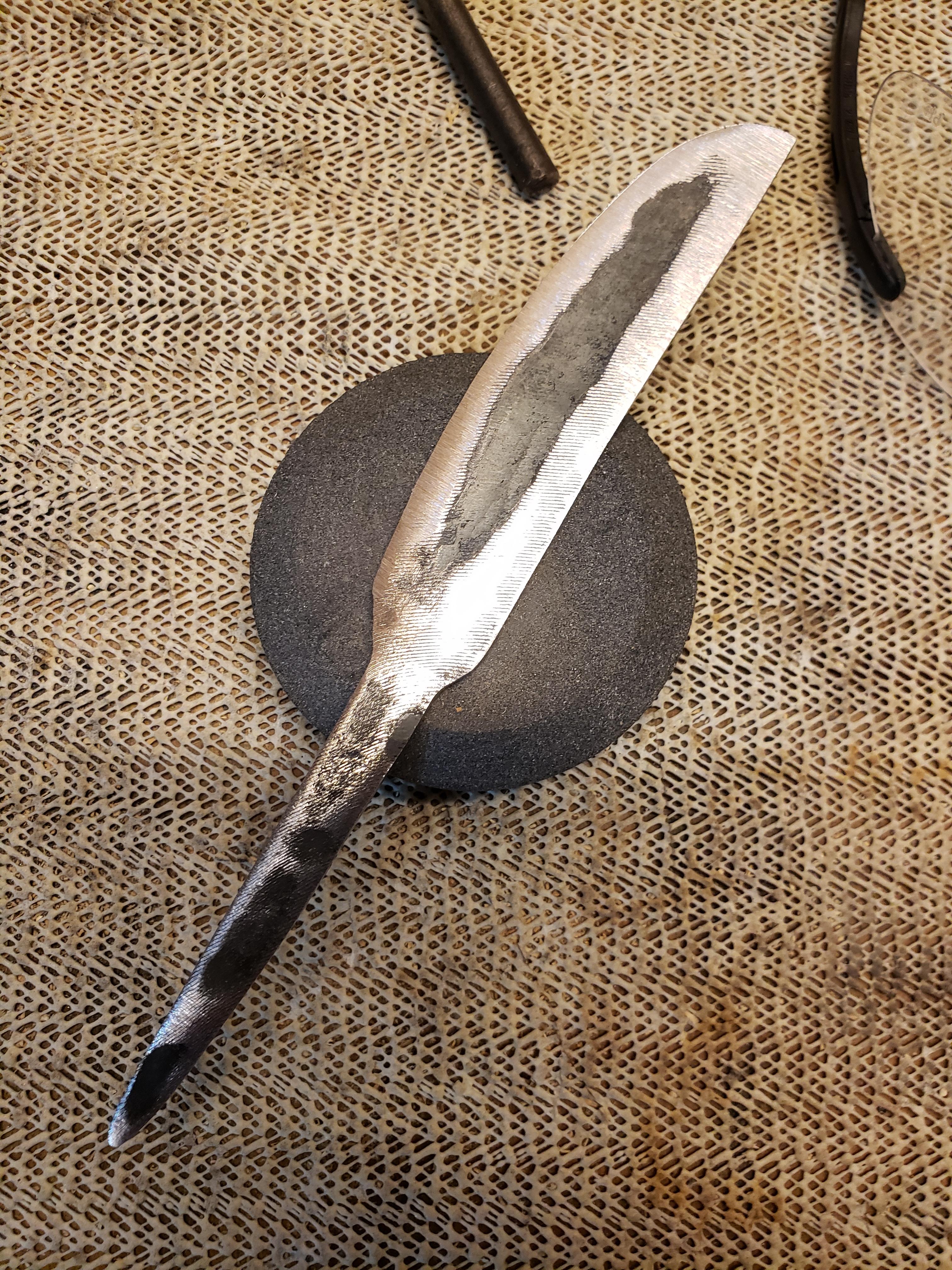

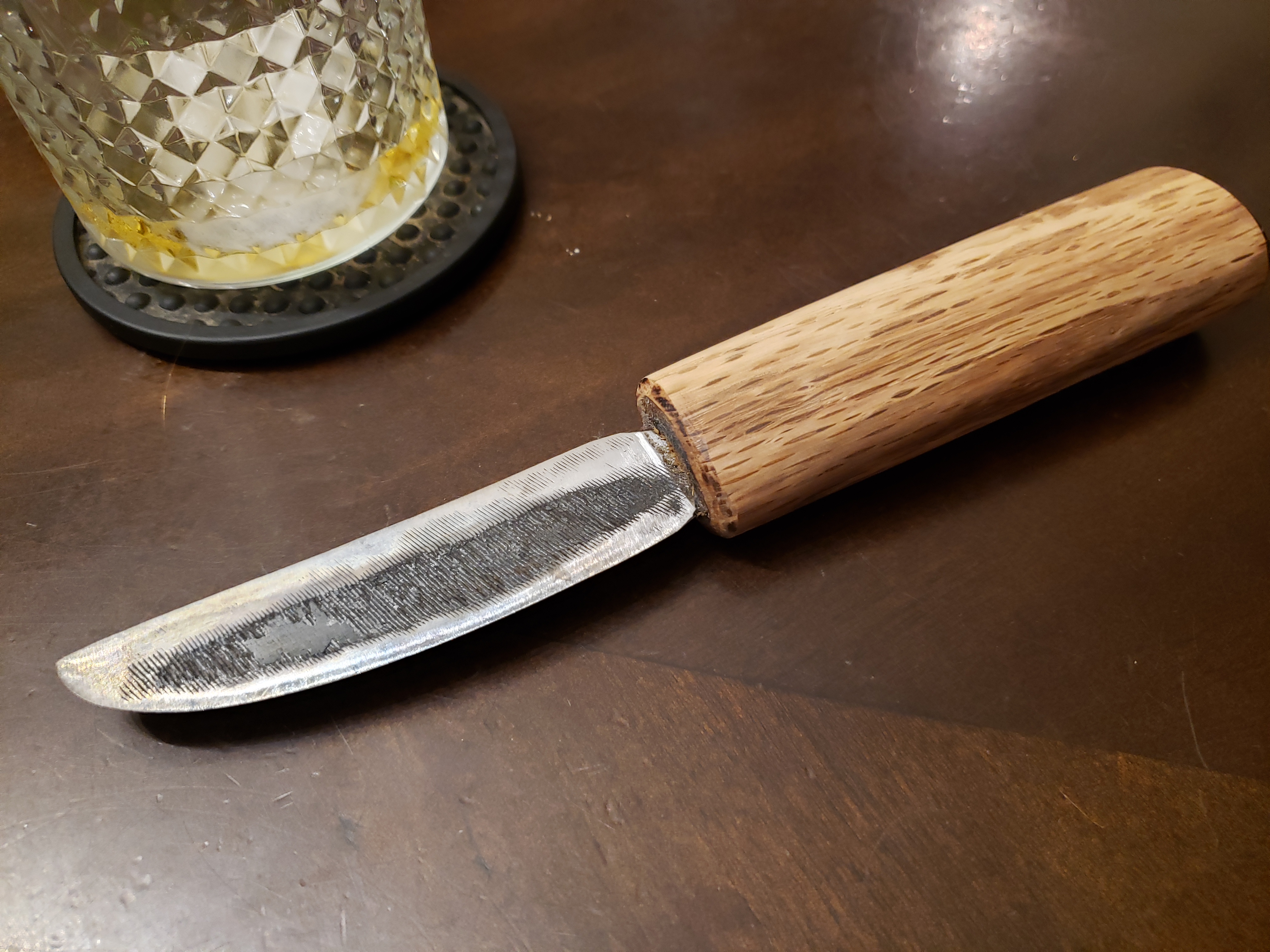

  4. Only a couple hours in the shop this weekend, but update on my first Yakut. I ate dinner with it tonight. Sliced through the Chicken Breast and Tomatoes like butter. Hardened/tempered, handled, basic sharpen. More work to do but getting there.

  8. Thanks Thomas I will go read up on the cutlers resin. And, I agree with you - I'm going tp pitch the Hickory handle and scabbard plan and go pick a nice piece of something "fancy" out of the bin. At first I took the stance of "it's my first one, probably won't turn out that great, no need to waste nice materials on it"... and then realized... if that was my plan, I would get what I feared.
  9. Thomas - I meant min - edited it while you were typing I think. Controlled heat, minimum char. Coat tang with an epoxy (ideally something natural, haven't decided yet), before installing tang in to handle and torching the protruding end for heading. That should keep any wiggle away. After watching one of my favorite blacksmith/bushcraft YouTube guys (Bertram - this guy and his videos are great) make his Yakut I've decided to do the burn fit handle, and the two piece leather wrapped scabbard. Hopefully I can work on it some more tonight.
  10. I was going to use the burn method for both handle and scabbard. For handle, drill a hole at about min thickness of the tang. Heat up tang. Burn it into the handle so that about 1/4 is peeking out on the butt end. (Remove and then Harden/Temper knife). Torch that 1/4" nubbin when knife reinstalled into handle. "Rivet" it down, or bend it over if heading it doesn't work. Finish handle and final sharpen knife. Scabbard - drill a series of small holes to match the width of the blade. Again burn it in bit by bit as far as it will go. Use pen chisel to carve out last 1/3. You are right, it will be hard to do with hickory but it looks like I have the right sized pen chisels so maybe not so bad. We'll see! I have seen it done before and I think I can make it work, even if it is my first time trying. I may, for the handle, drill one hole about the width of the tang. Take a wood dowel, cut it lengthwise, shave the halves to fit on either side of the tang down into the handle like wedges, friction/compression fit. If I go that route I may just make a two-piece scabbard and affix them together with glue and wrap the whole thing in leather. Decisions, decisions... Frosty - no, completely allowed. Thomas - are you referring to Shirisaya?
  11. Yes I got a little aggressive with the belt grinder... got caught up in the profiling and before I knew it, it was an edge. I'm going to knock it down a bit before I harden it for the reasons stated and I want to change the tip a bit anyway. I'm just surprised how dang sharp it is from just profiling it. Yes it is an old file George... scrap, dull file that I figured would be perfect stock for this. Nice convex side profiled, flat side with the fuller done. Thomas - I might go for a matching scabbard made from the same hammer handle so it just looks like a chunk of wood with some leather on it. Thanks guys!
  12. Little more work done on my first Yakut knife. I don't like how the shape of the tip ended up, but I can adjust it somewhat. Otherwise it's almost done. There is a scary sharp edge on it and I haven't even hardened/tempered/finish sharpened yet. Handle will be a spare piece of hammer handle I have stuck aside.
