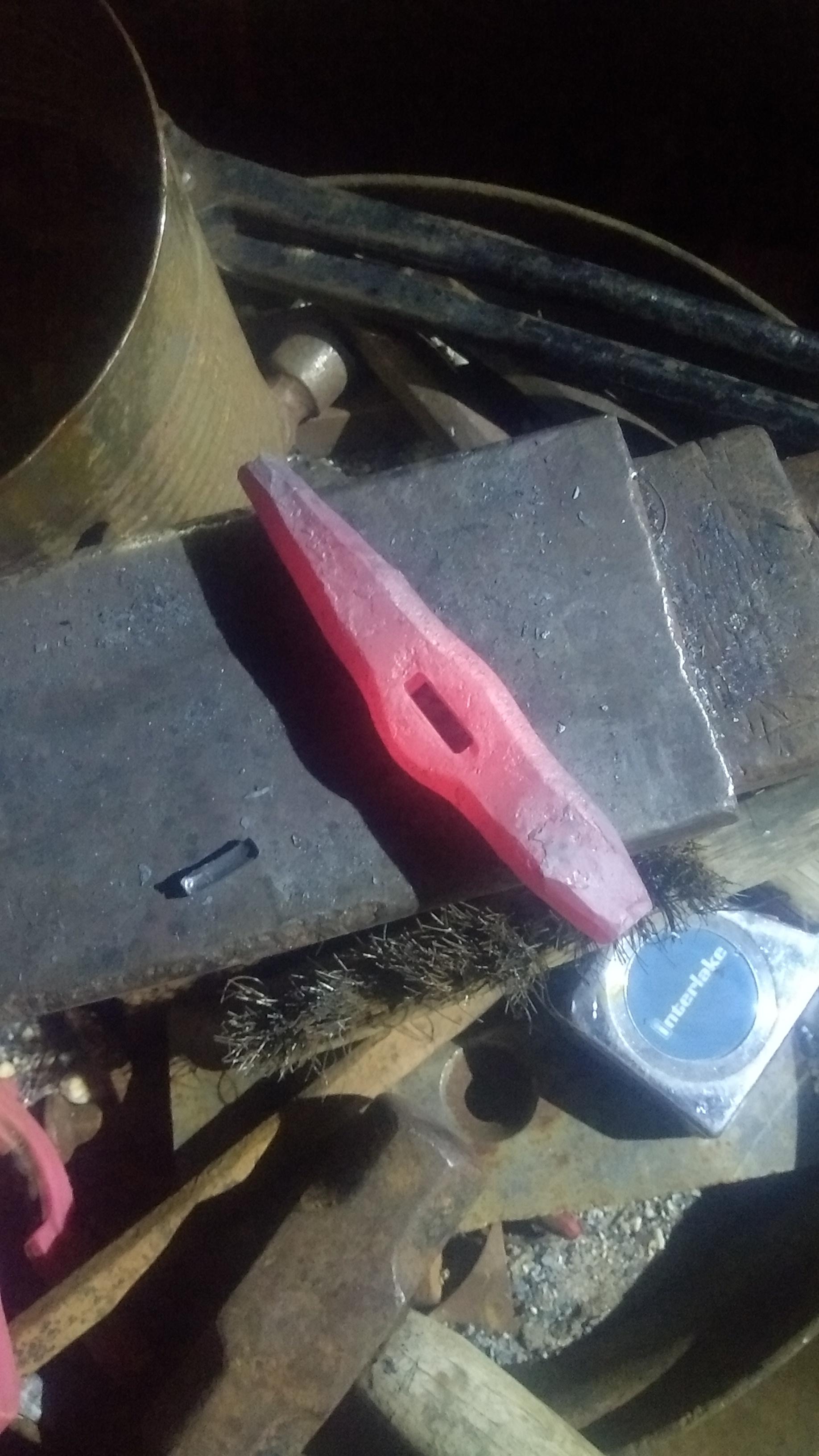

Shabumi Posted February 28, 2020 Share Posted February 28, 2020 Made my first handled tool from 4 inches of a coil spring I found on the road. The eye is a little off center but the plug was clean, which made me smile. I was able to center it better when drifting by cooling the thin side. Drifted round then hammered back to oval... Err rectangle with round ends. Still deciding on final end geometry, either an eye punch or an flat oval for sculpting Quote Link to comment Share on other sites More sharing options...
jlpservicesinc Posted February 28, 2020 Share Posted February 28, 2020 many find getting a clean plug to be part of the fun and very rewarding. Which is for sure is.. The temperature which the plug, or slug is sheared has a lot to do with how clean it comes out. It is not shearing because of the punch persay.. Its shearing because the metal that is supporting it at the bottom, is not distorting as much. its actually a pretty process much more like extrusion threw a die plate. Shabumi be careful about cooling off one side of spring steel to keep it centered.. You really want to minimize any kind of cooling while heated and then being worked on. It can lead to cracking. Mild steels not big deal. cool all you want.. Even 1040/45 there is a little wiggle room.. But ideally alloy and tools steels it should be avoided as a best practice. Quote Link to comment Share on other sites More sharing options...
pnut Posted February 28, 2020 Share Posted February 28, 2020 It took me quite a bit of trial and error on my own to figure out that trying to finish punching a hole while the stock is too hot doesn't work very well. I was a little slow figuring out too hot=stretch/distortion. A little cooler=a plug shearing cleanly. What's that saying? A hard learned lesson is a well learned lesson. Pnut Quote Link to comment Share on other sites More sharing options...

ThomasPowers Posted February 28, 2020 Share Posted February 28, 2020 For alloy steels with more Carbon I have sometimes found that differential heating works better than differential cooling: eg in my coal forge I will turn the piece so that the section I want hotter is towards the blast. In propane I may lay it on the hottest part of the forge. The idea is that everything is at working temp; just one section is a bit hotter than the other. Works better where an eye has been started as there is a gap to impeded heat transfer by conduction. For true mild---I have a dipper to hand! Quote Link to comment Share on other sites More sharing options...
JHCC Posted February 28, 2020 Share Posted February 28, 2020 Another option is to put the thin side down on the anvil for a moment before you start drifting. The anvil will suck a bit of the heat out of that side faster than the air will cool the thick side, giving you a slight differential cooling without too much risk of quench cracking. Then turn your piece upright and forge. Quote Link to comment Share on other sites More sharing options...

Shabumi Posted February 28, 2020 Share Posted February 28, 2020 Thanks for the pointers everyone, I'll keep them in mind next time. I was semi aware of the no water rule with alloys, but I thought I could get away with it as I wasn't quenching till cool to the touch. What I did was cool just the outside of the thin section with water and let it pull the heat from the inside of the eye until it was 1 shade lower than the fat side, from yellow-orange to orange-yellow. Didn't have any obvious problems this time, but I will avoid the water in the future. Great work as always JLP, and that's a nice tp holder DSW, I really like the brass coating look. Virusds, that sure looks more functional than the only knife I've tried to make. Good work Quote Link to comment Share on other sites More sharing options...

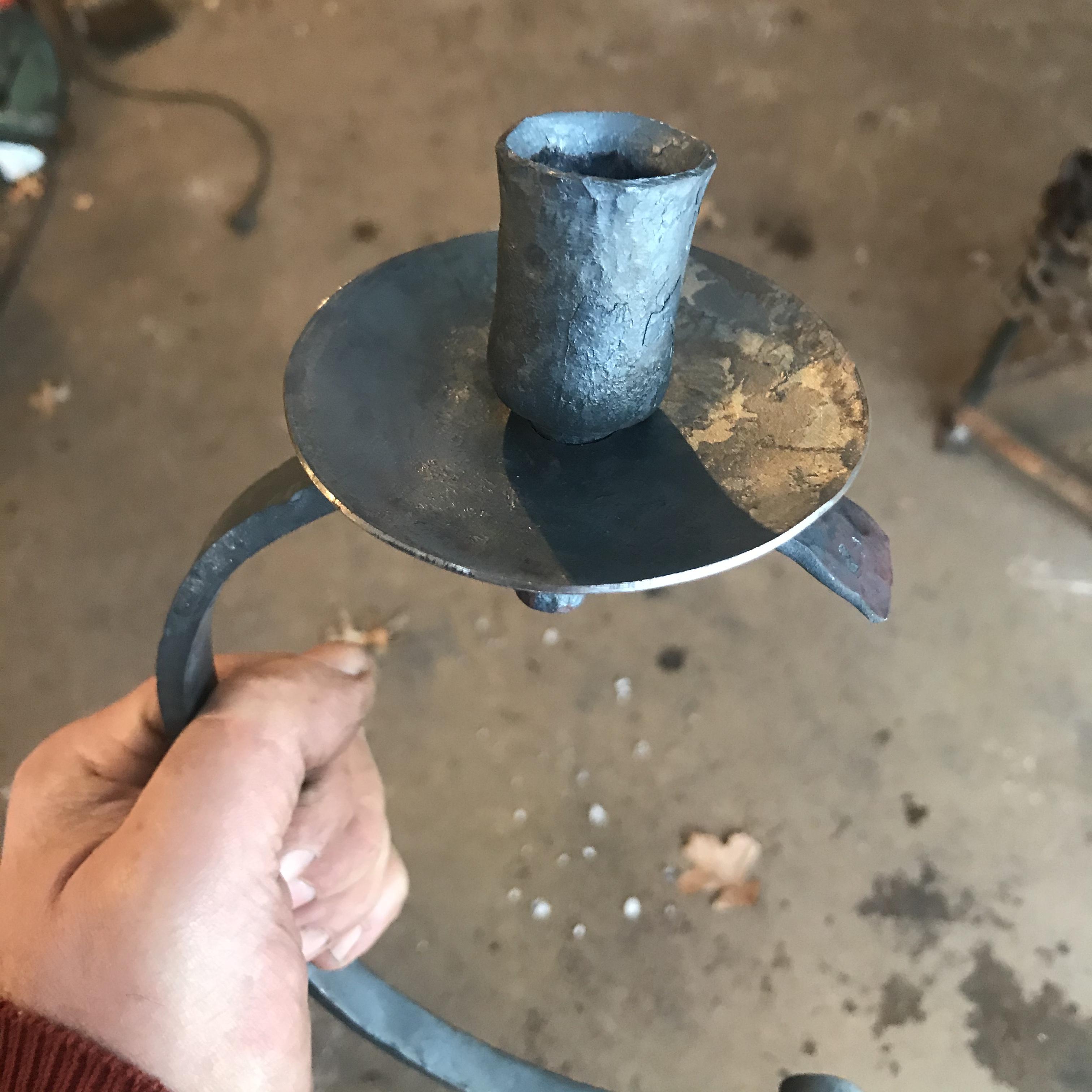

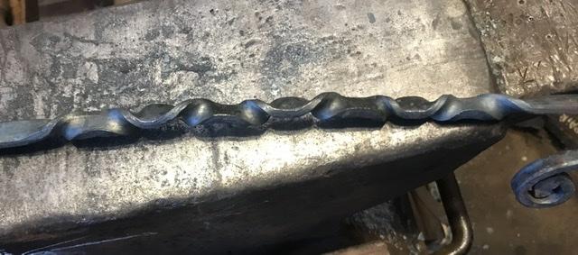

JHCC Posted March 1, 2020 Share Posted March 1, 2020 More work on the candelabra. Slitted and drifted the mounting holes for the candle cups on the arms, which will look basically like this: Practically all the forging is done now, and the parts are ready for wire brushing, welding, grinding, and painting: (The two flat pieces in the back are stock that I might use for collars in the center. Haven’t yet made up my mind.) Also made a new handle for my dipper, since the old one was too clunky. And tried out a new (to me) twist. Did some prep for a couple of other projects, but that was way too uninteresting to photograph. Quote Link to comment Share on other sites More sharing options...

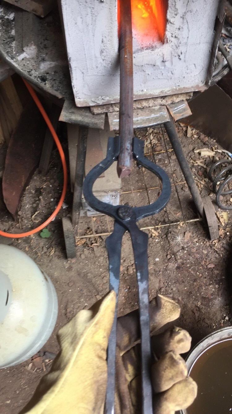

Shoshinjoe Posted March 1, 2020 Share Posted March 1, 2020 On February 28, 2020 at 11:33 AM, jlpservicesinc said: So, last sunday did a demo for the Connecticut Blacksmith Guild.. 1hr to forge a thumblatch.. So, much gabbing put the preform and 1 cusp done. So, monday was really nice and finished the latch up. Absolutely gorgeous I’ve had a productive few days. An enormous forged cleaver named Jötunn, a pair of bolt jaw tongs and a set of scissors. the cleaver was a custom order. Is shaving sharp and able to chop through a 2x4 in about 6-7 cuts. the bolt jaw tongs are for 20mm square and round stock(roughly 3/4”) the scissors did not turn out to well unfortunately. I hammered the rivet to firmly and the blades are not moving smoothly and require two hands to open them. They do however cut quite well. Quote Link to comment Share on other sites More sharing options...
