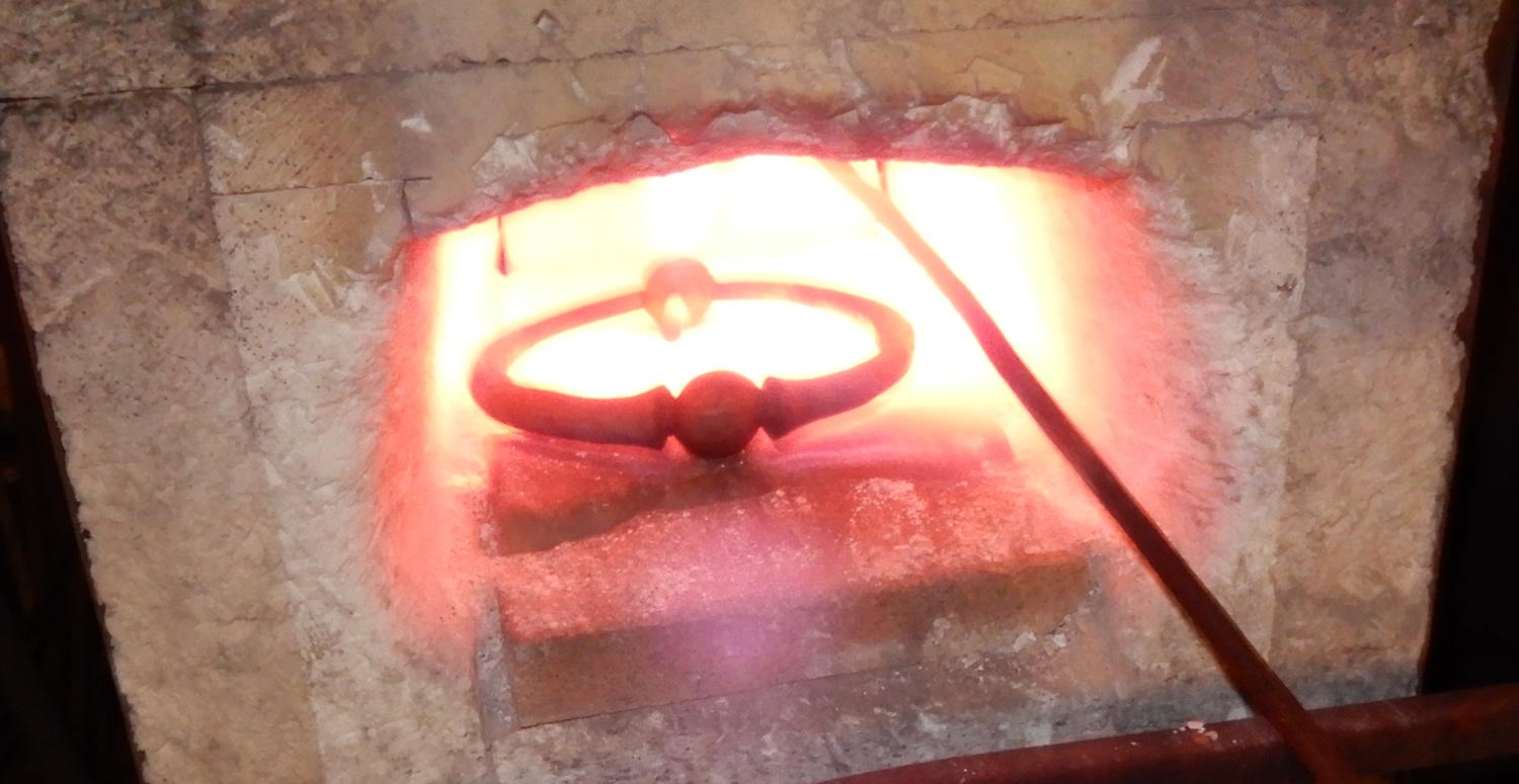

rocketman_k Posted December 23, 2018 Share Posted December 23, 2018 Finished an ammonite paperweight, took a pic. of it in the fire just so I could make a joke about fossil fuels! Also made some prototype components for curtain rail finials, the need more curves and some texture on the leaves. Quote Link to comment Share on other sites More sharing options...

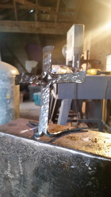

Cannon Cocker Posted December 24, 2018 Share Posted December 24, 2018 I made this self standing split cross for my mother in law. It's my first one. I'm pretty pleased with the way it turned out. Quote Link to comment Share on other sites More sharing options...

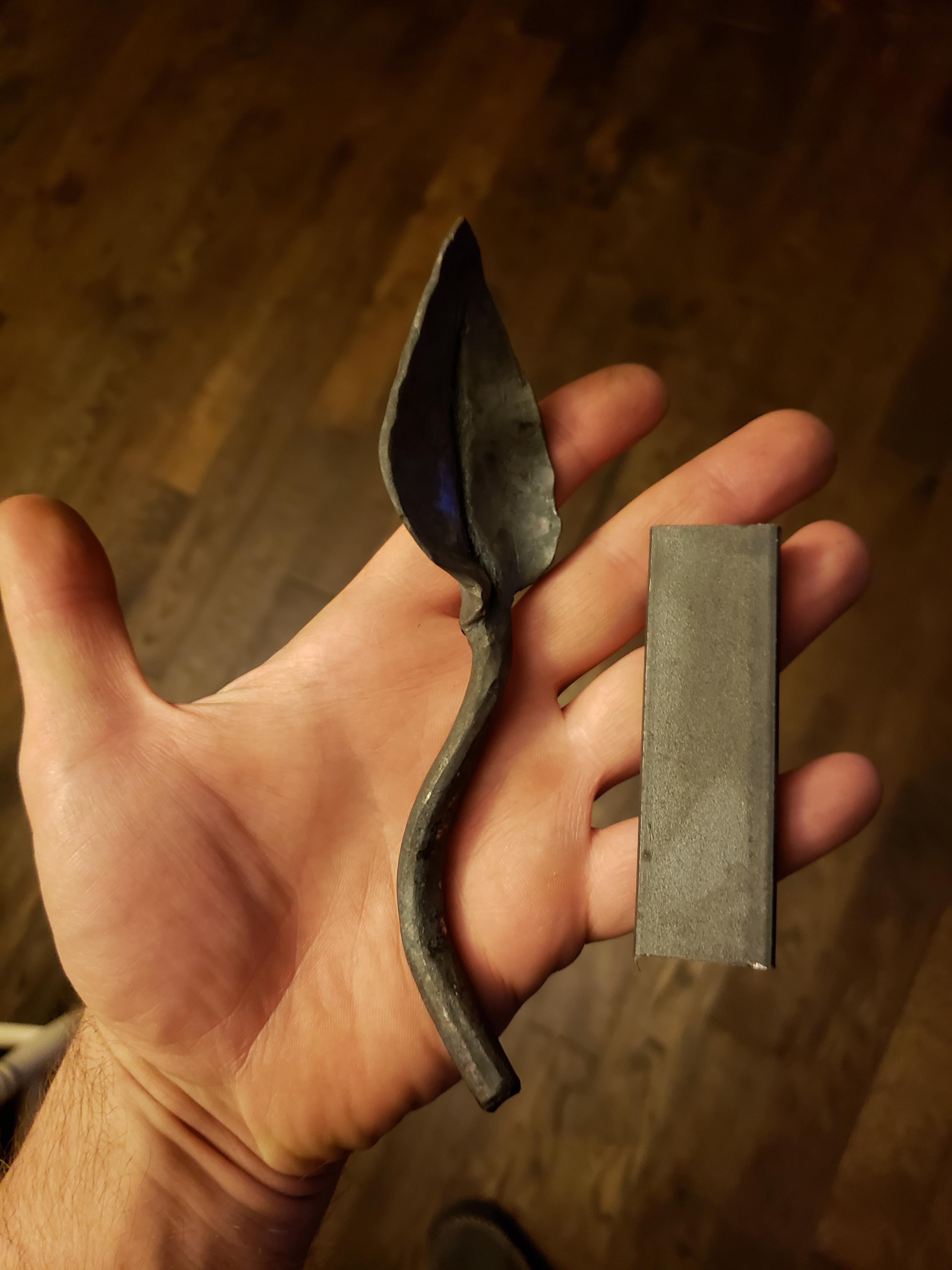

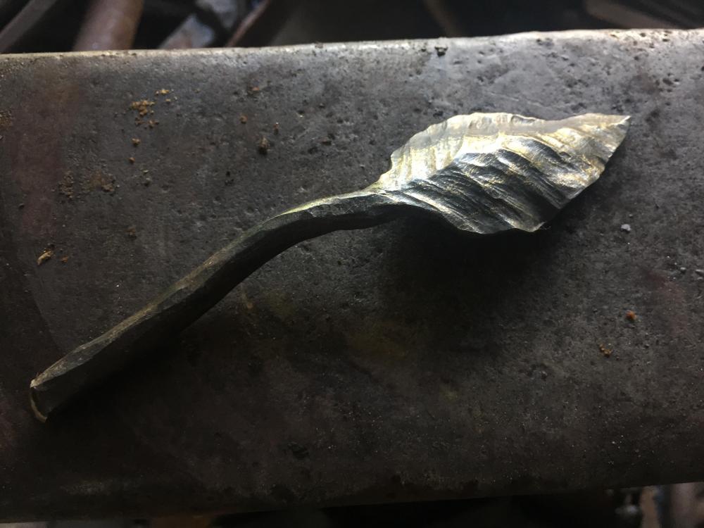

psacustomcreations Posted December 24, 2018 Share Posted December 24, 2018 I decided to try to texture the leaves from my previous post. I also made two more to keep practicing. I have several chisels and punches which could have been used. I gave it a shot with them but kept dropping the leaf after each strike. Since these previous leave were already bent into a shape that did not help me being able to hold them while striking. I then went to the straight peen hammer. I am not a fan of the straight lines from chisels on some leaves that I seem to see from a lot of beginners, but I still suck at making them so that may be part of it. As usual, comments or suggestions for improvement are encouraged. Quote Link to comment Share on other sites More sharing options...

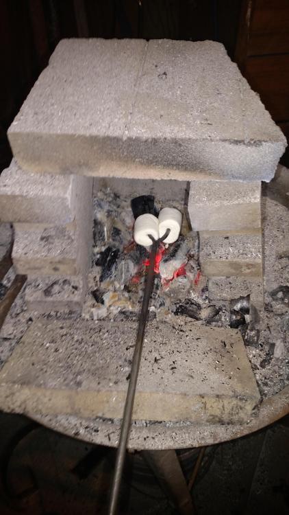

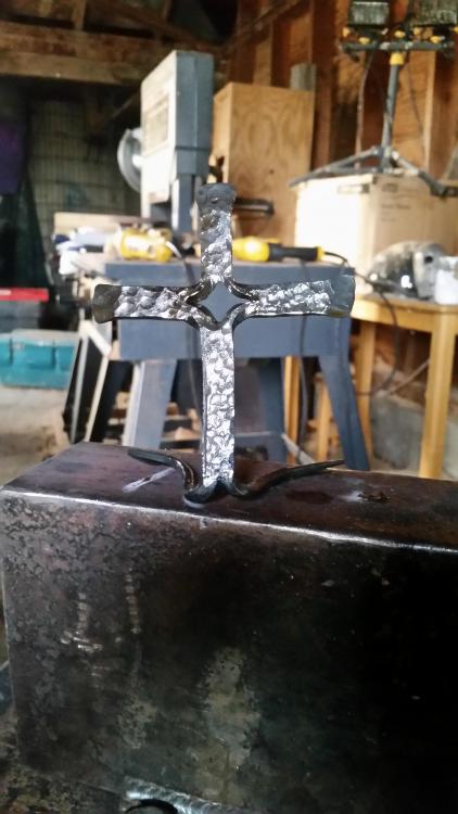

Glenn II Posted December 24, 2018 Share Posted December 24, 2018 Had a busy day in the shop today. Had some good helpers too. Since Christmas hasn't come yet, they weren't wearing their aprons yet. My son made a toasting fork from 1/4"(6mm) mild round stock. He's 10, but did the bending and twisting of the handle. He ran the blower while I hot cut the fork tines and dressed them. We had fun working together to make it, but I believe he liked the testing process more! My daughter made her first split cross from 1/2"(12mm) mild square stock. I helped hold it while she did the hammering. The texture was hammered in with a fencing pliers. Finished the day with my first leaf on a wall hook made from 1/2"(12mm) mild square stock. Quote Link to comment Share on other sites More sharing options...

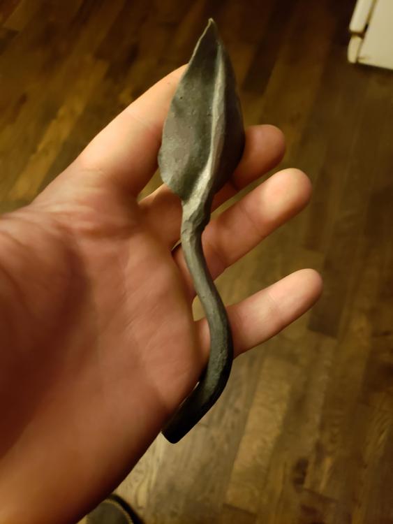

bryson489 Posted December 24, 2018 Share Posted December 24, 2018 Got a little time to try a new leaf style today. It's cool how a simple fold completely changes the look. Quote Link to comment Share on other sites More sharing options...

JHCC Posted December 24, 2018 Share Posted December 24, 2018 13 hours ago, psacustomcreations said: I decided to try to texture the leaves from my previous post. I also made two more to keep practicing. I have several chisels and punches which could have been used. I gave it a shot with them but kept dropping the leaf after each strike. Since these previous leave were already bent into a shape that did not help me being able to hold them while striking. I then went to the straight peen hammer. I am not a fan of the straight lines from chisels on some leaves that I seem to see from a lot of beginners, but I still suck at making them so that may be part of it. As usual, comments or suggestions for improvement are encouraged. When I make leaves, I bevel both edges of the top surface to create the center ridge and the thin edges, and then I texture the surface with a cross- or straight-peen hammer as the mood strikes me. Then I flip it over and hammer out the “belly” with a ball-peen hammer over a divot in a wooden stump. A little tweaking, and we’re done. Quote Link to comment Share on other sites More sharing options...

psacustomcreations Posted December 24, 2018 Share Posted December 24, 2018 Thanks for the tip JHCC. I will give that a shot. I have plenty of wood to make a dishing bowl. Another project added to the list to make. Quote Link to comment Share on other sites More sharing options...
JHCC Posted December 24, 2018 Share Posted December 24, 2018 Just hammer in the beginning of a divot with a ball-peen hammer; working hot leaves in that spot will burn it in the rest of the way. Quote Link to comment Share on other sites More sharing options...
