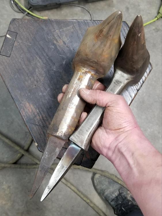

ThomasPowers Posted December 18, 2018 Share Posted December 18, 2018 Still draw filing the face of my latest stake anvil; where did those blasted apprentices sneak off to? See if I don't put power in the shop and replace them all with Eeeletterick motors! Link to comment Share on other sites More sharing options...

ThomasPowers Posted December 18, 2018 Share Posted December 18, 2018 I got into a good rocking motion letting my body put the ooomph into the rasp while my arms were mainly straight and locked with my shoulders putting the downward pressure on the rasp. (I'm using an old horseshoer's rasp, coarse side, on the annealed face made from a sledge hammer head.) I think there will be a blip or two left from tooling when I was trying to make the top face planar with my screw press. It will be a great eating fork anvil. Once I get the top to a suitable surface I will need to heat treat it. Needs a lot more quenchent than I generally work with. Link to comment Share on other sites More sharing options...

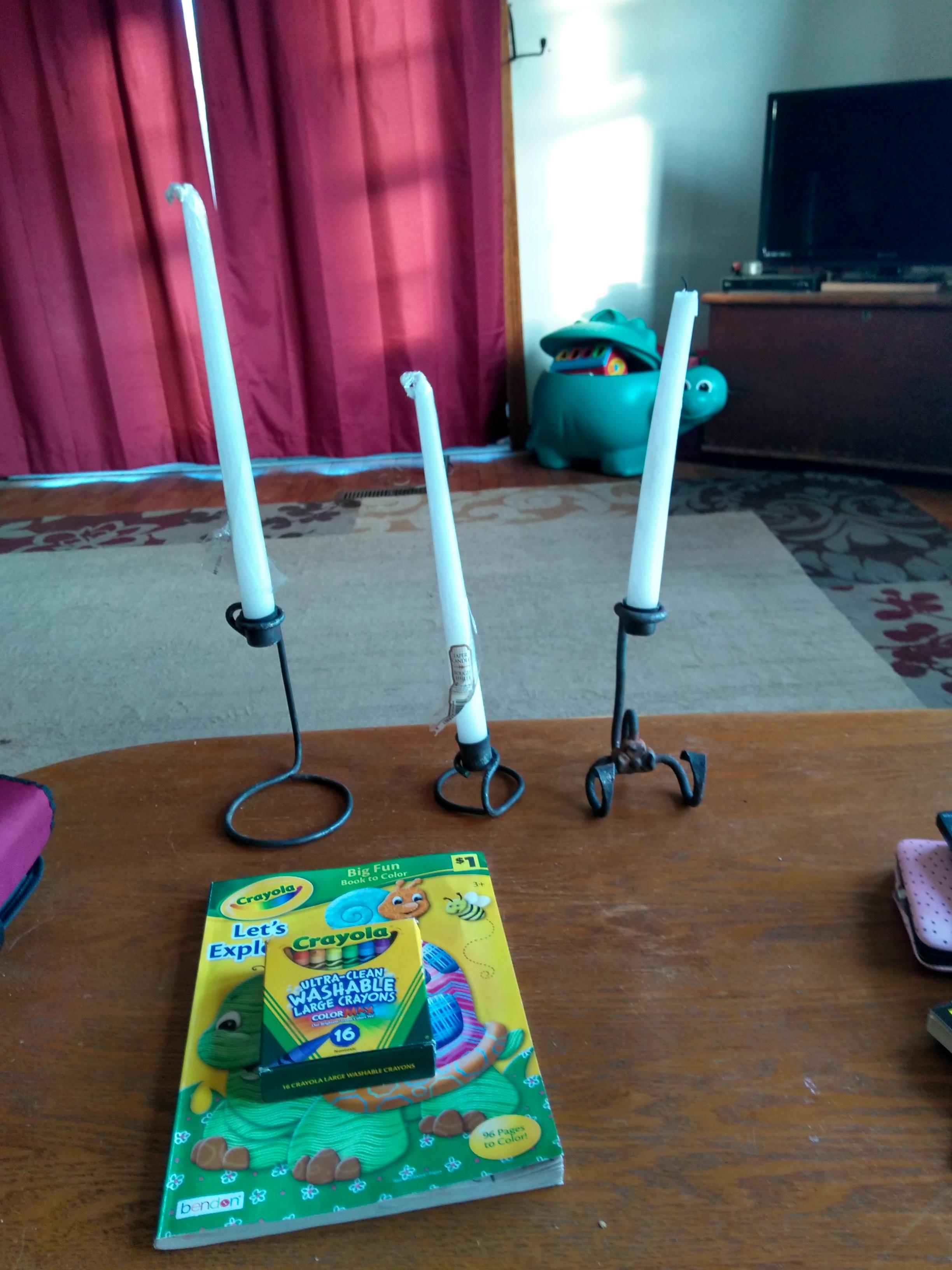

Laynne Posted December 18, 2018 Share Posted December 18, 2018 Tried my hand at some candle holders. Lots of room for improvement but I'm reasonably pleased with how they turned out. I learned quite a bit and will go about it a little differently next time. Link to comment Share on other sites More sharing options...

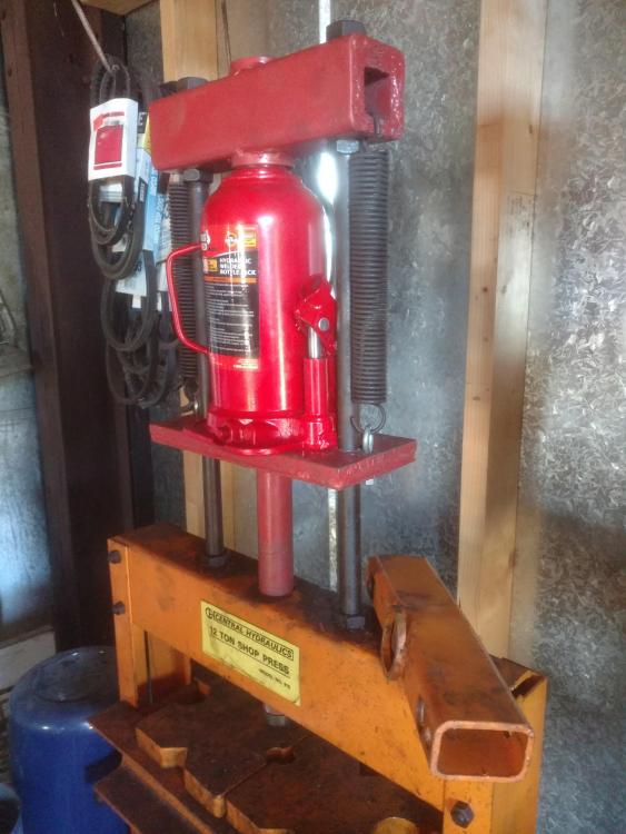

Reeltree Posted December 18, 2018 Share Posted December 18, 2018 Beefed up an old 12 ton shop press to 20 tons. 3 pieces of heavy wall square stock welded into them selfs keeping one side completely flat onto each other. Added a 1/2" plate on the bottom. Link to comment Share on other sites More sharing options...
Daswulf Posted December 18, 2018 Share Posted December 18, 2018 Laynne, Just in time for a little candle light coloring. a good addition might be wax catch trays/ pans unless you are using non-drip or dripless candles. Realtree, just be cautious of the bolts and the rest of the frame on that press. Link to comment Share on other sites More sharing options...
Laynne Posted December 18, 2018 Share Posted December 18, 2018 The grandkids had been to the house, I didn't realize the crayons were in the picture. That is funny. I've not done any flat ware, so trays or pans are on the list. Daswulf, your creativity astounds me. It's like "why didn't I think of that." Thanks for the inspiration. Link to comment Share on other sites More sharing options...
