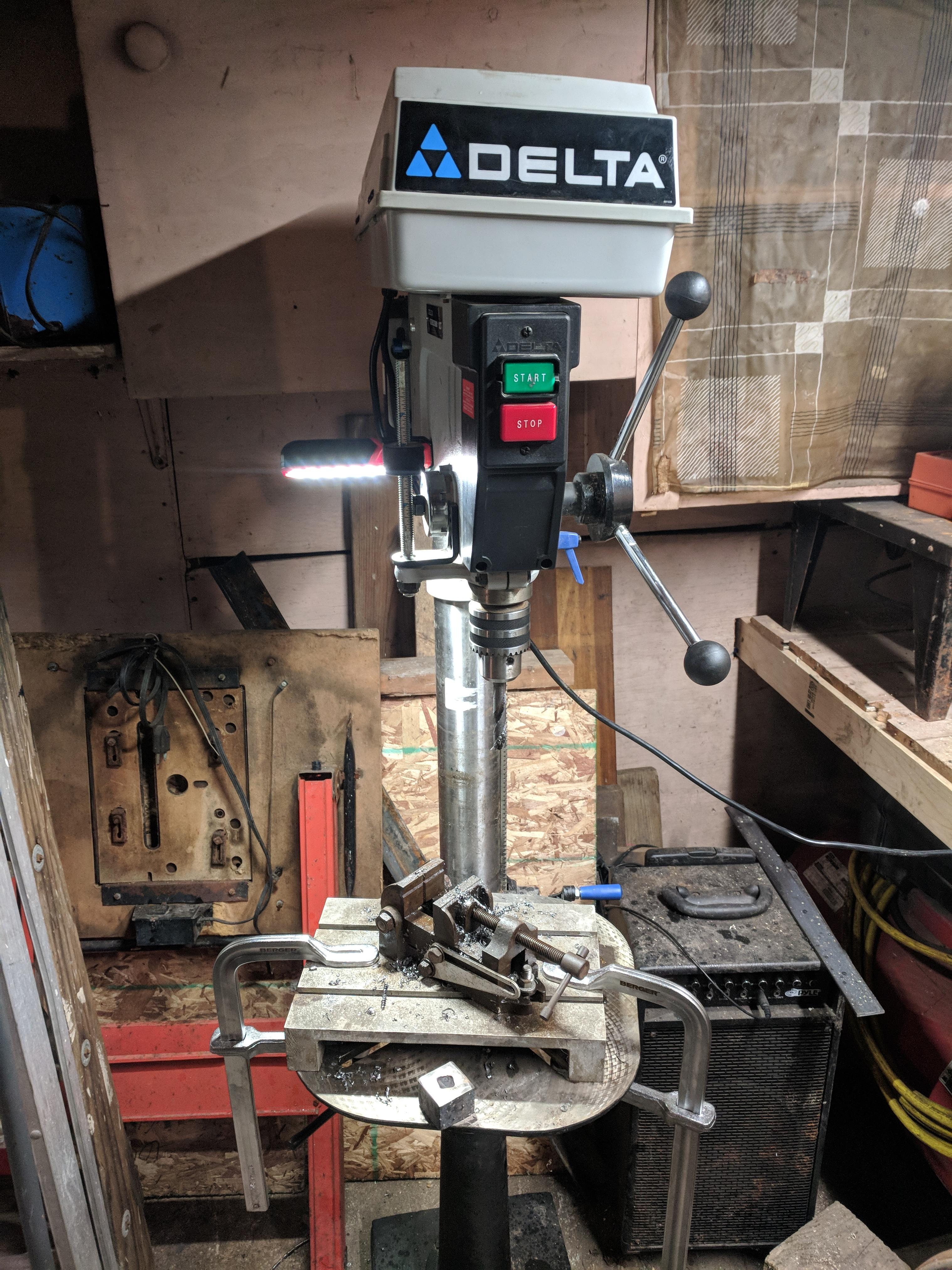

Helena Posted January 5, 2019 Share Posted January 5, 2019 I finally broke down and bought a real drill press. And I tried my hand at making some rivet setting tools. IDK if I'm doing this right... Quote Link to comment Share on other sites More sharing options...

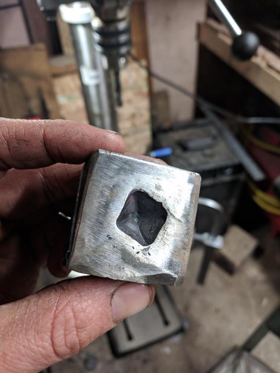

SLAG Posted January 5, 2019 Share Posted January 5, 2019 Ms. Helena, What kind of rivets do you plan on setting? The concave depressions look kind of large. I'd love to see a picture of them. Nice drill. Congratulations. Regards, SLAG. Quote Link to comment Share on other sites More sharing options...
Helena Posted January 5, 2019 Share Posted January 5, 2019 These will be half inch diameter rivets I want to use for an umbrella stand I'm working on for my mom. Still haven't made a successful rivet yet... But I've got a few tries in. I'll try again tomorrow and when I get something that looks more like a rivet I'll send some pics. Quote Link to comment Share on other sites More sharing options...
jlpservicesinc Posted January 5, 2019 Share Posted January 5, 2019 Helena did you try the method in the video? If you don't mind, what seems to happen? Making the rivet or setting the head on the backside? Quote Link to comment Share on other sites More sharing options...
Helena Posted January 5, 2019 Share Posted January 5, 2019 It seems to work, I just am not hitting accurately enough in the center during the making of the rivet. I'm going to be using the fancy heading tool for only one side, as I want a flat rivet head on the inside of the stand. I don't know what video you're referring to though. Quote Link to comment Share on other sites More sharing options...
jlpservicesinc Posted January 5, 2019 Share Posted January 5, 2019 it's a bolt making video though making rivets these same 3 methods can be used.. Quote Link to comment Share on other sites More sharing options...

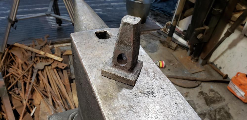

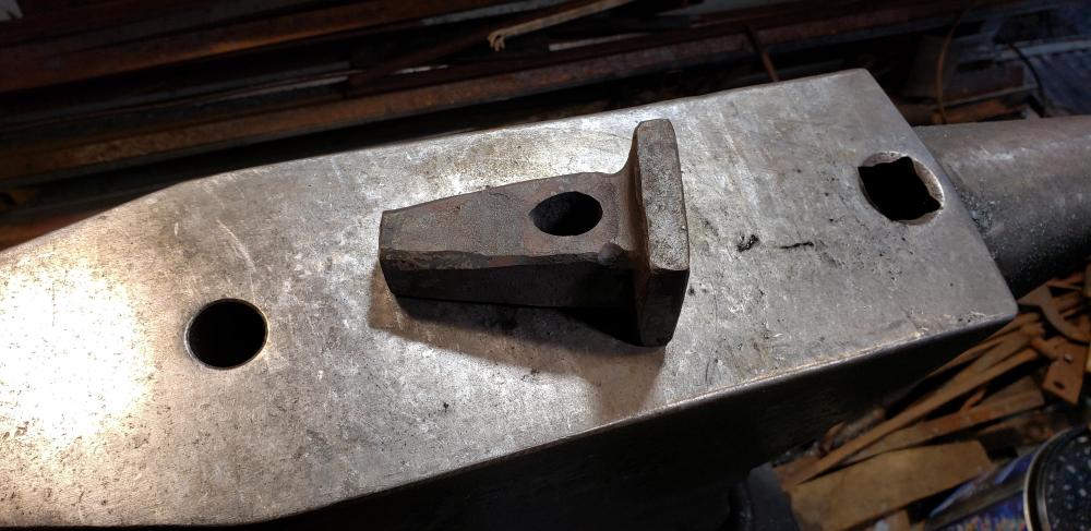

JHCC Posted January 6, 2019 Share Posted January 6, 2019 Finish-ground and handled the flatter: And while I was at it, threw a handle onto a nice old cross-peen head I picked up on my rambles for $2.50. (This is after grinding some nasty chips out of the edges of the face.) Quote Link to comment Share on other sites More sharing options...
jlpservicesinc Posted January 6, 2019 Share Posted January 6, 2019 JHCC perfect.. This is what i made today.. For a "How to" video and the flatter for the other thread.. started life as 1" SQ Quote Link to comment Share on other sites More sharing options...
JHCC Posted January 6, 2019 Share Posted January 6, 2019 Thanks, Jennifer. Here’s another view of the business end. Quote Link to comment Share on other sites More sharing options...
jlpservicesinc Posted January 6, 2019 Share Posted January 6, 2019 Mudman, your welcome. and Thank you.. . There are a whole bunch of the videos and usually make about 5 a year or so.. Usually based on a forging problem someone is having and then make the "How to" video to address the problem.. The main ones are 2D but also there are 3d or VR (virtual reality) for head gear.. There are so Many " regular videos with 100 different ones on basics.. I keep trying to find Niche areas that might interest someone.. Not sure if my methodology or format is on the mark as the channel is moving at a snails pace. But, I make videos i would like to watch so I guess that is the point.. Thanks again.. JHCC that is a nice, chunky flatter.. Face have a slight crown to it? Quote Link to comment Share on other sites More sharing options...

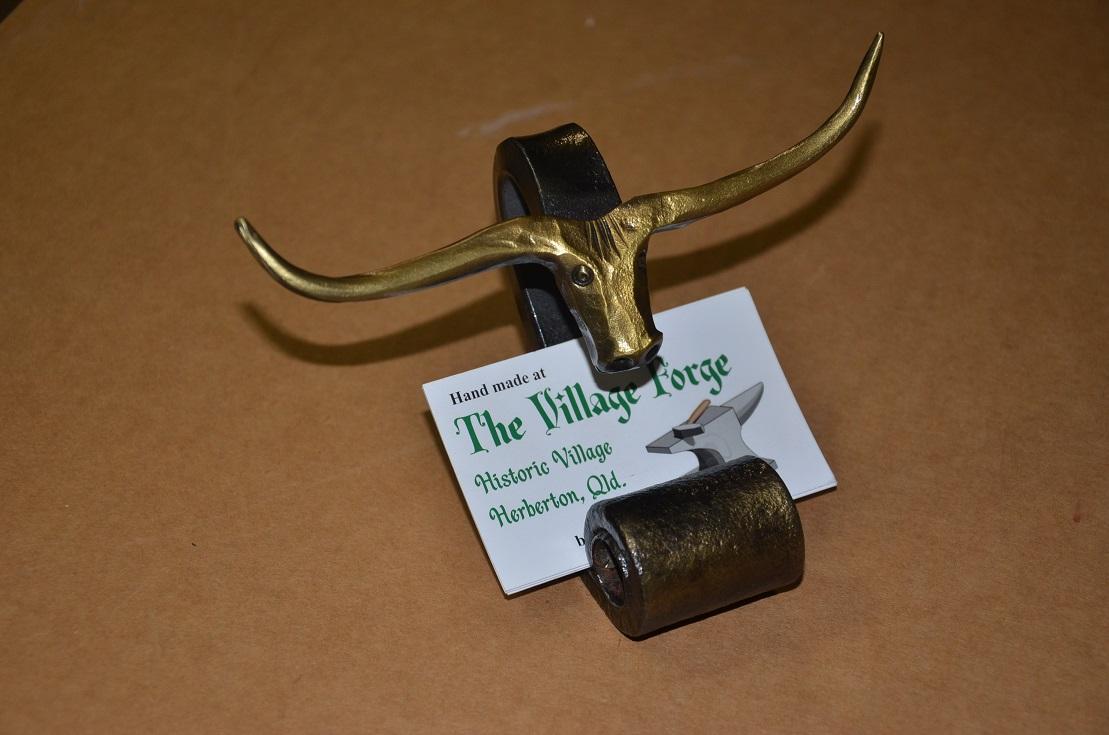

ausfire Posted January 7, 2019 Share Posted January 7, 2019 Beautifully forged hinges there, Ted. We haven't seen any business card holders on here for a while. I made these two over the last couple of days. Had a new idea for the base instead of folding a lip on a piece of flat steel as I've done before. The bases on these are the eye ends of motor leaf springs. The curl of the eye holds the cards snuggly in place. Texas longhorn designs are popular here. Some I burnish and others I leave bright. Don't look closely at the welding - I do not profess to be a welder. The longhorns are forged from 8mm x 19mm mild bar. Quote Link to comment Share on other sites More sharing options...
