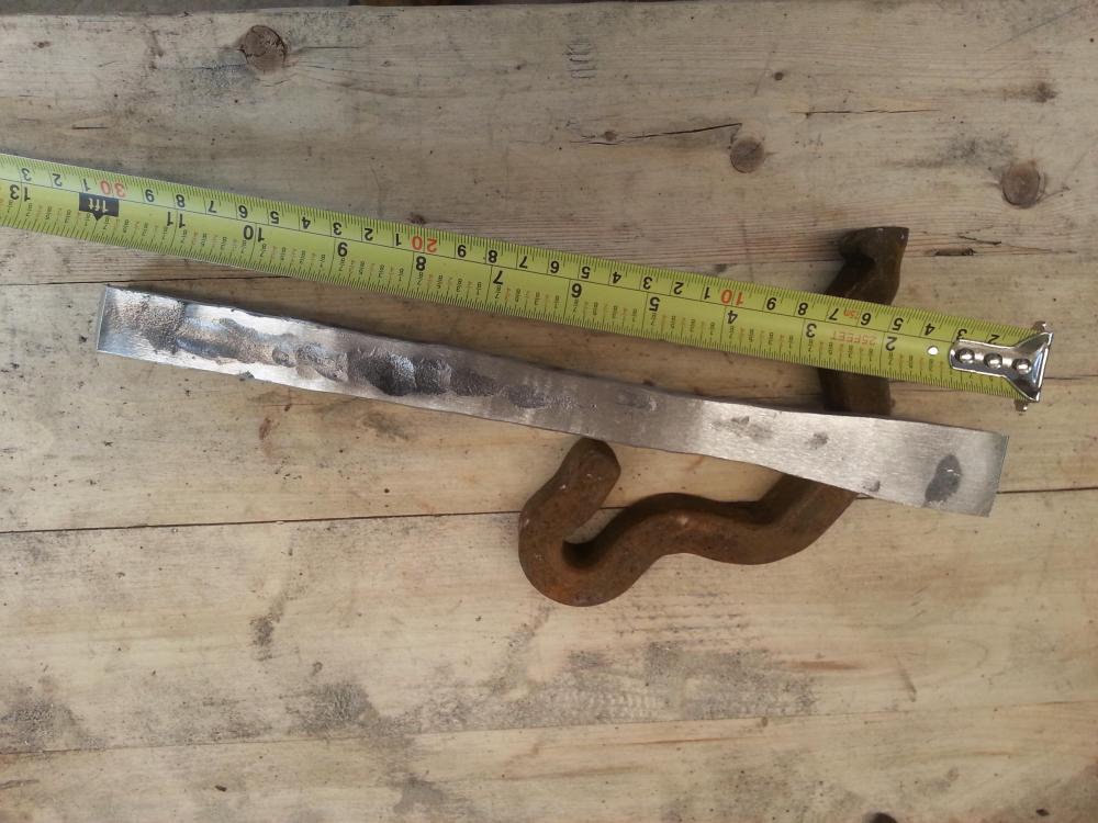

I don't have much in the way of tools yet and needed a hot chisel, so I made one out of a rail anchor. I understand the steel of these is 1060.
Figured that leaving a few hammer marks when I sanded it wouldn't be a problem for such a tool, as long as it was nowhere critical. Not sure if I have the edge geometry right, I should be able to test it soon to see how well it works.
Couldn't flip the pictures on my phone, so they are upside down. :P
Edited by Arthur210
Added second picture. Added some details.

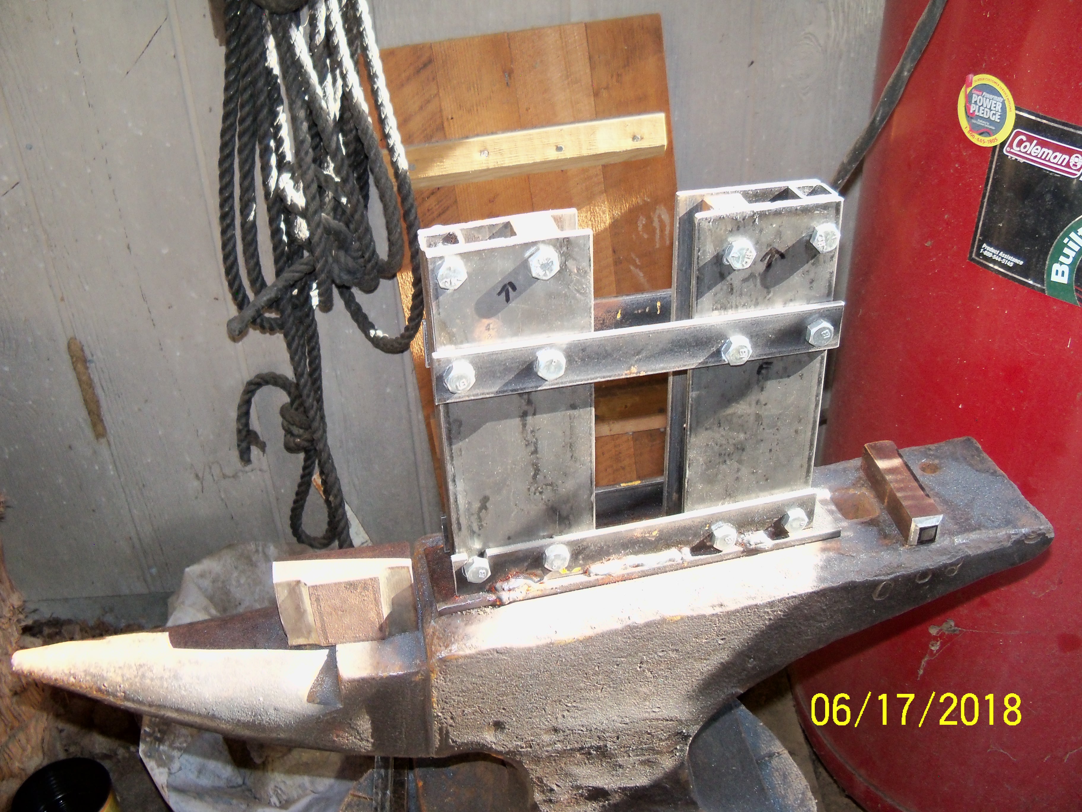

Today other than working on the propane forge, I made a bottom die for the Smithin Magician my wife made. She found a piece of massive leaf spring that's 15/16 in thick. It needed to be 3/4 in to fit the channels. She said you can't reduce it that much. I love a challenge so several hours later and an angle grinder, it fits. Temp was 94° F so we both got overheated.:lol: The camera angle makes the die look crooked, but both sides are the same and the top is round.

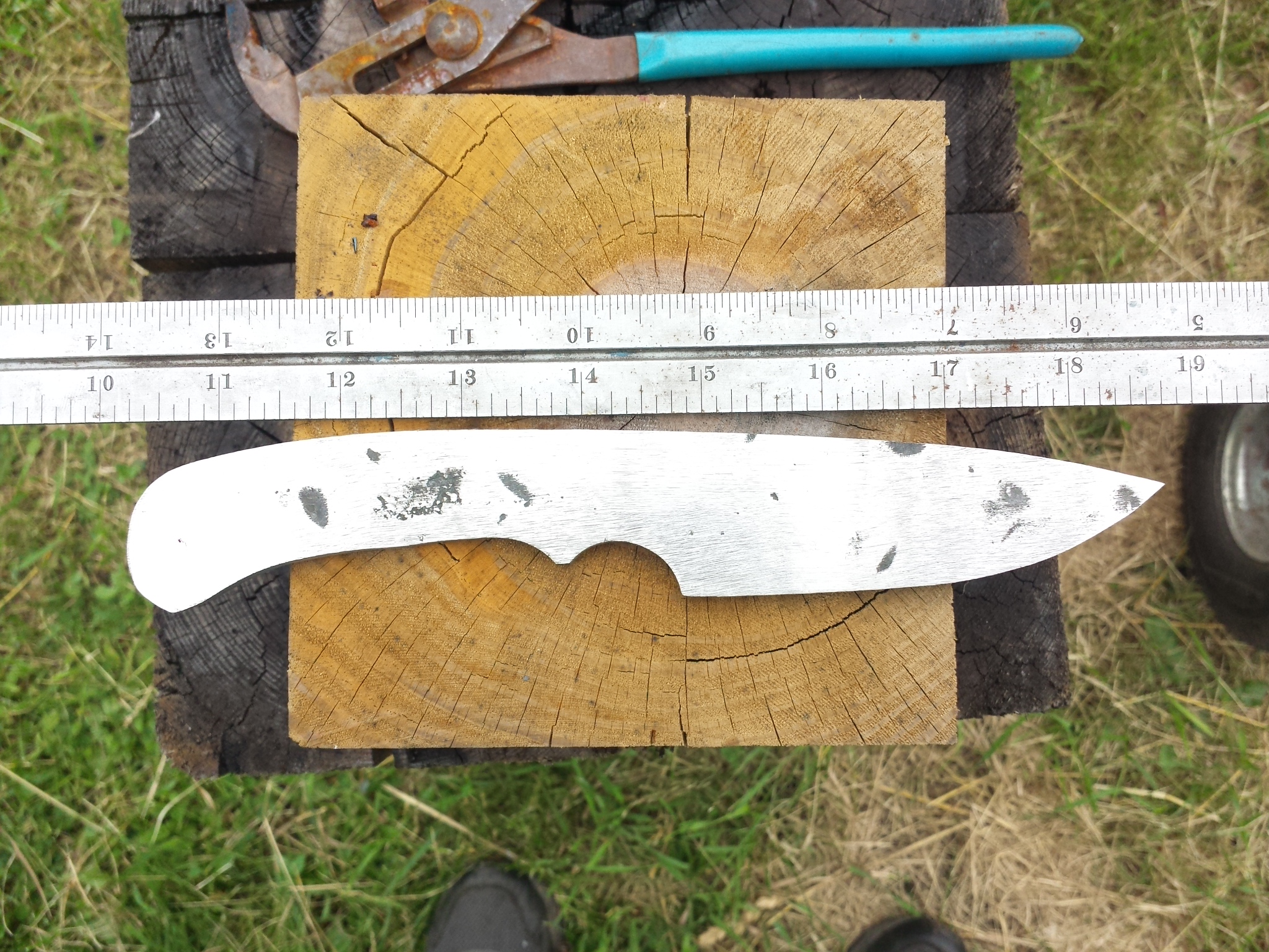

So I took a 2x4x1/2 piece of leaf sprig and made this today. Really proud of this one. Nothing very special in looks, but it is my first project and first knife to come out of my coal forge. That's an accomplishment for me haha.
