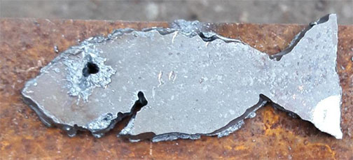

BryanL Posted June 8, 2018 Share Posted June 8, 2018 Got my new (to me) plasma cutter working. As far as I can tell, I basically have a lightsaber now. I think rose petal blanks soon. Dont mind my shaky hand. Quote Link to comment Share on other sites More sharing options...

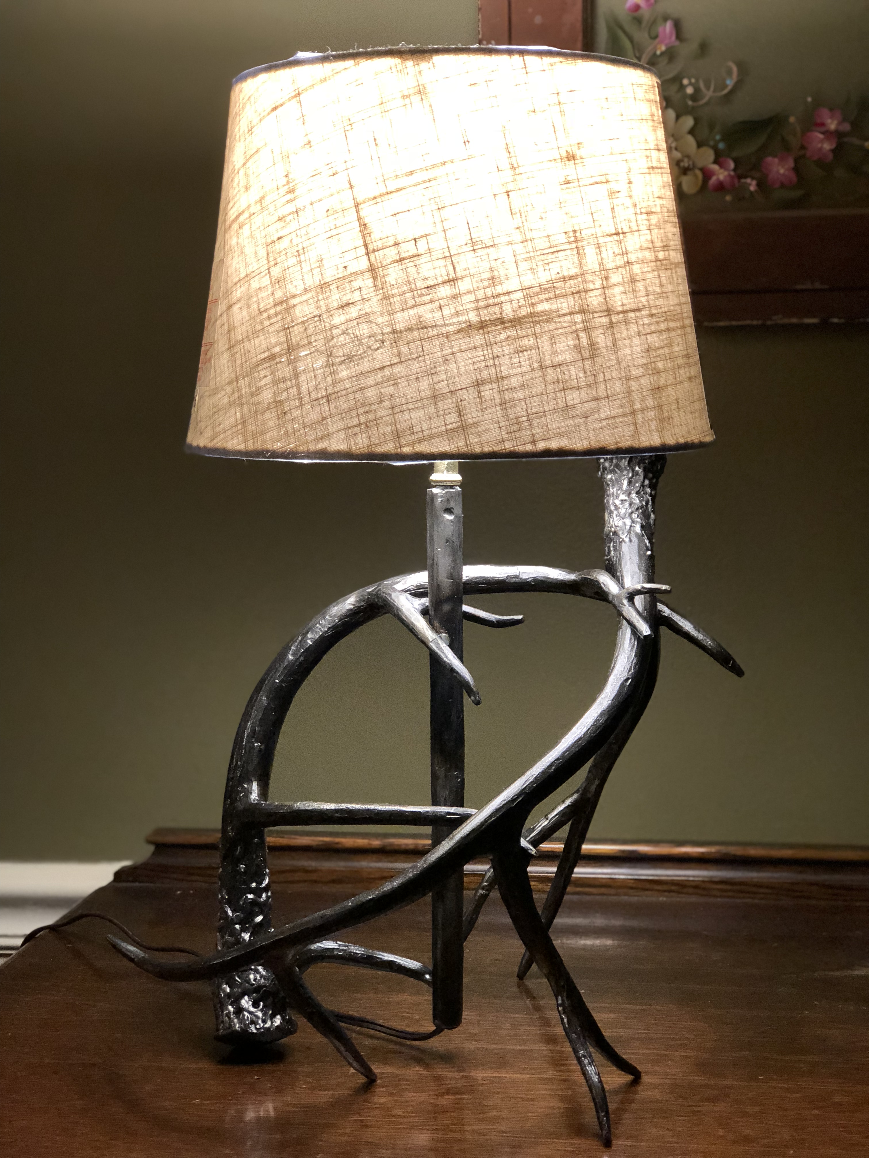

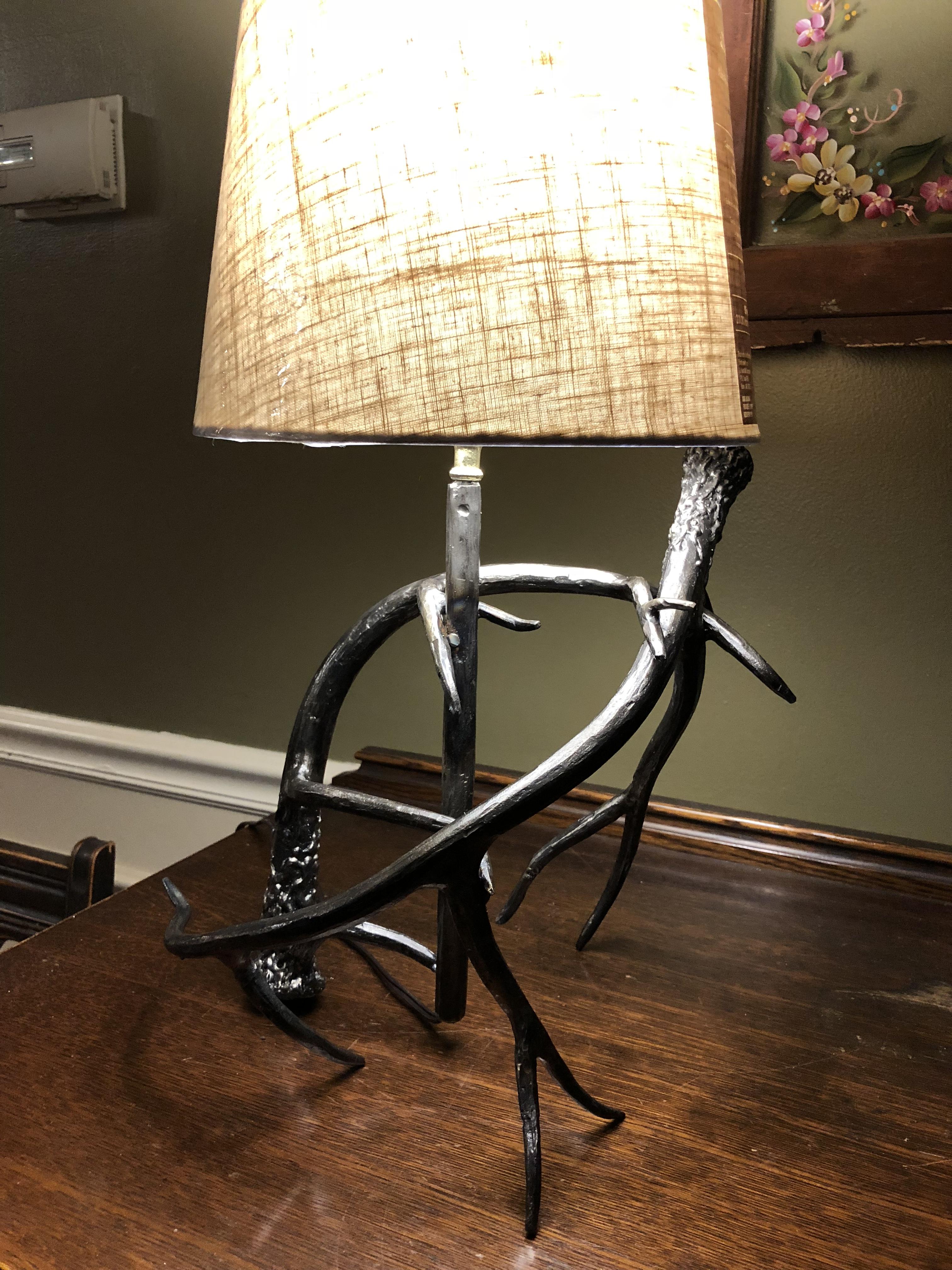

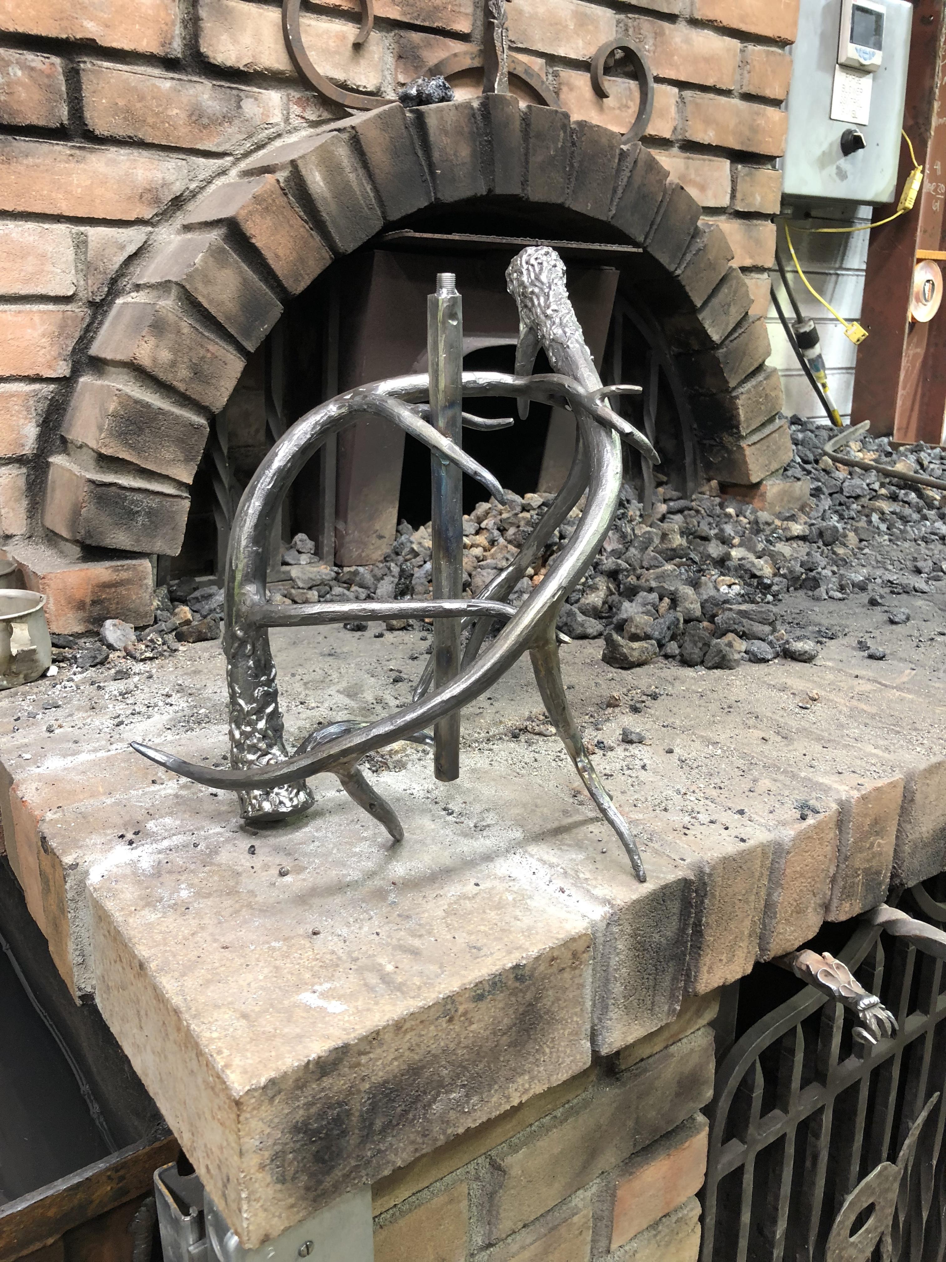

58er Posted June 9, 2018 Share Posted June 9, 2018 Antler lamp Quote Link to comment Share on other sites More sharing options...

Glenn Posted June 9, 2018 Share Posted June 9, 2018 16 hours ago, BryanL said: I basically have a light saber now. Don't mind my shaky hand. Tip speed and somewhere for the kerf material to go will improve your cuts. Hold the tip vertical unless you want a slope on the cut. Depending on the tip, do not touch the material being cut, leave a small gap between the two. Remember that plasma cutters produce a LOT of bad air and debris that you do not want to breathe. Quote Link to comment Share on other sites More sharing options...
BryanL Posted June 9, 2018 Share Posted June 9, 2018 Good to know Glenn, thanks. Do you think I need a respirator or is working out in the open air sufficient? Quote Link to comment Share on other sites More sharing options...
Daswulf Posted June 9, 2018 Share Posted June 9, 2018 58er, that antler lamp is absolutely awesome. Very inspirational since id love to make a full deer skull and antlers on it. Vaughn, nice warm up and you can put it right in the for sale pile. Quote Link to comment Share on other sites More sharing options...
Glenn Posted June 9, 2018 Share Posted June 9, 2018 Bryan Wait until the ground is covered in snow and fire up the plasma cutter. The gray debris all over the place will answer a lot of your questions. For me, definitely outside with a fan under the cutting area, blowing the bad air and debris out of the work area. Remember that if the material is galvanized (zinc coated) or coated with something, the stuff is vaporized and now floating in the air. When your finished cutting take a damp white cloth and wipe the top side of the material being cut and wipe around the work area. Is the cloth still white? You think you inhaled any of that stuff? As you get a little more practice with the plasma cutter, cut the box apart so you do not have to think outside the box. You have a plasma cutter so why not use it to cut things, like round and flat bar stock into the length you want, hardie plates for the anvil (always nice to have several extra), and cut the leaf spring so you can make the guillotine fuller you been wanting to build. DO NOT cut into closed containers as you are blowing air and sparks and any combustible material in a closed container can go BOOM ! Always wear eye protection when running a plasma cutter. Always. A respirator is another level of protection. Your call. Quote Link to comment Share on other sites More sharing options...
Daswulf Posted June 9, 2018 Share Posted June 9, 2018 Actually a shaded lens eye protection is better. I use torching safety glasses when using mine when I can. A kid I worked with at one shop went to cut the lid off a 55 barrel that had contained ( I believe) methynol. It was " empty" he pulled the trigger on the cutter and BOOM! the barrel bounced 5' in the air. Thankfully he was not in the way or injured. I have cut these successfully after "Thuroughly" hosing them out. Another guy i know got blown through a garage door from torching a barrel that had oil residue. A guy just brought me a barrel to cut the top off. It still had residue so i chiseled it off instead of risking the plasma cutter on it. Be smart about how you use it. And when not to. Quote Link to comment Share on other sites More sharing options...
BryanL Posted June 9, 2018 Share Posted June 9, 2018 Good points guys. I don't have a respirator right now but I'll take a look into what's available. Probably if I search around the site, it has been discussed before. Good tip about the barrels, that sound like a disaster. Certainly exciting to get a new capability. Bryan Quote Link to comment Share on other sites More sharing options...
Glenn Posted June 9, 2018 Share Posted June 9, 2018 10 minutes ago, Daswulf said: shaded lens eye protection Thank you, I left that out. I picked up a 55 gallon drum clearly marked 10w30 motor oil. The lid had a bit of a hoove to it so I ask the fellow if he knew why. Oh that was the drum we used for racing fuel at the track last weekend. You can NEVER know what is in a drum. Always proceed with caution. Quote Link to comment Share on other sites More sharing options...
JHCC Posted June 9, 2018 Share Posted June 9, 2018 Respirator = good. You’ve only got one set of lungs. Quote Link to comment Share on other sites More sharing options...
Daswulf Posted June 9, 2018 Share Posted June 9, 2018 Bryan, a good respirator should only run around $20-30. More or less generally. They have been discussed in the safety section. Also about changing the filters! Buy extra filters and a air tight container to keep your respirator in when not in use to prolong filter life. Quote Link to comment Share on other sites More sharing options...
Frosty Posted June 9, 2018 Share Posted June 9, 2018 Plasma cutters are often used over a water tray to trap debris. You still want a respirator and eye protection. One of these days I'd like to have a plasma cutter. <envious sigh> Frosty The Lucky. Quote Link to comment Share on other sites More sharing options...

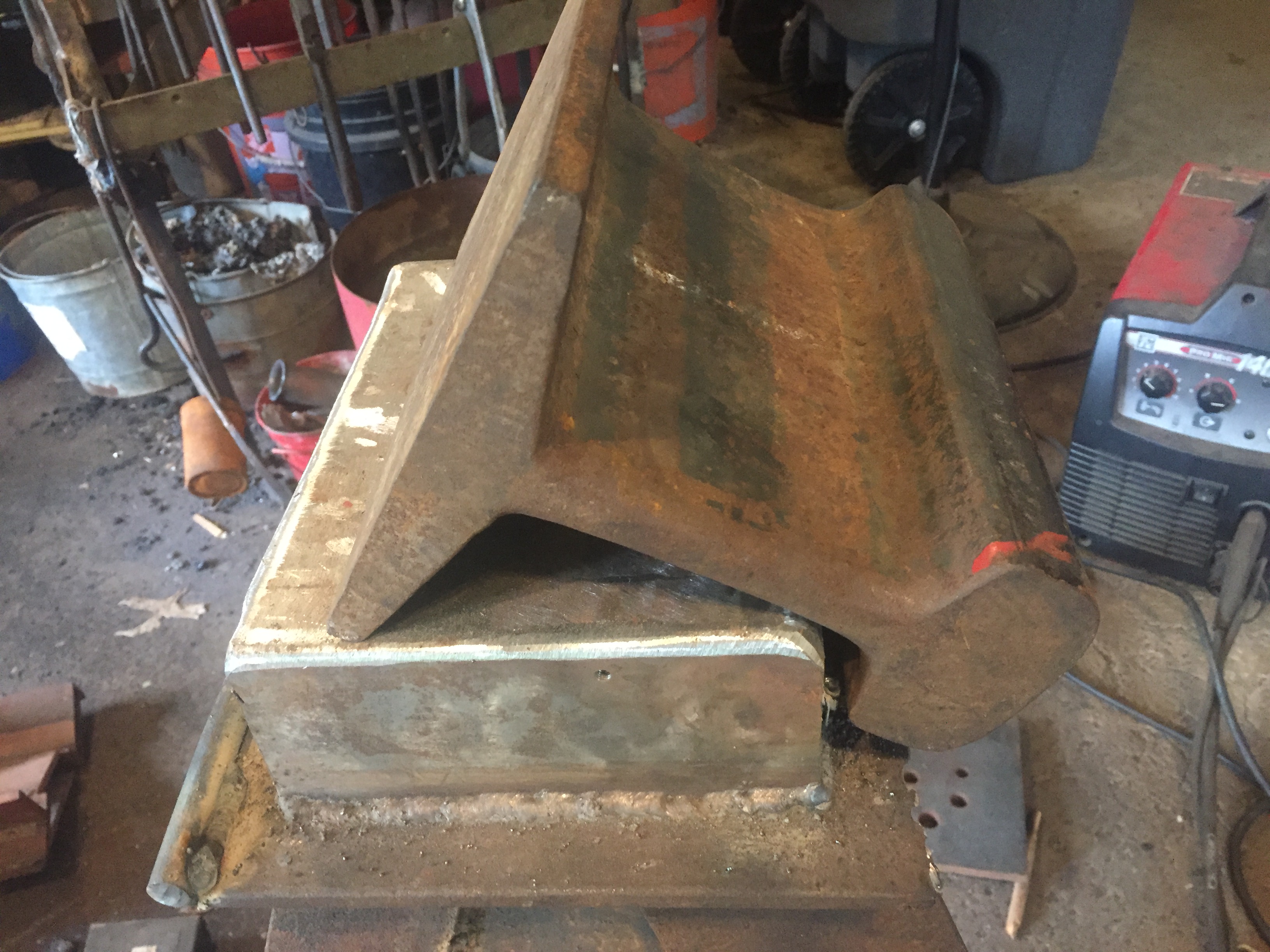

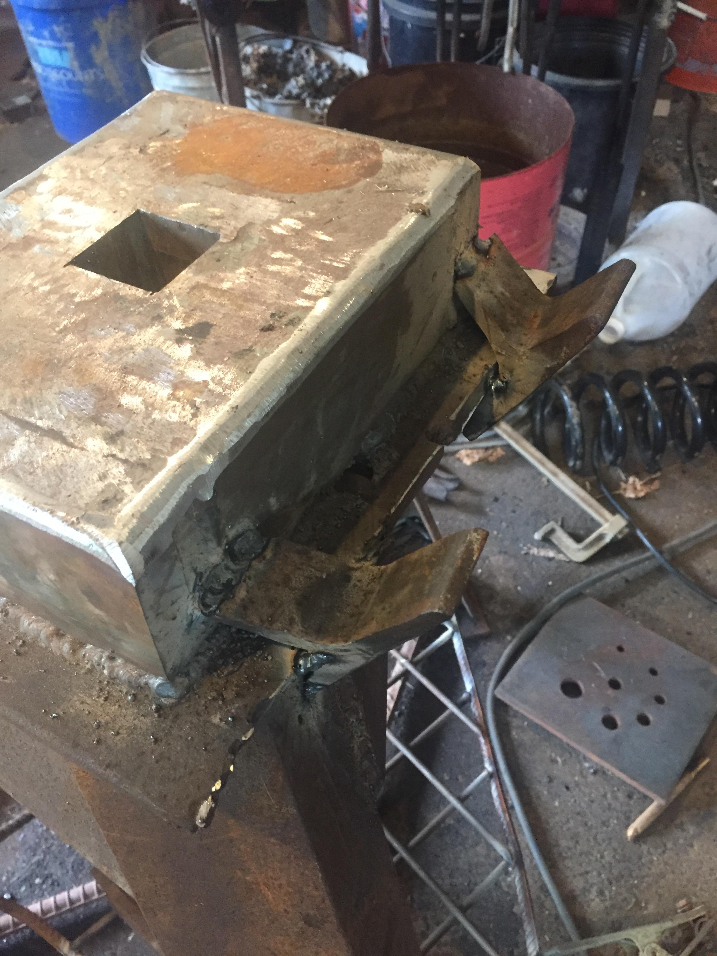

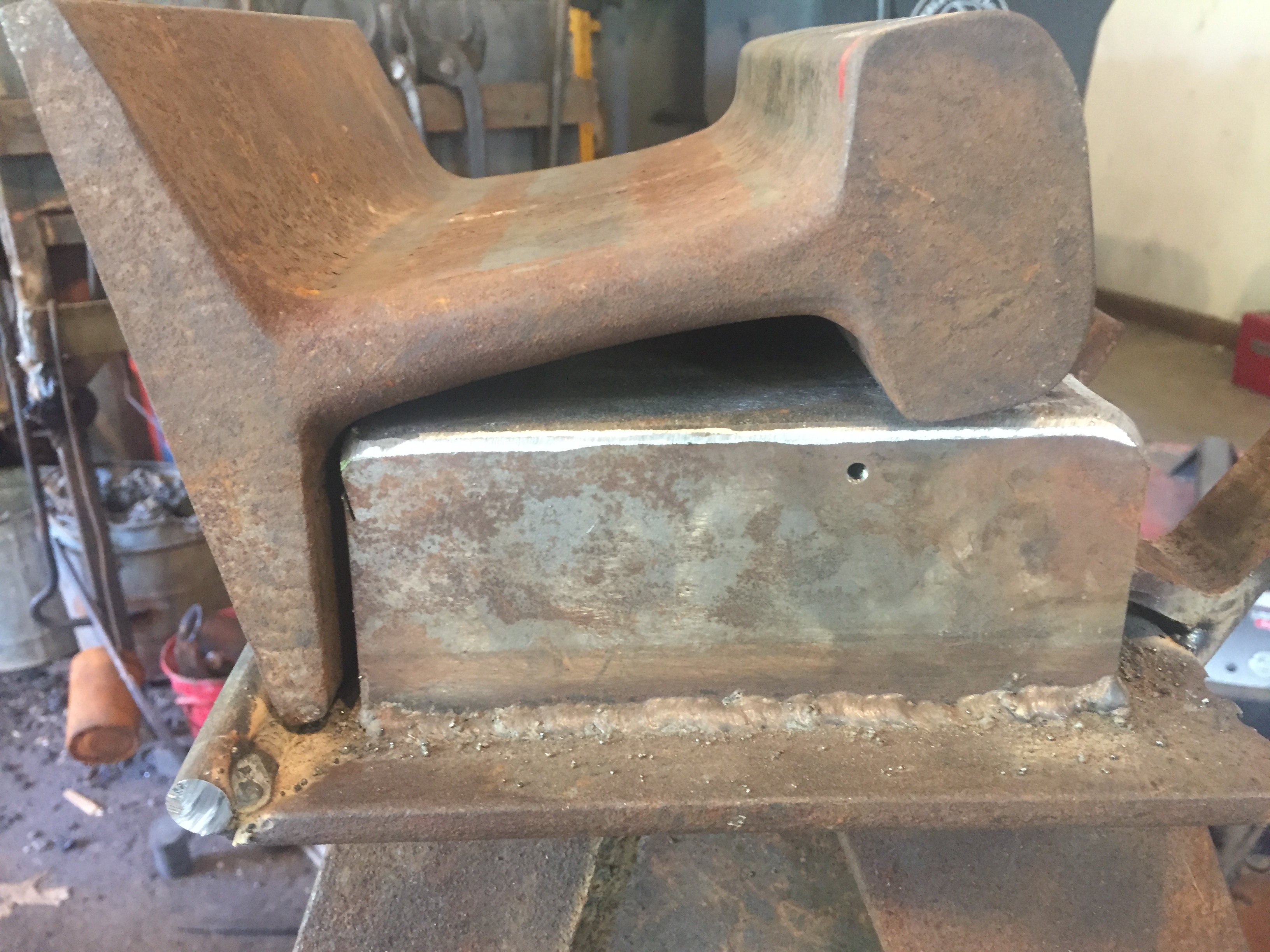

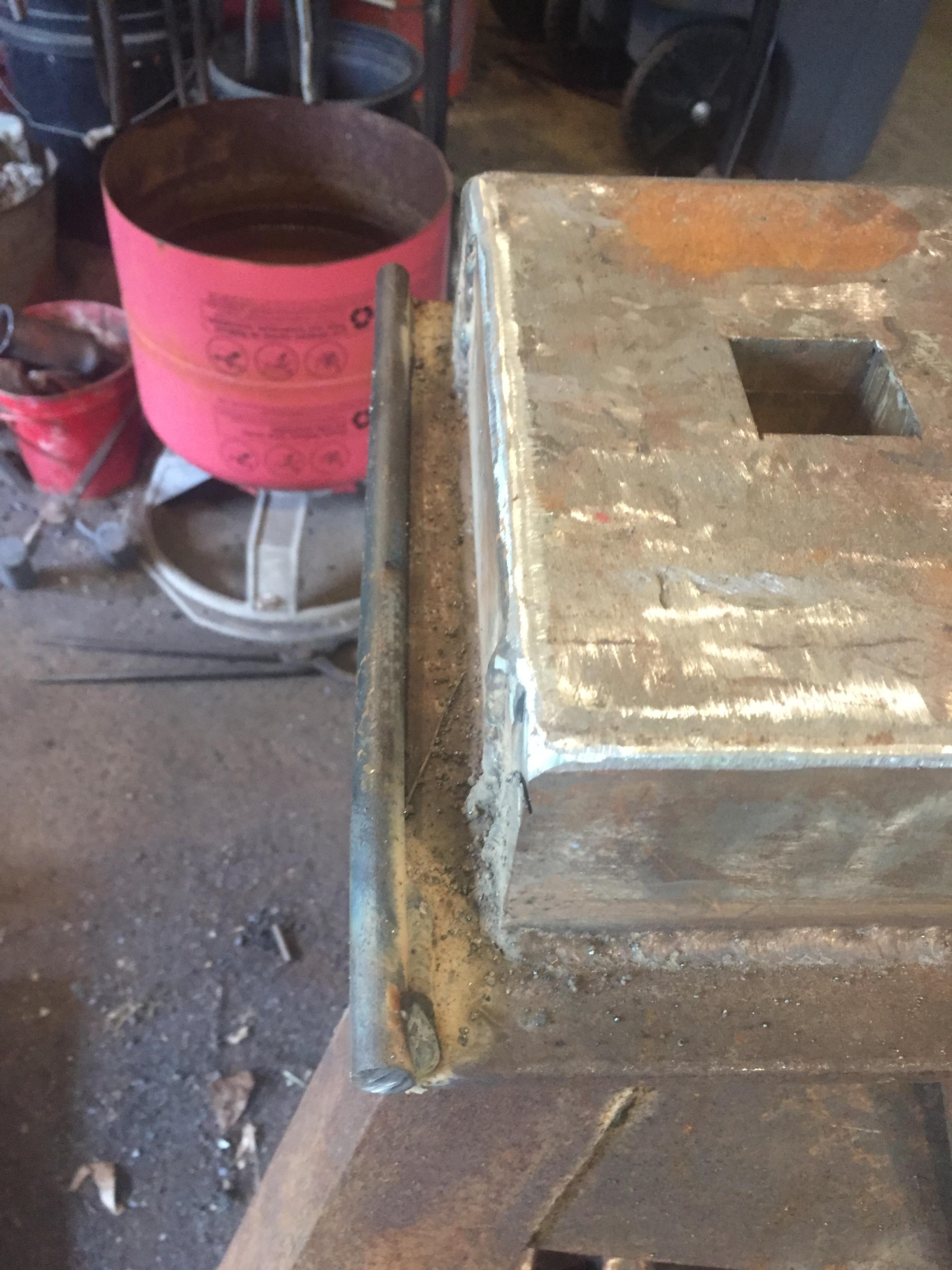

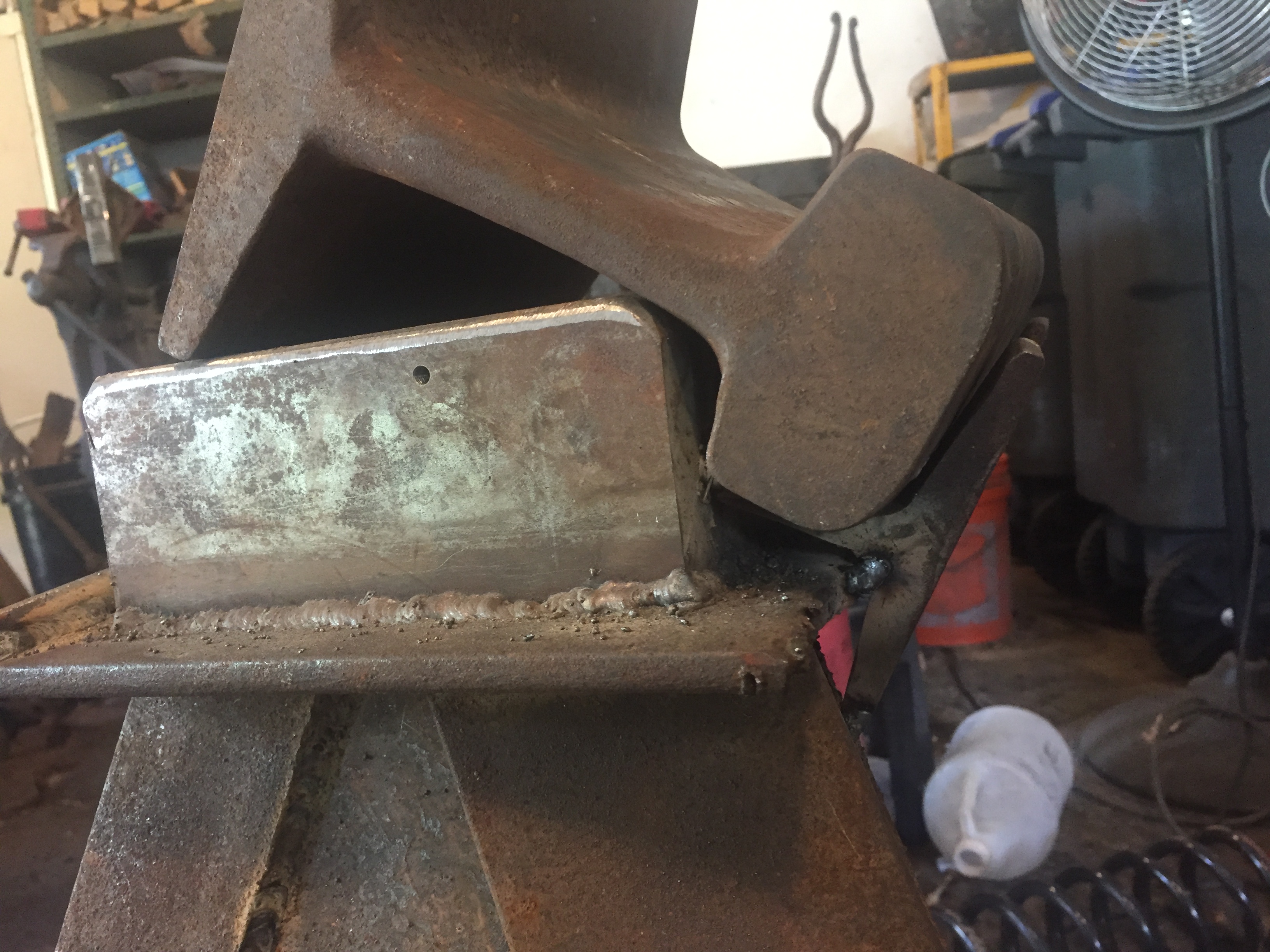

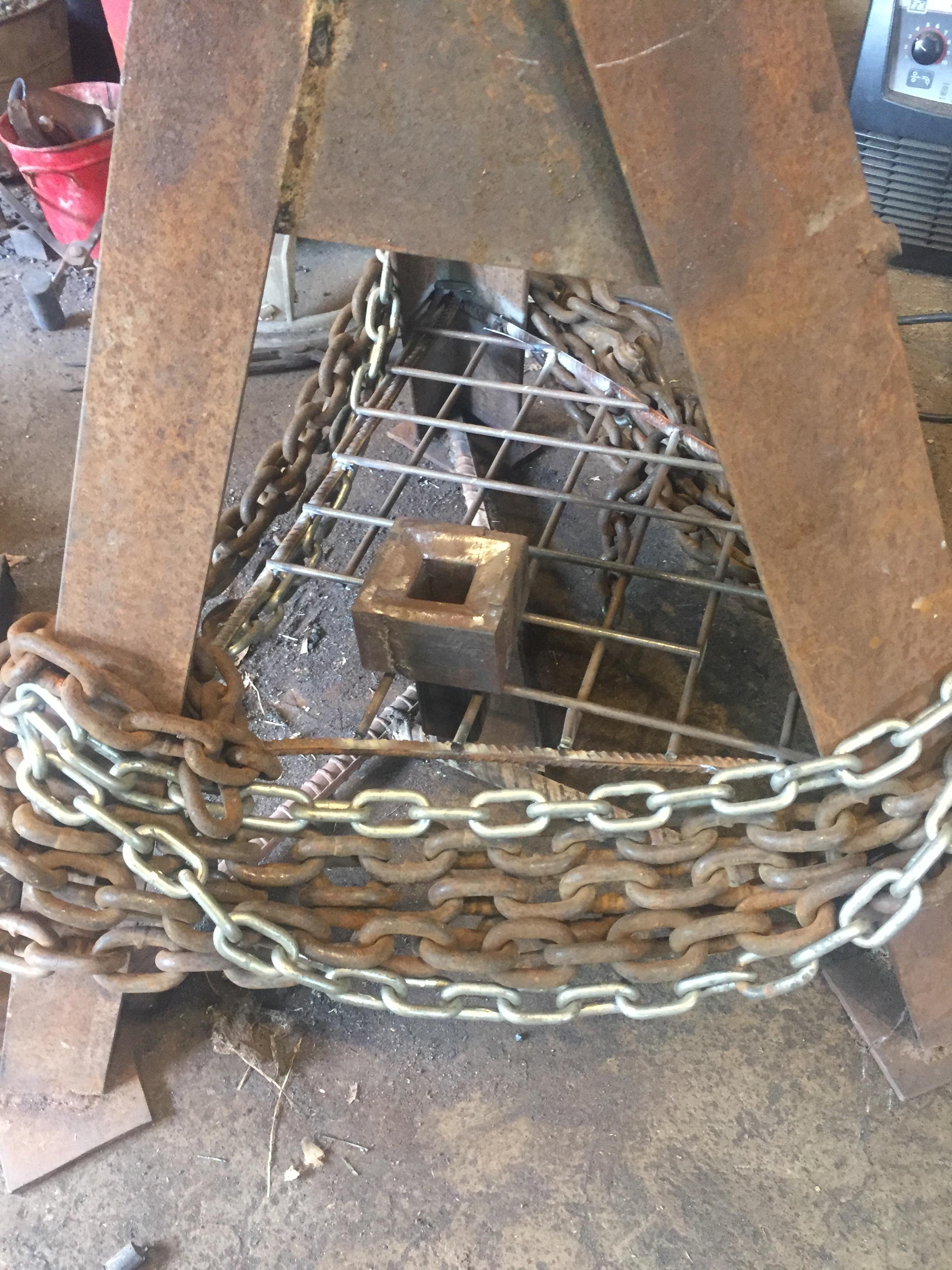

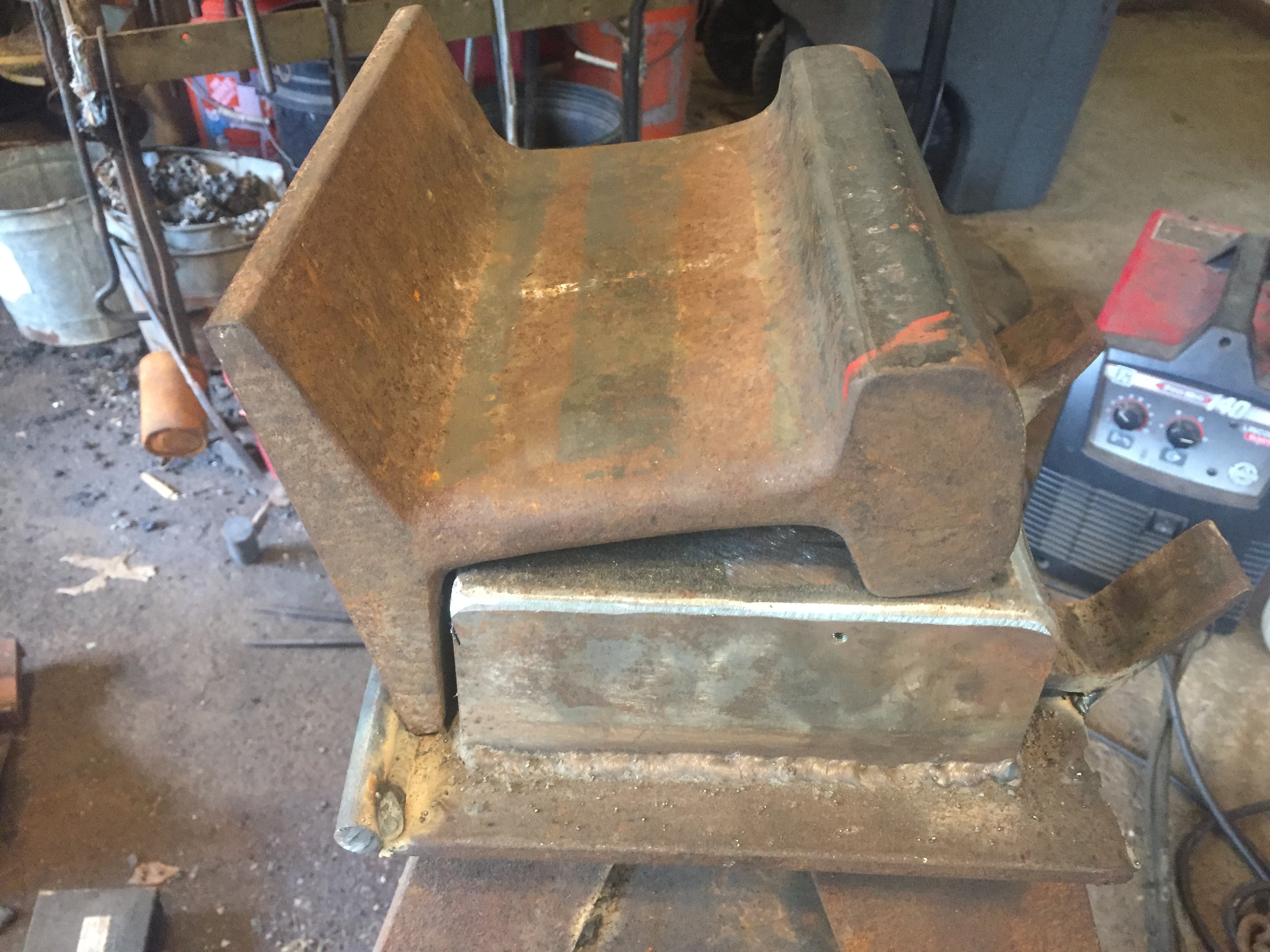

JHCC Posted June 9, 2018 Share Posted June 9, 2018 I’d picked up a chunk of square grid (1/4” round on 2” centers) and realized it would make a nice rack for the hardy tools that fit the portable hole/striking anvil. Here it is with some 1/2” rebar welded to the edge for reinforcement: Also welded some 1/2” round and some bits of I-beam to the base plate of the top: These act as brackets to hold a chunk of RR track on its side: To use the curves of the sides as swages and the edges as fullers: Next up is to finish replacing the stems on some of those tools (the ones I made before changing the hole from 1-3/4” to 1-1/2”). Quote Link to comment Share on other sites More sharing options...
Frosty Posted June 9, 2018 Share Posted June 9, 2018 Looks good John. The screen shelf will be a good place to let stuff cool off. Please round the corners off the angle iron hangers before you find out how I know you Don't want sharp corners at that level. Heck round off any sharp protrusions for safety's sake. Frosty The Lucky. Quote Link to comment Share on other sites More sharing options...
