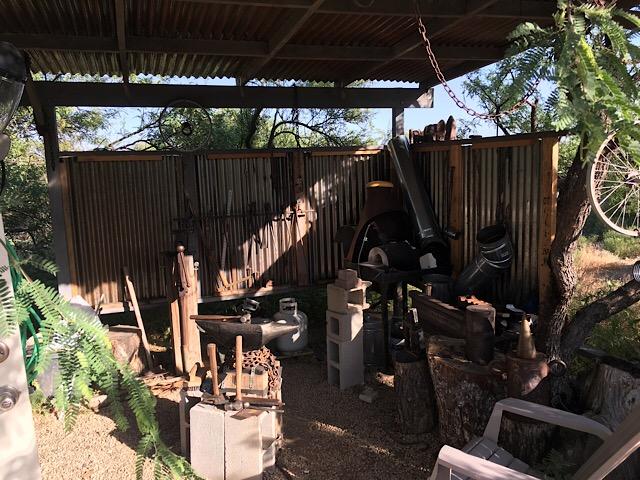

As has been mentioned, it really depends on what you plan on doing. If you main focus will be small items and you will have minimal tools you can get by with a relatively small shop, say 8x8 or 10x10. If you plan on having more tools like a power hammer, hydraulic press, drill press, sander, lathe, ect. you will need more room. If your goal in ornamental work like large gates or sculptures you will also need more space to mock and weld things up. I work in an area around 400 S.F. which contains my anvil, gas forge, post vise, work bench, drill press, 4'x5' assembly/welding table, and its fairly roomy. The barn I'm working in is larger though so if I'm working on something bigger I can move some equipment around and utilize up to around 1,000 S.F.

That said my shop is 12’x12’ and its perfect for me working solo but Im 6’1” and rather lean. 2 is a crowd but doable. 3 is too much for my little space

When I moved out here I built a 20' x 30' shop, all metal with a concrete floor.
Later I added another 20' x 30'  to it all metal save for 4 utility poles to hold it up and with a dirt floor.
Now I'm starting to plan a 20' x 20' "carport" addition so I can park my truck out of the sun, or put a postvise in a buried gazinta and swing 10+' stock around it. (and probably another buried gazinta down the driveway so I can swing a full 20' piece...)  Already have another 6" postvise.
