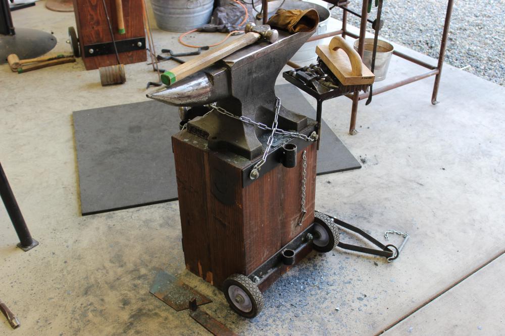

I want to modify the stand with wheels and a handle to make it easier to move about. Also make some decent tool/hammer holders on the sides. Rebound is pretty good and it has a very loud ring to it, louder then most I've played on. I haven't gotten around to using it yet, this one will be for when I have a group of people here for workshops. I already have the anvil of my dreams for a main shop anvil. A 475# S&H south German style double horn.

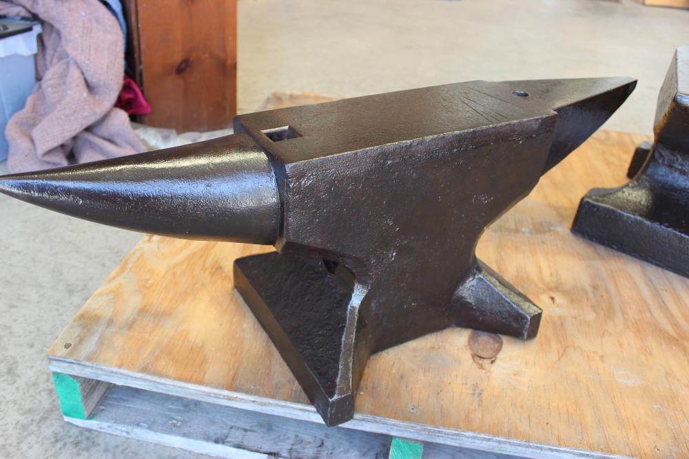

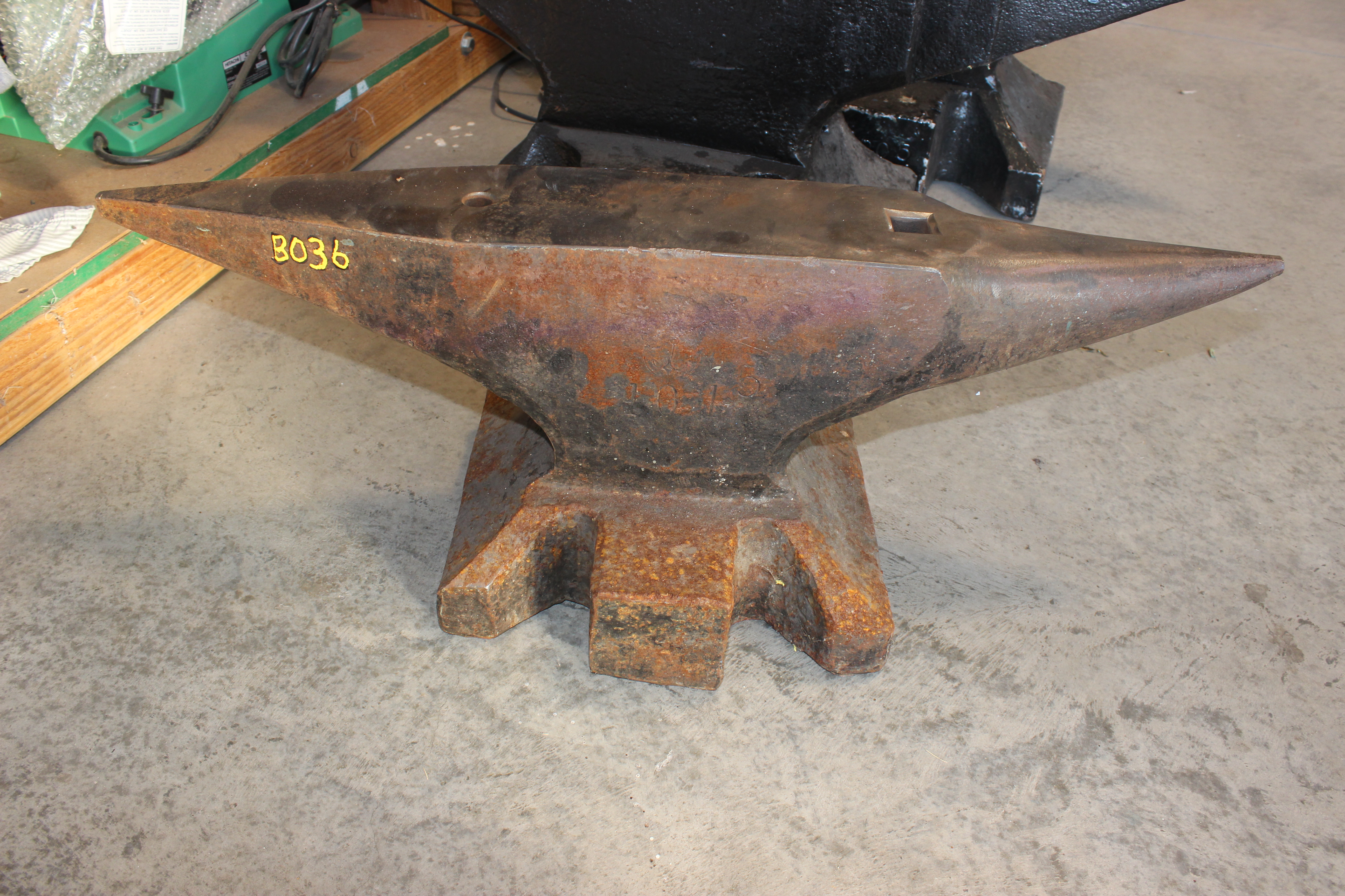

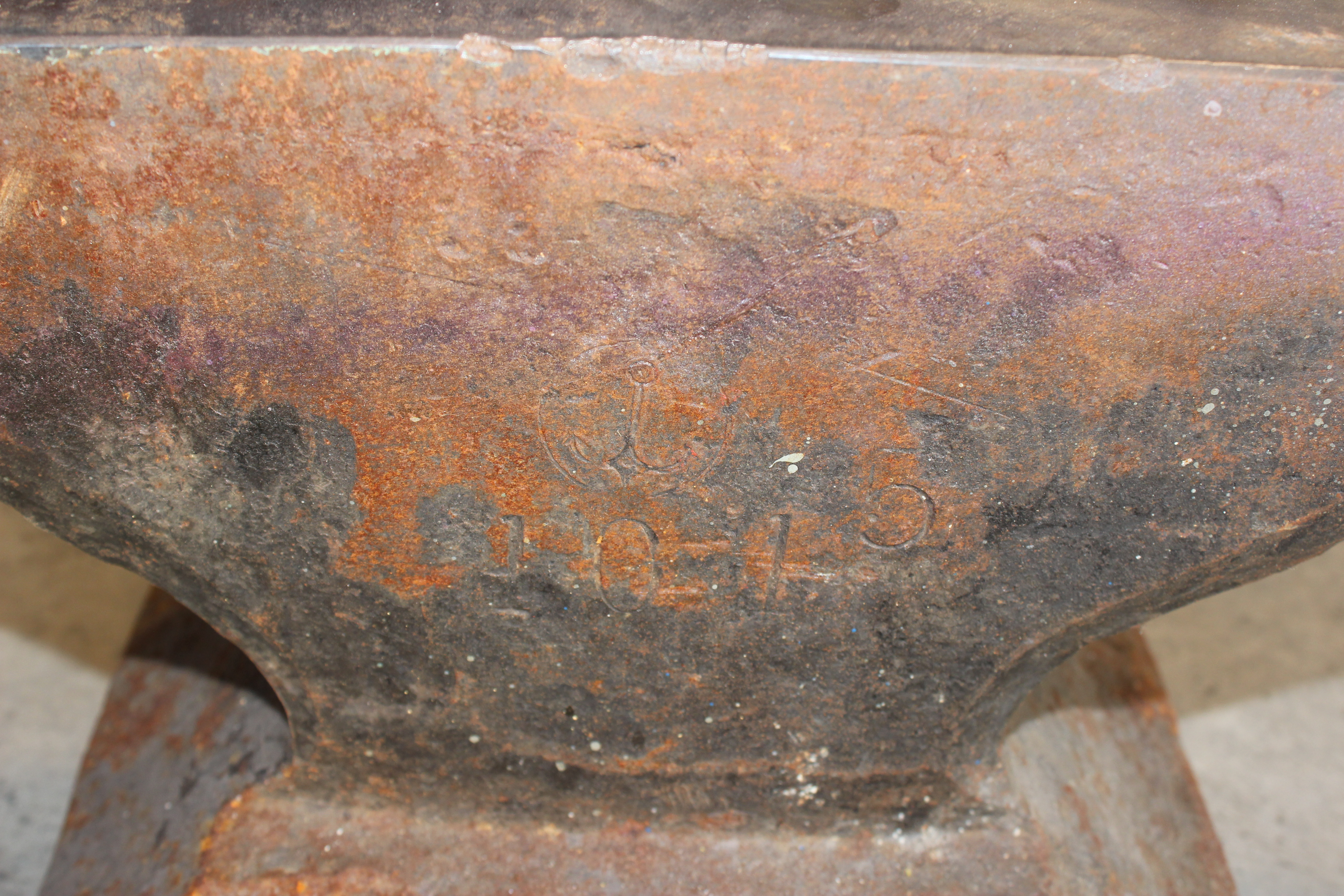

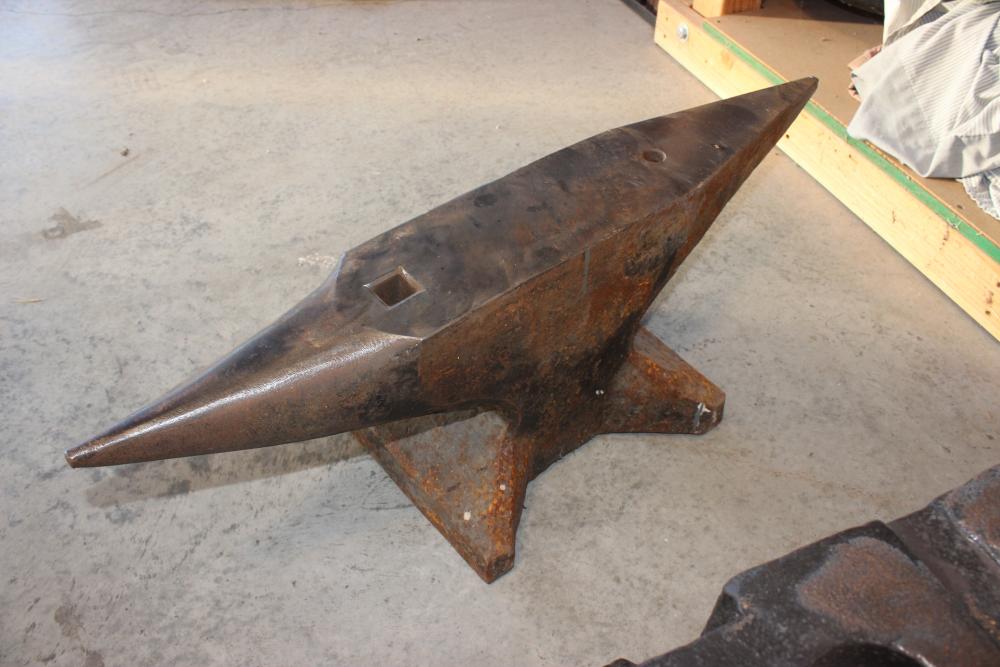

I recently picked up this 168 pound Attwood along with a few other anvils from England. Rebound is at 60%+. Without the markings you would think it was a Mousehole with the triangular feet and how the underside of the horn is finished. Just doesn't have the MH handling hole on the front feet.

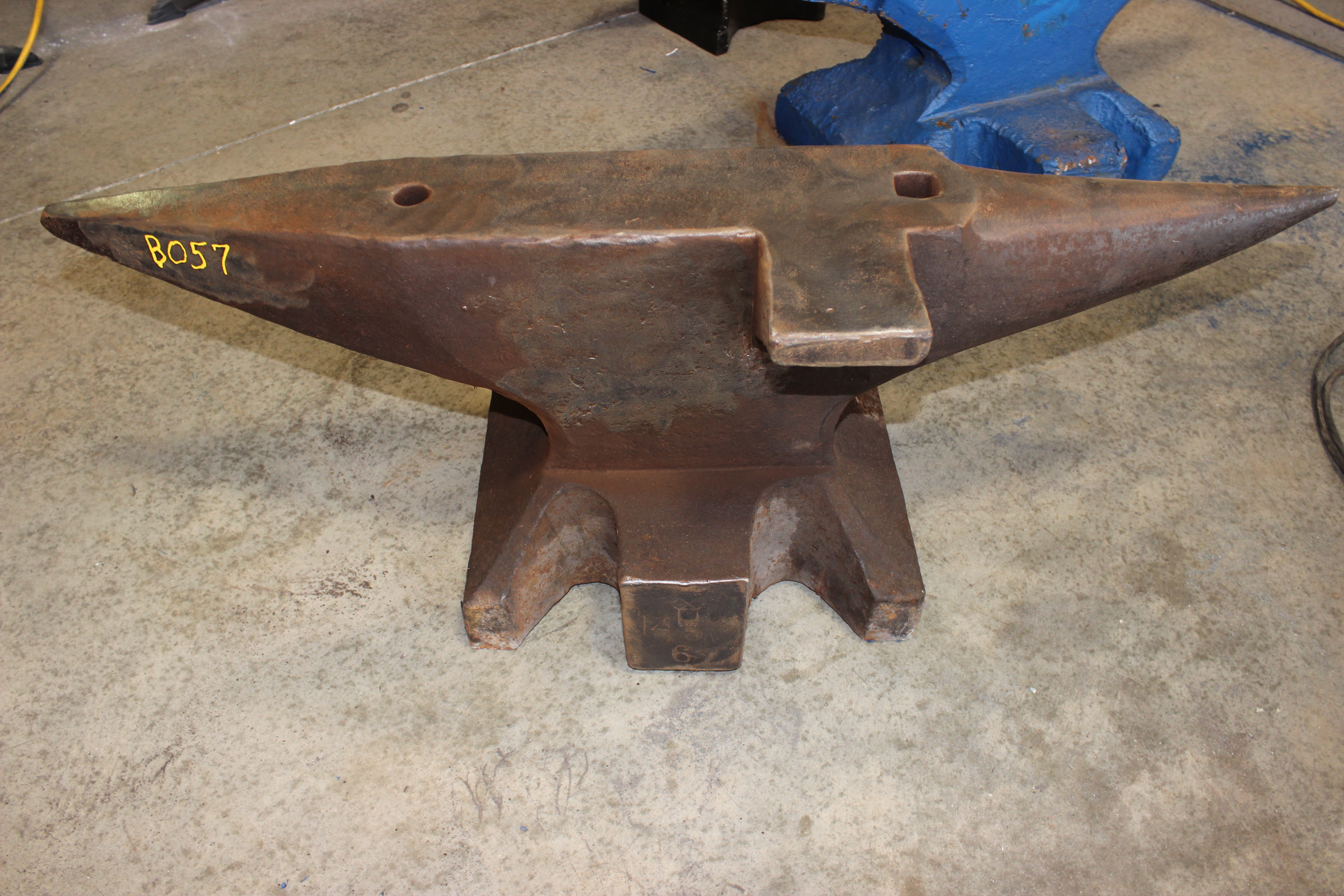

I have this PW that weighs in at 449 pounds. Its measurements are 37 1/2" long, 15 3/4" tall and has a 6" wide face. Hardie is 1 3/4" and prichel is 11/16". -

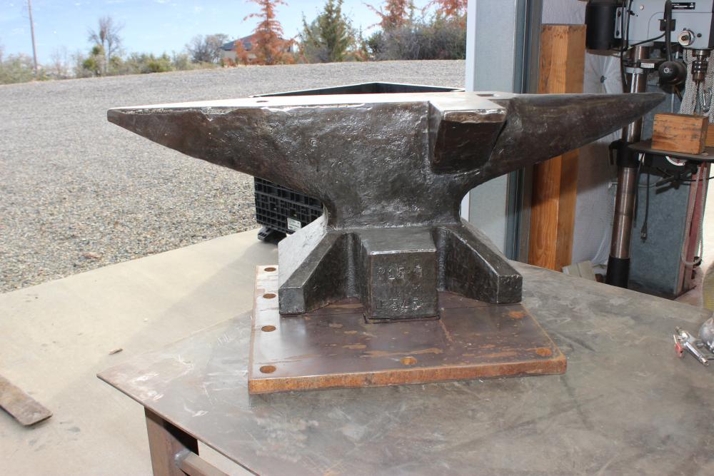

Now for last S&H I have. This one I acquired early last year and have just recently got a stand made for it and it is now one of my main shop anvils replacing a smaller S&S I had. Dated 1937 and weighing in at 475 pounds. There was some small amount of edge repair done by the previous owner but they have held up well so far. Rebound is unbelievable at 95%. Below is when I was laying out the base plate for it, one inch steel plate to help stabilize it. Completed stand with a swing out tray. This is the last S&H I have or have access to for now!

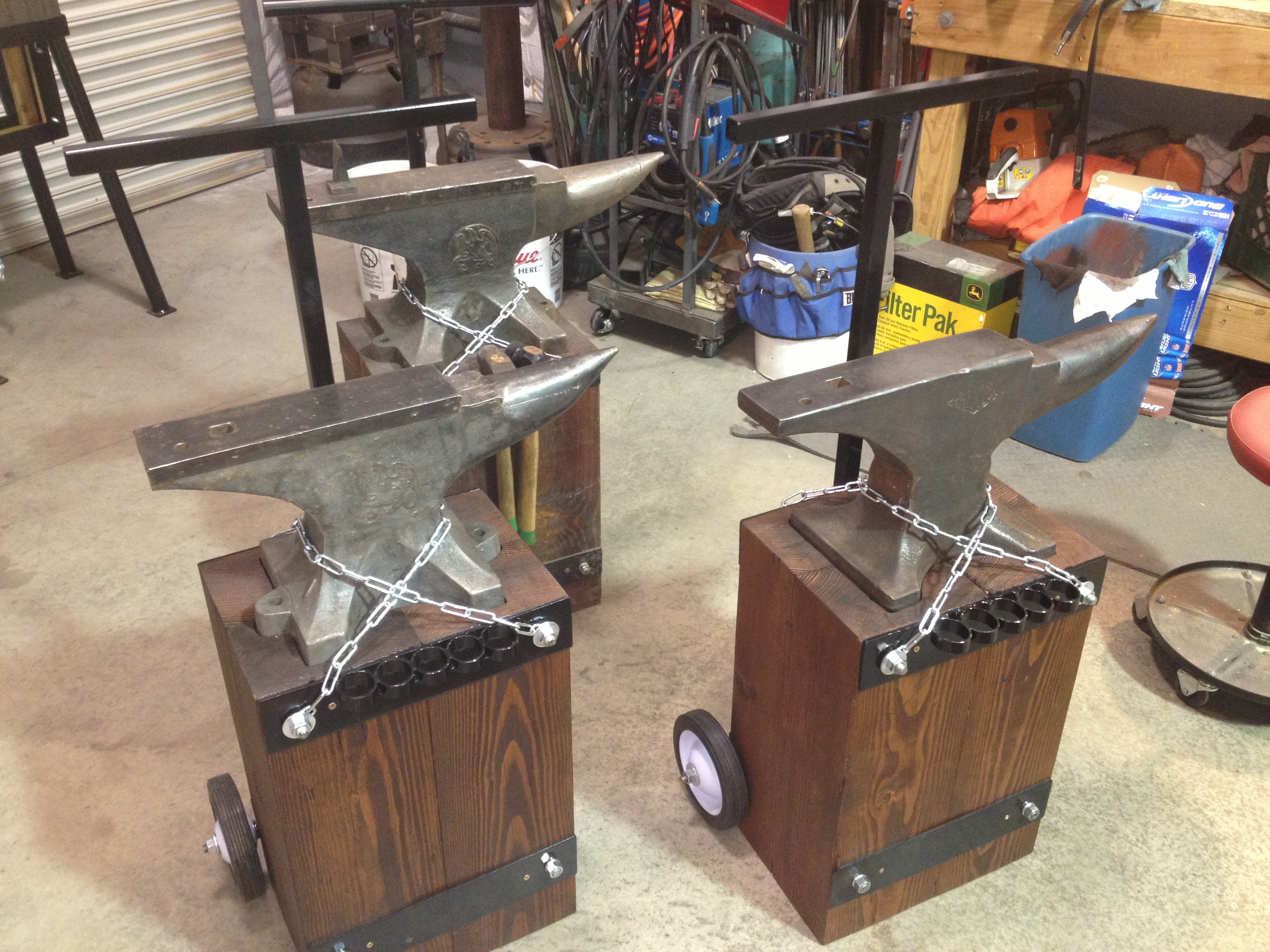

For my smaller traveling anvils I use this type of stand so I can easily move them around at events.I don't recommend this type of stand for anvils much over 150 pounds for they try to get away from you when tipping. The front two anvils are a 100 pound Fisher and a 120 pound Trenton with a Fisher in the back at 150. The above small Fisher was donated to a local museum last year for their small smithy that I get to play in a few times a year. Rear view showing a swing out tray I made later on. For one of my maim shop anvils (this one at 406 pounds) I made this three legged stand. The legs are filled with rammed decomposed granite to absorb vibration and add to stability. -

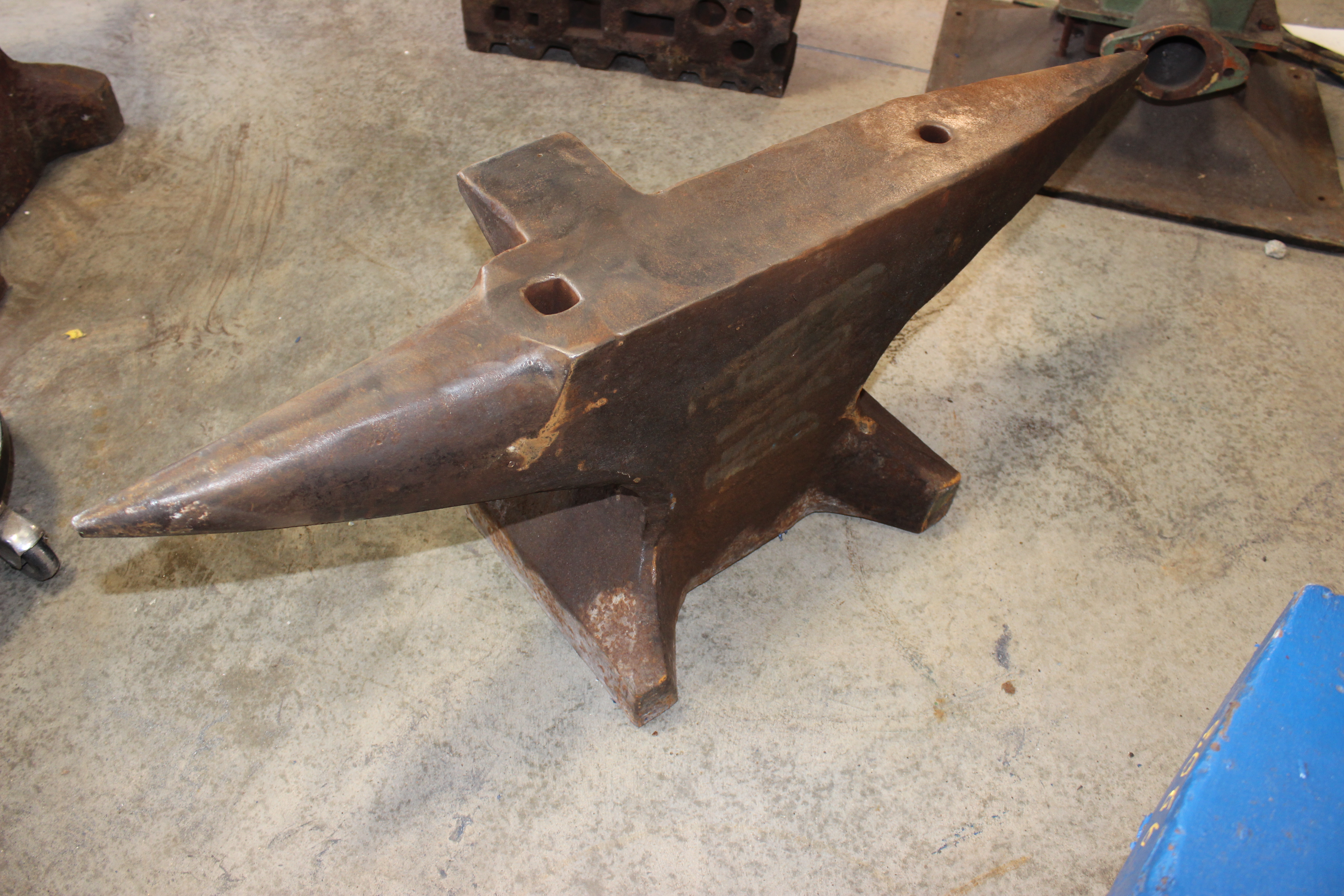

This S&H in the North German style with a upsetting block weighs in at 297 pounds. Face has some very shallow marks but still has fantastic rebound of 90%+. Dated 1917

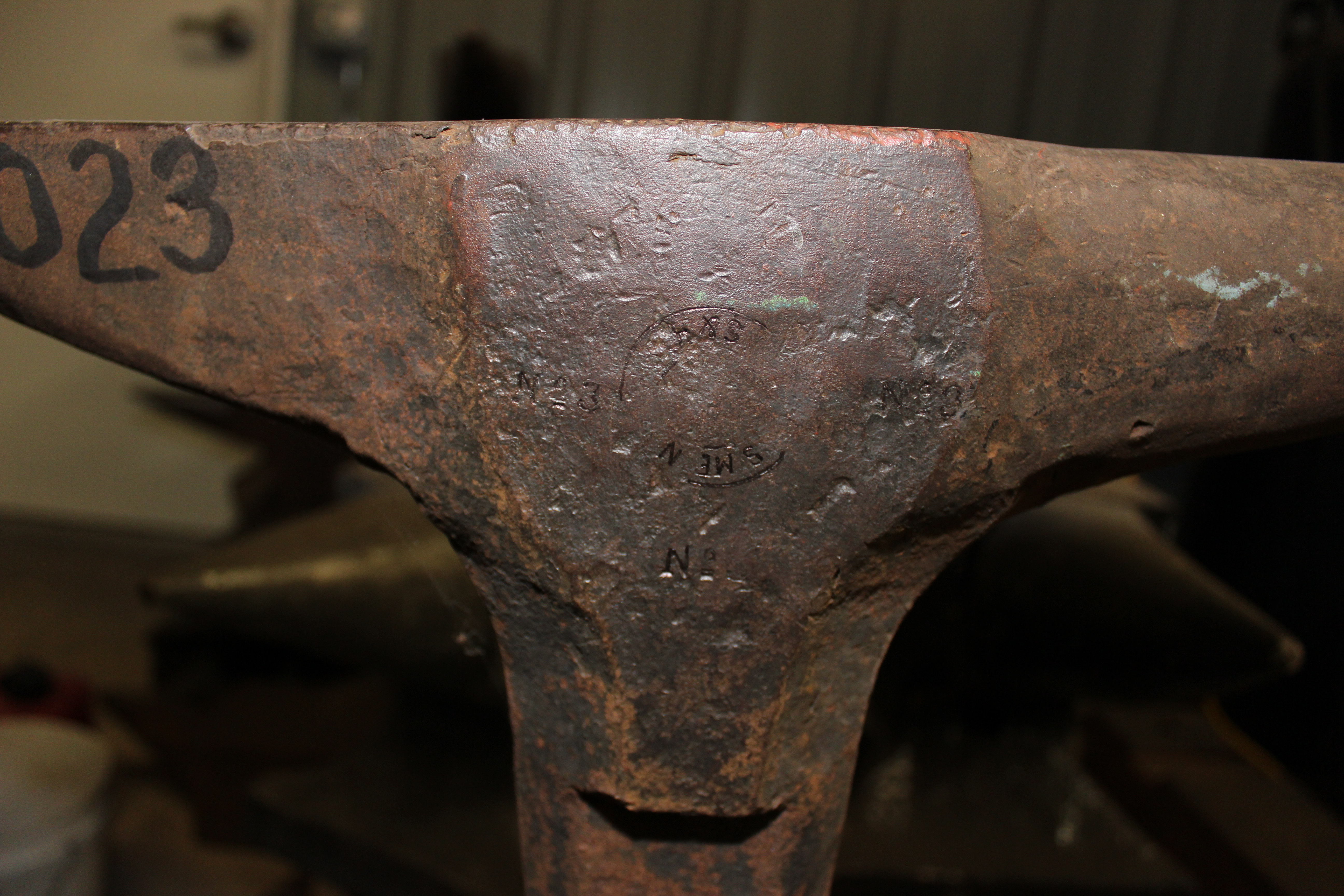

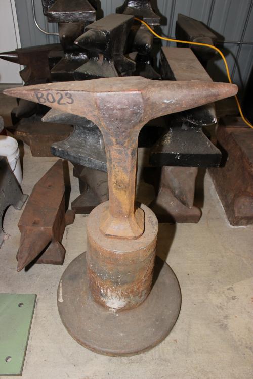

Now for this stake anvil from S&H. Has the rare factory cast iron stand. Most stake anvils were just used with a stamp or a cut wood block. The stake by itself weighs in at 77 pounds but the stand is 405 pounds. I believe this is dated 1881 from the stamp at the base of the anvil or could be dated 1938 from another stamp. Like the upside down makers stamp. This mark "38" could be a date of manufacture because it doesn't match a weight in kilograms. This would put it at 83 pounds and it's not even close to that at 77 actual pounds. The stamped "81". Lead pocket for the base to snug it up.
