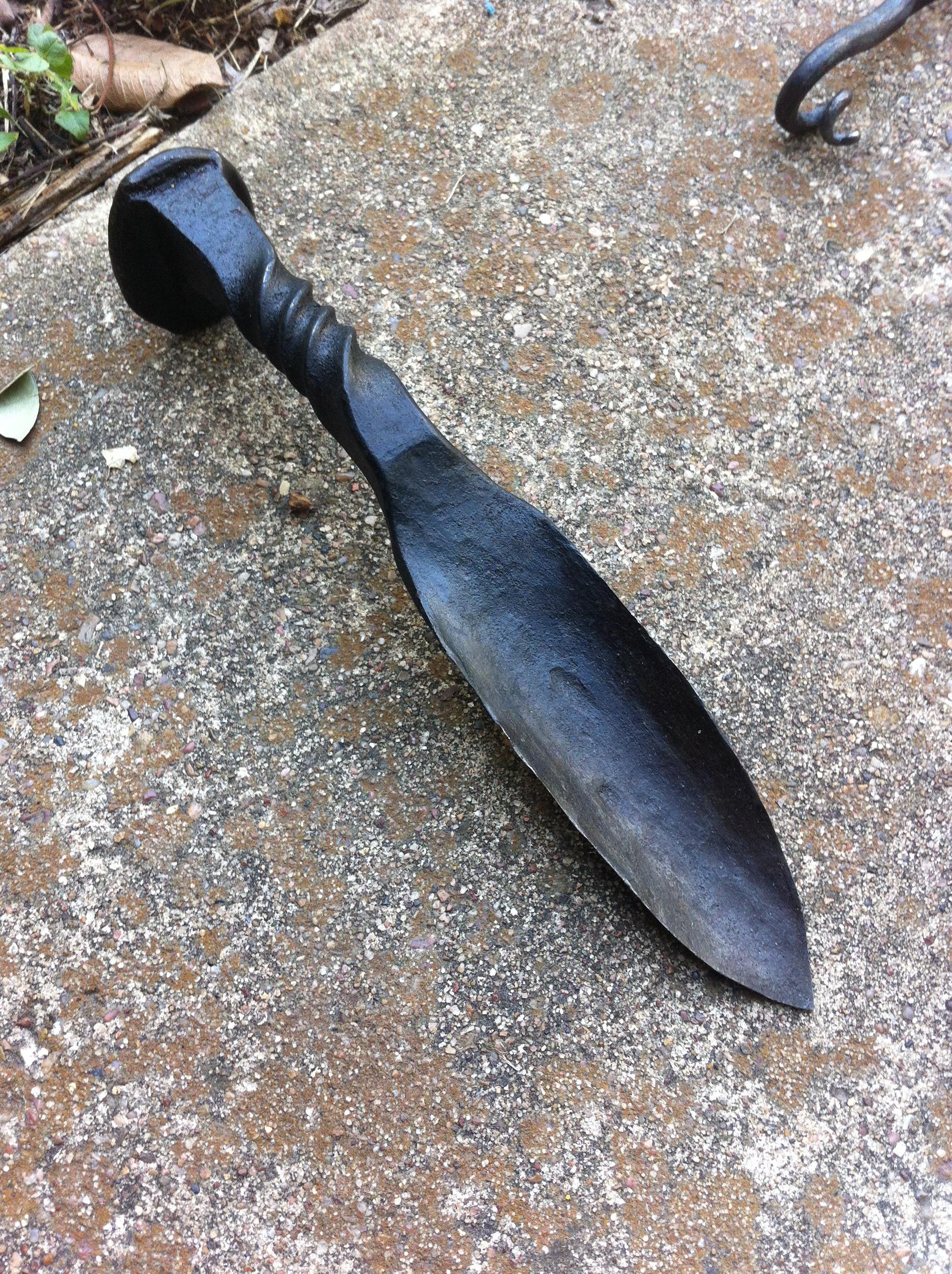

Mark Ling Posted August 5, 2017 Share Posted August 5, 2017 garden shovel, a couple bottle openers, and a wall hook with leaf, still needs wire wheeled and a finish put on it. Littleblacksmith Quote Link to comment Share on other sites More sharing options...
Jim Coke Posted August 5, 2017 Share Posted August 5, 2017 Greetings LBS.. Looking good.. Just a few suggestions. Prior to twisting your stock file the surface clean on the Rubic's cube and your plain twist . Round the edges for hand comfort. A smaller diameter ball pien for the screws than a round punch for the screw to set flat. As you might of guessed I've made bunches.. Keep up the great work . Forge on and make beautiful things Jim Quote Link to comment Share on other sites More sharing options...
Mark Ling Posted August 5, 2017 Share Posted August 5, 2017 Thank you! I had never thought of using a flat punch then so the screw heads sit flat! lots of good suggestions! Littleblacksmith Quote Link to comment Share on other sites More sharing options...
SLAG Posted August 5, 2017 Share Posted August 5, 2017 LBS, An old trick for preventing a rivet from rotating is to fashion one end squarish, and the other end can circularish. The square end is set in a square or rectangular hole. SLAG. Quote Link to comment Share on other sites More sharing options...
