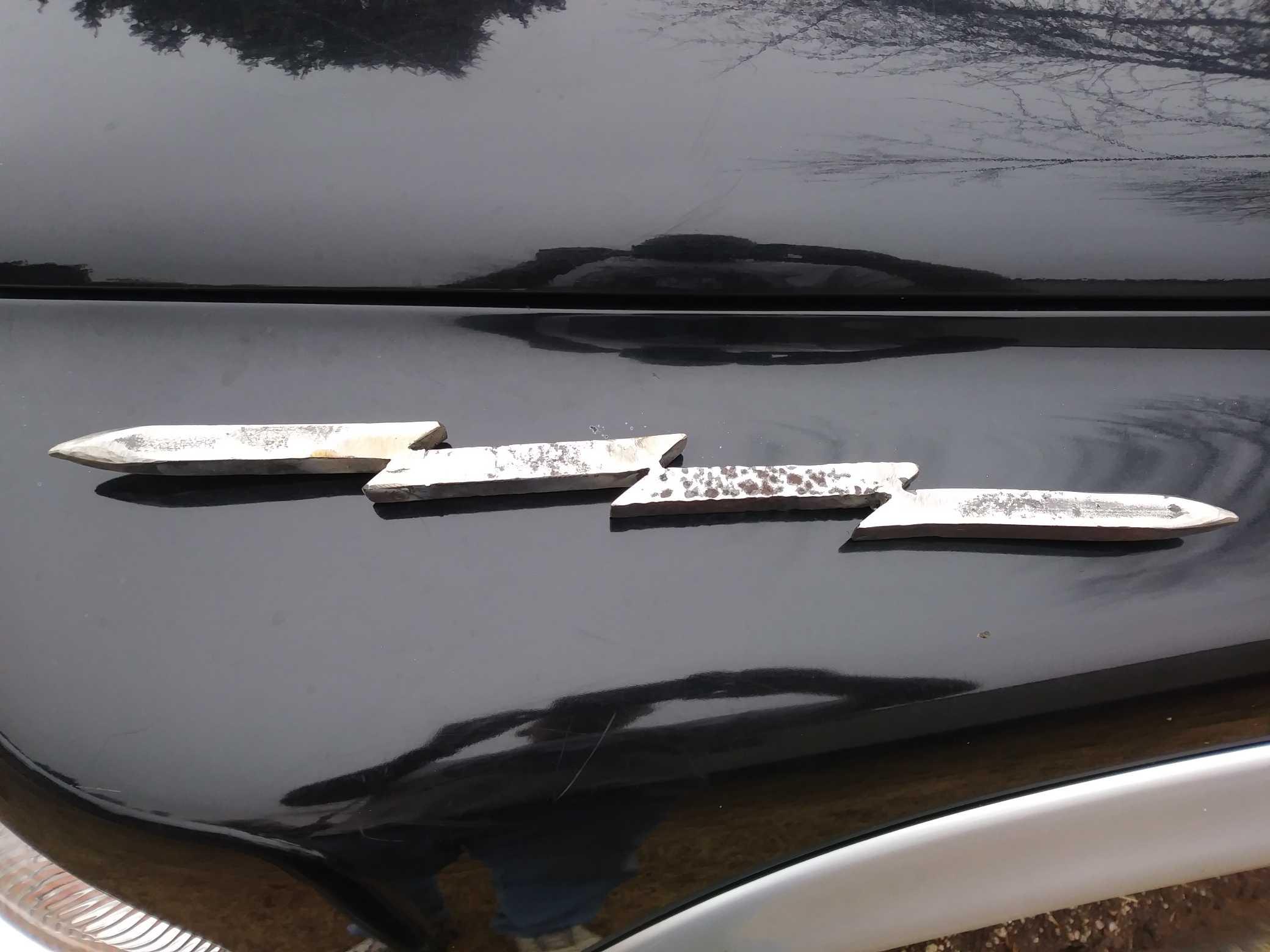

Scott NC Posted January 9, 2022 Share Posted January 9, 2022 I use them to make lightning bolts. This one was for a sculpture of Hḗphaistos. I never did finish it.... Quote Link to comment Share on other sites More sharing options...
George N. M. Posted January 10, 2022 Share Posted January 10, 2022 Nodebt, did you cut the sections and then twist them to get the offset? By hammer and hand all arts do stand." Quote Link to comment Share on other sites More sharing options...
TWISTEDWILLOW Posted January 10, 2022 Share Posted January 10, 2022 That’s pretty sweet looking Scott! 3 hours ago, Nodebt said: lightning bolts. Quote Link to comment Share on other sites More sharing options...
Daswulf Posted January 10, 2022 Share Posted January 10, 2022 Love it Scott. Was thinking how you might have made it.. thinking welded sections. Please let us know. Quote Link to comment Share on other sites More sharing options...
Scott NC Posted January 10, 2022 Share Posted January 10, 2022 Yes, they are welded. I just cut off the heads and tips on the bandsaw and tacked them together. I made 25 of them for a guy who wanted them for a security fence. Quote Link to comment Share on other sites More sharing options...

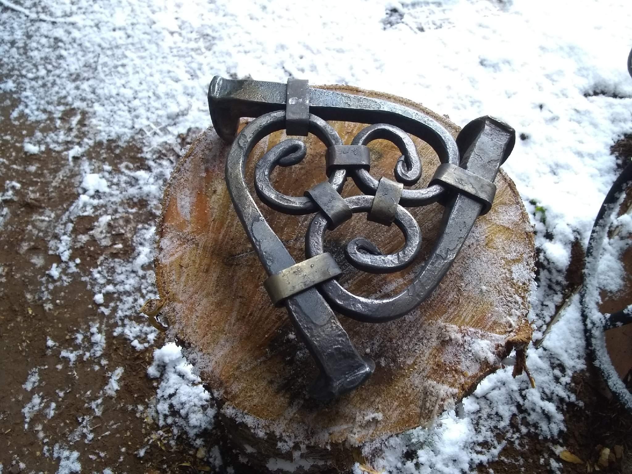

lary Posted April 13, 2022 Share Posted April 13, 2022 My second attempt at a trivet made from spikes. Quote Link to comment Share on other sites More sharing options...

JHCC Posted April 13, 2022 Share Posted April 13, 2022 That is very nice. I would only have one suggestion, and that is to make the initial curls of the scrolls more round rather than bending them over so abruptly. If you have an oxyfuel torch, you might want to try spot-heating them and re-rounding them with a pair of scrolling tongs. Quote Link to comment Share on other sites More sharing options...
anvil Posted April 13, 2022 Share Posted April 13, 2022 i agree, you could heat them with a torch and drive, gently, a tapered round punch or drift thru the eye and use that as a mandrel to shape them with a small hammer or scrolling tongs. Quote Link to comment Share on other sites More sharing options...
Frosty Posted April 13, 2022 Share Posted April 13, 2022 Nice trivet Lary, well done. I agree, truing up the scrolls would make it more attractive. Then again a customer wanting something more rough hewn might disagree. Frosty The Lucky. Quote Link to comment Share on other sites More sharing options...
