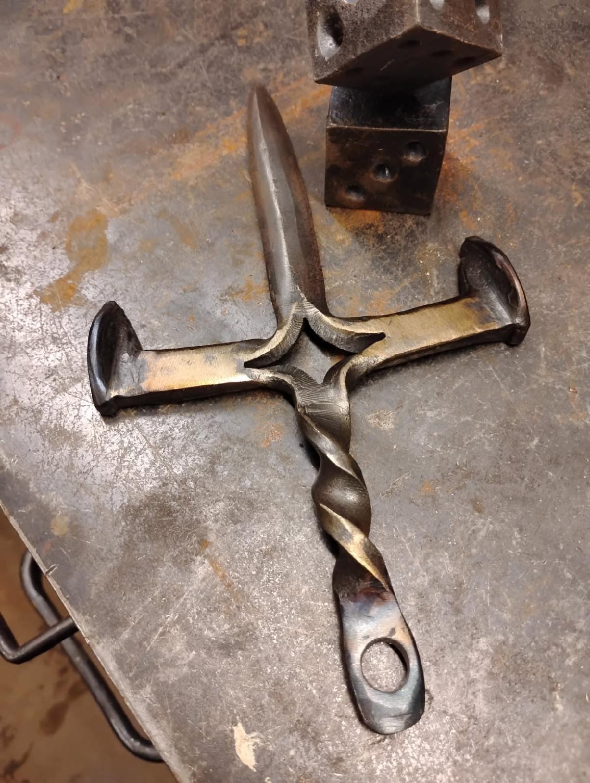

Been seeing these Fredricks cross daggers recently. Thought I'd try it. I see Chad posted one recently.
I was waiting for someone else to ask, but here goes:  Did you forge weld the spikes together and then make the cuts for the cross?  (I always wondered why they came with a scarf on the end ;))
Pretty sure it is just one spike. The other side would show the cut part of the head of the spike. On a Frederick cross the piece is cut so far one way up (in this case splitting the head of the spike head), then turned 1/4 turn and split up the other way. After that it is spread open and worked as desired. Sorry I dont know the exact amount but the "sides" (in this case the head of the spike) are cut shorter then the top and bottom which will intersect over the shorter cut to form the diamond opening.
Hope that makes sense. If not I could try to elaborate. Im sure there are diagrams somewhere on here.
Its 2 separate cuts length ways, little shorter on the head side of the spike. I used a stationary vertical bandsaw. Hate to send you off to youtube but "Fredricks cross blacksmithing" would explain it better than I can type it out. As Das said this is one spike.
I see. I’ve made crosses before, but just assumed I was looking at two complete spike heads.
And if you did start with a two-headed spike (and cut in from the side below each head, rather than straight in from the ends), you'd end up with heads on two adjacent arms of the cross.  I think . . .
