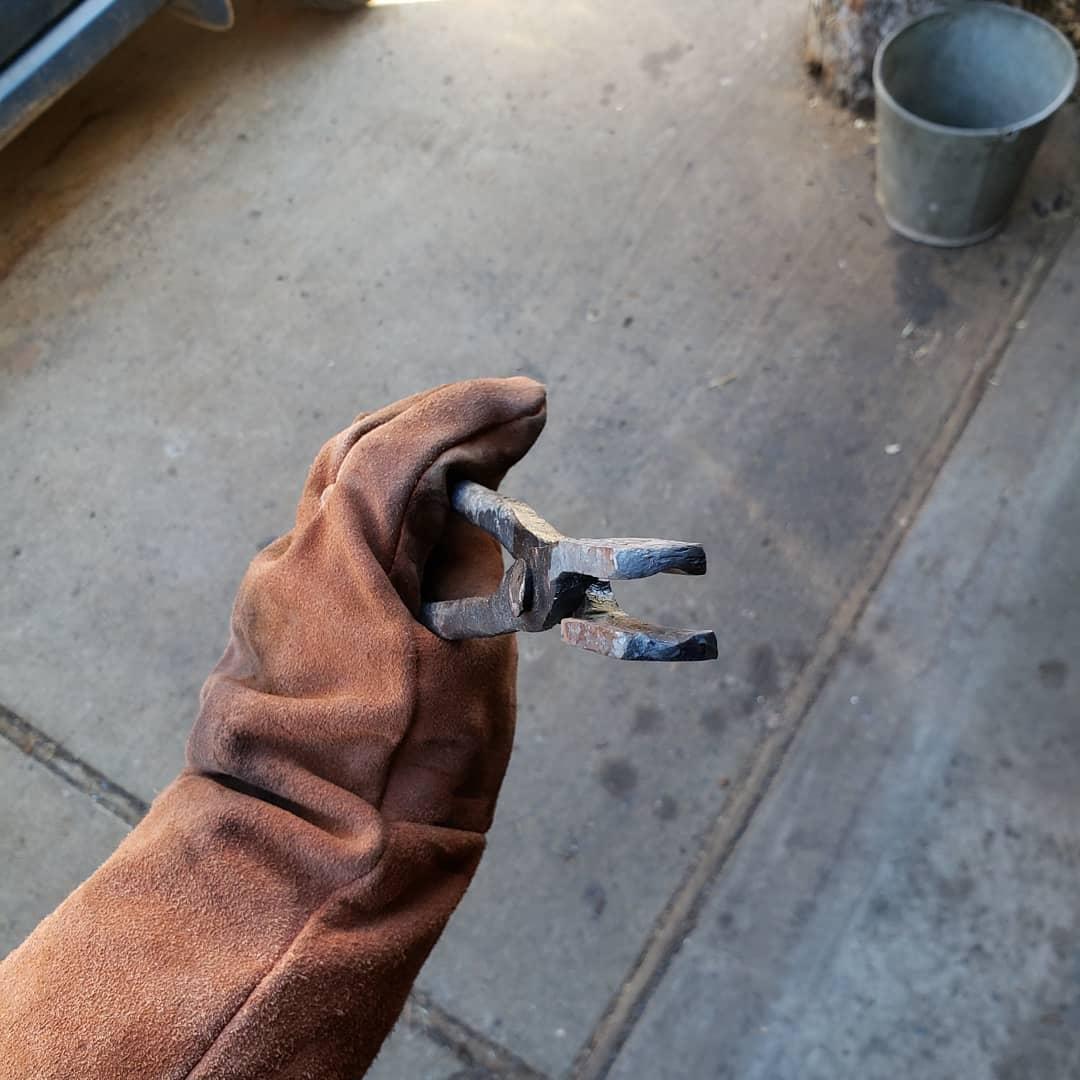

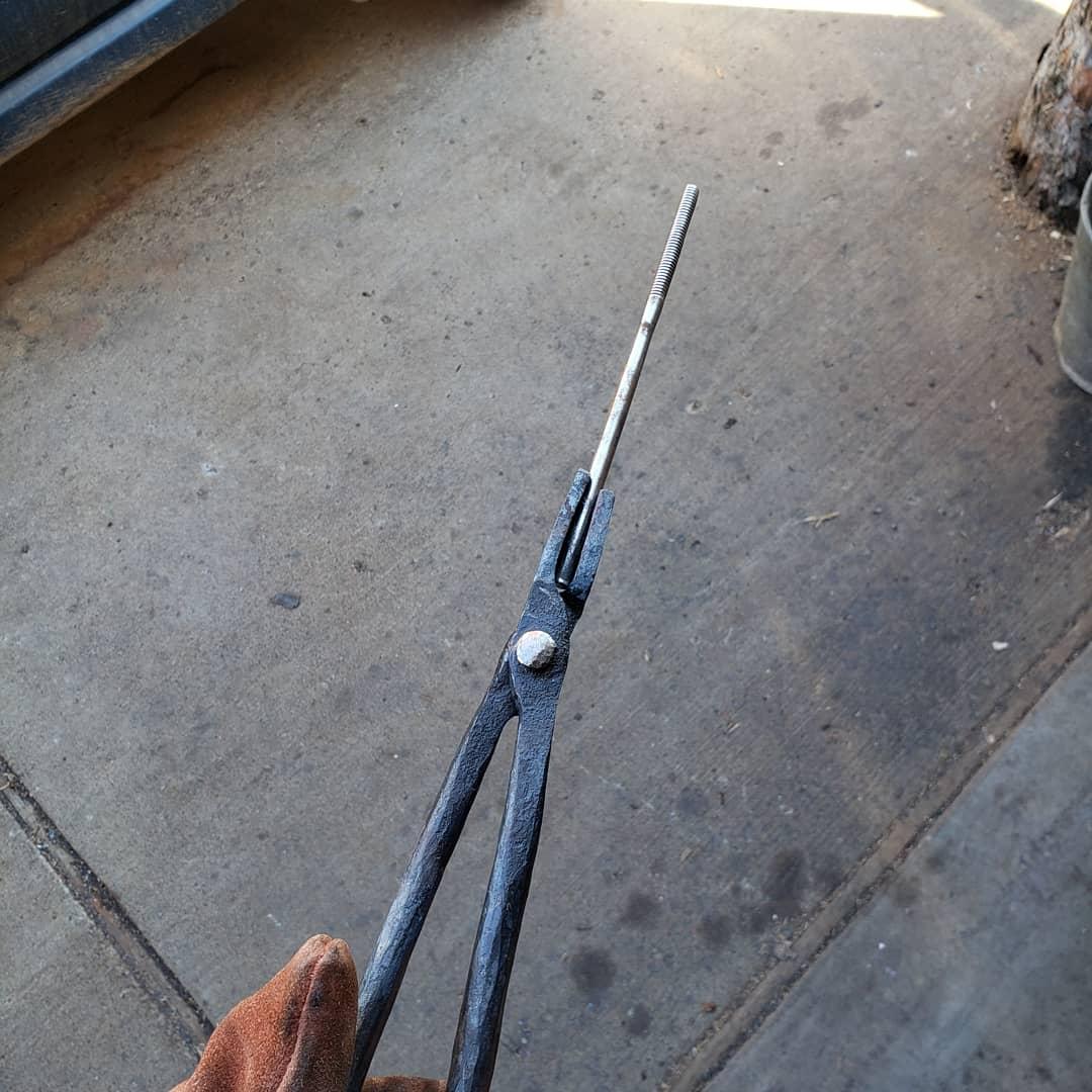

Whiskytrekker Posted April 30, 2020 Share Posted April 30, 2020 Not pretty, but pretty useful...tongs from spikes are plenty doable... Quote Link to comment Share on other sites More sharing options...
