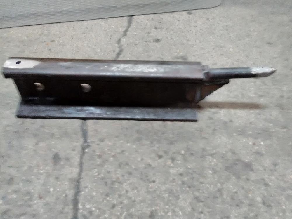

19Branden86 Posted December 16, 2017 Share Posted December 16, 2017 Here's my anvil. I have a chunk of RR track with a horn made from a backhoe bucket pin. Good hard steel. The gusset is leaf spring steel (5160 I presume). The "horn" has a hole drilled through the head about halfway into the shaft and about 3 inches deep into the rail with some 4140 bar welded into it for added support. Drilled a pritchel hole into the back of the rail. The two rivet tie holes in the track, even though I don't have a picture of the finished product, I welded two more backhoe pins in there for some heavy duty turning cams. Works great and I can do just about anything. I have another chunk of steel not shown that had a square hole already machined into it that I welded some legs on for my Hardy tools. The slightly rounded face of the rail really moves steel and for planishing I use my Hardy anvil. In tandem with the two I can do just about anything. Quote Link to comment Share on other sites More sharing options...
Charles R. Stevens Posted December 16, 2017 Share Posted December 16, 2017 You new guys go threw a lot of work welding on hunks if rail to make mediocre anvils. The shape just is at an efecent use of mass in the original horizontal orientation. Quote Link to comment Share on other sites More sharing options...
19Branden86 Posted December 16, 2017 Share Posted December 16, 2017 Mediocre is a matter of opinion, don't you think? If it works for the applications of the guy using it then who is anyone else to say it sucks? Quote Link to comment Share on other sites More sharing options...
jlpservicesinc Posted December 16, 2017 Share Posted December 16, 2017 He's not saying it sucks.. He is saying there is a better way to mount it so it is more effective.. Please try to remember there are a lot of people here who have been there and done that on their way to finding a better way with less energy... Standing that rail on end, and welding on a larger diameter for the horn if really needed.. Quote Link to comment Share on other sites More sharing options...
Charles R. Stevens Posted December 17, 2017 Share Posted December 17, 2017 The web of a heavy gauge rail is about 3/4” and 8” high, lots of spring their, so all the work to either carve a horn and heal out of rail or the pre and post heat to weld the high carbon rail still creates an anvil that absorbed quit a bit of the energy from your hammmer blows. So a mediocre anvil. Turning the anvil vertical and using the head which is 1-1/2” x3” as your striking serface puts a much more substantial mass under the hammer, one can notch the flange to produce both a double horn bick 8” long with horns starting at about 7/8”, a lot less work for a super working anvil, if you need a long flat to straiten something it’s easy to hang the stock parallel to the head, look down to see where to strike and and do so. as to who am I to judge a mediocre anvil design from a superior one? A guy who has been at this a wile and found out how not to do things, not a YouTube guru who is perpetuating mediocre anvil and forge designers. Do the two preceding rail anvils look servicible? Sure do, do they look to have been improved in praportion to the amount of work put into them? Not in my opinion. Quote Link to comment Share on other sites More sharing options...
