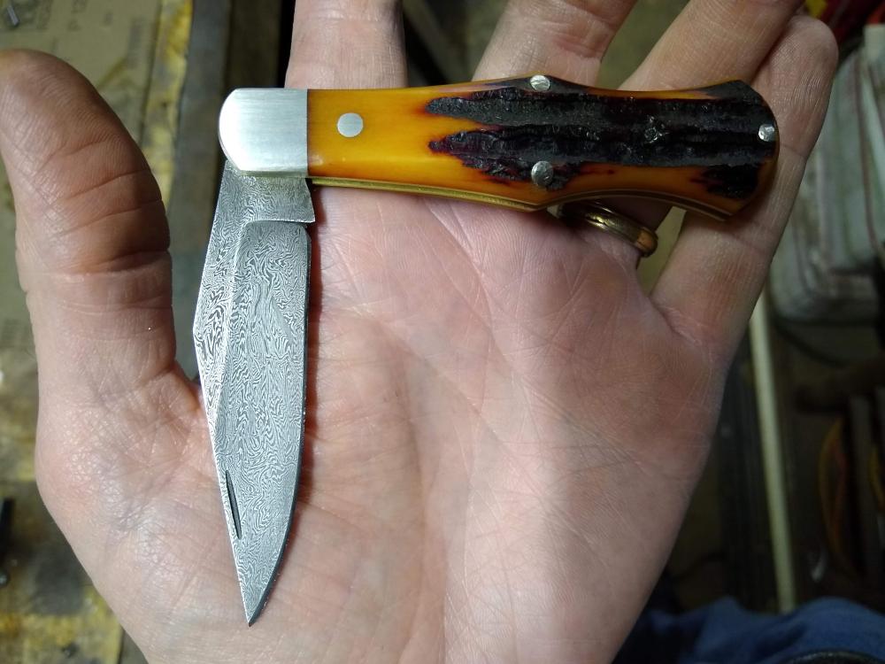

  Being fairly new to knifemaking, this build had many "firsts" to it. I forge welded an old bed frame around W2 in a taco san mai, made mokume gana from quarters, learned how to make the Japanese style handle and sheath, made an electro-etching rig, converted photos to line art, put it all together.  I still have a lot of finishing to do, but so far I'm pretty happy with it.  It's part of a project to make a knife for every type of aircraft mission I flew during my time in the Air Force.  I'll be building a matching 1911 also.CS5.thumb.jpg.8c7819e00fac157d0e5e1ec28509b5b8.jpgCS1.thumb.jpg.0743b34fb157cfa56983e9c2065f745a.jpgCS2.thumb.jpg.246aedf32f016f047d0e2f2dd803570e.jpg
Thanks for serving Samal.
Pretty nice for a lot of firsts knife. Well done. I like your attention to details like matching the grain between handle and sheath, that came out very nicely. I can't see much pattern in the mokume gane but I think understated pattern is Japanese for blade furniture.
I like it, well done.
