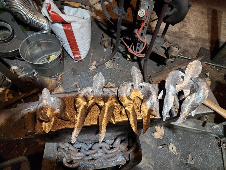

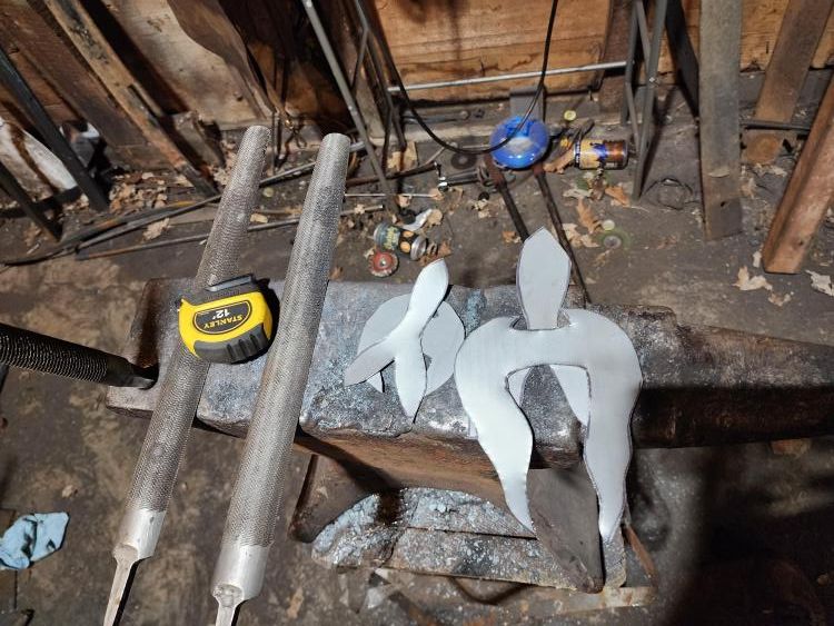

This week marks the 3 year anniversary of my getting into the hobby.   I've gotten to spend a lot of time on this in b that time.   Anyway I've been working on spring related items.  Shepard hooks of various designs,  a simple decorative chain,  fire pit tools,  knives, and I've started in on some orchids that my girlfriend, who is a horticulturist at a botanical garden,  helped me design for relatively realistic looks.  I've got them cut out and started shaping them last night.

Those are going to be beautiful Chad. Looking forward to seeing them finished. Look kind of like the Cymbidium orchid but without the middle part ... I know there are many varieties of orchids though.
My first step whenever trying to create a thing that exists in the world is to see if I can find a paper pattern for it. People make all sorts of things out of paper (especially flowers) and it looks like it would translate easily into sheet metal or forged metal.
Thanks George!  It was just the shadows, I'm going to try to get some heat oxidation on some of them in the toaster oven and catch them in the blue ranges.   Also going to go black and v hot bread brush a couple.  Here are the blanks...

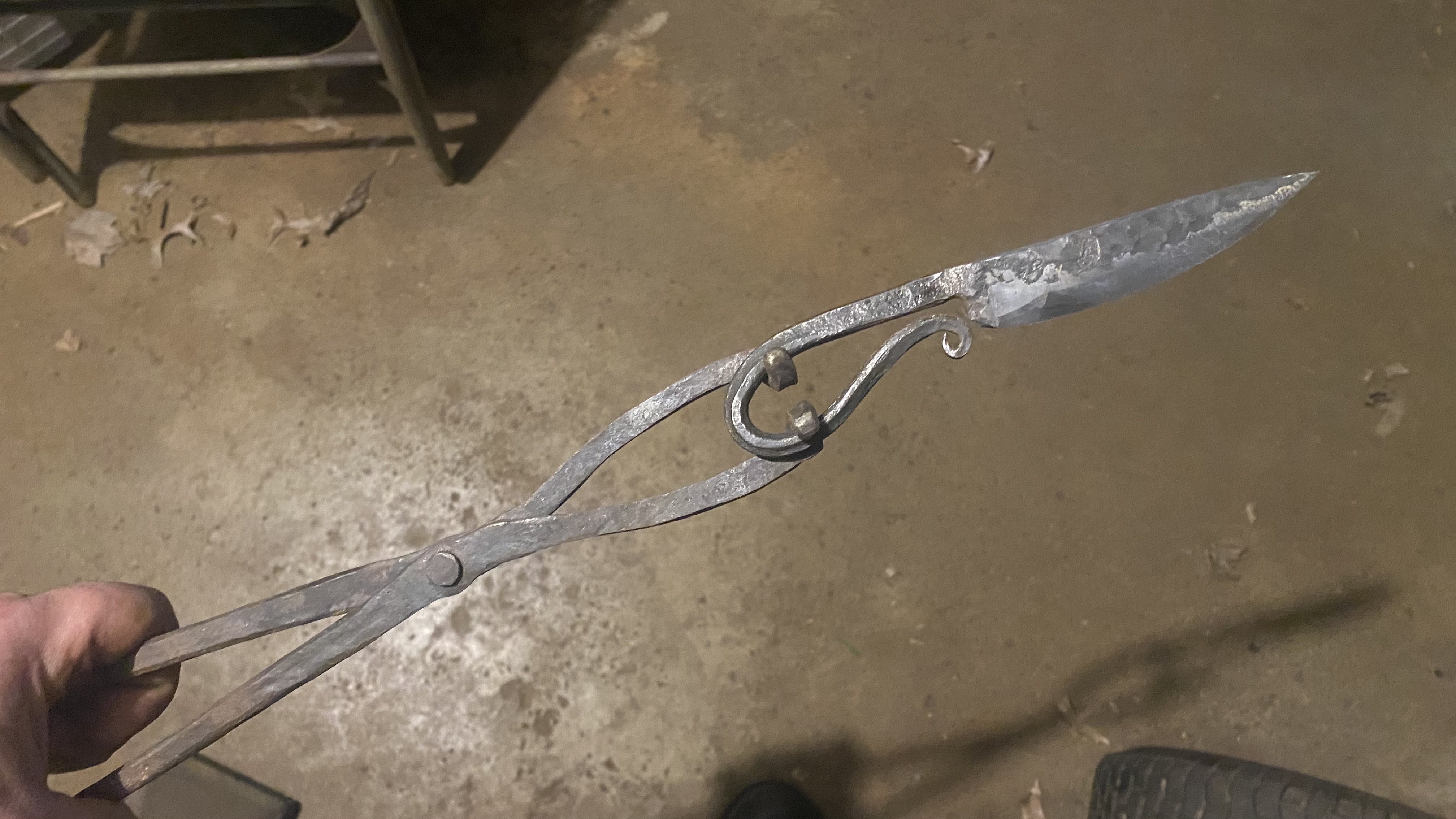

Some bladework: heat treatment and basic grinding of some long-neglected knives. The Viking knife was left behind by one of my students when they graduated; I drew out and shaped the handle and am finishing it up as a surprise.
The bottle opener tongs were great for holding the loop handle while heating and quenching.

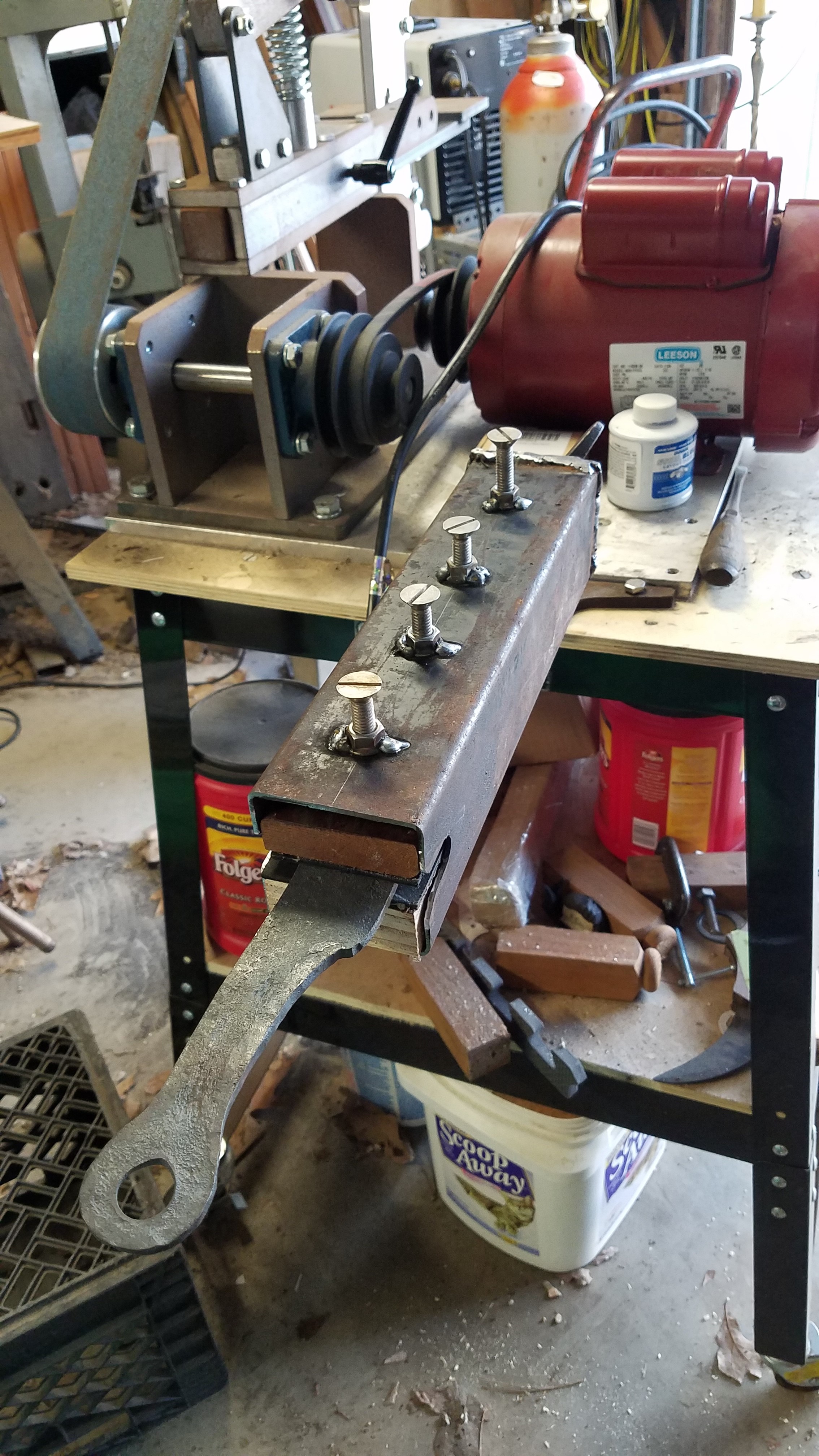

For a while now Debi has wanted another knife making jig to be able to hold the blade while working on the handle. We finally got around to it the other day.
It was a joint effort with Debi picking out all the steel from the resource piles. She did all the layout, drilling most of the holes and all the welding. I picked out the slice of RR track for the mounting base and heated it to make the bend.
A picture of a Seax I forged out at a demo, with the blade held some day I'll get it finished. The nice thing about the jig is it will rotate 360 degrees while working on the handle/scales without worrying about marking up a finished blade or getting cut.
I also made the wood inserts with leather glued on to hold the blade by tightening the machine screws down.
I also got to drill and tap the end plate for the stud & big wing nut I found in the pile. Loosen the wing nut to rotate the jig or take it off the mounting bracket.
The knife also fits in like this, so one can work on the spine. All that's left is Debi wants to paint it with Rust-Oleum hammered grey paint.

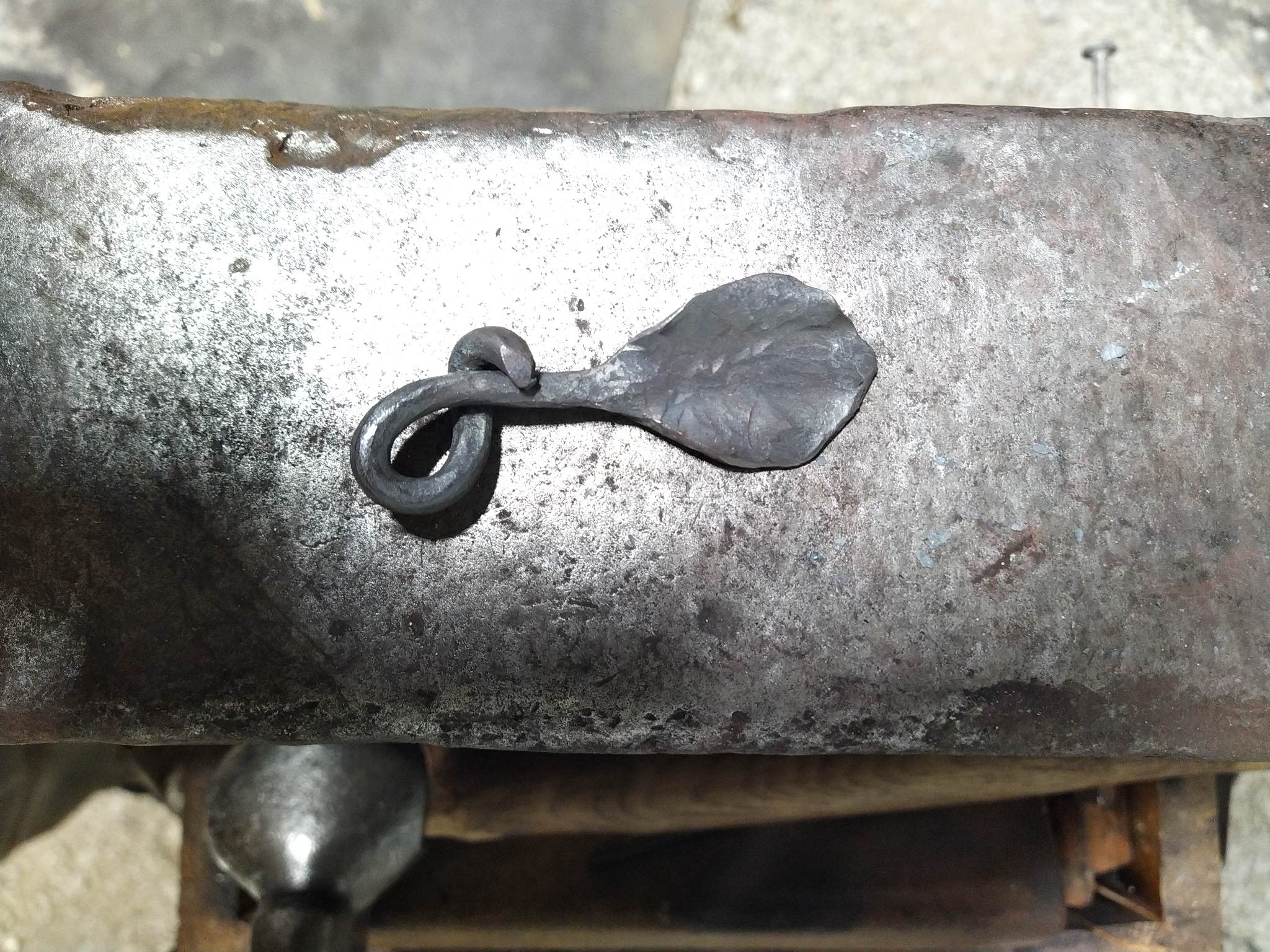

More ABANA NC stuff. Tonight I worked on S hooks and leaves.
The evening started off not great with focus. I was making dumb mistakes. First S hook I started to hook the second side in the same direction as the first side... Oops... Straightened out and hooked it the other way. Then realized the curls I'd made weren't facing the same directions. One faced in and one faced out. I dropped it and moved on to the next one.
Second hook I tried my first fishtail curl. That went okay and the first side of the hook looked good. Start the fishtail on the other side... And then realize I didn't rotate the piece so the fishtail is now perpendicular to the other. Oops... So I decided I'd just square the center and twist so it looked like an intentional design element but would also fix my error. Win!
Leaf is a little fat but overall I was happy with it. No cracks, mostly equal sided, and I even got a bit if a center ridge and some waviness! The video shows off the leaf better but I included the pic as well for those who don't have the bandwidth to watch video.
Good Morning Shain,
Instead of making your round material square, so you can twist it, knock 2 flats where you want to twist it. Use your Handled Hot-Cutter to make a fairly deep line, the length of the Flats, on both sides. Now when you twist it, it will look like 2 pieces of round that were fire welded to the ends and then twisted. Very simple to do, VERY different and attractive effect. K.I.S.S.
Neil
Oh NO you turned a hook the wrong way!:o Welcome to the club, it happens to everybody. A twisted shank on an S or wall hook is often an indication someone turned a hook backwards. It's a simple effective and very much traditional blacksmith "fix".
Leaves just take a little practice.
I find that upsetting the "end" back flat makes reverse or fish tail scrolls suit my tastes.
Nice S hook, next time it goes backwards, give Neil's suggestion a try, it's fast easy and looks attractive.
Neil & Frosty, I've done the rope twist and other chiseled twists before - and for me it's not more simple (especially on these little fiddly pieces) but it is definitely more attractive! Squaring & twisting took me 2 heats (the twist should have had another heat, as evidenced with the uneven twist,lol). The chiseling alone would have taken me at least 4 heats, possibly more - just because I'm still so slow at it, lol
I tracked my heats on the leaf because I had seen an Instagram post by the same person who instructed the first class. He had put out a challenge to create a wrapped leaf in less than 10 heats. This leaf took 20 heats - and 10 of those heats was just drawing out the stem square (then one heat to octagon and two heats to round). So I really need to work on getting more efficient in that department. I'll give Brian Brazeal's video another look - I remember he showed how to forge a tong blank in one heat, including drawing the reins. There are a ton of various methods for drawing out but I remember trying his in clay and thinking it was pretty efficient. Could also be I'm just not using full swings so I'm not moving as much metal as I could. I have a bad habit of that. I need a pre-recorded message that just plays in the shed every 5 minutes or so "Full Swings!" :lol:
More practice is definitely on the way. I used up all my 5/16" stock practicing staples. I even bought an extra bar! Sheesh. So I'll pick up FOUR bars of that tonight - that oughta do it.
