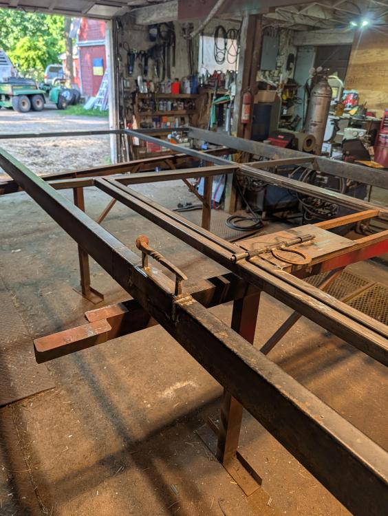

Building new rolling door frames for the neighbor's new pole barn. This door has a man-door framed within it. Jazzed it up a little with a horseshoe for the bolt and a twisted RR spike hand-grab for the main frame.

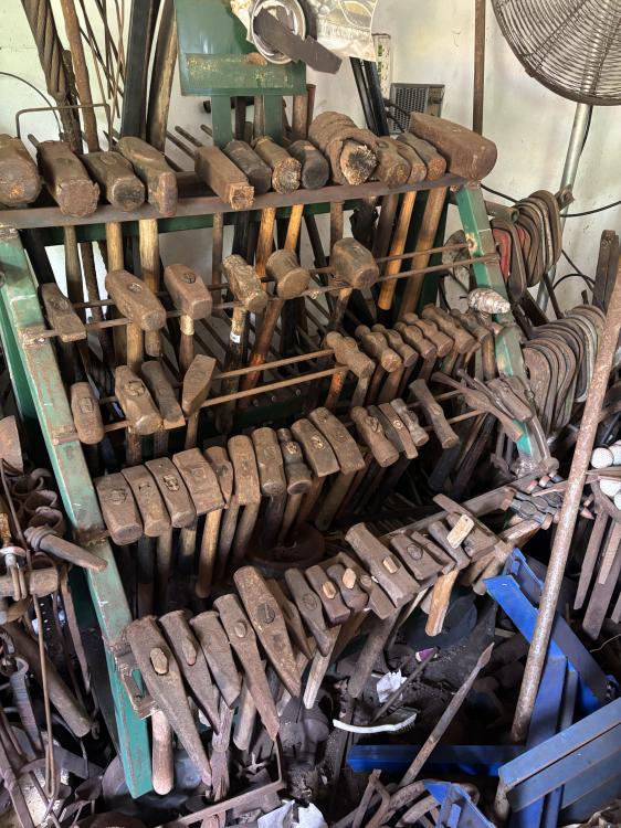

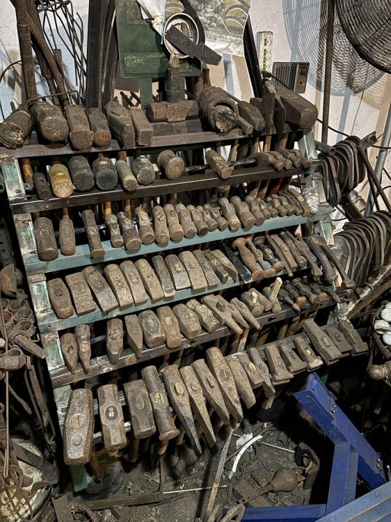

Shop infrastructure project today, expanding the capacity of my hammer rack (trying to catch up with my expanded hammer collection). This involved cutting the paired horizontal bars, moving the bottom set down, and putting in four new sets to replace the previous three.
Before:
After:
It's gorgeous but if you keep it up you may need to reinforce the foundation and possibly the bedrock.
Did you dress that spalled one on the top, two from the left in the first pic? That looks like one I would know better and still be using anyways and then be cussing when I got a chip in me.
