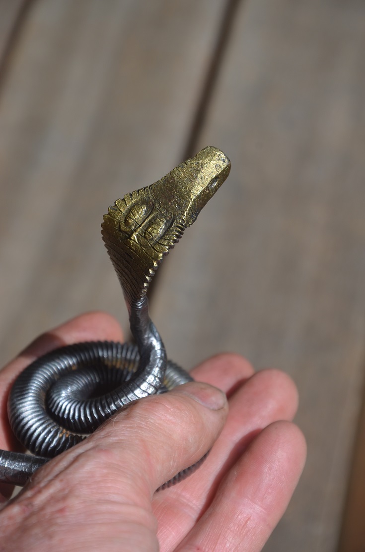

ausfire Posted March 28, 2018 Share Posted March 28, 2018 Cool hairpins, Gergely. The textured copper looks great. Nice how you have brought in the historical aspect with those old straps. I made another cobra or two today with Jennifer's idea of making the rings on the hood. Had to make a quick oval punch. Here's what happened. I'll refine the punch a bit so it cuts deeper. Quote Link to comment Share on other sites More sharing options...
JustAnotherViking Posted March 28, 2018 Share Posted March 28, 2018 Nice! Could you possibly flatten the belly of the snake a bit by hammering it hard into a wooden block so the top side smooths, and leaves the threads on the other, or even file one side before bending to shape (just looking at the top of the neck where it flares out into the hood)? Might make it more difficult to bend it to keep the belly side down, but it would add yet another depth of texture to it. Quote Link to comment Share on other sites More sharing options...
jlpservicesinc Posted March 28, 2018 Share Posted March 28, 2018 ausfire, that is so cool.. Nice job.. Number stamps or did you make up a special punch.. You building up inventory?? Big show coming up? Quote Link to comment Share on other sites More sharing options...

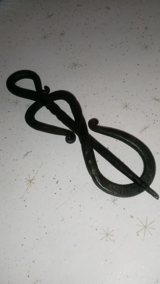

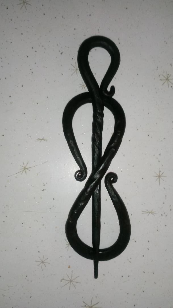

SFC Snuffy Posted March 28, 2018 Share Posted March 28, 2018 Bad estimation on my part. I knew what I wanted to make (a hairpin - hairpiece?) and had a good idea of how to do it. I used the stock I had available at the time, and this is what I got: I think it's nicely proportioned, and considering all the bends were done with a hand-held bending fork and a hammer I'm happy with it. But... it's about 50% too large. So it's a success as a proof of concept, but not as the gift I intended. Next week I'll flatten the one piece out and keep it as an S-hook, and maybe thread the other for use as a plant hanger or some such. I'll try again with 1/4" or 3/16" stock. Quote Link to comment Share on other sites More sharing options...
Frosty Posted March 28, 2018 Share Posted March 28, 2018 It's good as it is, it's just a blanket pin. You mislabeled it is all. Frosty The Lucky. Quote Link to comment Share on other sites More sharing options...
ausfire Posted March 28, 2018 Share Posted March 28, 2018 On 3/28/2018 at 6:37 AM, jlpservicesinc said: ausfire, that is so cool.. Nice job.. Number stamps or did you make up a special punch.. You building up inventory?? Big show coming up I made a special punch but it was a quick job and I think I can do better. I never thought of using the 0 number stamp ... another idea you have given me! And yes, I am building up some stocks. This is our quiet time at the Village Forge because it's the wet season here and flooding etc limits tourist travel. It's a good time to catch up on some maintenance and practise a few new things at the forge without too many on-lookers. However, things really ramp up over Easter and I want plenty of items available in the shop. We are hoping the roads will open very soon or we will be depending on local custom over the four day holiday break. Quote Link to comment Share on other sites More sharing options...
Irondragon Forge ClayWorks Posted March 28, 2018 Share Posted March 28, 2018 SFC Snuffy it's perfect for holding the cloak shut like a pinnanular. Quote Link to comment Share on other sites More sharing options...

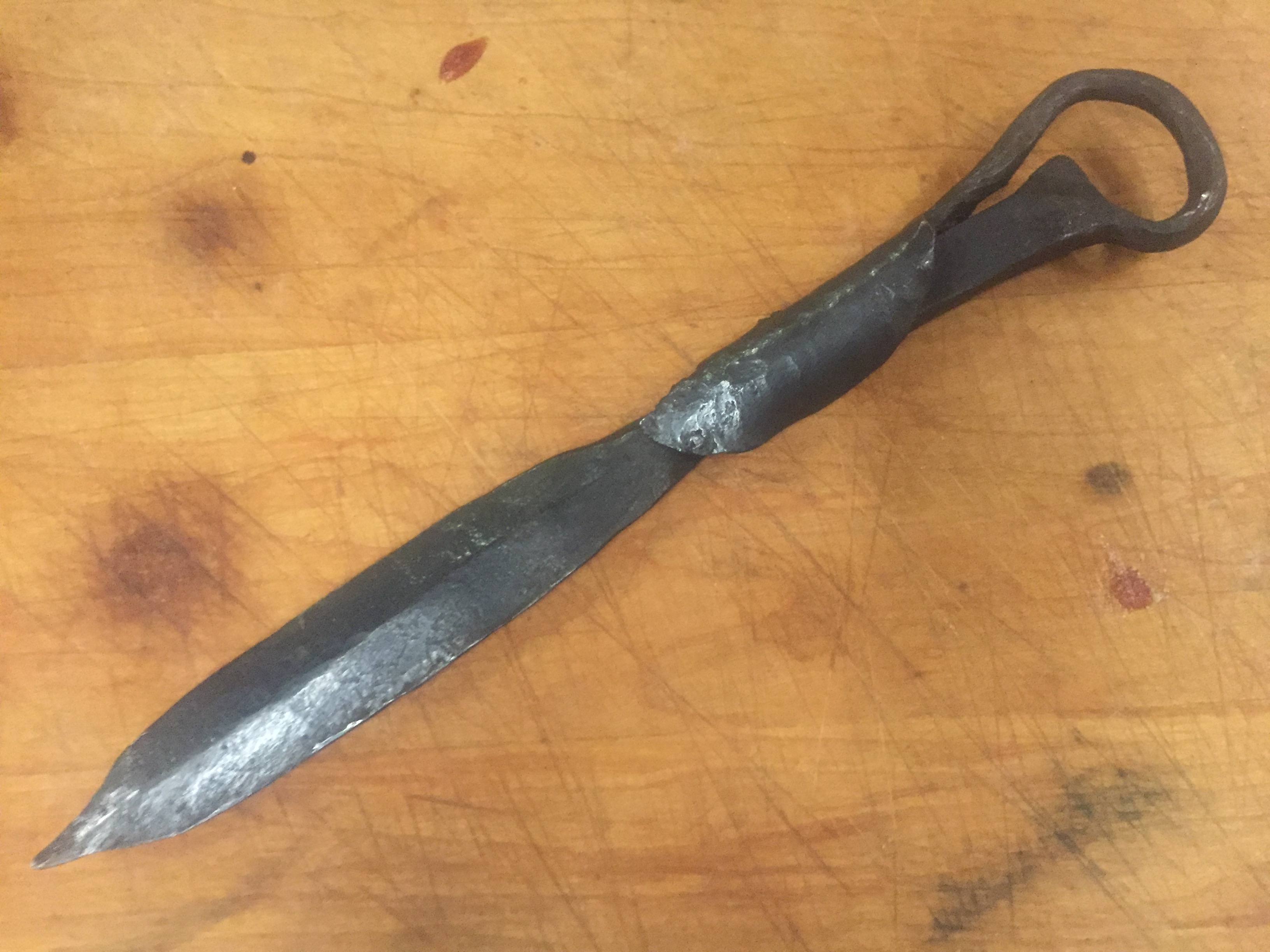

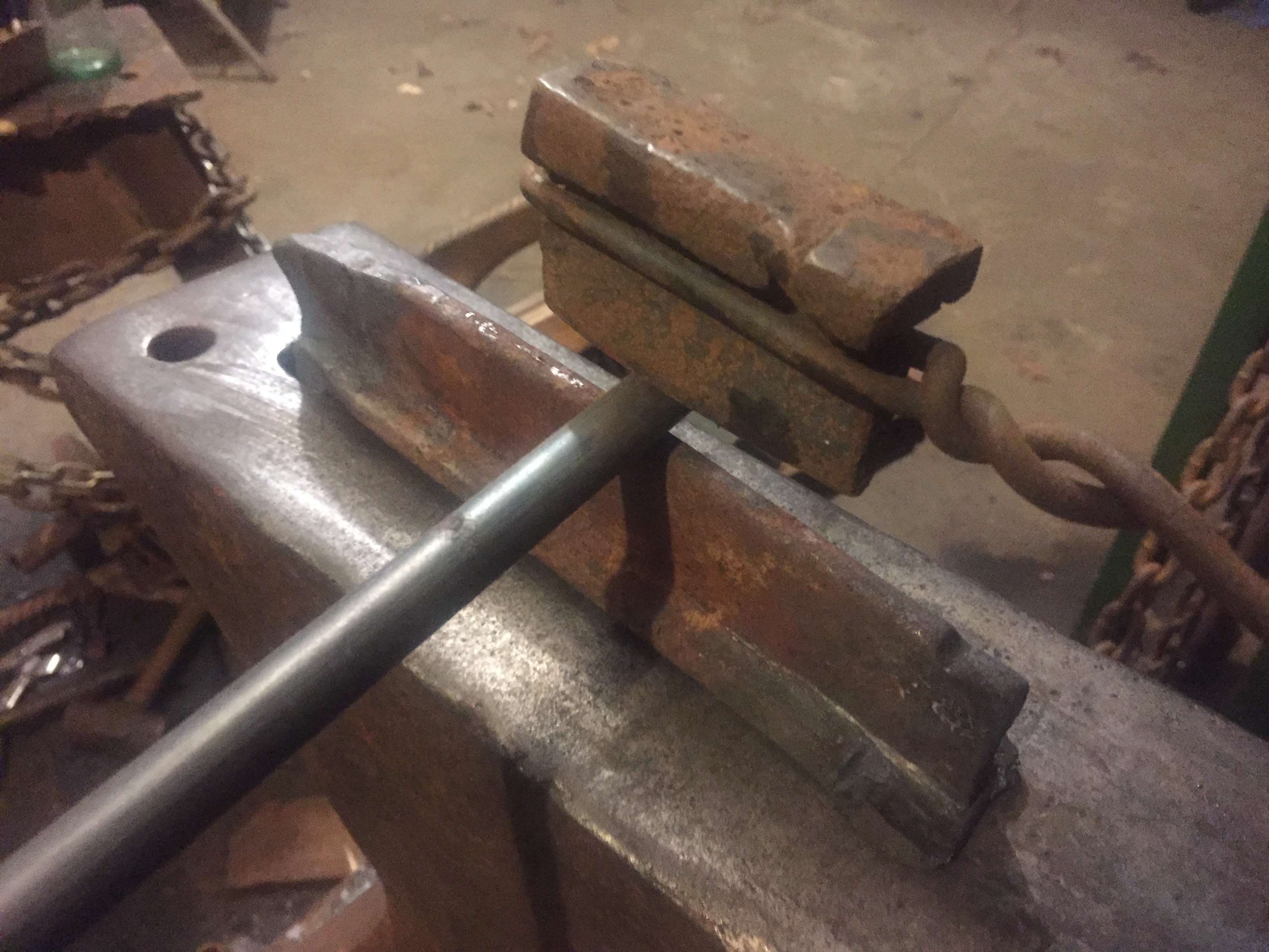

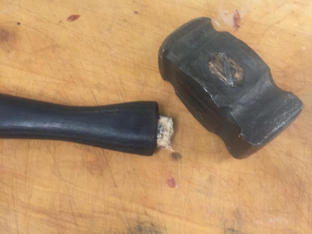

JHCC Posted March 29, 2018 Share Posted March 29, 2018 A friend asked for something with a leaf, so I made her a combination letter & bottle opener. Of course, the leaf burned at the last possible moment. Made a bottom fuller from a FAIR rail anchor, long enough to reach the part of the anvil where the treadle hammer hits: And snapped the handle off my rounding hammer! Quote Link to comment Share on other sites More sharing options...
