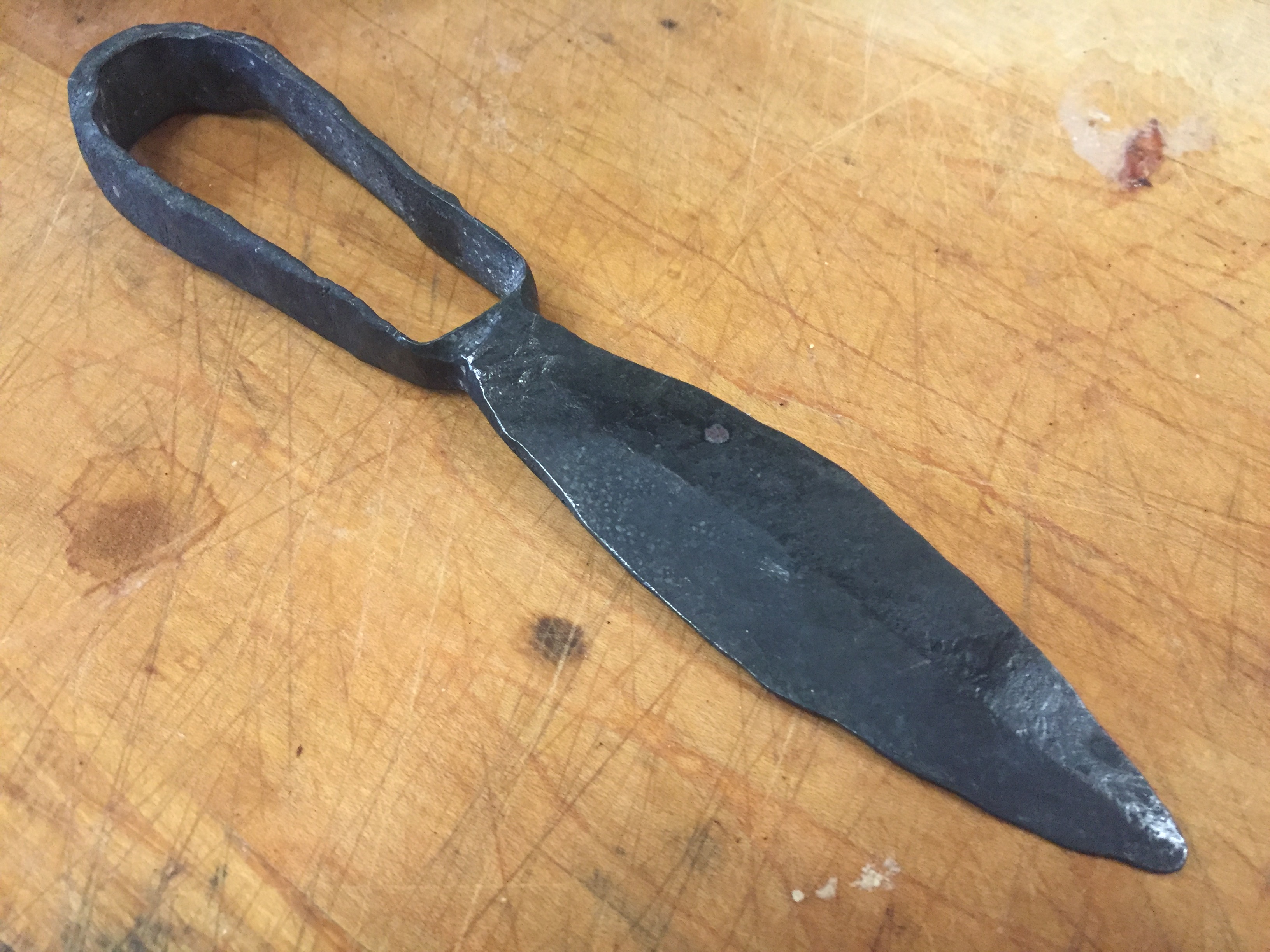

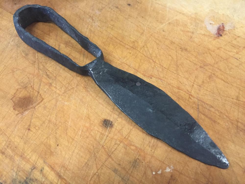

JHCC Posted March 25, 2018 Share Posted March 25, 2018 Rough-forged a knife, based on an African dagger in the Cleveland Museum of Natural History. Once this is finished, I think I might give it to my friend Charles, who just got tenure as a Professor of Africana Studies. (Coil spring, total length = about 8”) Quote Link to comment Share on other sites More sharing options...
jlpservicesinc Posted March 25, 2018 Share Posted March 25, 2018 JHCC, that is really cool.. How big around was the spring? Diameter ThomasPowers, sounds like it was a great morning.. was the SCA good also? Quote Link to comment Share on other sites More sharing options...
JHCC Posted March 25, 2018 Share Posted March 25, 2018 5 minutes ago, jlpservicesinc said: How big around was the spring?l 5/8” Quote Link to comment Share on other sites More sharing options...
jlpservicesinc Posted March 25, 2018 Share Posted March 25, 2018 JHCC, you did a really nice job.. did you upset the handle portion to get enough material.. Looks like its about 3/16" thick in the handle web.. Clean transition in the ricasso area as well.. Quote Link to comment Share on other sites More sharing options...
JHCC Posted March 25, 2018 Share Posted March 25, 2018 3 hours ago, jlpservicesinc said: JHCC, you did a really nice job. Thank you! I started with about 18” of freshly straightened coil spring. I split and drifted about 2-1/2”, starting about 3” from the end (the treadle hammer came in really handy for this part). I left the knife attached to the rest of the coil, which made a convenient handle. There was some upsetting at this stage, as I rounded out the ends of the slit by hammering them on the tip of the horn. Then I drew out the sides of the handle to increase the circumference. The next step was to preform and bevel the blade, deliberately leaving plenty of meat for filing/grinding to final shape. Next, I cut off the excess coil I’d been using for a handle, rough-shaped the butt end of the handle, tweaked the handle shape, heated to critical, and put in lime to anneal. Next steps: grind, harden, temper, finish. Lessons learned: 1. Next time, cut a longer slit. Maybe use a slot punch at the ends. 2. Shape the blade before drawing out the handle. The thin sections bent a lot as I was preforming the blade, and that led to some stress cracking (which I think/hope I got all ground out). 3. Upset more material into the ricasso. The original has some little prongs coming off the base of the blade, and I didn’t have enough material to attempt them. Quote Link to comment Share on other sites More sharing options...

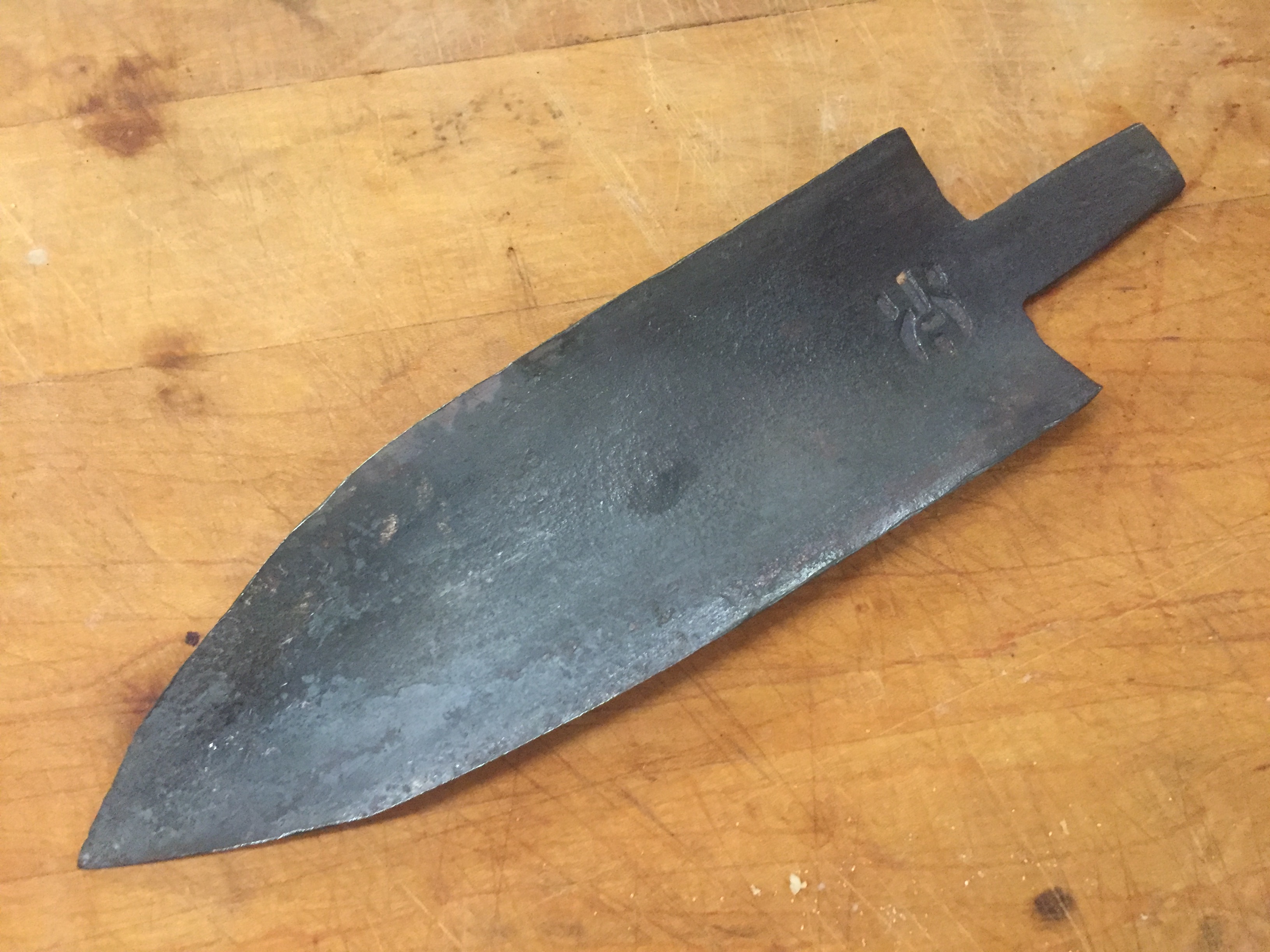

JHCC Posted March 25, 2018 Share Posted March 25, 2018 Also this: my neighbor wanted a hori hori with a longer than usual blade, so I made this to his specs. Material is a John Deere lawnmower blade without any heat treatment beyond as-forged normalization. (The blade is about 9”. I personally think the tang is too short, but that’s how he wanted it.) Quote Link to comment Share on other sites More sharing options...
jlpservicesinc Posted March 26, 2018 Share Posted March 26, 2018 @jhcc you guys are all killing it.. I do one project every few weeks and think i got it going on.. Well done.. How is the handle going to be held on? Quote Link to comment Share on other sites More sharing options...

JHCC Posted March 26, 2018 Share Posted March 26, 2018 21 minutes ago, jlpservicesinc said: How is the handle going to be held on? I think he plans to epoxy it; I'm going to recommend he put in at least one pin as well. Quote Link to comment Share on other sites More sharing options...
