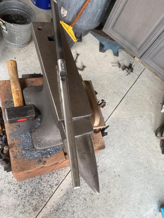

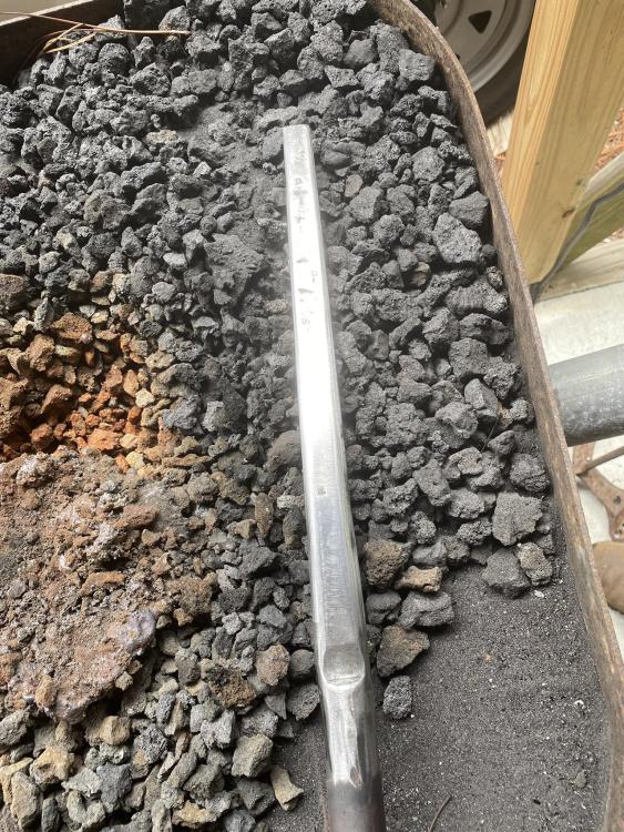

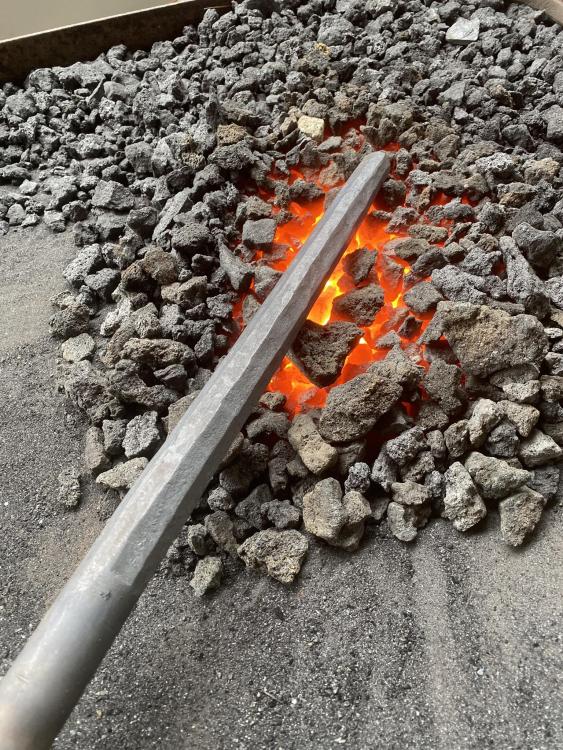

I finally made the dreaded hammer eye drift.  It wasn't so bad once I gave in and used the DKE12 press and DKE66 hammer.  Still did quite a bit of handheld hammer work.  I tried to follow TA's method: draw out a square taper, go to octagonal, then 16 sides (at least in spirit), then flatten out to an oval cross section.
I intended to make it a 1-1/4" x 7/8" racetrack oval tapered down over 10" to 5/8" x 5/16".  Got pretty close at 0.67" x .38" at the tip, .98" x .73" at 10", and 1" x .75" at 11".
I need to trim down the handle, but not too much so I can keep my hands away from the hot hammer billet.  What's a good length for the handle portion?
Finally, look at that big clinker.  I think it's my biggest one yet.  I'm going to vacuum-encase it in epoxy and make a really interesting paperweight.  JK. :lol:

FYE Chellie, a drift is meant to size holes precisely and are tapered at both ends like a lozenge with a cylindrical center section. I don't recall which is preferred, straight or curved tapers. Overall length is more a factor of how thick the stock to be drifted is. The tapered ends need to be longer to the straight section than the thickness of the steel being punched and drifted. If not, you can drive the drift through and out with a flat ended punch but you have to move F A S T er because you're stopping to grab the punch and even one less blow can matter.
The cylindrical (straight) section doesn't need to be as long as the target is thick but it needs to be long enough it doesn't cock in the hole easily and make golly wobbly hole. The tapered sections need to have "points" just smaller than the pilot hole you punch. They don't need to come to a "sharp" point, you need to hit them with a hammer and maybe a flat ended punch so just smaller than the pilot hole.
In use you have to get the target HOT, yellow is best and drive the lubricated drift through F A S T! It has to be fast because the drift will draw heat from the stock causing it to shrink while the heat it absorbs causes the drift to expand. If you stop part way through you'll have to drill it out unless you have an electron discharge machine handy. Why? Having a piece of steel in a hole smaller than it is is called an "Interference Fit." Just a couple thousandths of an inch and it's stuck like they're welded.
Lubricant is important to help keep the drift moving. Without powdered graphite, coal dust, lithium dry lube, etc. friction can cause all kinds of problems worst is of course stopping in the hole.
Long tapered punches can only drift tapered holes, if you drift to an equal depth from both sides an hourglass shape hole. Long tapers have greater contact area than a lozenge shape(?) The taper will be in full contact and heat VERY quickly and get locked in.
