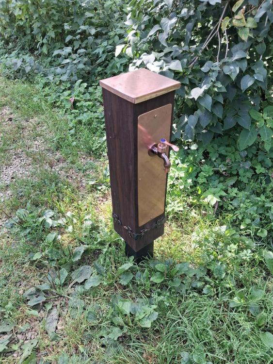

Beautiful as always Alex. I've liked your shelving units from the first and the water tap would make any garden beautiful. I assume it's easy to drain for winter, we have to drain all outdoor spigots back to the house or below about 2m depth.
What are the screw plates and toppers? Railing or stair banister ends?
I love that water tap, Alexandr!

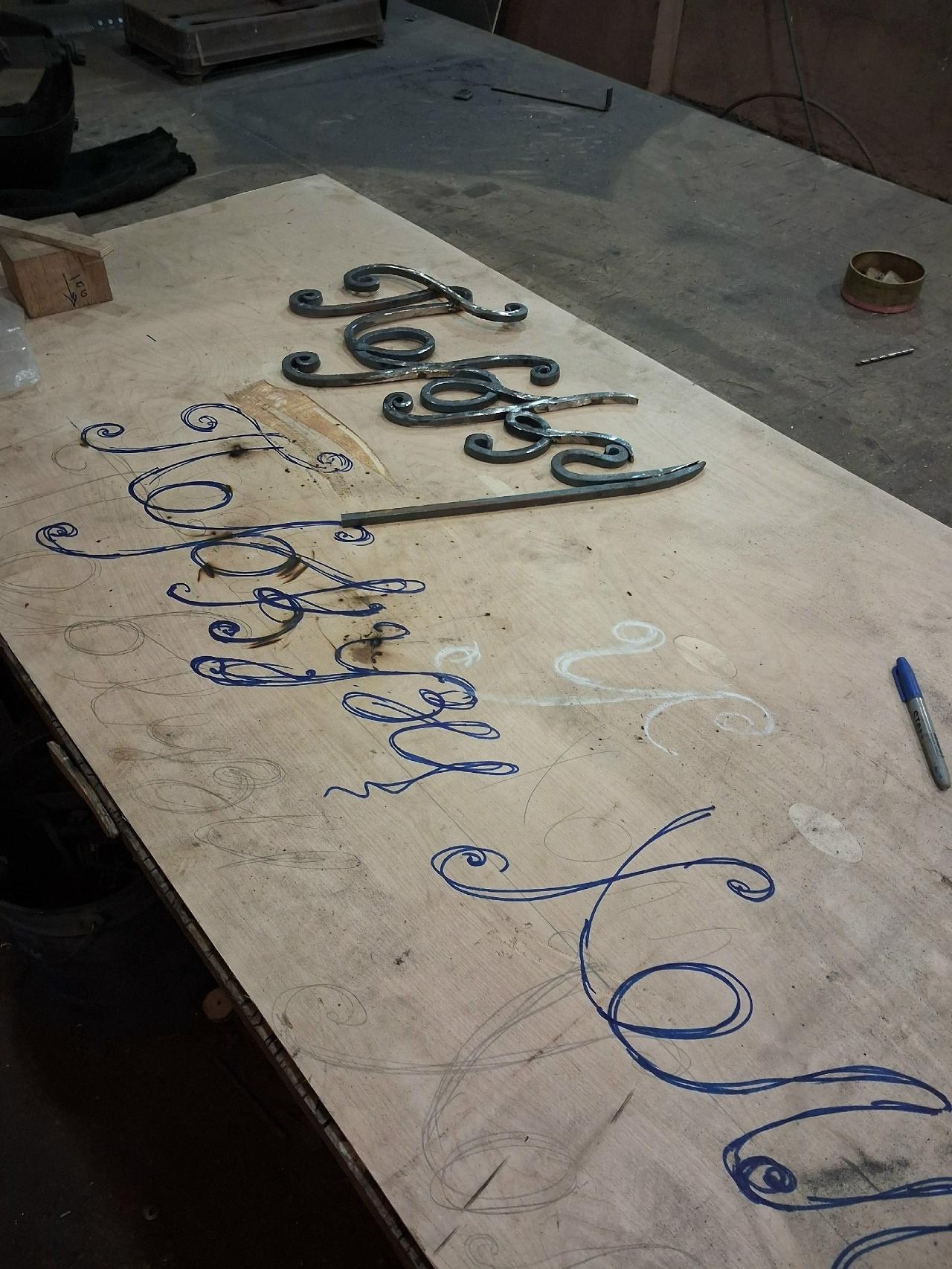

Alexandr, what does the sign in the second pic say?
Sign at the entrance to the house. Porkuzi hall. Porkuzi is a village. ПОРКУЗИ

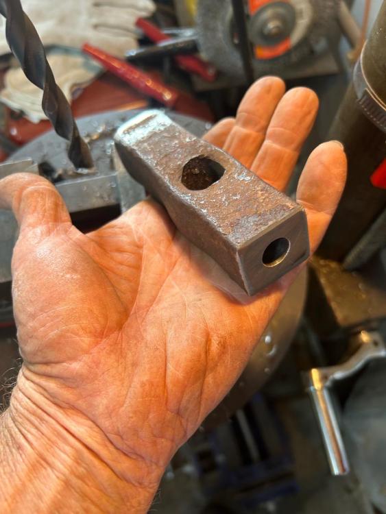

I turned an old swap meet find square hammer / set tool into a monkey tool for 1/2” tenons.

And oh my gosh - using a square hammer to create a monkey tool?! Brilliant.
That little square "hammer" is actually a bottom tool, you can tell by how the far end is mushroomed slightly. It's called a Set and used to flatten precise areas on forgings where a flatter wont fit.
Making your scissor blades flat and smooth is what flatters were made for. You can improvise a flatter with a piece of thick flat steel say 1/2" or thicker plate maybe 2-3" square. Just lay it on the hot blade contact side down and smack the plate with a hammer, repeat on the other blade and viola! A little draw filing and block sanding and it's "OOH SHINY!".
