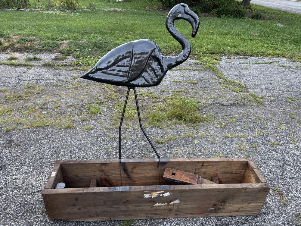

In other news, the first coats of paint are on the flamingo.

JHCC, liking the flamingo. Is he going to be pink?
Black with red eyes. The assignment was “[six letter expletive beginning with ‘bad’] flamingo”.
Ooo cool! He'll be the baddest flamingo on the block. Smoke coming from his nostrils would be a good effect.
Yeah, that's a pretty B A D Flamingo alright, too bad you didn't put red LED eyes in it. I like it.

I hope your customer anchors the legs in 80 lbs of concrete to deter those of the porch-pirate class of human being.

That flamingo is freaking great!  Love it.
