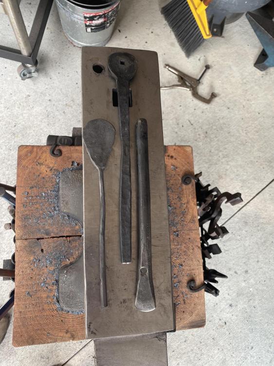

I went out to the smithy this morning because we're only in the high 80s today.  I was going to make some nails myself, so I dug up my nail header.  I think it was the very first tool I ever made...and it shows.  I made it out of a railroad spike.
But first I had to fix the hole.  It wasn't really tapered as far as I could tell, so I found a file with the perfect square tapered tang, reheated  and drifted it some more.  Then I tried to make some nails.  Wow.  After two attempts, I quit, realizing I needed a review.  I had a problem with turning a square cross-section into an irredeemable trapezoidal cross-section.
So I went to making a new fuller out of a piece of coil spring and making that last leaf I need for a pair of shelf brackets.  I hopefully got the right curves on the fuller.  It sort of looks like the one from Brian Brazeal's video.  I think my fourth leaf will look really good.

I think I need to round off the corners of the fuller some more now that I compare it to Brian's.

As a general rule, the tool should be shaped as the negative of how you want the workpiece shaped.

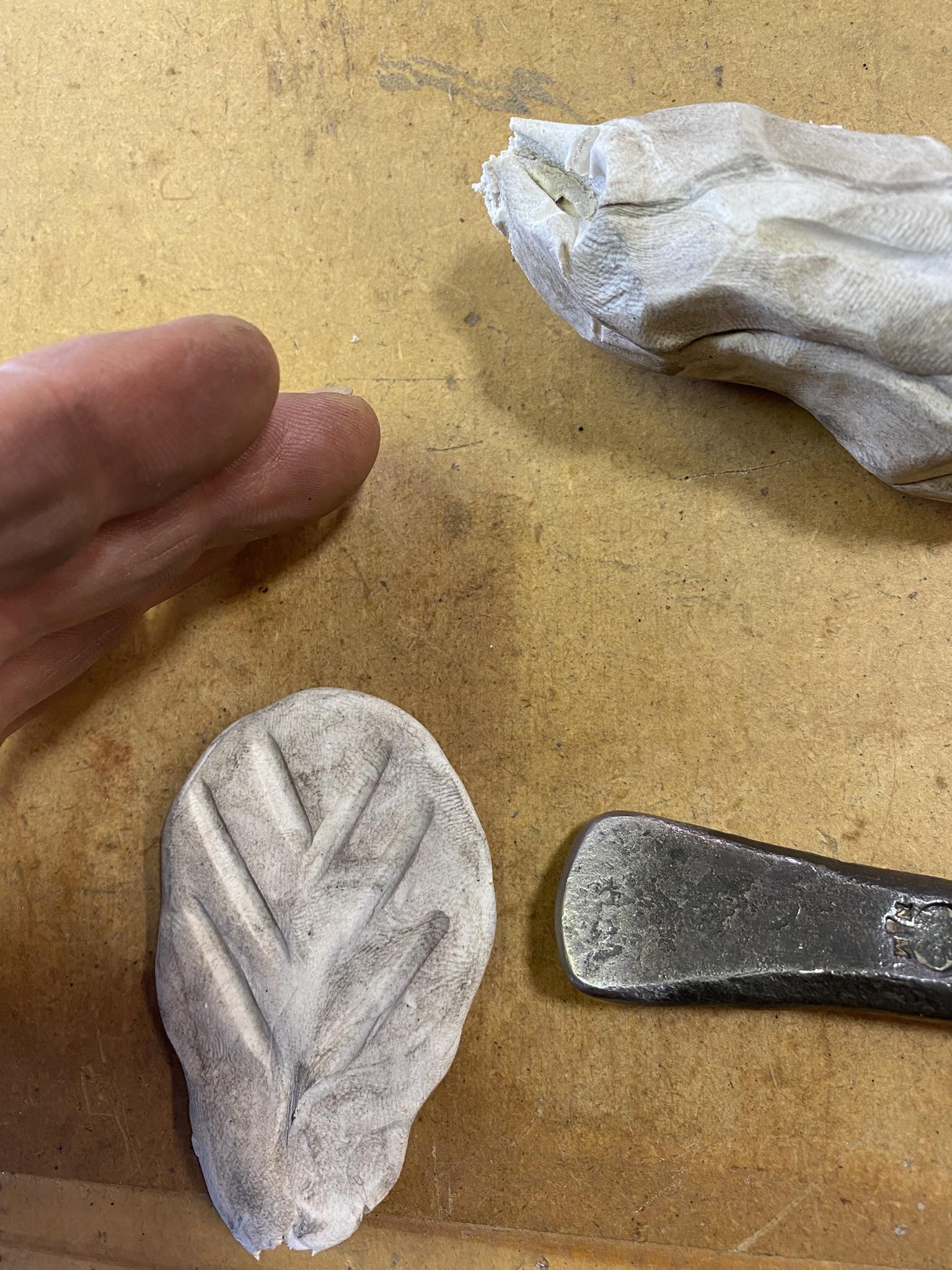

A fuller needs a GENTLE curve, visualize an axe blade and ends rounded JUST enough it isn't cutting sharp divots. Half round profiles makes an embossing tool, not a fuller. Similar but different tools.

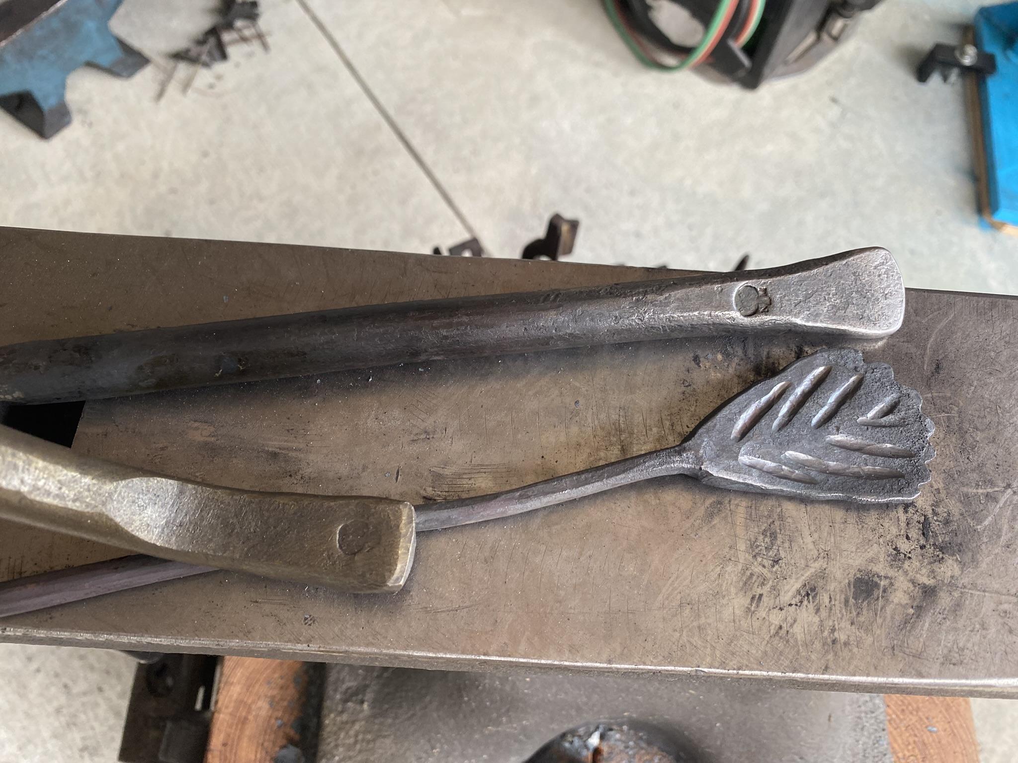

Back out into the smithy after a little wash up, lunch, and quick nap.  The new fullering chisel seems to work very well.  I added some texture to the fourth leaf to make it go with the other three. I think they all look good. I tested the new fullering chisel with some modeling clay.  Looked okay.

Melted, the fuller lines in the leaves look real good. Well done!
