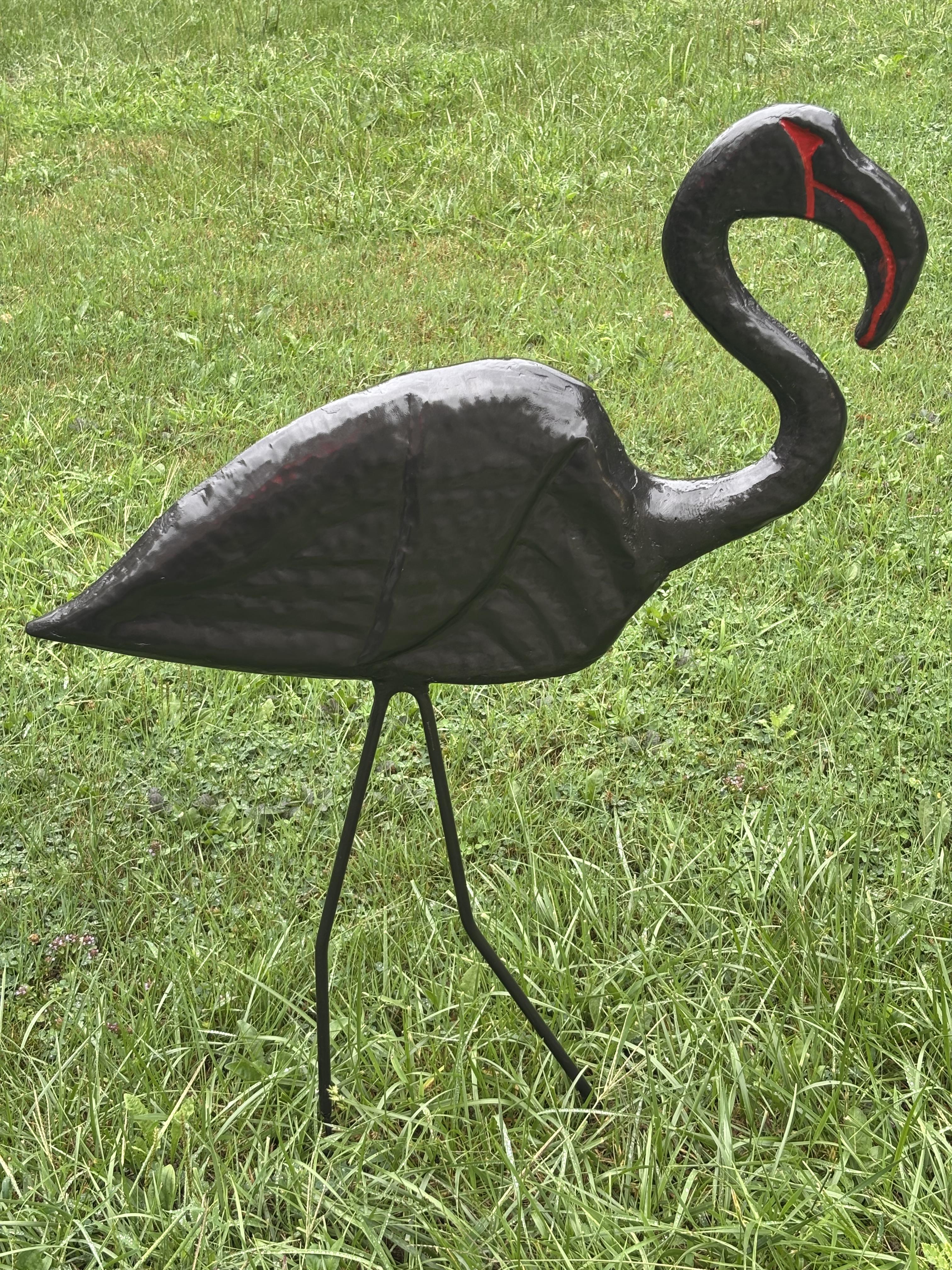

All done!
Put it in a fenced-in backyard.  Please!  Too beautiful to let some loathsome individual steal it off the front lawn.  Or at least connect it to a non-pulsed high amperage electric fence controller if in the front.  Set up a camera, too. :lol:
Shaina, all you need do is roll the pointy tips of the leaves over and even stepping on them won't make people leak.
I like it John, I'm sure the commissioner will be pleased at the appalled wailing and shrieking of the hoity toity neighbors. <evil grin>
That's wonderful, John!
Frosty, not sure if you can tell from the pic but those leaves are about the size of my fingernail. Pretty small. I think rolling only the tips of the leaves would make it hard to tell they were even leaves anymore, lol
For these, I think I'll just bend the "stems" of the leaves so they kind of fold back toward the parent stock.
My next batch will start from larger stock to get a larger leaf. Another alternative is to fold-over forge weld the 1/4" stock to get more mass.
Then just file the points off, I doubt anybody is going to poke a hole in themselves on a pinky nail sized element.
Of course folding or just laying them down on the stem or ring will look well.
