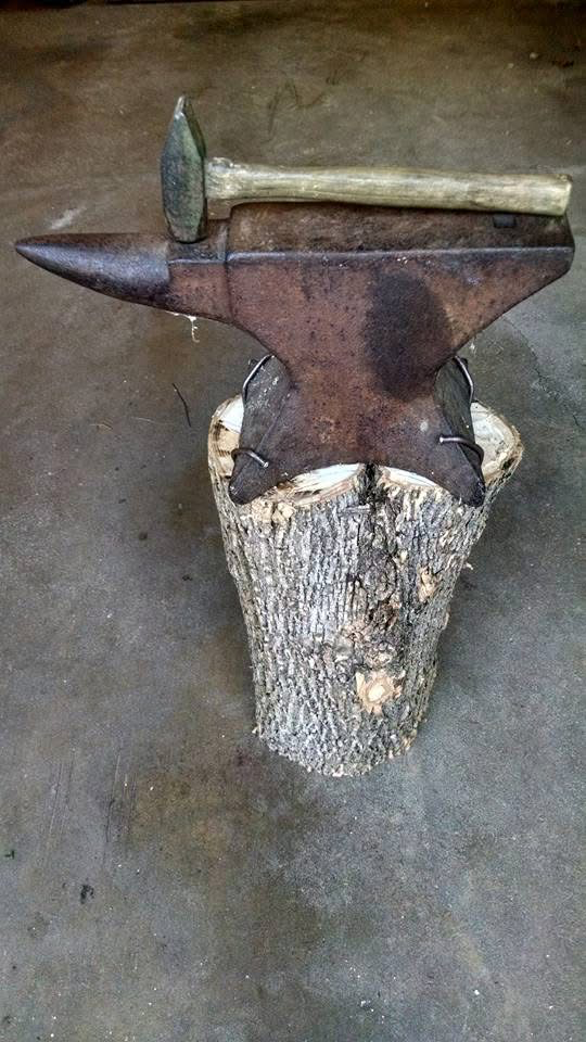

FB Memories reminds me that ten years ago today, I was in the shop putting my anvil back on a block for the first time in twenty-three years. image.thumb.png.bc70ec97816da9e2f9beed8bd39645b7.png

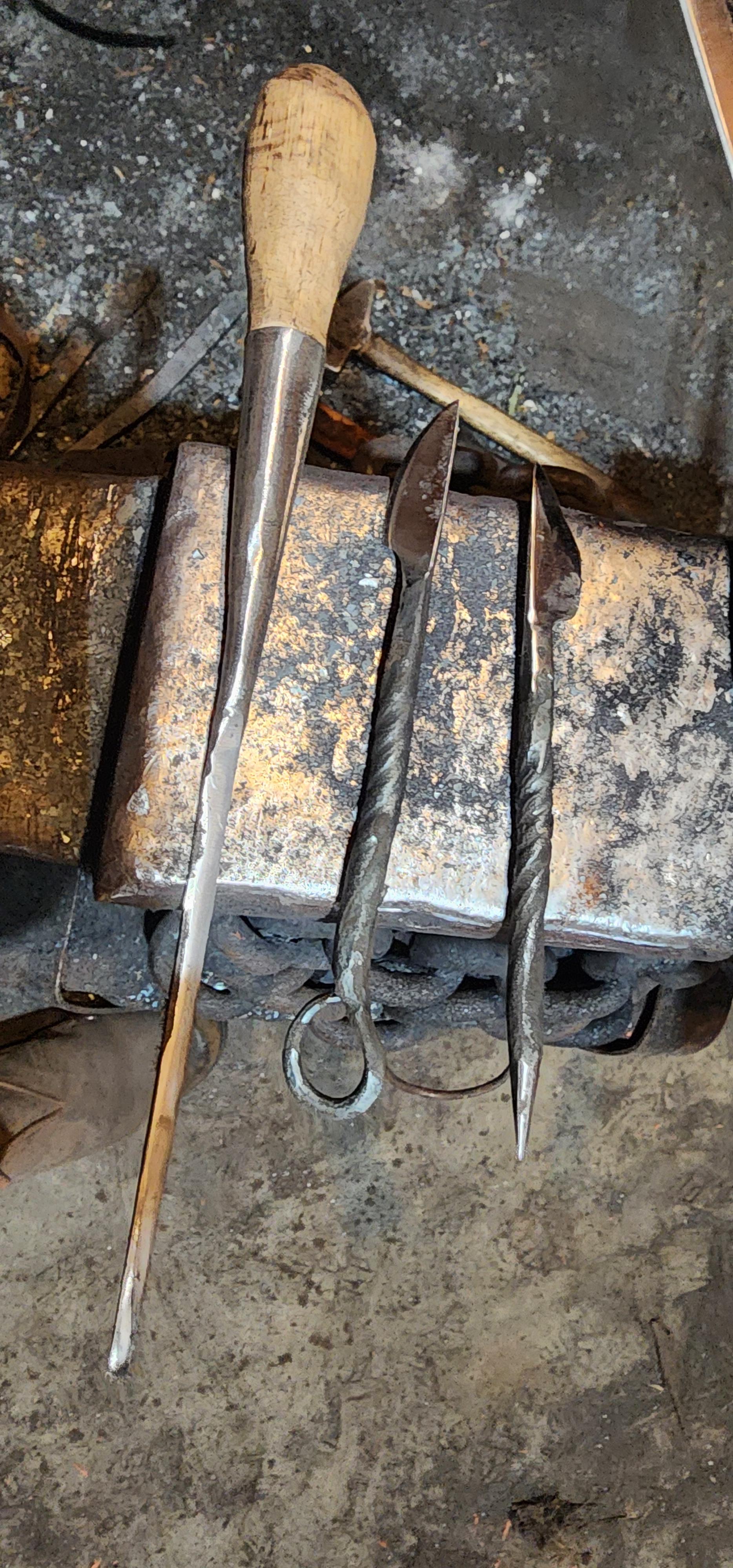

Made a couple chisels today from some coil springs.  Continuing to work on my sockets.  Also made a pair of small carving knives from some of the garage door spring I have.  Not doing too badly but I may change up the designs a bit.  I actually quenched them in water after trying one in oil and it not talking.
The main reason I was working on carving tools was the hidden tang on the dirk.  I was thinking I would be able to carve it out better.   What I didn't take a picture of was the replica of the knife tang that I also forged and ground to match.   Threw that in the forge and burned it in, tang matched up perfect.  Still drilled a pin hole because reasons.  The wood is african bloodwood.  I still have a little shaping to do on the ends and the making a pommel.  Maybe something up top too to dress up around the blade.
Looking good Chad. Your sockets don't need to be that long, they only need to hold the blade and handle securely and a shorter steeper taper is easier to form and fit. I'm not saying half that length but maybe.
You want the rivet farther back on the dagger's handle. Where it is now will rub on your finger irritating it. Farther back between the palm and heel where your hand has more surface area it won't rub and irritate it. Farther back the rivet won't have as much leverage working against it so it will stay secure and solid longer. Make sense? It sounded good when the voices said it.:)
JHCC, time sure flies doesn't it?

Best place to put it with the size tang it had.   I should have made the hole smaller,  1/8 instead of 1/4.  It'll be smooth when it'll all sanded.  I Just need to get the blade into some acid to times etch it.
The tips on the sockets are appreciated.  There are times when I just run with what I've got going but I can plan better in the future.   Now to make a Roman Pilum and really test it out.
