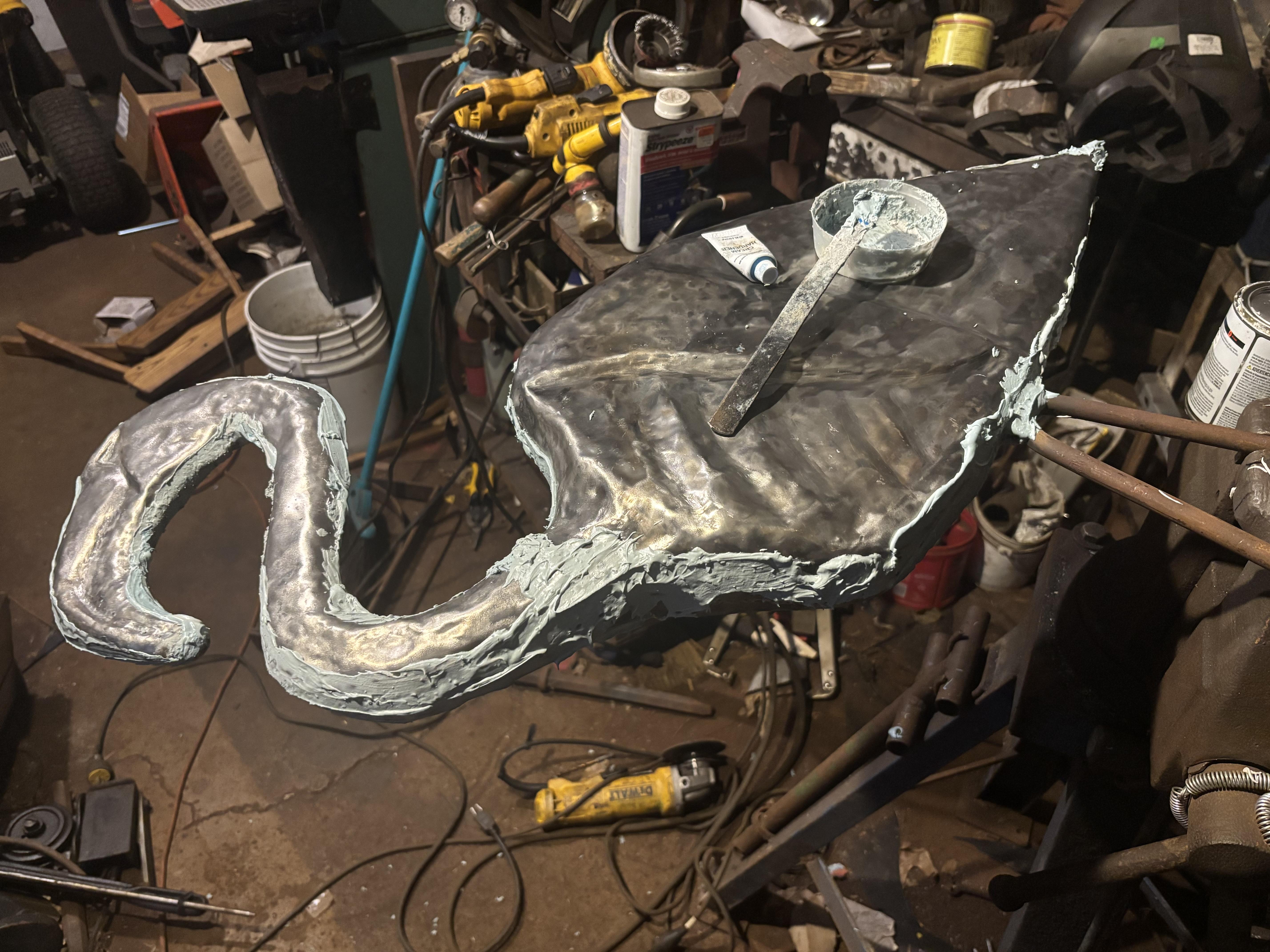

And in today’s episode of “Sentences I never thought I’d write”, I put Bondo on the seams of the flamingo.
IMG_1759.thumb.jpeg.48b3f6bfa900e82bb6de13bb8a1e82b2.jpegIMG_1759.thumb.jpeg.48b3f6bfa900e82bb6de13bb8a1e82b2.jpeg

You Bonbo'd your flamingo. You SURE you're not listening to Cheech and Chong?
