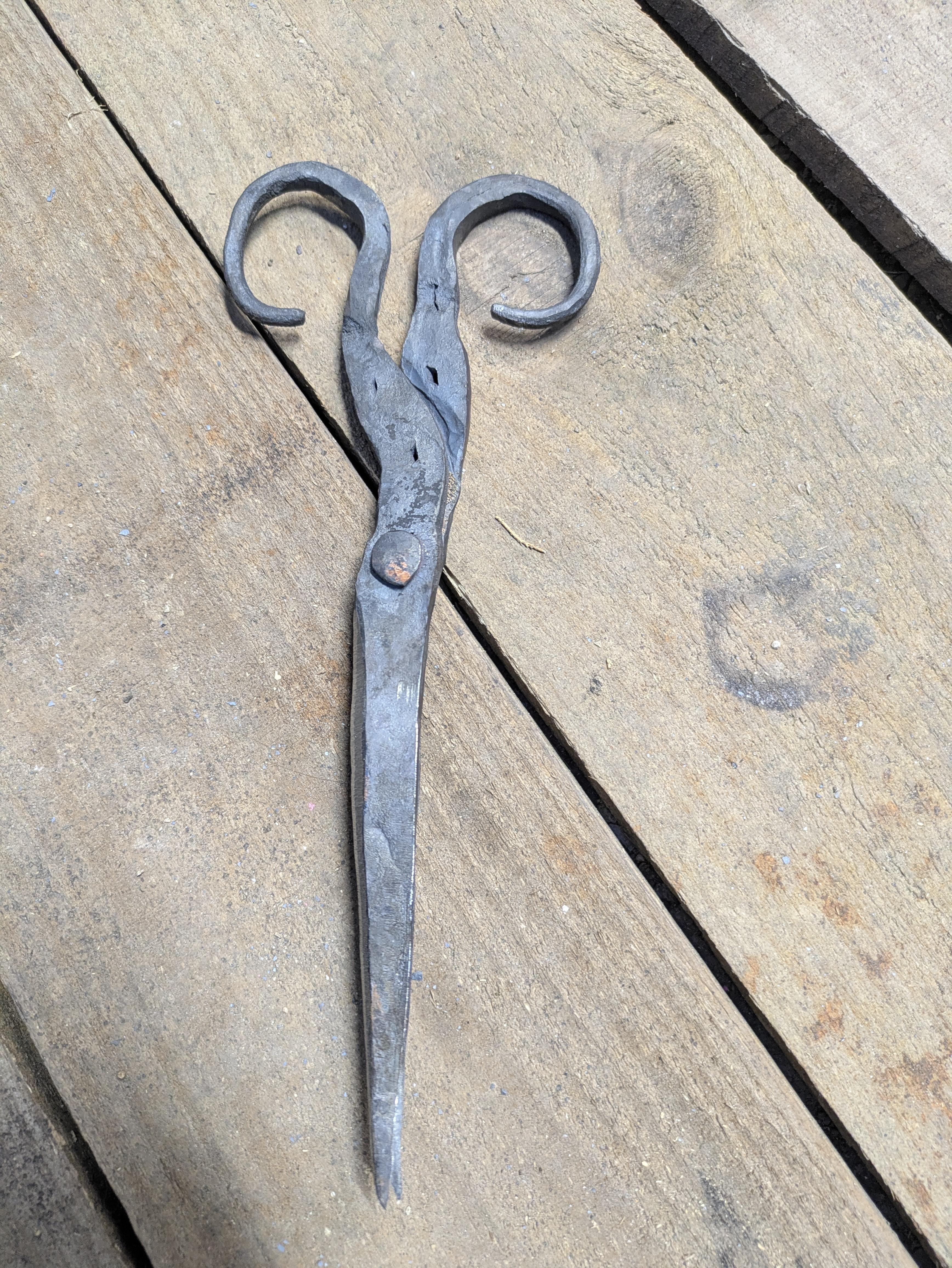

The collage is from October 2023 when I made my first attempt at scissors and used a horseshoe. Not ideal. But I was hoping to be able to retain some of the horseshoe features and gift it to the guy that cuts my hair. Tonight I found that old unfinished pair and tried to salvage that mess. Pretty ugly, lol
I'll try again with a rasp for the gift.
I've started on some Viking style shears but I've already made a few mistakes and the fixing is just making it look worse. I'll probably start over on those as well, lol
Scissors are difficult!

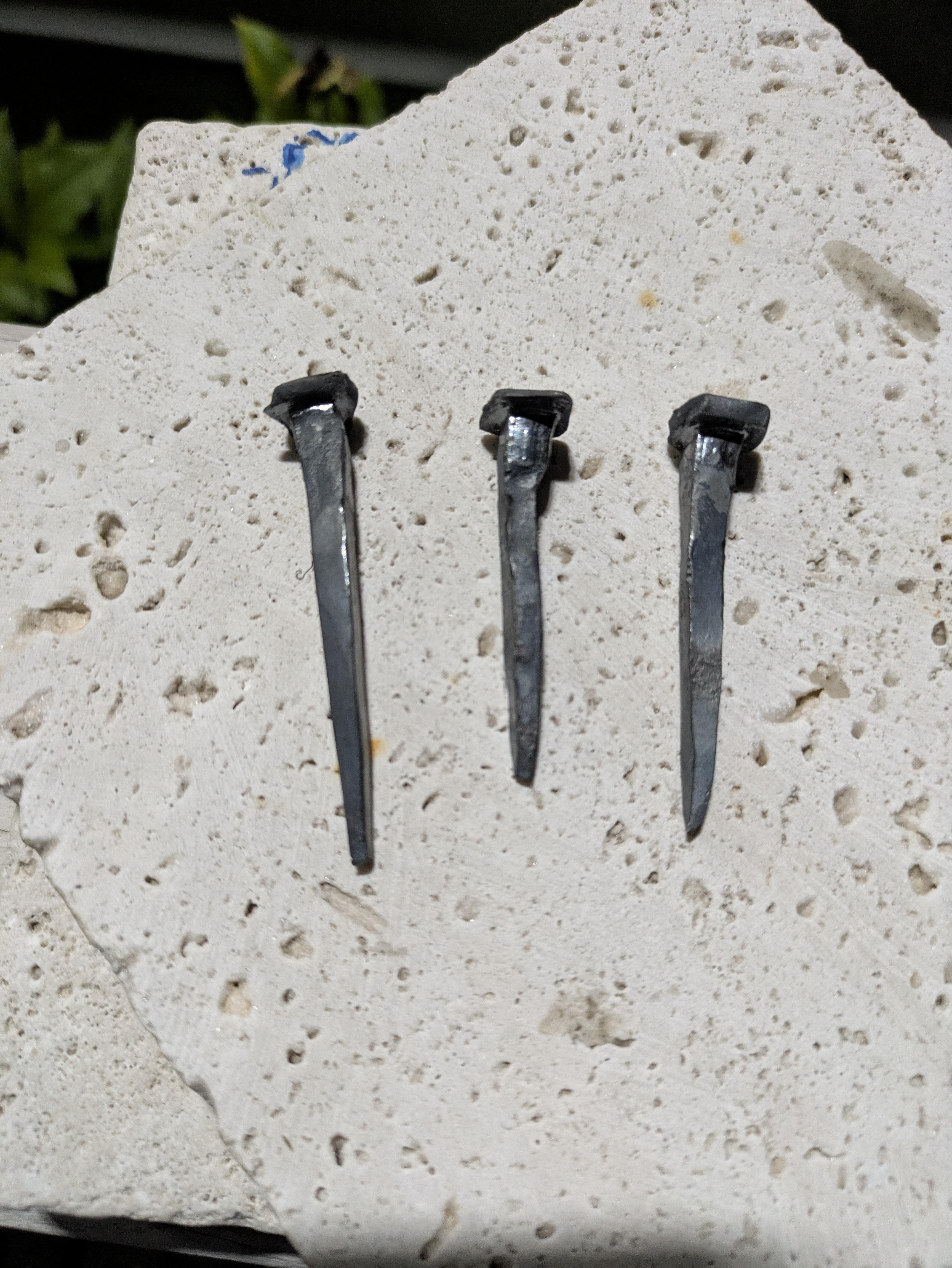

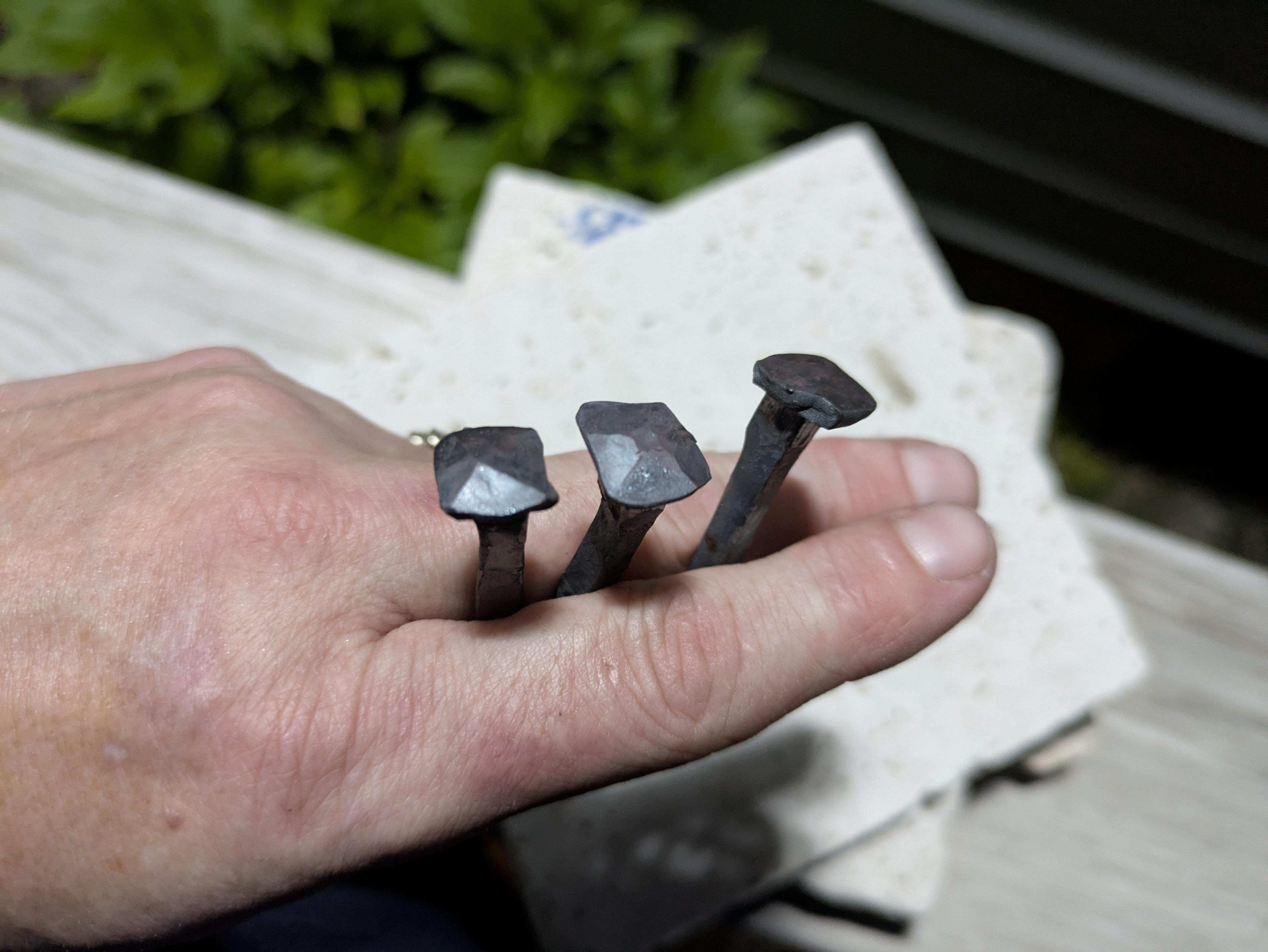

Ended my session tonight with nails. I rewatched Jennifer's (JLP Services) YouTube video on nails over my lunch break. These are much better than the ones I did earlier this week!

Shaina, I've never seen scissors made from horseshoes and I even started a discussion on IFI about ideas for things to make from shoes. That was kinda my thing. I like to keep as much of the original shoe as I can as well. Coincidentally, I was going through things to find sanding belts and I came across a box 'o stuff (mostly things I made that went to the fail pile) and I found these. I actually liked these so I don't know why they are in with the discarded things.
Your nails look great!

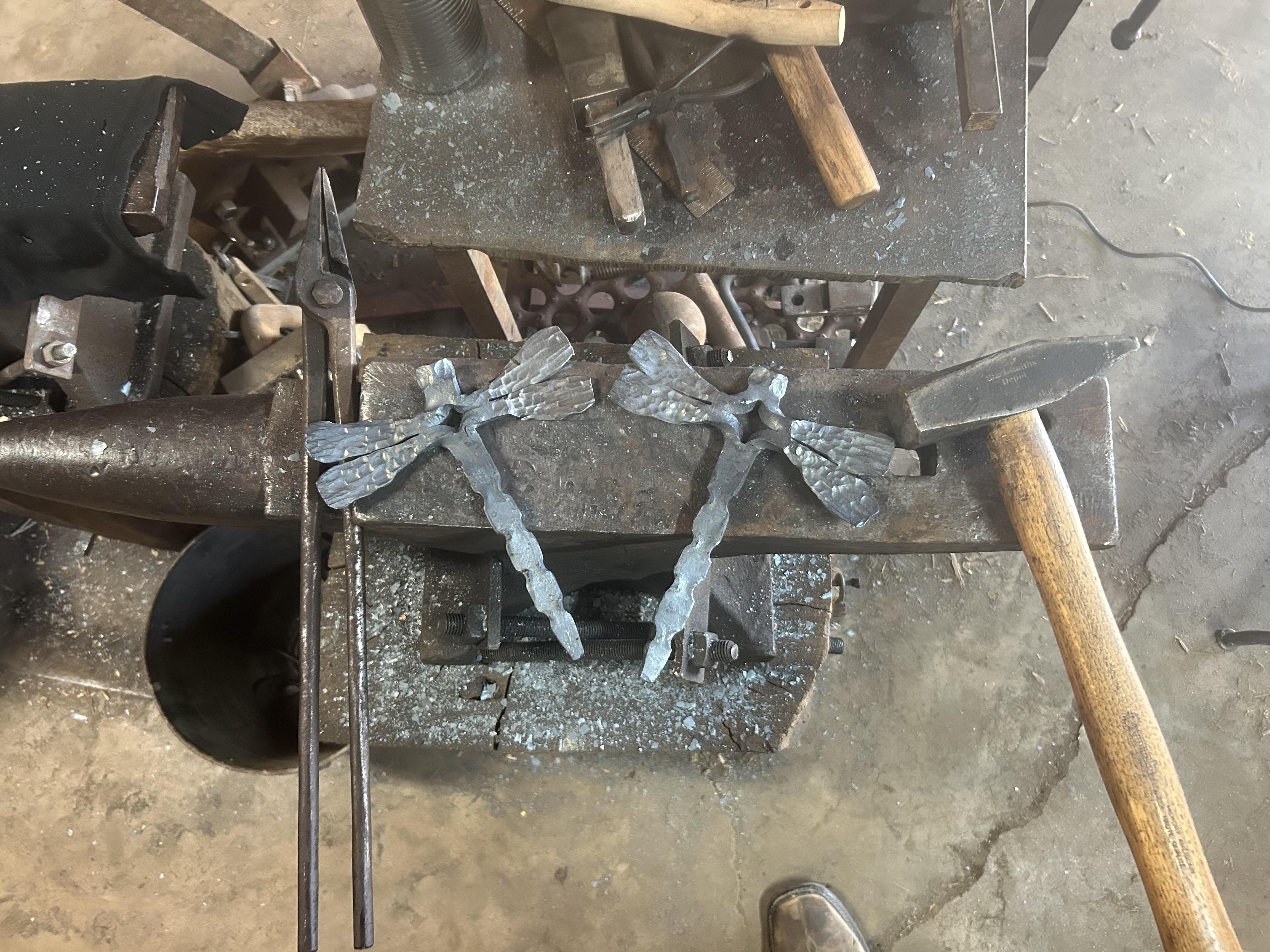

First time making some of these today (my favorite insect.) I am pretty pleased with how they turned out!

Will, you and i have something in common. I LOVE dragonflies. Amazing creatures.

You're getting better at dragon flies all the time! They're my favorite insect too and scorpions are my favorite arachnida.

Will, nice dragonflies. The split design is a smart way. I will write it in my book of ideas.

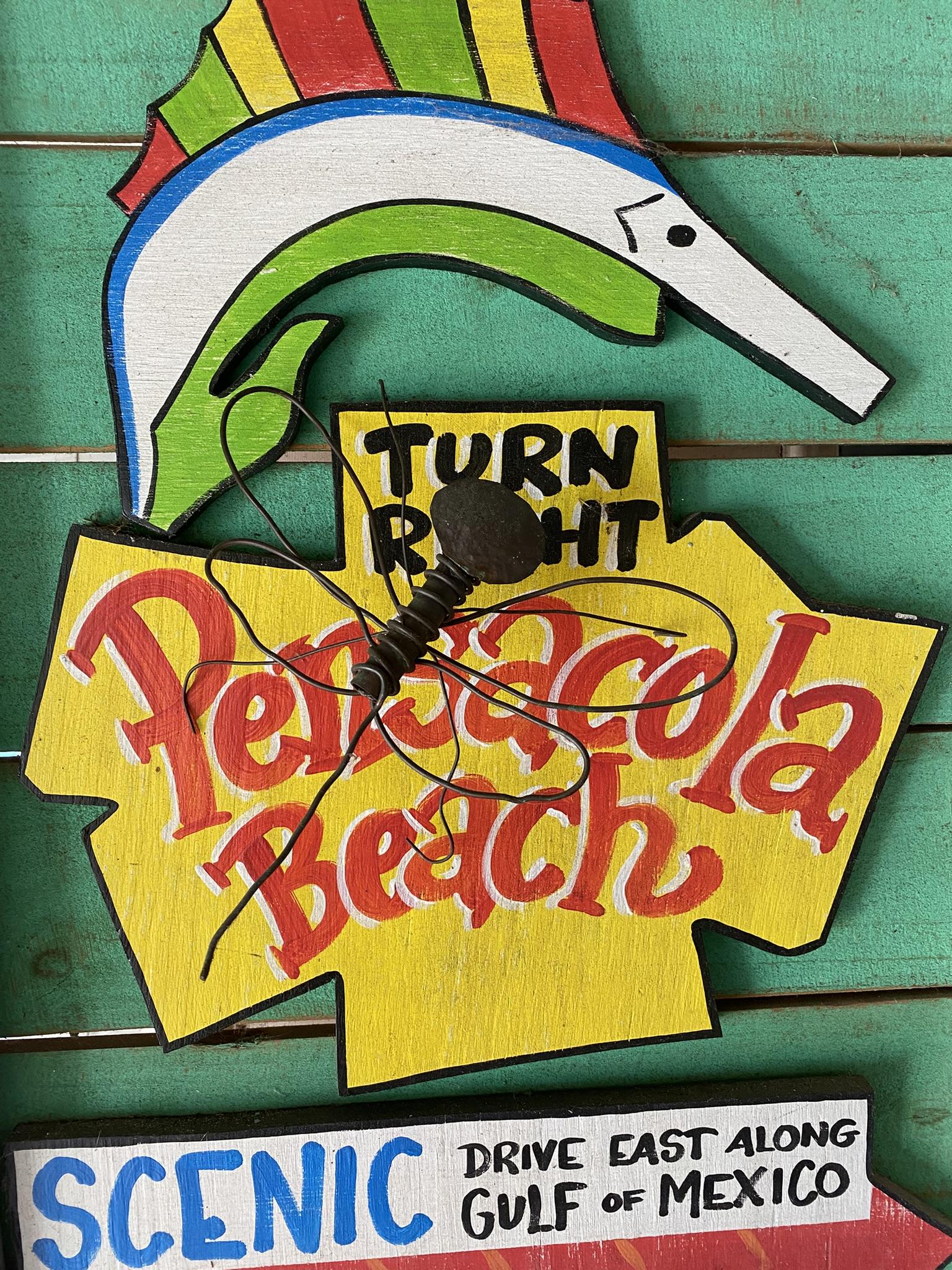

I made this for the wife a while back.  Just goofing off in the shop.  I did use fire and a hammer, but I wouldn't call it blacksmithing. It is a dragonfly though.  Wife loves them, too.

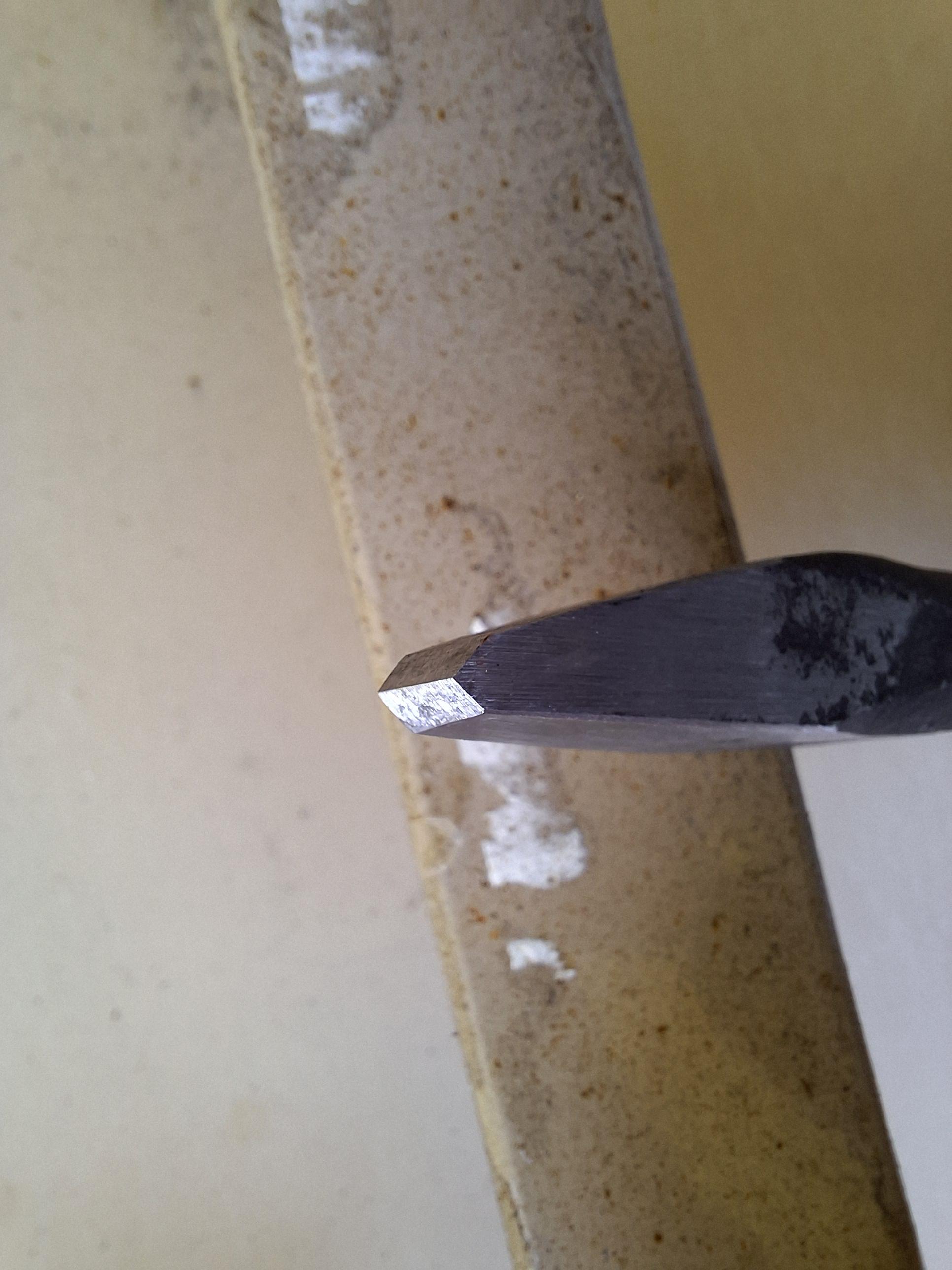

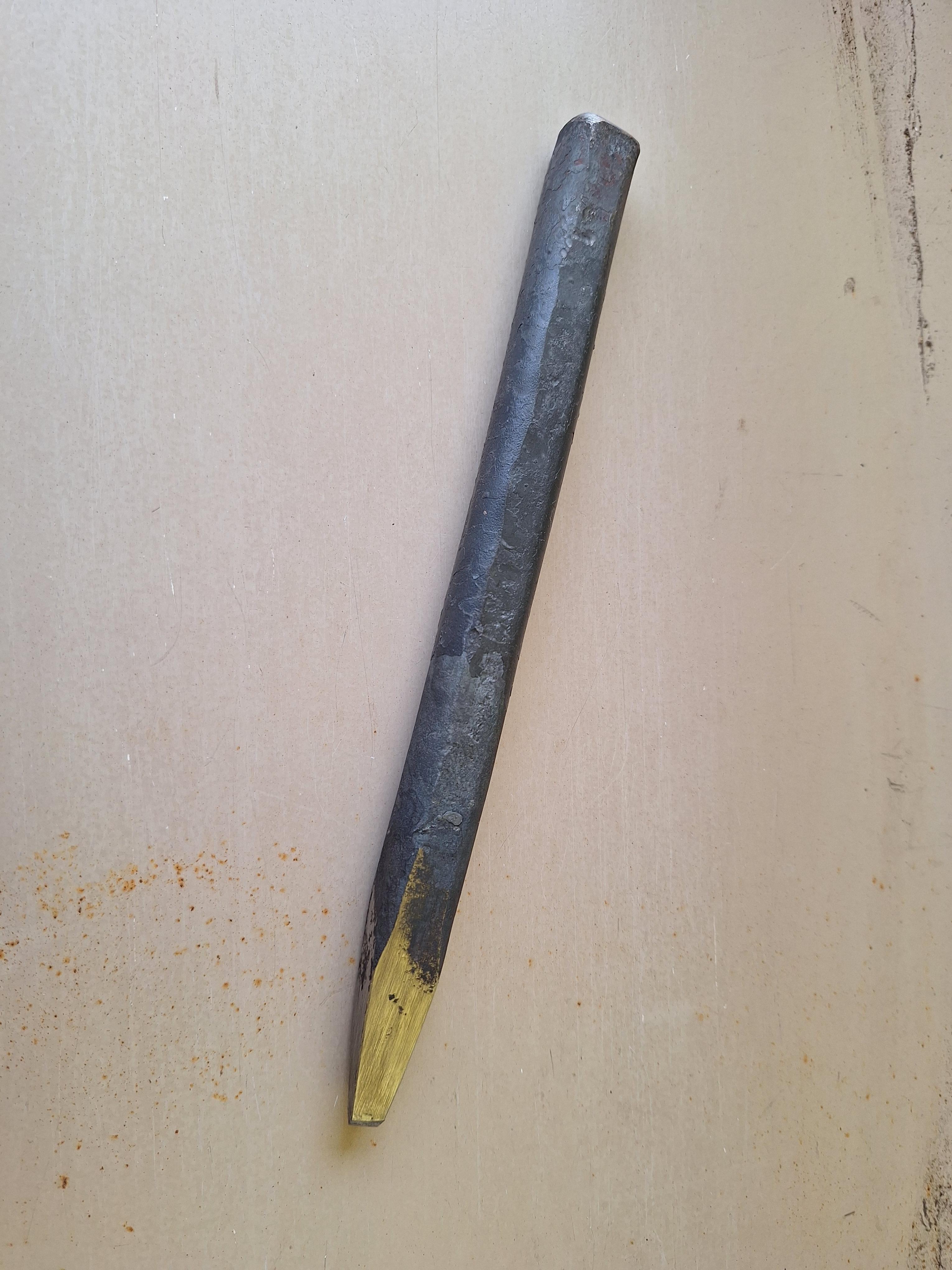

And to keep on topic, today I had to make a tool to work on a project.
I occasionally make BBQs and/or smokers out of old gas bottles (propane tanks) but I don't have anything for cutting the large-ish round holes in them for air vents, so I tend to drill lots of small holes in a circle and then find a way to cut through what's left. The steel is about 3mm (1/8") thick and I've tried in the past to make a small chisel out of garage door spring (the torsion kind, not the tension kind) but it just wouldn't cut it (pun intended!). I came into a lot of different sizes of coil spring recently, so instead of a small chisel with a small cutting edge, I made a big chisel with a small cutting edge out of 16mm (5/8") diameter coil spring. I forged a comfortable flat down the full length and forged a taper for the cutting end. Quenched it in water and drew the temper to a straw colour at the cutting end, then ground it to a fairly wide angle for cold cutting.
I'm really happy with how it performed! I wasn't expecting much based on previous tools I've made but it cut 24 little "webs" between the drilled holes flawlessly (I had already started filing these before I remembered to take the photo!)
and this is what it looks like afterwards! Almost exactly as it was off the grinder!
A nice little win for me!

Way to go Jono! There are different chisel profiles that work better for connecting the holes like that but a plain old cold chisel works a treat. I'd say that was a win win though, you cut the hole, you have the satisfaction of making it work AND you have a chisel.
Makes a good day doesn't it?
Jono, if you do a lot of them i would suggest getting a hole saw kit. I got one for cutting metal that goes from 1/2" up to 2".
