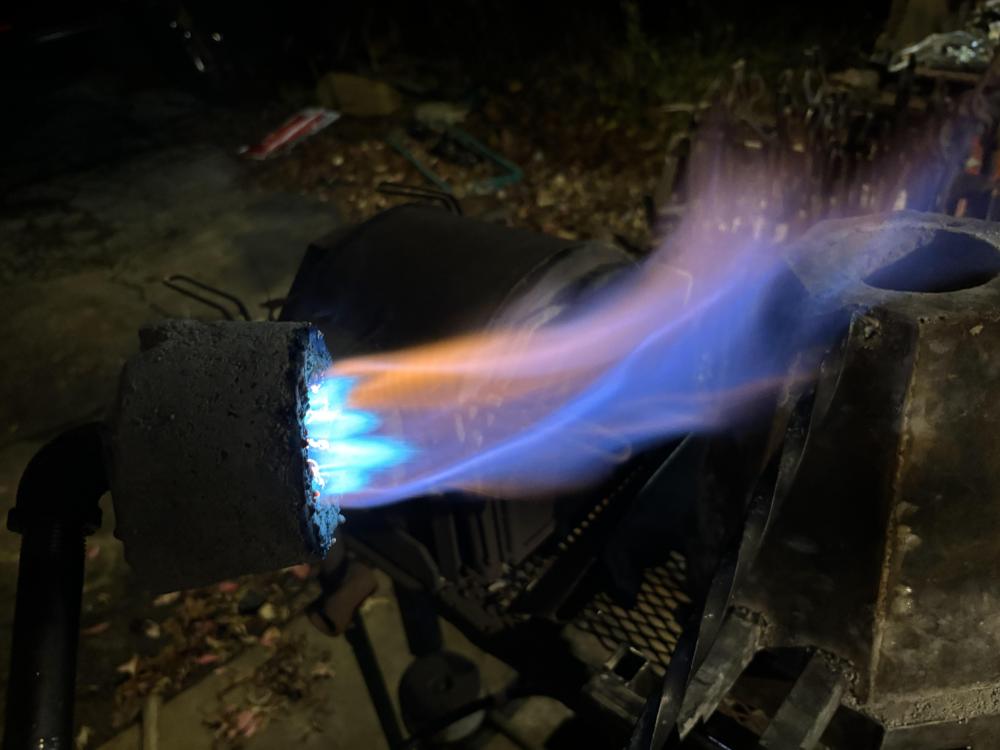

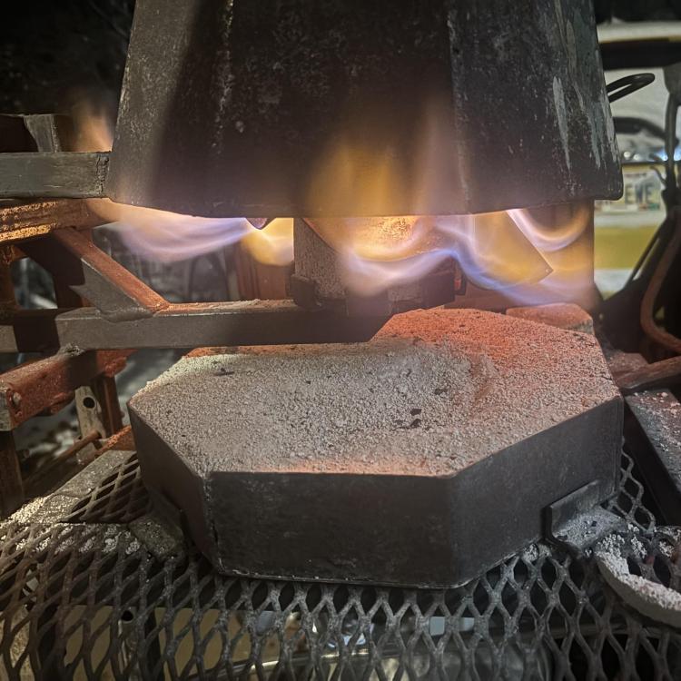

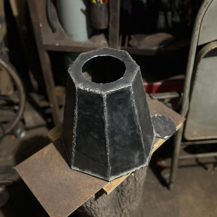

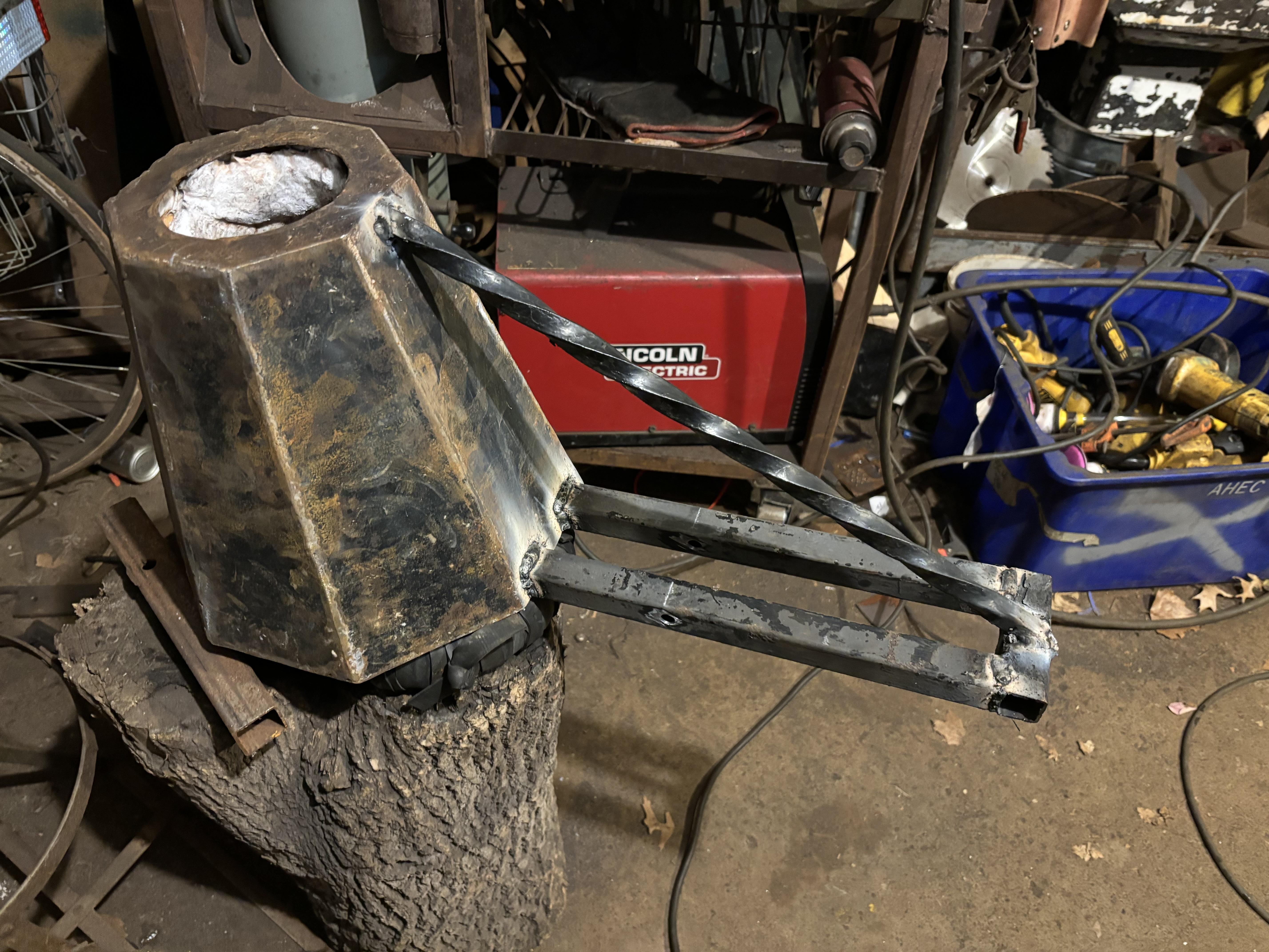

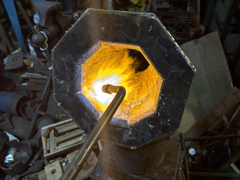

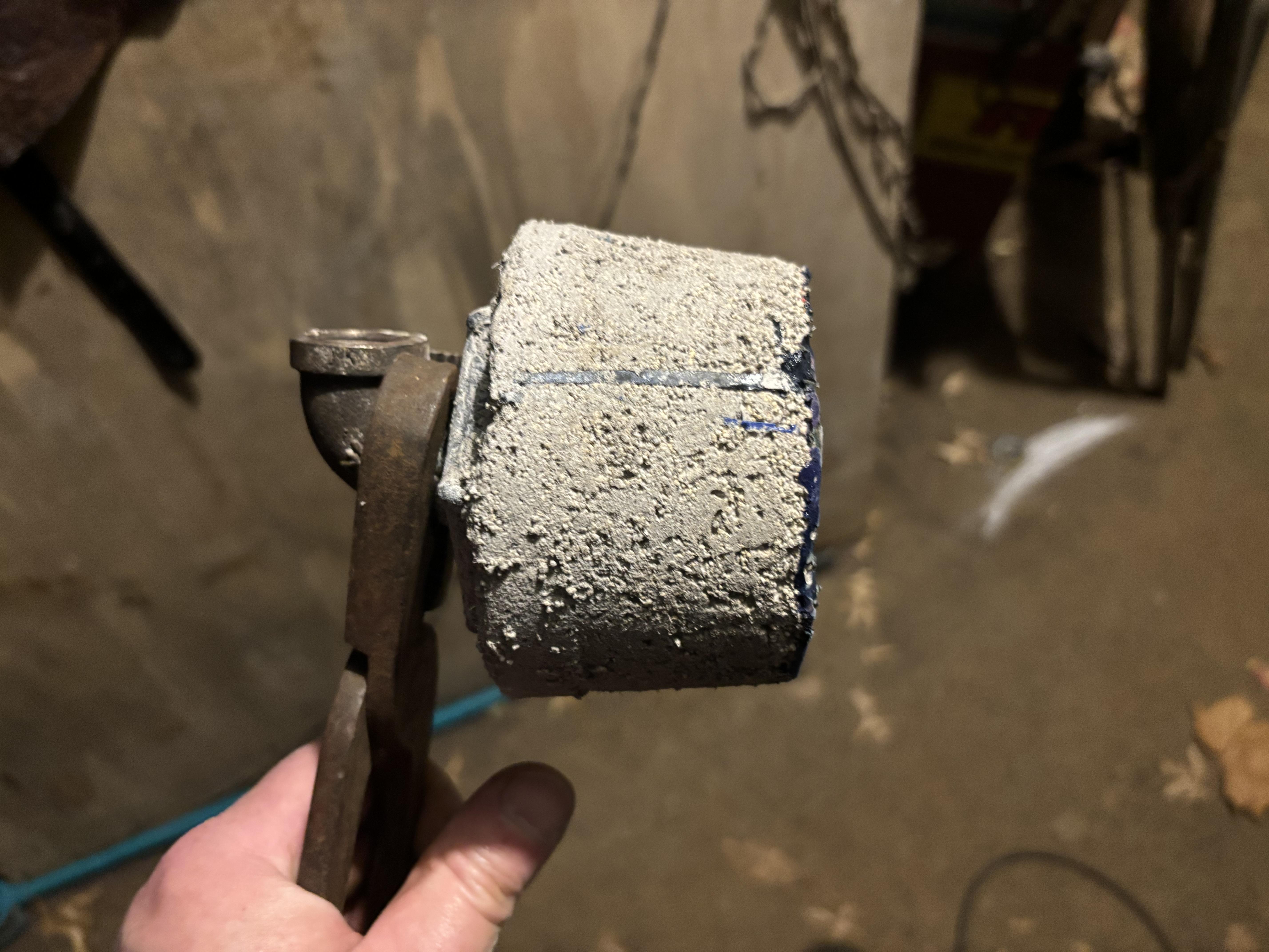

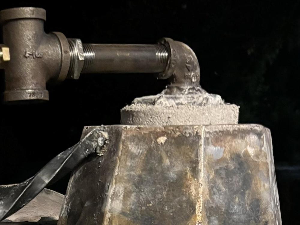

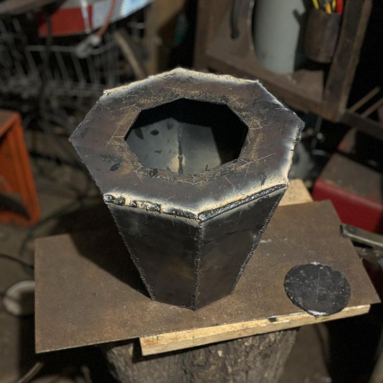

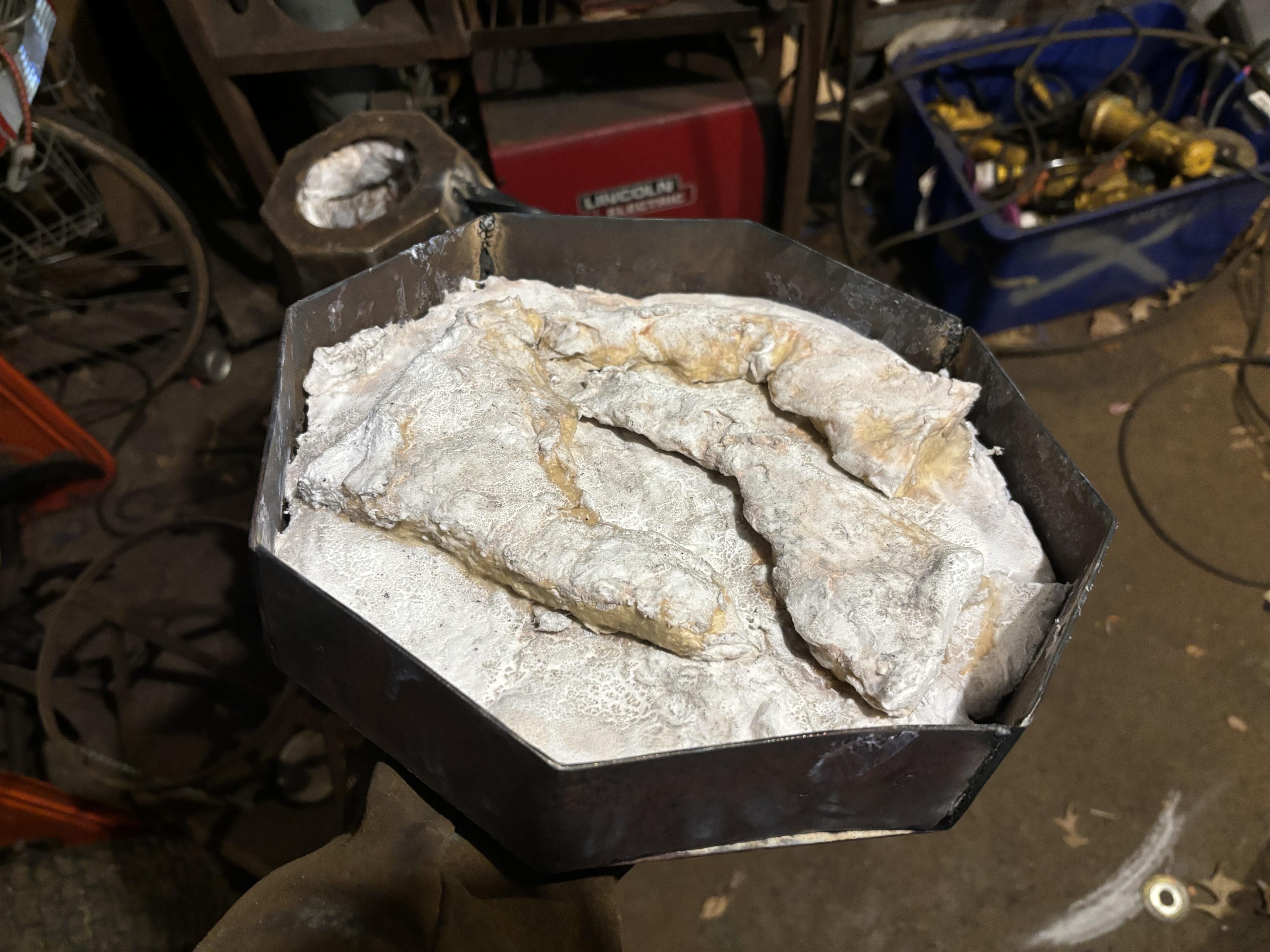

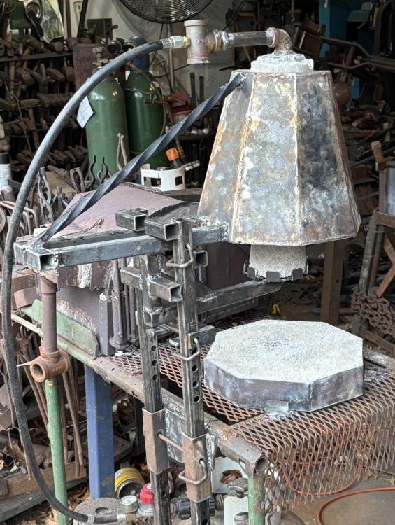

JHCC Posted November 25, 2024 Share Posted November 25, 2024 While I have had good luck heating sheet metal (for forging bowls) with a rosebud tip on my oxypropane torch, it is rather a fuel hog, plus I’m paying for the O2. However, my regular gas forge doesn’t accommodate bowls very well until they’re practically finished. This problem didn’t seem to have a great solution, but then I ran across Eric Thing’s article on Anvilfire about his armor forge. (IFI doesn't allow links to AF, but a websearch for "Eric Thing" and "forge" will get you there.) So, here’s my version, with some modifications. First, I replaced the burner with a 1/2” Frosty T- burner powering a 12-hole NARB. Second, instead of Eric’s threaded rod height adjustment, I mounted the forge on a tilting arm, which itself pivots on a support that can be adjusted vertically. Here it is fully assembled: As you can see, it’s mounted on the back of my gas forge cart. However, it can be removed if I need to run long pieces through the tunnel forge. I also made the shell by welding up an octagonal taper rather than Eric’s original frustum of a cone, mostly to make more efficient use of my sheet metal stock. This was lined with two 1” layers of rigidized ceramic wool: And then given a layer of kastolite-30 (not shown). I molded the top with a plastic container that originally held Parmesan cheese, so that it would match the taper of the burner block (see below). Here’s the arm welded onto the back of the forge, along with a diagonal brace: Here’s another Parmesan container set up with the crayons for the burner block. These were first set in holes drilled in the bottom of the container, but then I melted some more wax around their bases to hold them more securely. Getting the kastolite between the crayons was a bit of a pain, but I managed to ram some in with an icing spatula and a popsicle stick. Then I inserted the plenum (made from the cutout from the mouth of the forge with a 90 degree elbow welded on) and packed some more kastolite around it. After curing, I melted the extra wax off the bottom with a plumber’s torch and reamed most of the wax out of the holes with a heated piece of thick wire: Here’s the block removed from its mold, showing the taper from the Parmesan container: Which fits neatly in the tapered top opening of the forge: The base of the forge (what Eric calls the "deck") is a 2-1/2” deep octagonal tray, with the bottom lined with a 1” layer (and a few extra chunks) of rigidized ceramic wool: The finished base can be seen in the picture below of the tilting mechanism. (Not shown are two solid blocks I cast in another Parmesan container and a yoghurt container, to support bowls under the forge.) Here’s the burner fired up. Lots of calcite and crayon wax burning out: First firing of the forge (note the water vapor cooking out of the top): And here’s the tilting mechanism: Even though the refractory isn’t fully fired, it still got a scrap of 16 gauge mild steel up to a respectable glow: After the first firing, I brought the parts back into the house to cure in the basement some more, where they’ll be warmer than out in the garage. I’ll do another firing tomorrow. So far, so good! Quote Link to comment Share on other sites More sharing options...

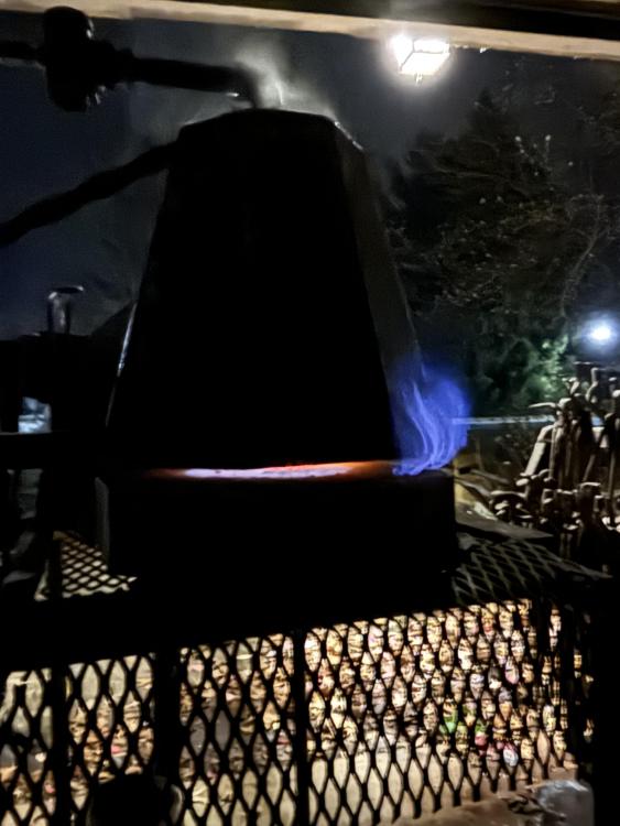

Frosty Posted November 25, 2024 Share Posted November 25, 2024 Pretty neat forge John. Unless I'm mistaken the octagonal prism is hollow. If so it's a natural for hanging a single light bulb in to keep warm so you don't have to pack it in the house every night till it's cured. It wouldn't take much wattage as small and well insulated as it is, 20watt night light or old school Christmas light would be plenty. Frosty The Lucky. Quote Link to comment Share on other sites More sharing options...
JHCC Posted November 25, 2024 Author Share Posted November 25, 2024 With the temperatures dropping into the 30s, I don’t think the lightbulb would be enough. The good news is that it’s pretty easy to move: the diagonal brace makes a natural carrying handle. Quote Link to comment Share on other sites More sharing options...

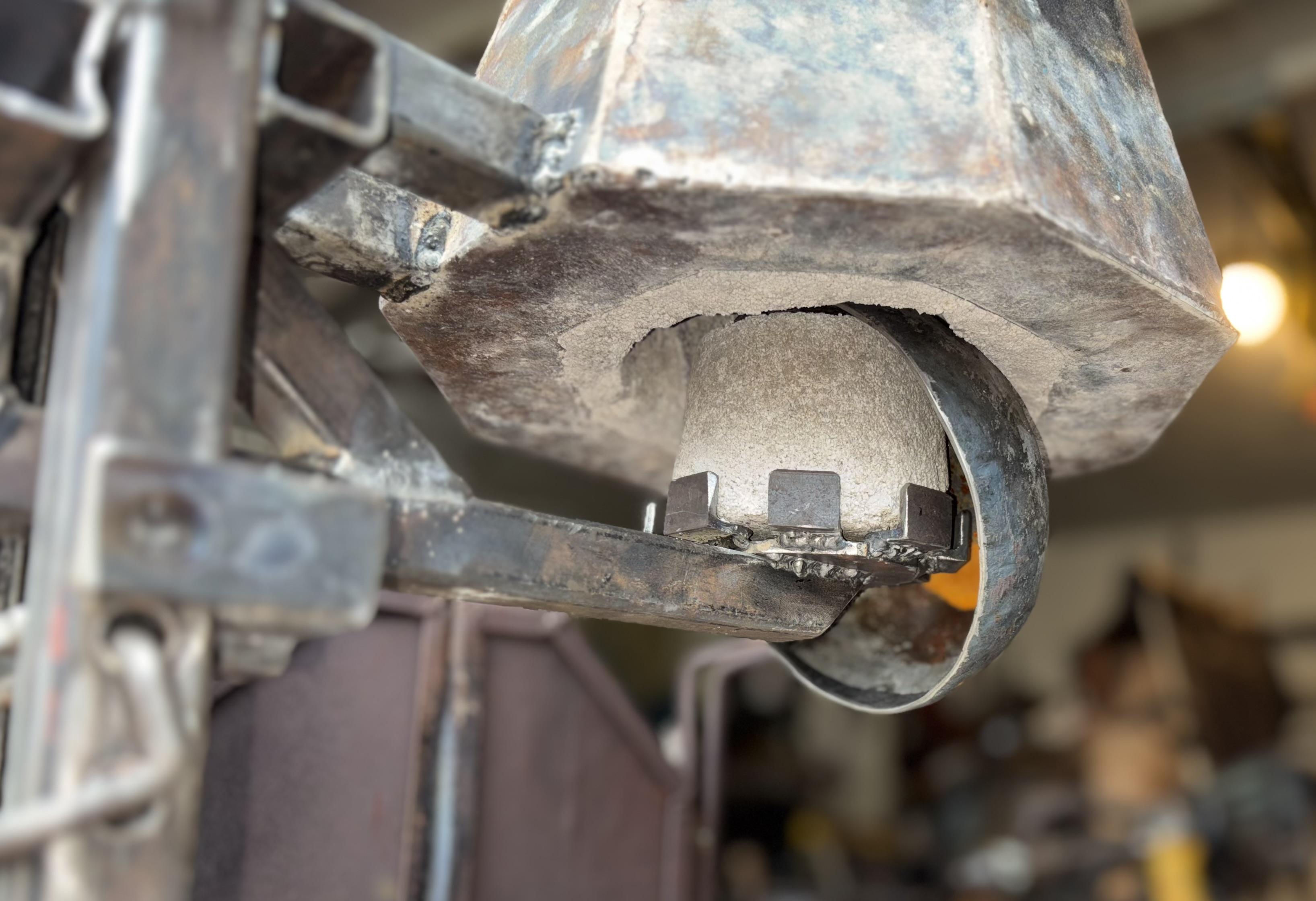

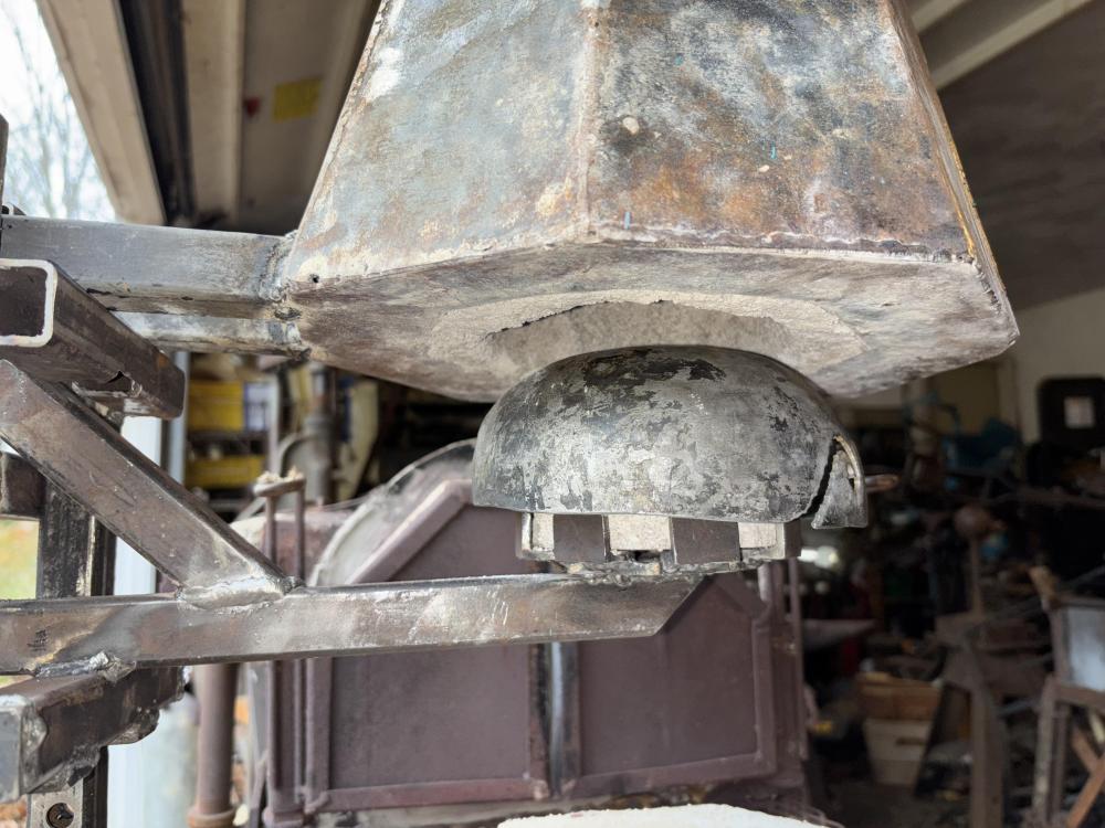

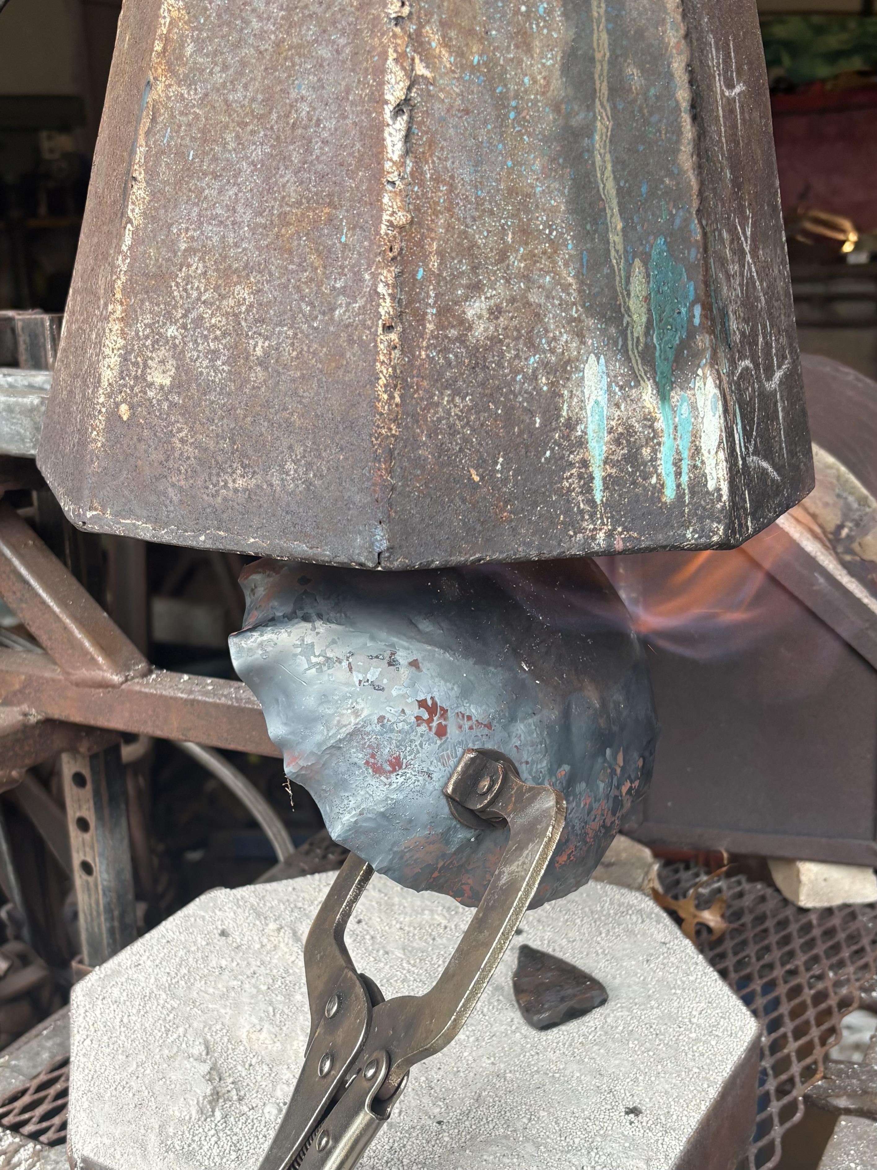

JHCC Posted November 25, 2024 Author Share Posted November 25, 2024 Addendum: one significant difference between Eric's forge and mine is that his deck is at the end of an arm, which allows the smith to get further into a deeply hollowed form like a helmet: (Apologies for the low-resolution photo; this was a screen grab from someone else's video of their forge.) I have some ideas for this, should it become an issue in my own forging. We shall see. Quote Link to comment Share on other sites More sharing options...

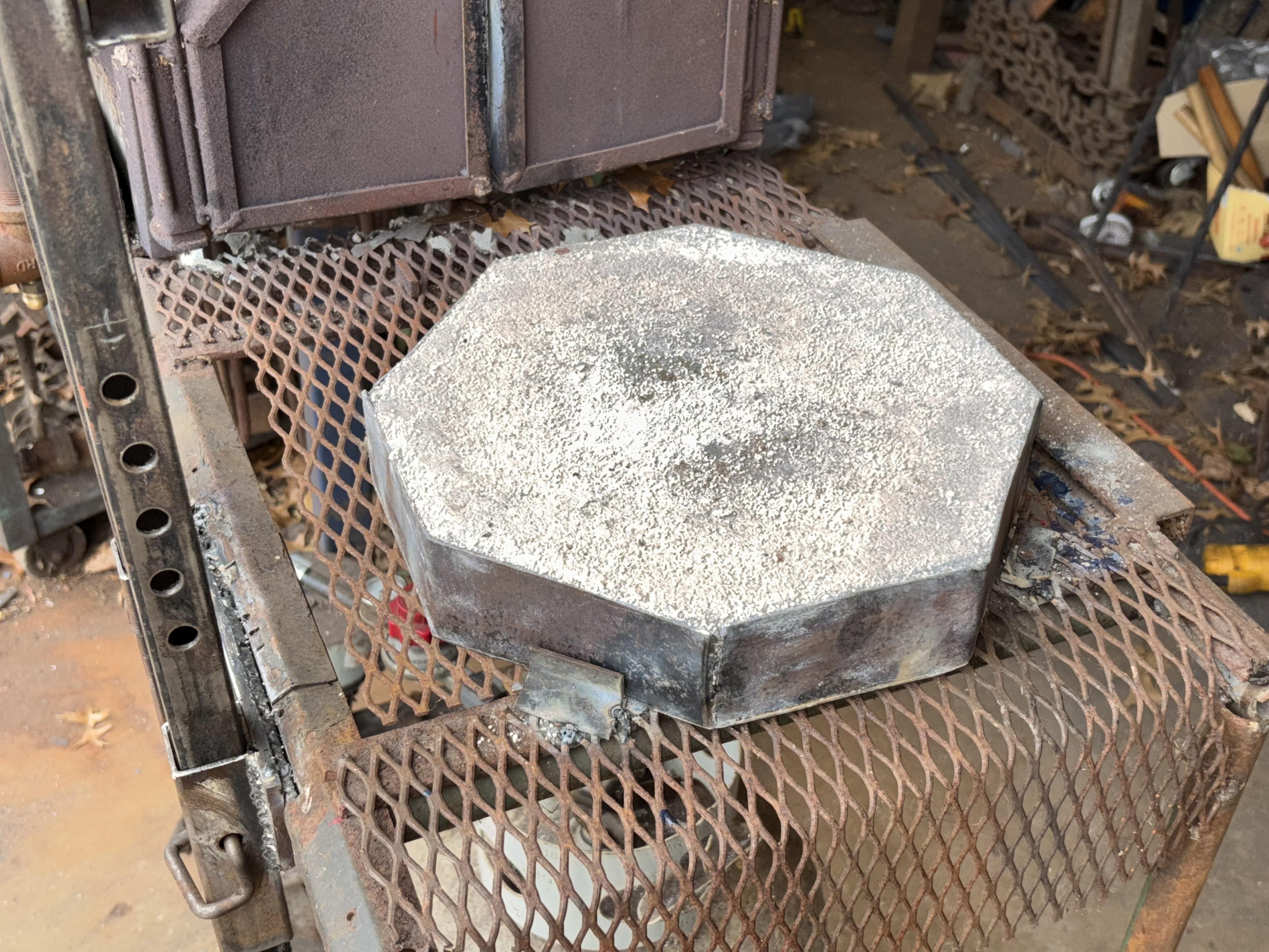

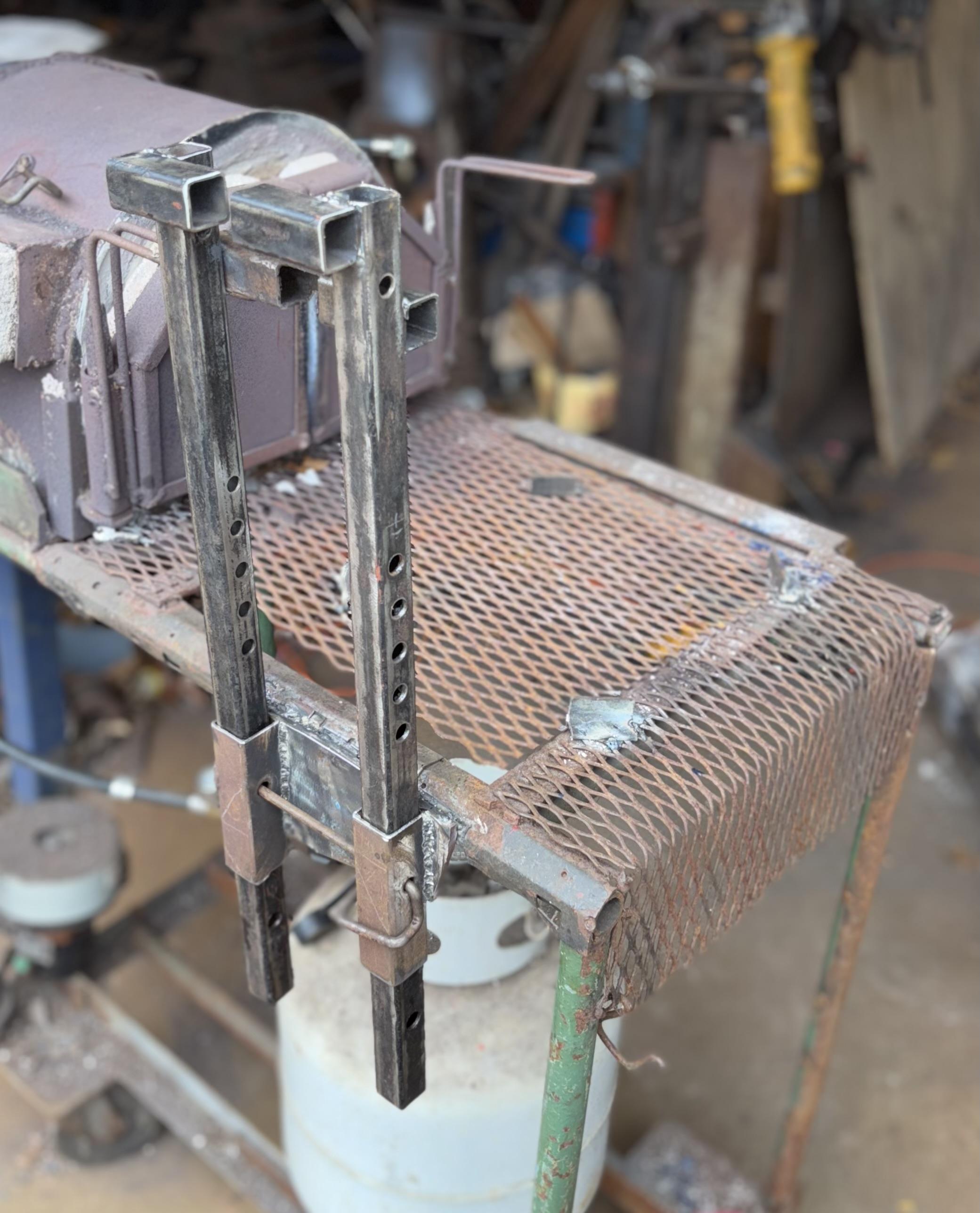

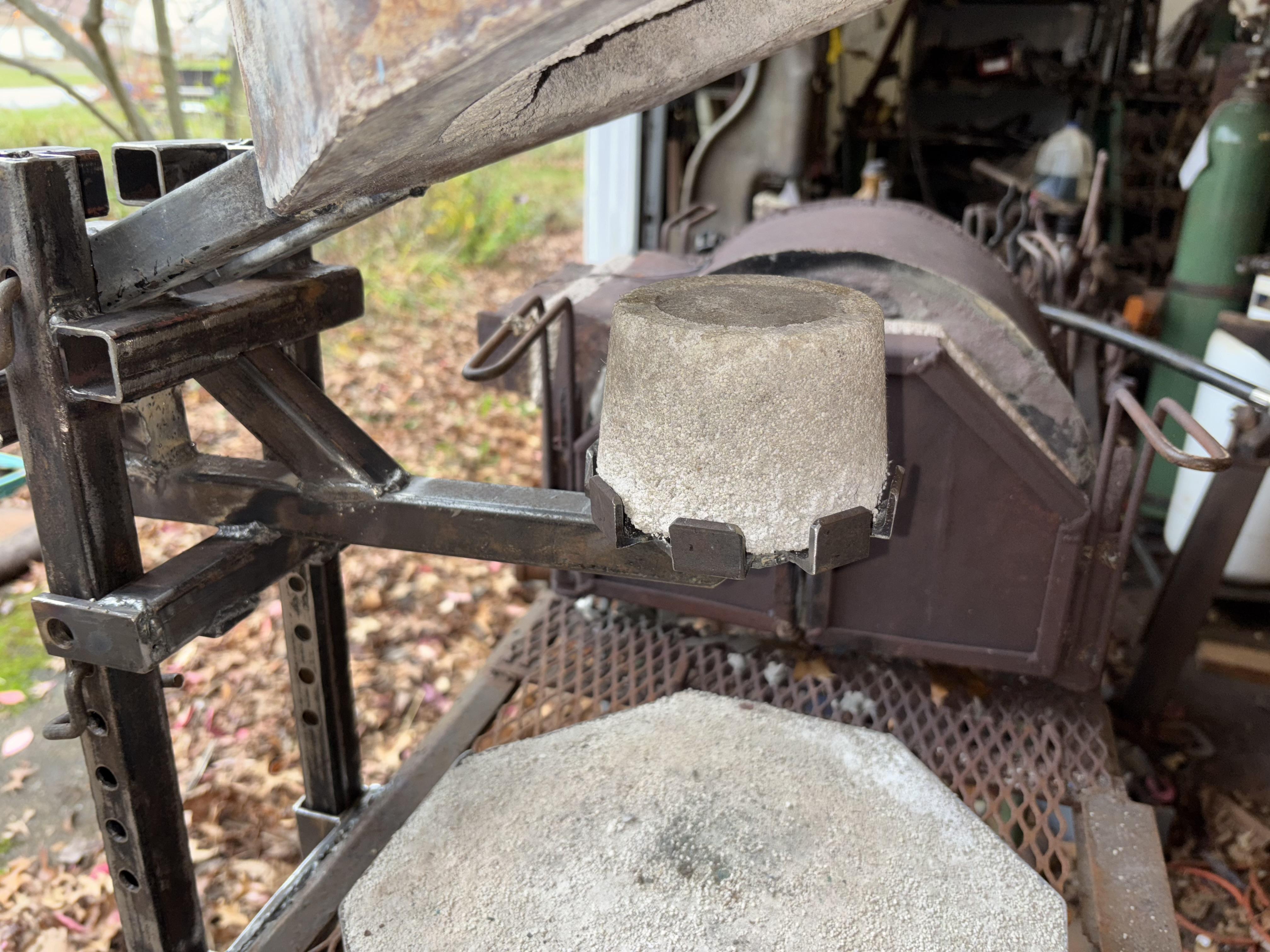

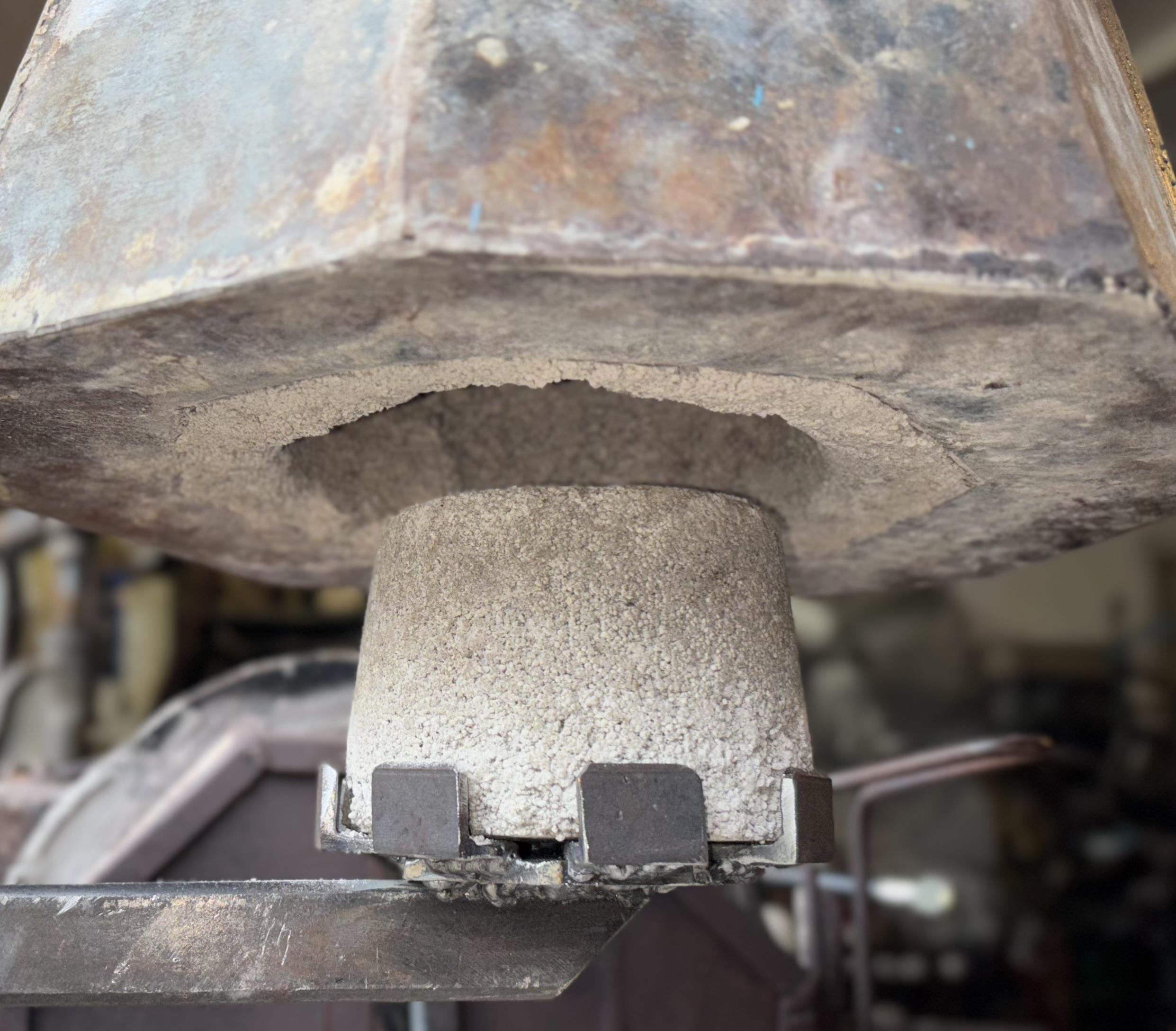

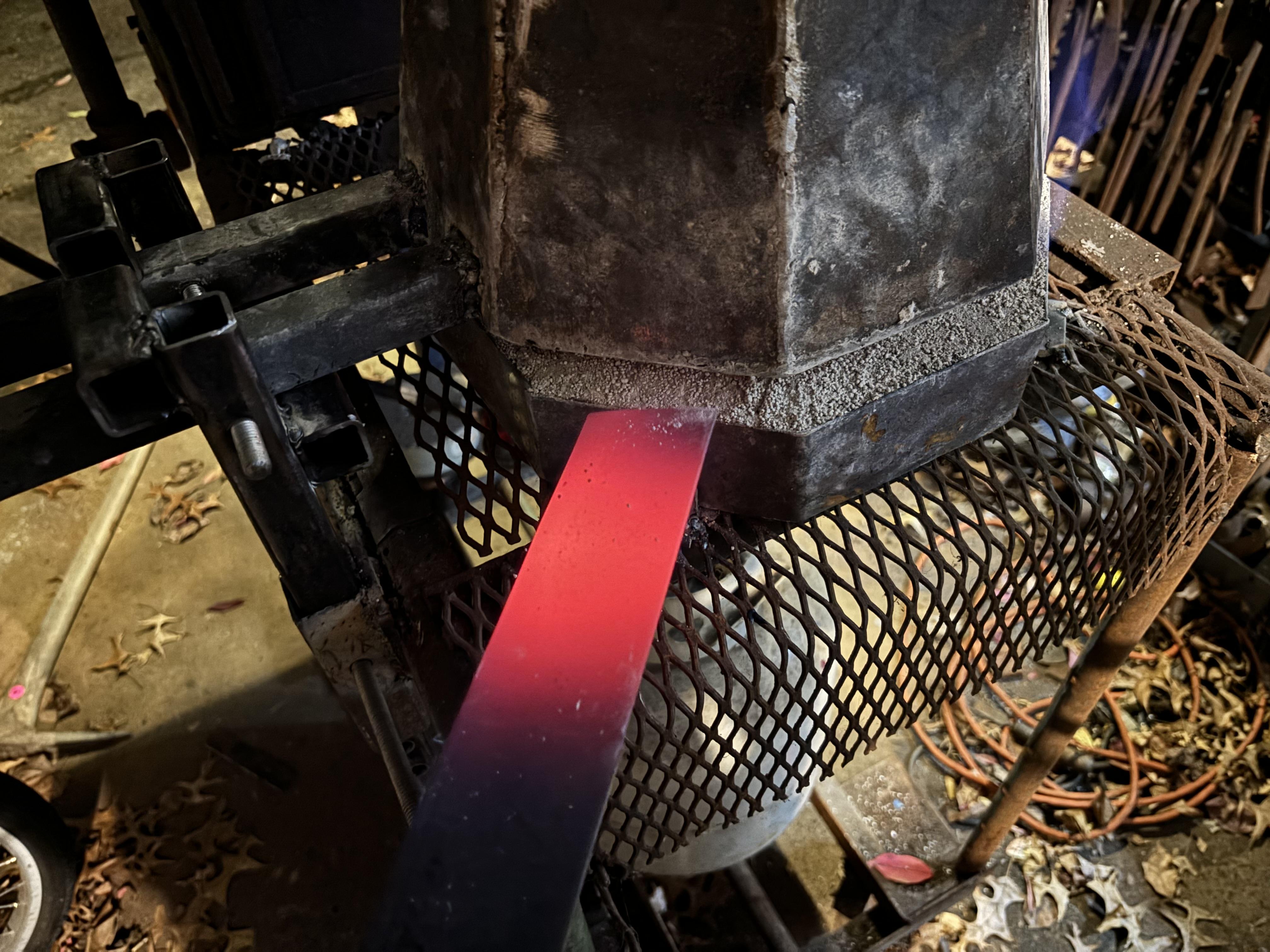

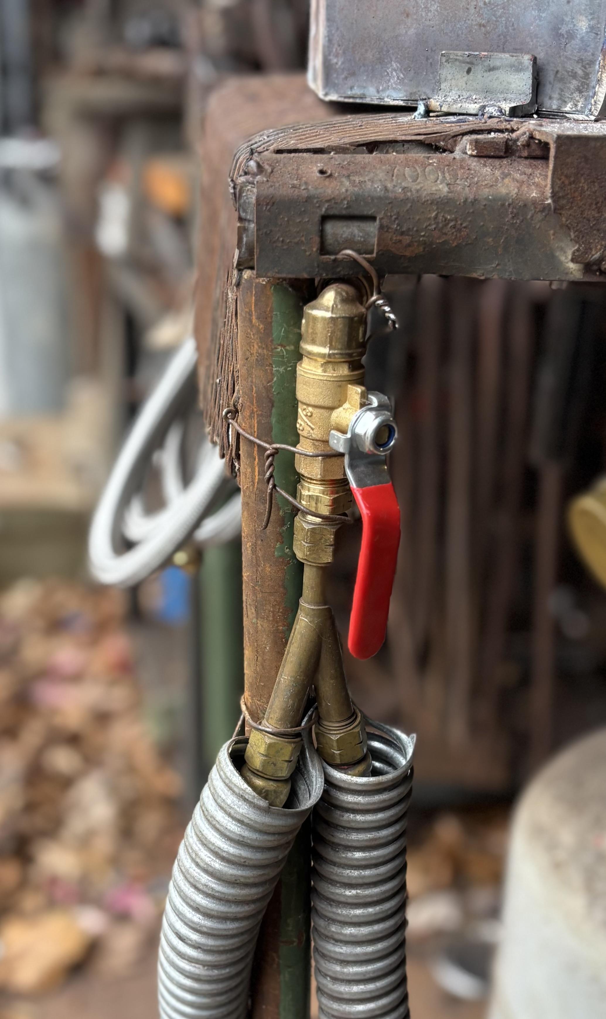

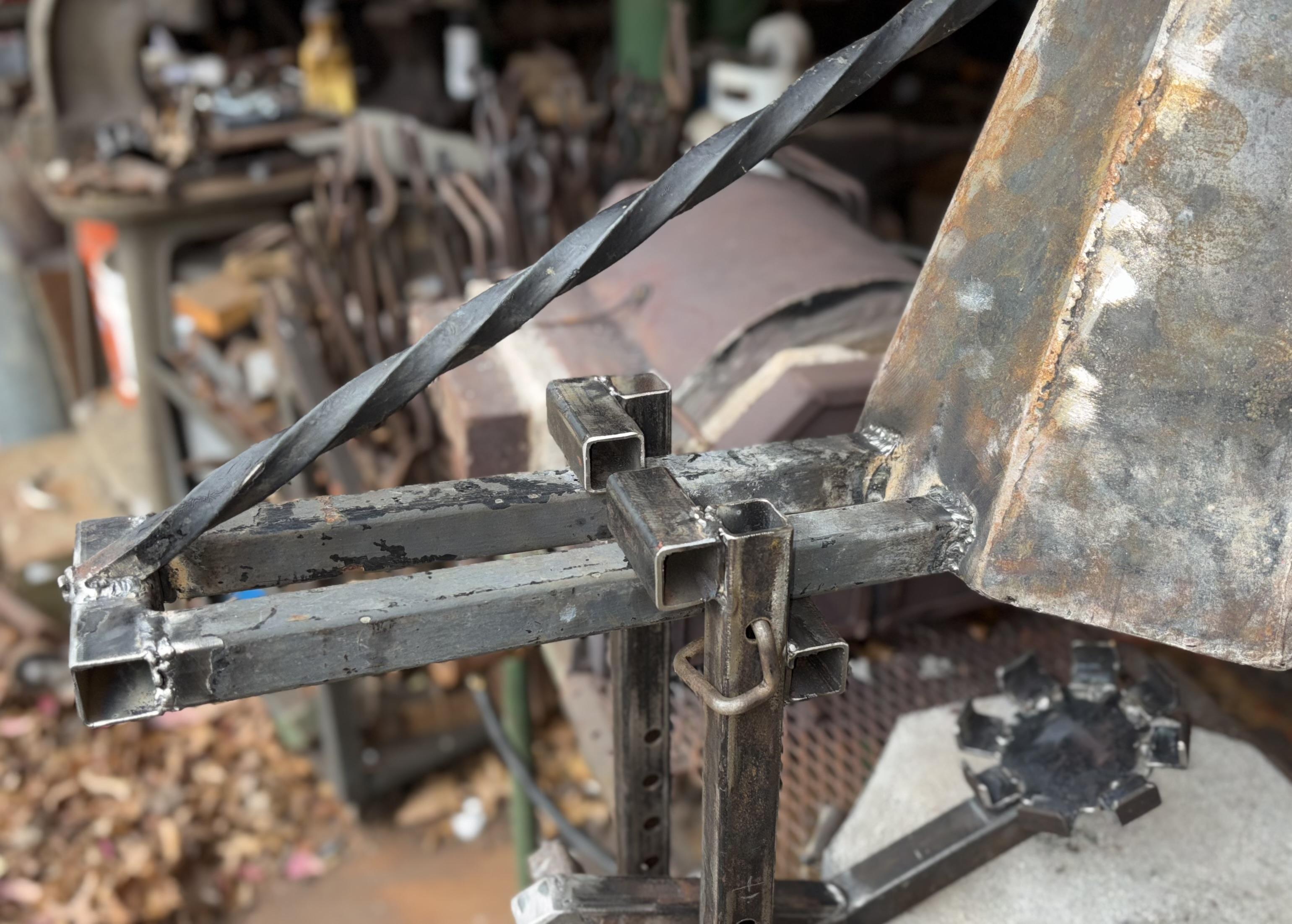

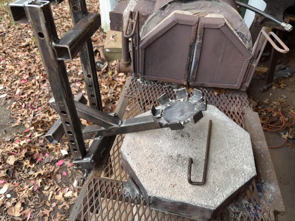

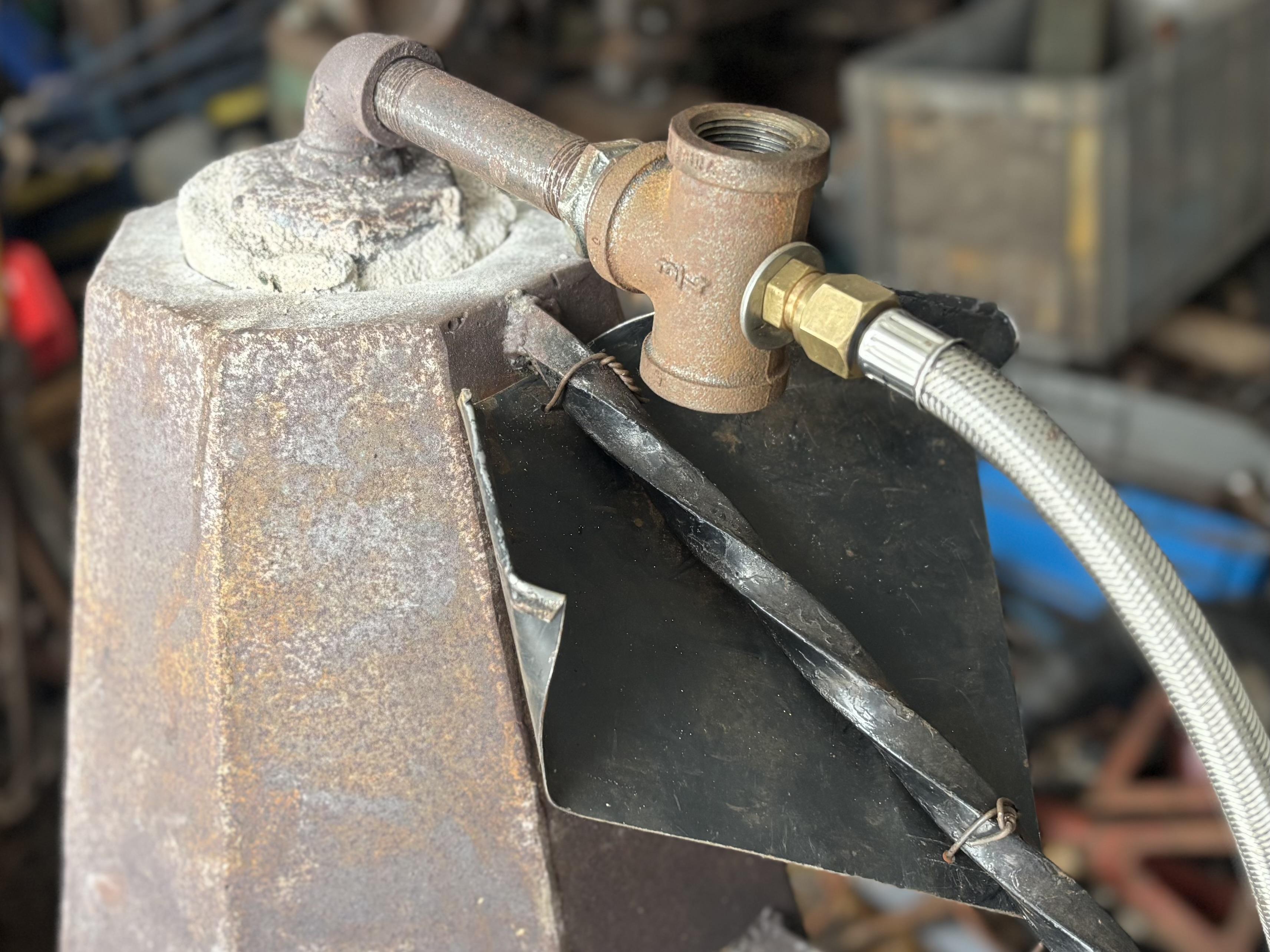

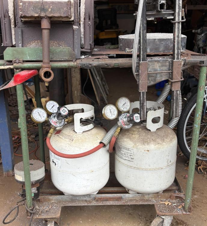

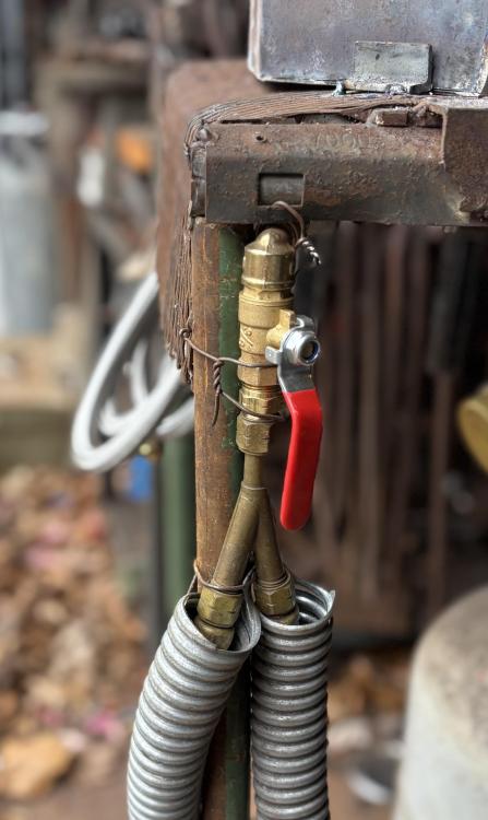

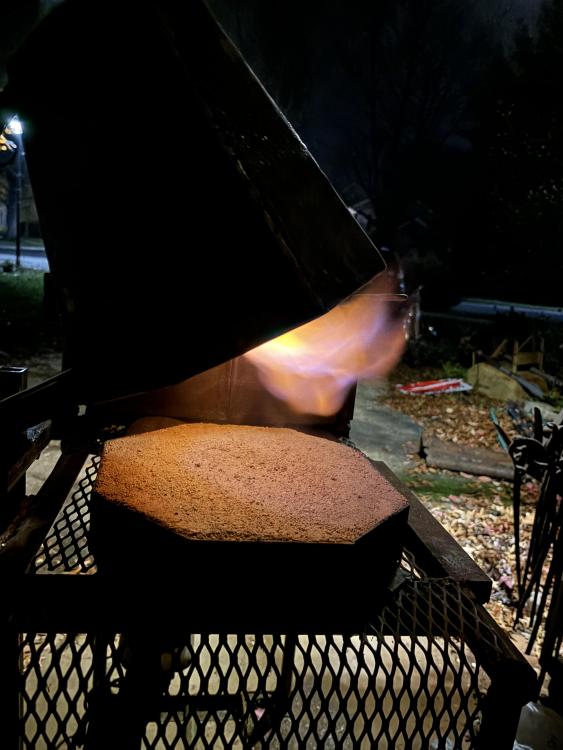

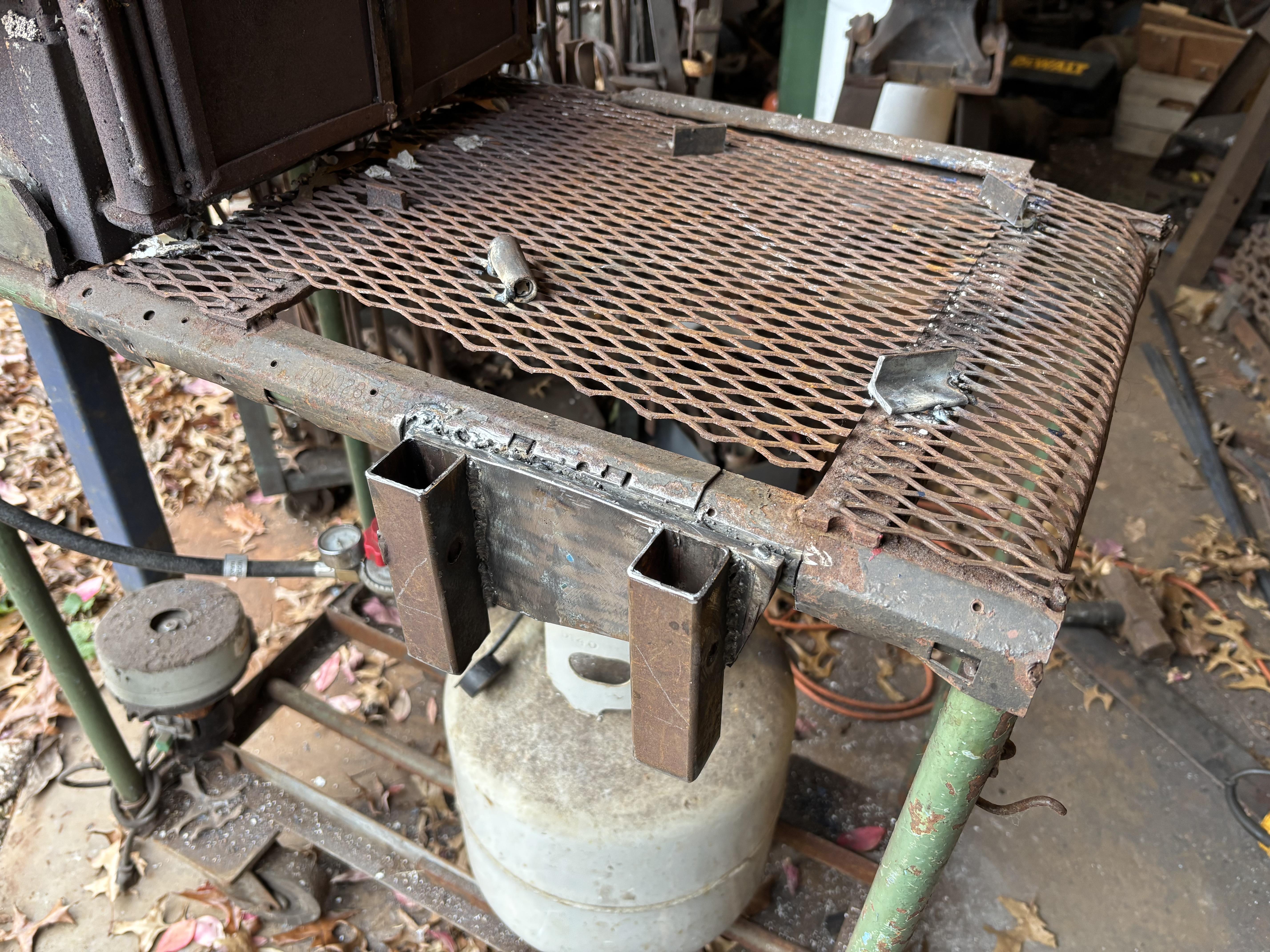

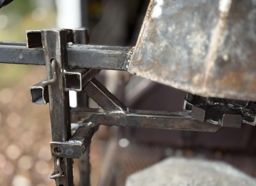

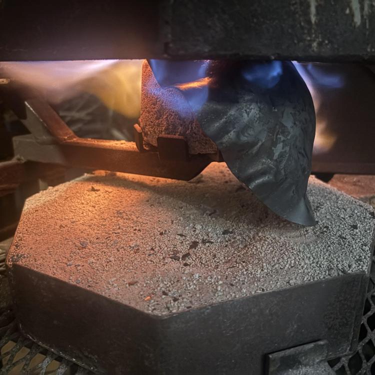

JHCC Posted November 28, 2024 Author Share Posted November 28, 2024 Update: I decided to go ahead and make such an arm to hold a block of refractory. So, here’s the whole process of setting the entire rig up for forging. Here’s the empty cart, showing the mounting bracket: Here’s the vertical support set in the brackets and pinned at medium height: Here’s the bottom deck set in place: Here’s the arm and its pin set in the vertical support, but not yet at working height: The forge is set in place and pinned: The arm is brought to the top position and pinned in place: The forge is tilted up and the refractory block is set in its bracket on the end of the arm: When the arm is in its top position (as here), the top of the block is about level with the opening of the forge, holding the workpiece in place: The arm can also be set slightly lower: Allowing more clearance around the workpiece: And here’s the entire setup. The only thing remaining is to upgrade the fuel supply from a single hose (with a basic regulator and running from a single tank, as shown here) to dual hoses, each with its own proper regulator, piped into a braided metal fuel hose. I have all the pieces for this already assembled; I just need to make a mounting bracket to hold the Y-junction in place. Quote Link to comment Share on other sites More sharing options...
JHCC Posted November 28, 2024 Author Share Posted November 28, 2024 Addendum: ended up just wiring it to the frame of the cart: Quote Link to comment Share on other sites More sharing options...
