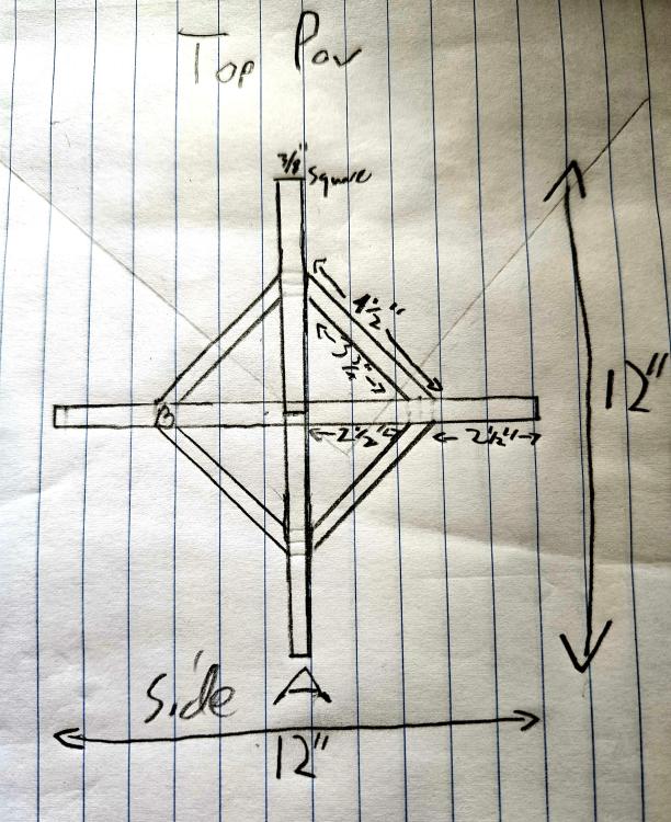

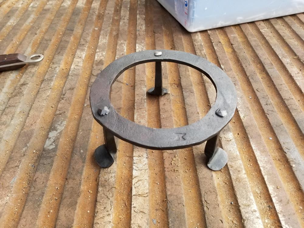

Sketched out a design of a pot stand that you can put in your fireplace as a commission from my brother

GTF, a stand on which you palce  pot on a fire or on the table is called a trivet because they often have 3 legs. E en if they have more thn 3 legs or no legs at all it is a trivet, aka a fire stand.  Nice work.
GNM
Also sometimes called a "spider", although that term is also applied to a frying pan with attached legs.
Just an FYI MacLeod, propane tanks are not mild steel, they're a medium carbon though I don't know the grade.
Looks like a serviceable trivet from here. It makes me want to tinker with it and see if I could make a fold up trivet so it isn't in the way when not in use. I'm thinking it'd take slots in the main pieces so the angle stiffeners could slide to close it up. Hmmmmm, might have to get out the popsicle sticks and play with the idea.

Frosty please do design something.

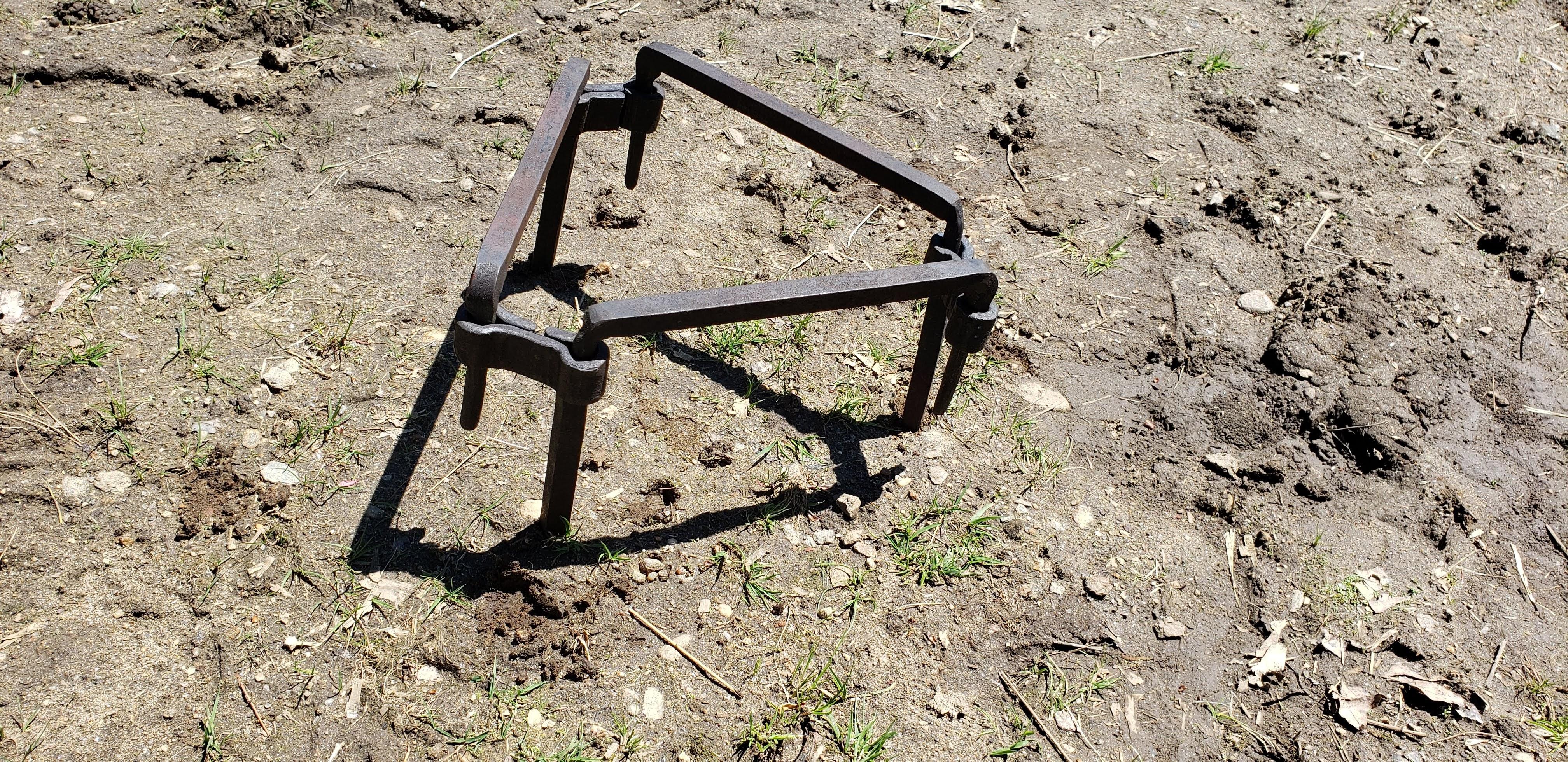

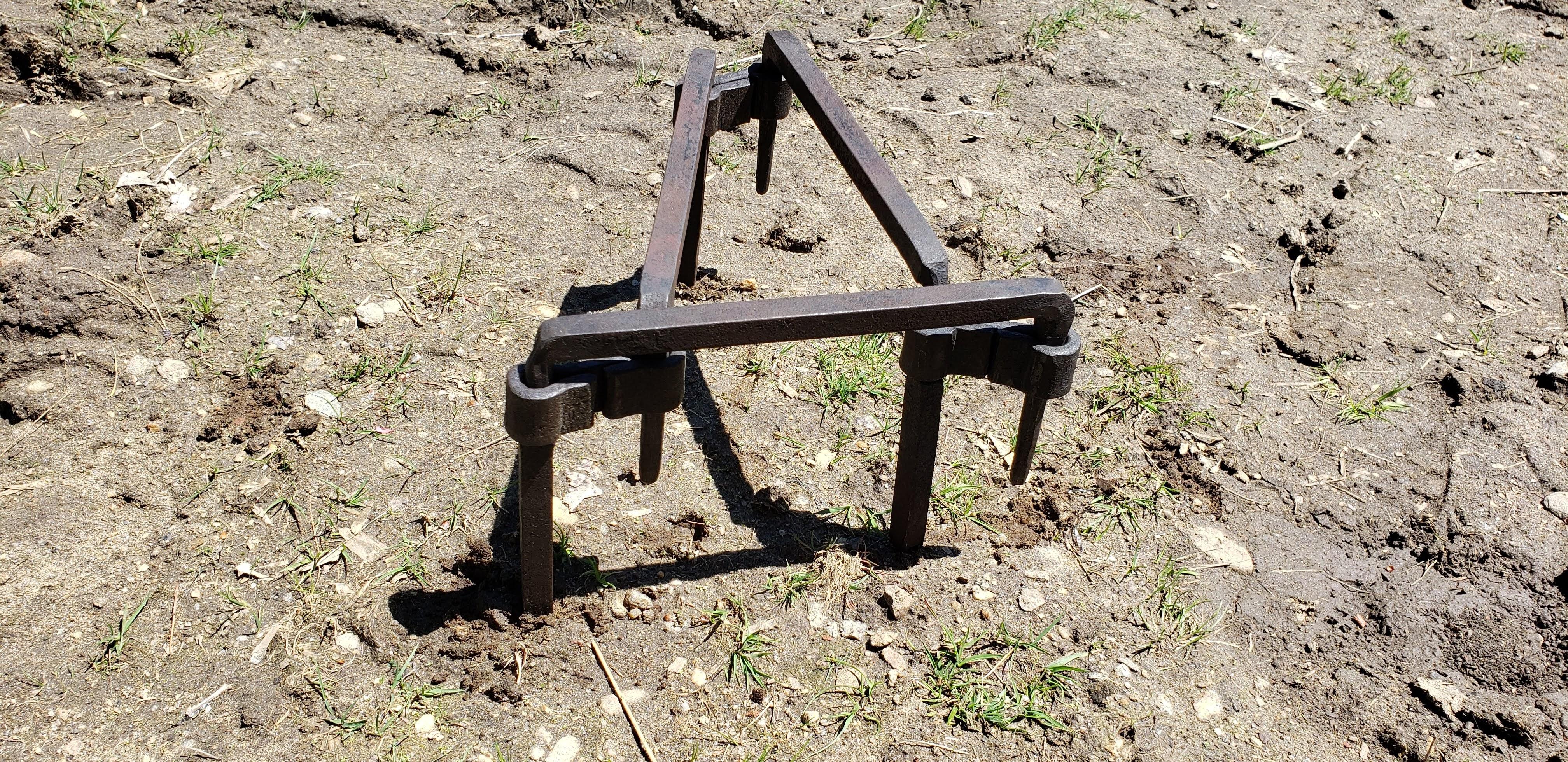

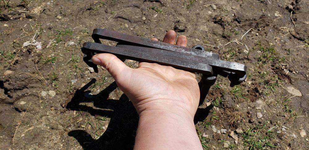

The caveat to the folding trivet I made was the person was complaining they could not forge weld so most options with traditional designs were off the table.
The design I came up with is sectional and adjustable and comes apart completely.
It can also be made larger with more sections though I don't see a need.
This model adjusts from about 3" to 12".
The only change of design would be some feet on the bottom for use on frozen ground.

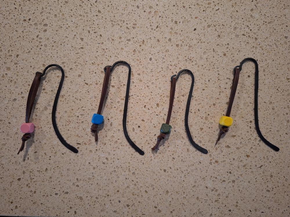

Our school year starts up this week so I've made a "goody" pack for each member of the teaching team I coordinate.
The final addition is a blacksmith's bookmark. I made these ones from mattress spring. They're quick and easy and you can heat them with a torch (although I did most of the work on these on charcoal in my JABOD, just cos I hadn't lit it in a while).
Just square one end so you can twist it, twist, bend a hook with a curlicue, then flatten the other end to a thin section and put a sweeping curve in it. I finished them with an oily rag at black heat and then wiped them clean once cooled and added the leather thong and bead.
I think they'd make a great, quick demo piece and a value-for-low-price-point sale item (although I haven't done any selling work, yet).
Thanks for looking!
Cheers,
Jono.
