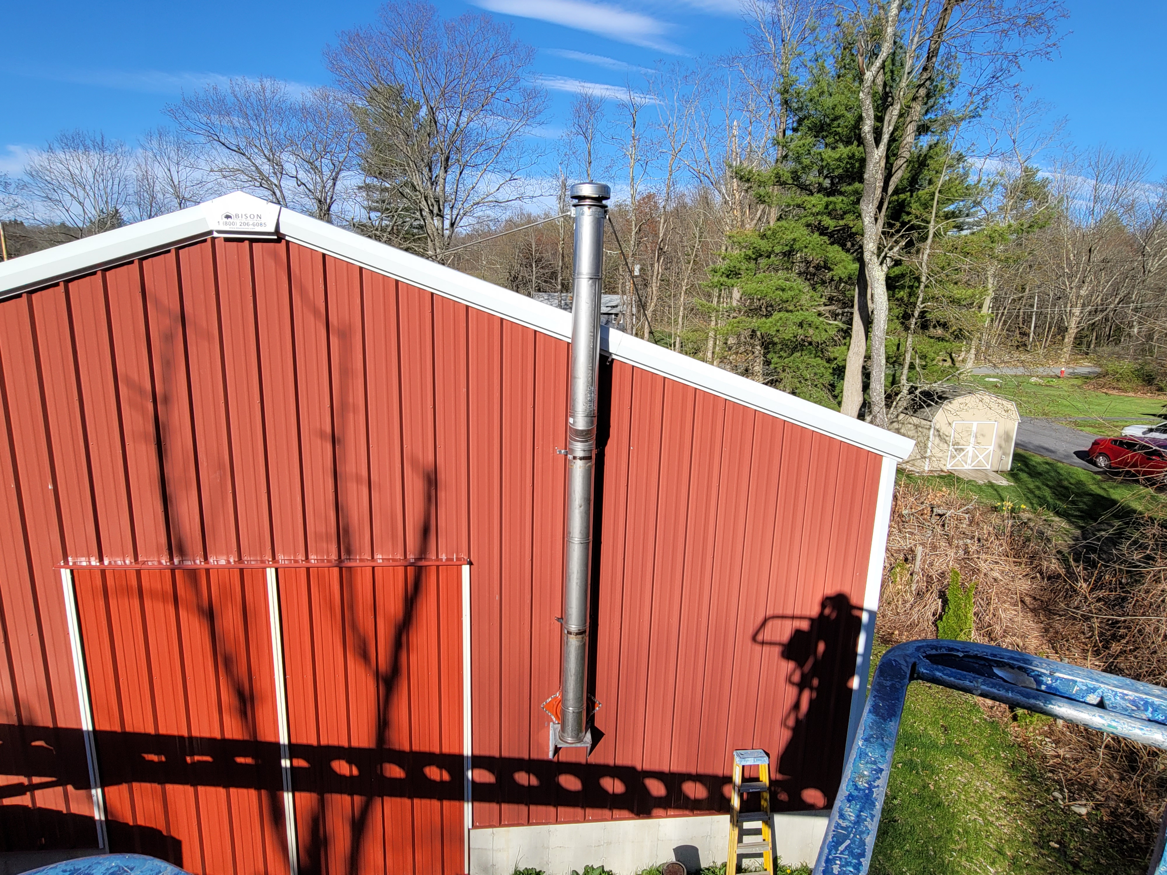

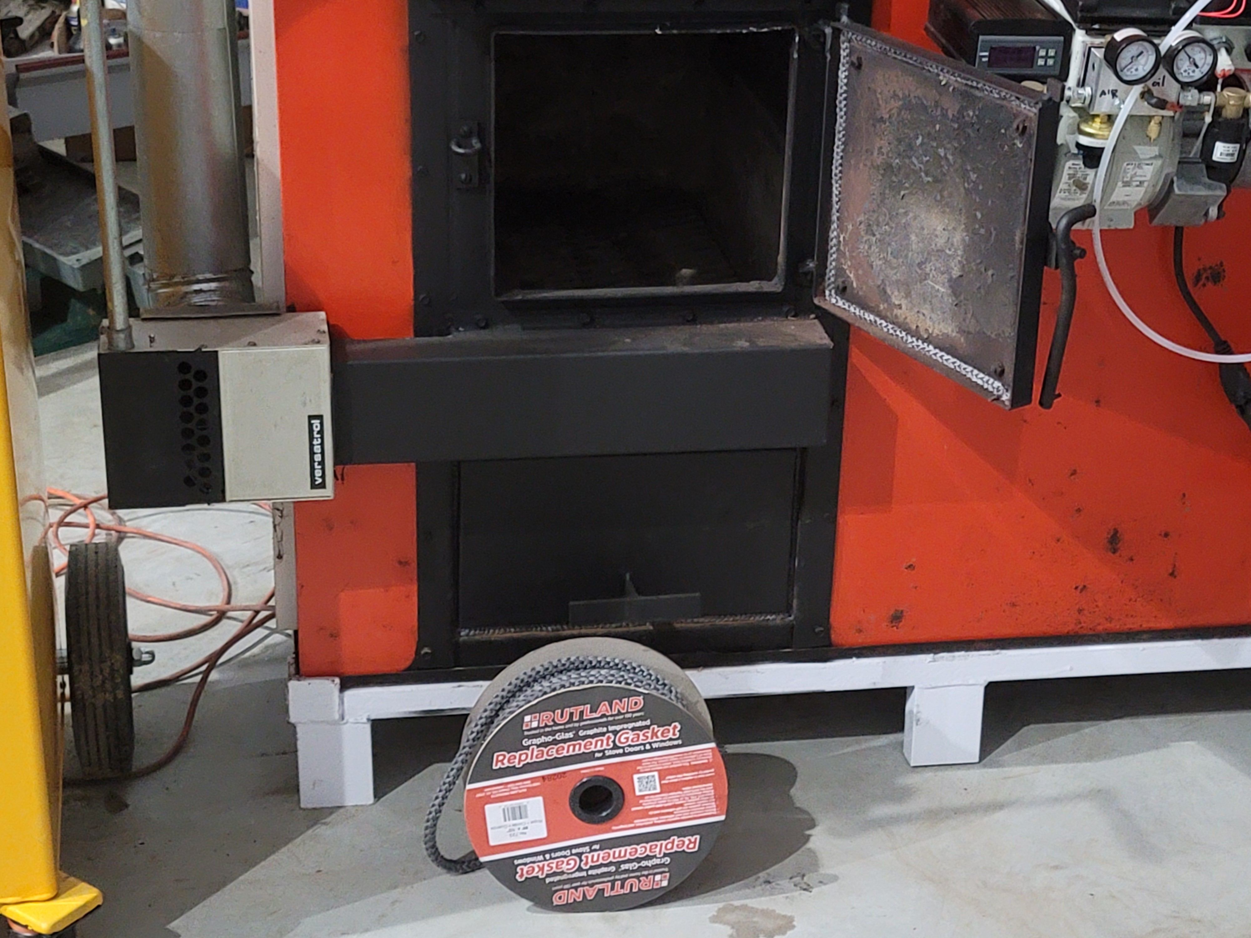

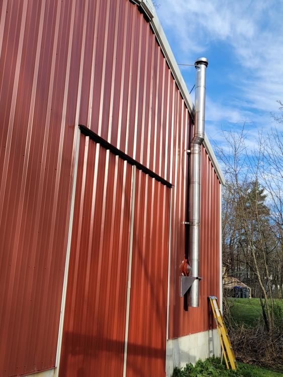

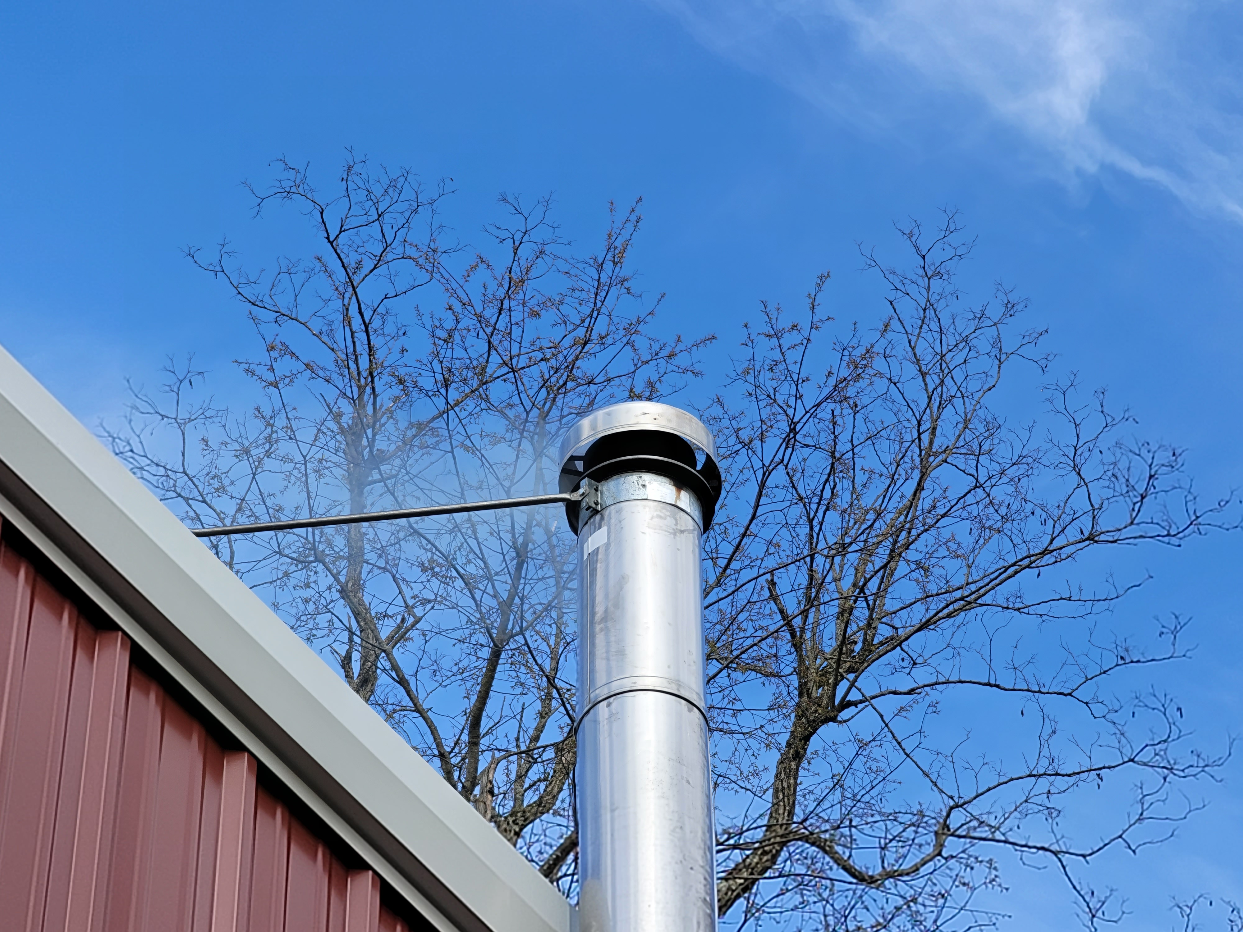

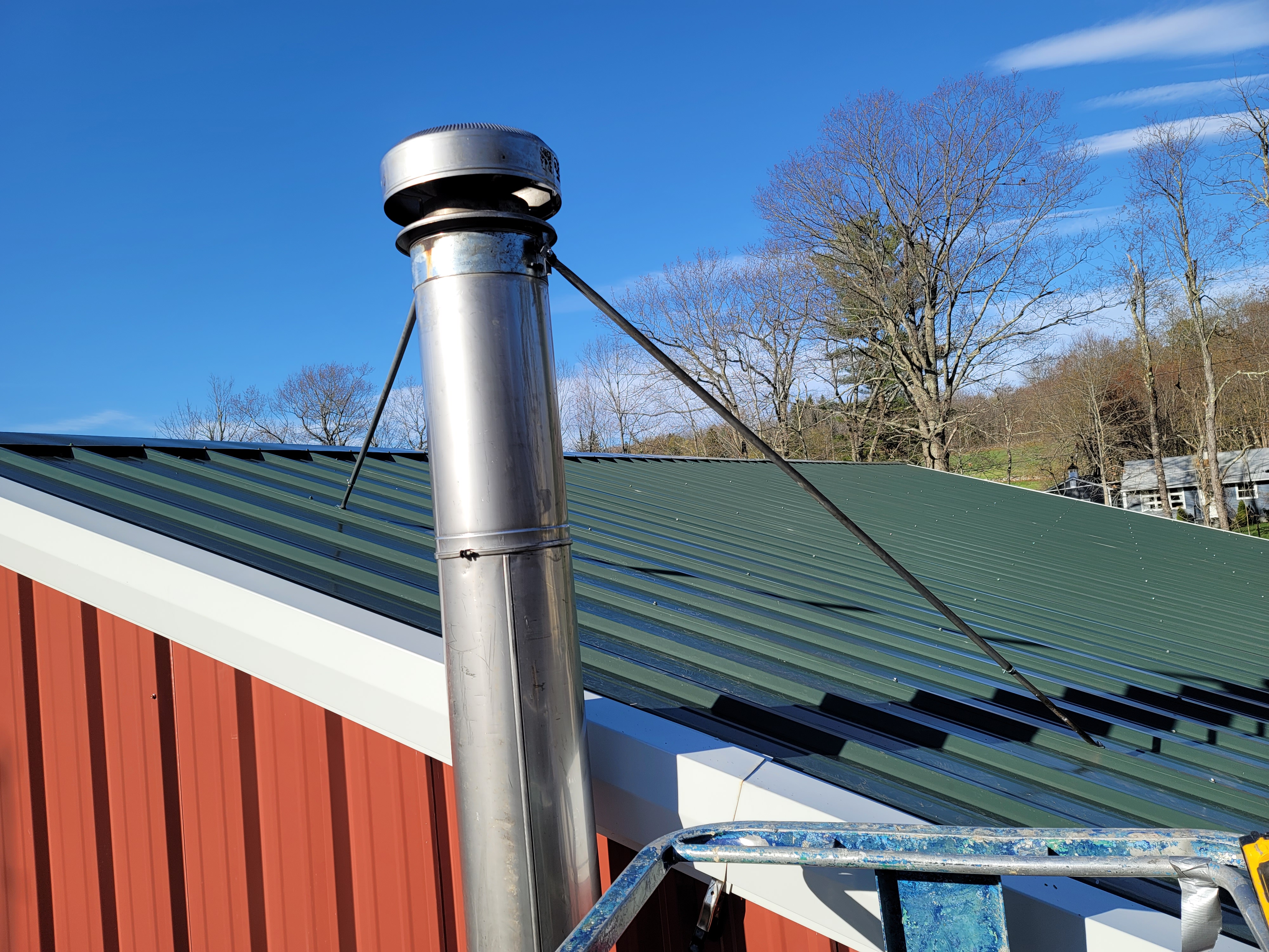

another banner day yesterday..  Got the stove pipe in and the chimney up and cap and seal installed..
Installed new door gaskets

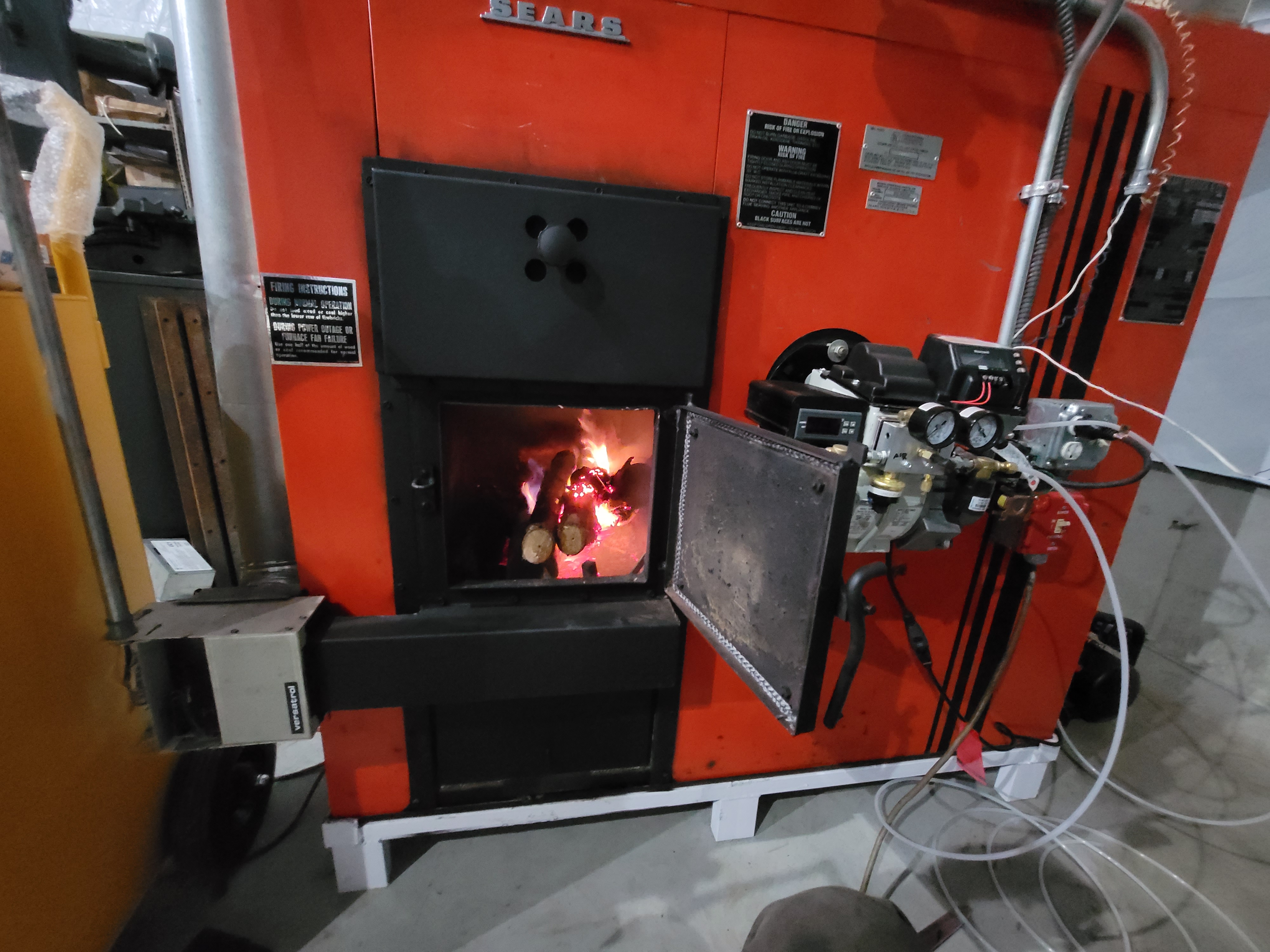

Now the new to me combo coal/wood/oil furnace is installed and fired up..

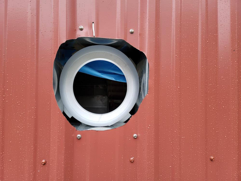

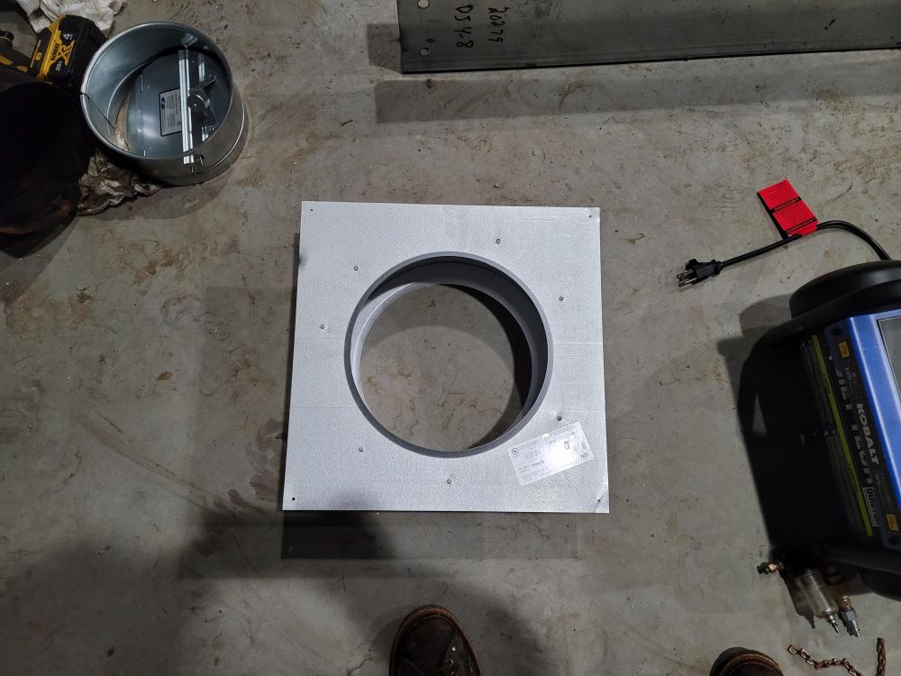

learned a bunch..  Because the building is steel corrugated the flange that would go outside has to be mounted inside..
The original hole was cut for the flange size.. which turns out only needed a 10" hole vs a 12" hole..
The flange seal I bought is designed for roof applications but figured it would work just as well for side wall..  Sadly with metal buildings there are a bunch of items which don't seem to be out there unless in the know, or adaption is relied upon.

Mr Pedro, thanks, it sure is.. Was so excited getting it lit..
We had several days in single digits and a - or 2..  many days in the teens..
The dual fuel will be really nice..  Wood, coal, used oil, kerosene, or fuel oil or diesel..  The options are pretty good.. Once the Propane is installed I can install a propane burner if the desire is there..

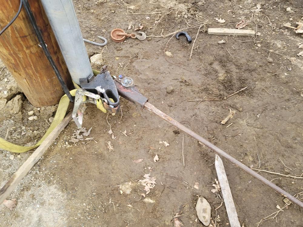

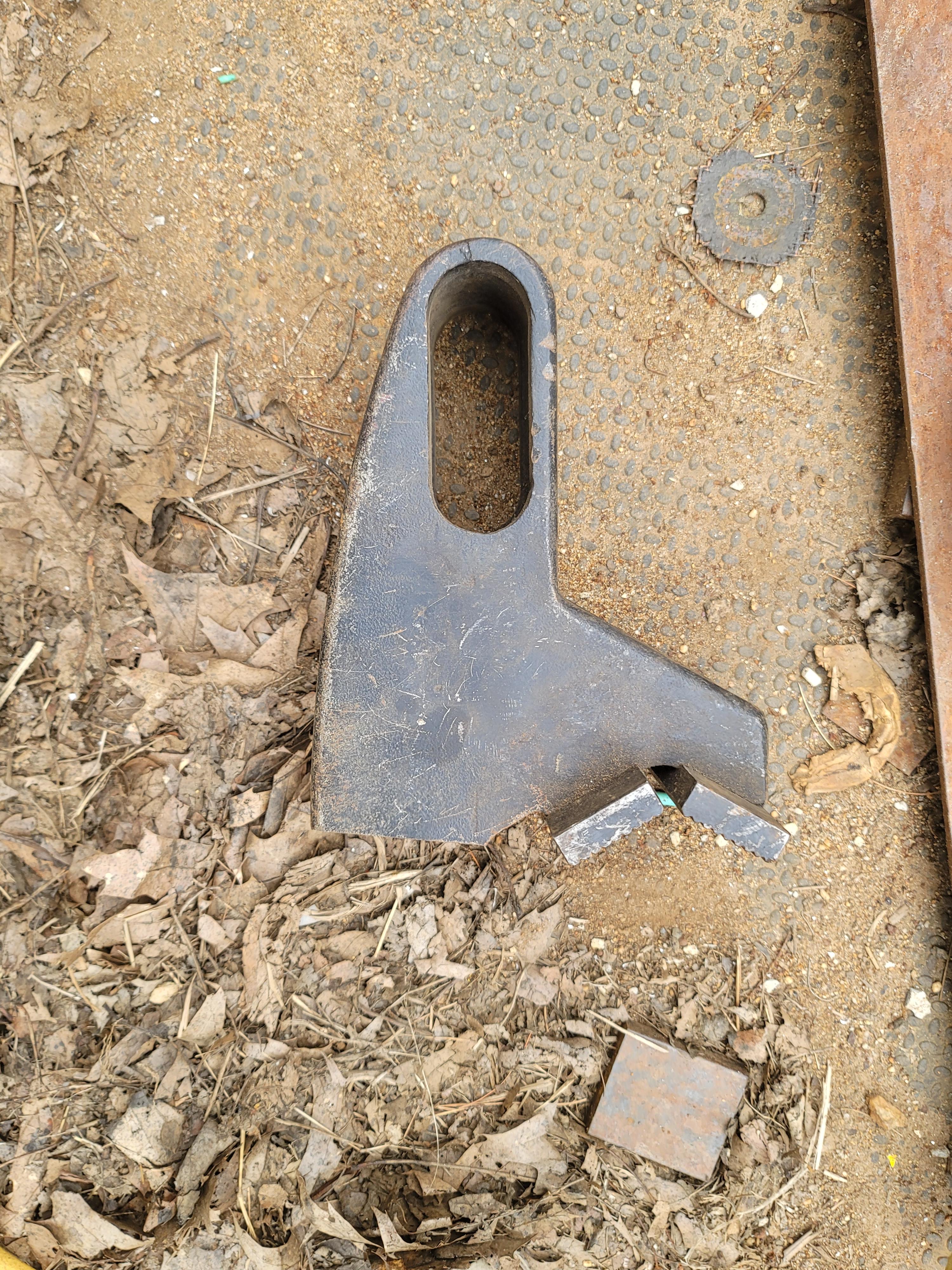

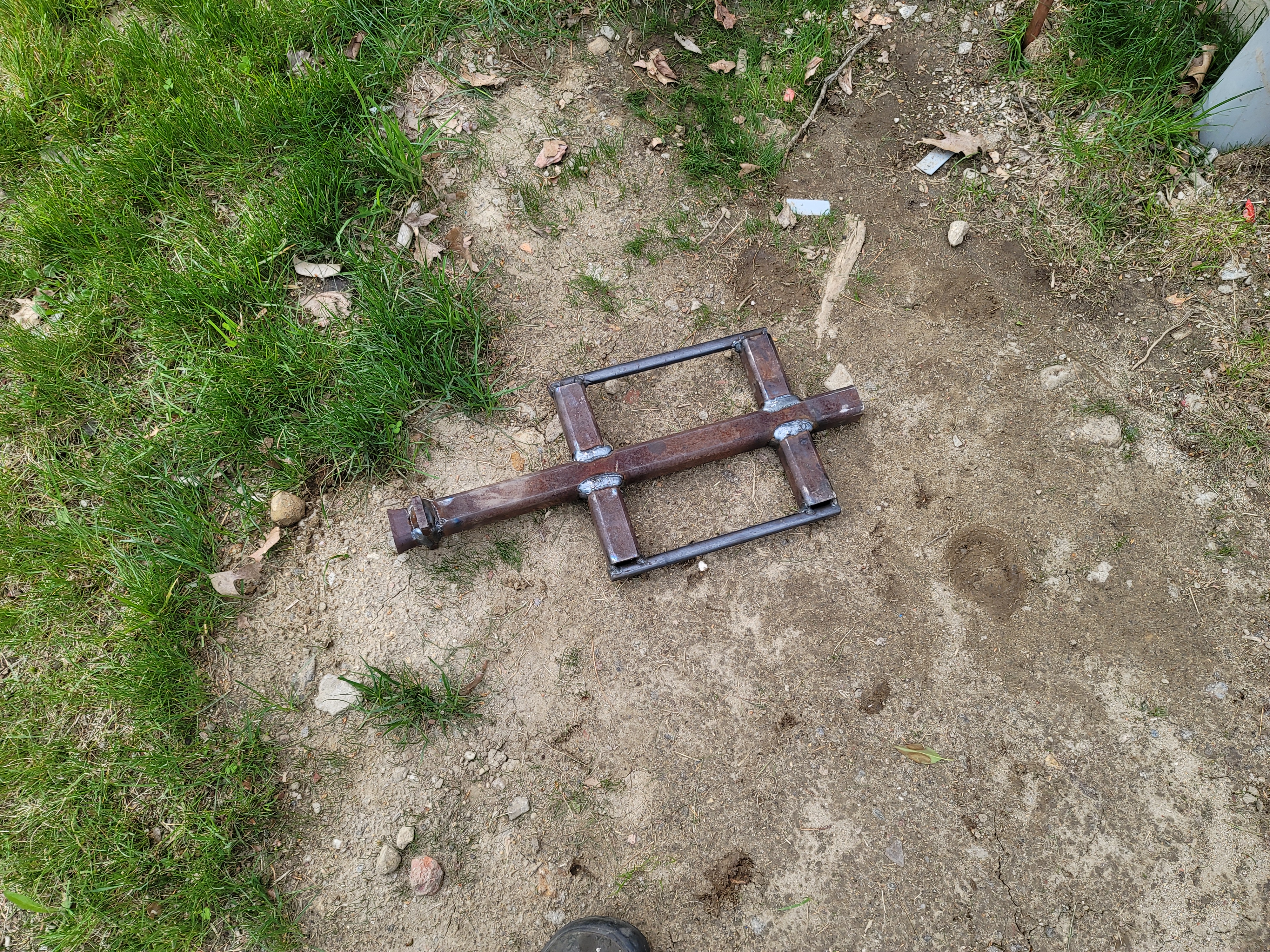

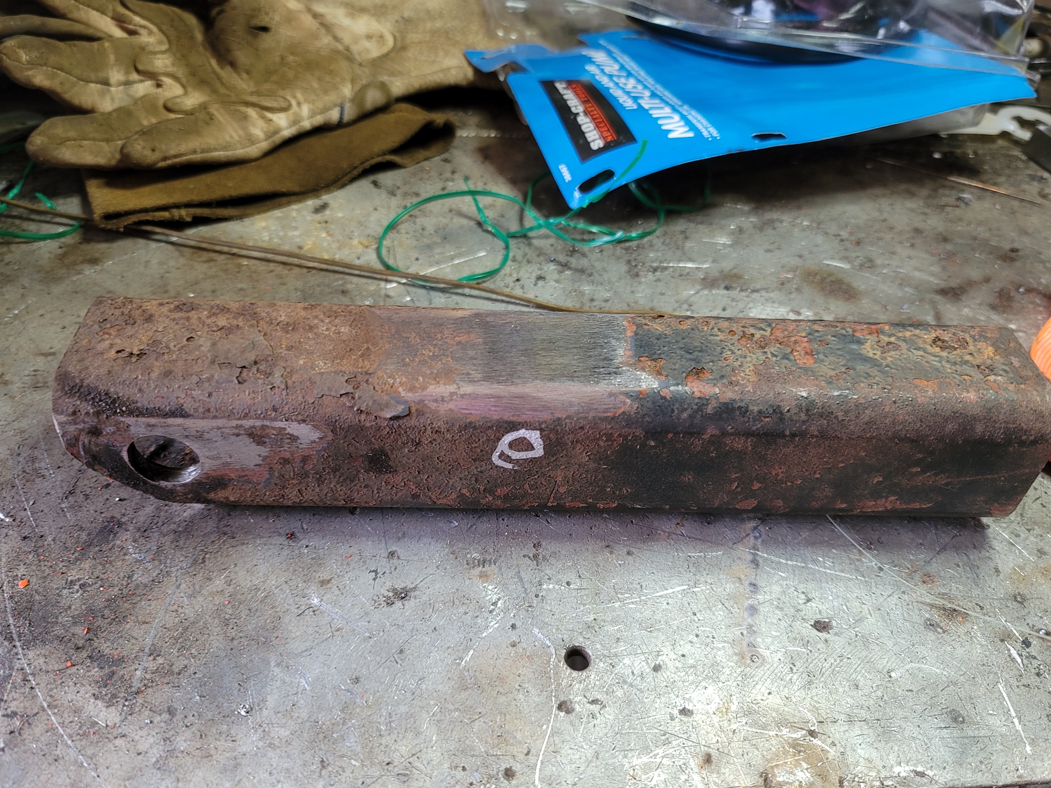

So after some thought I came up with a plan for the pipe wrench..  It worked mint..
Aligning the pipe went super well.. Could not expect it to go better.  I put a couple of blocks on the side of the pole and then leaned the Rigid over some till I thought it was aligned..  It screwed right in..
the wrench only needed 1 redesign because there was no way to get get the bolt section on the wrench body..
The teeth could use to be a little sharper but overall a raging success..

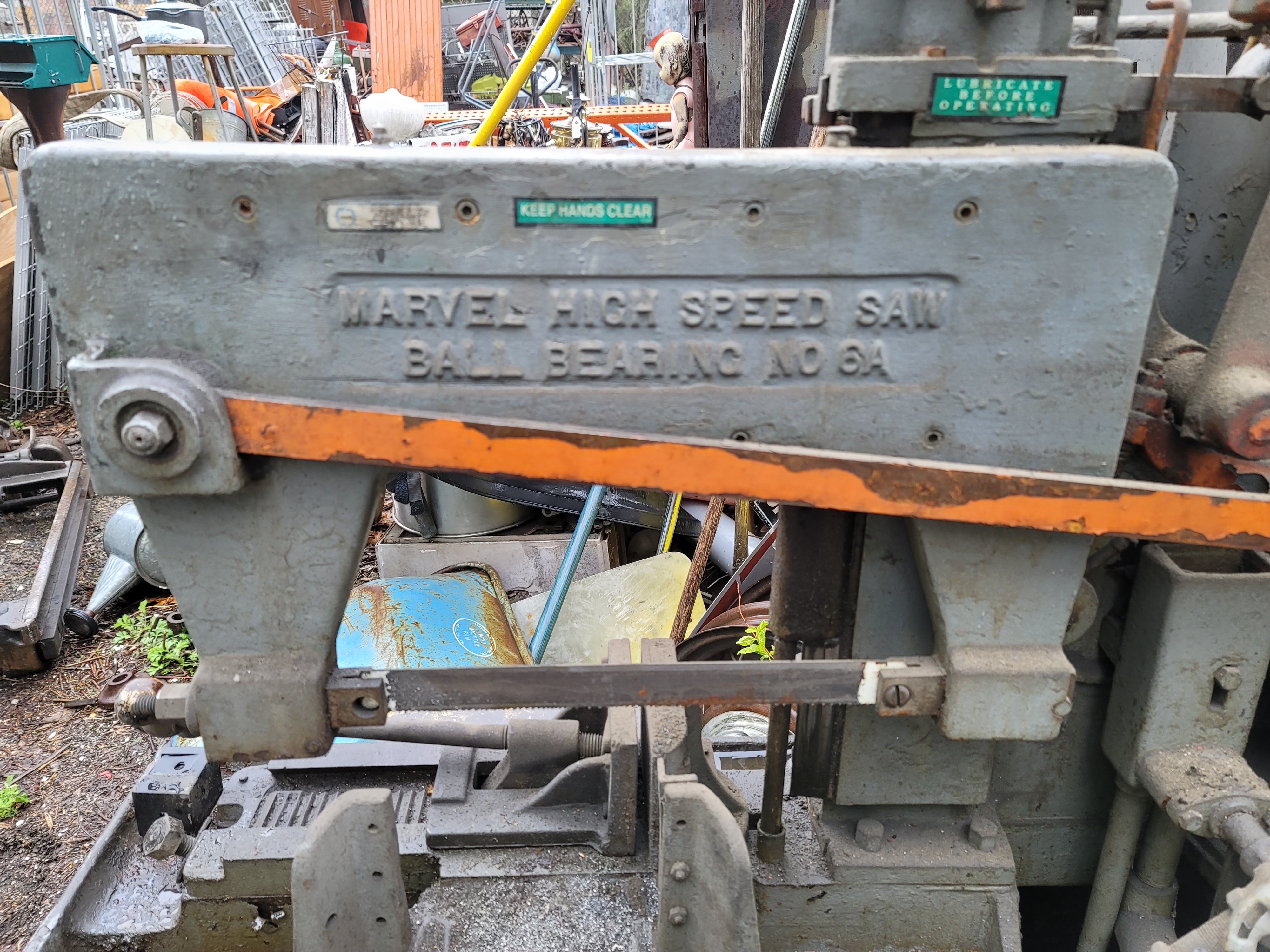

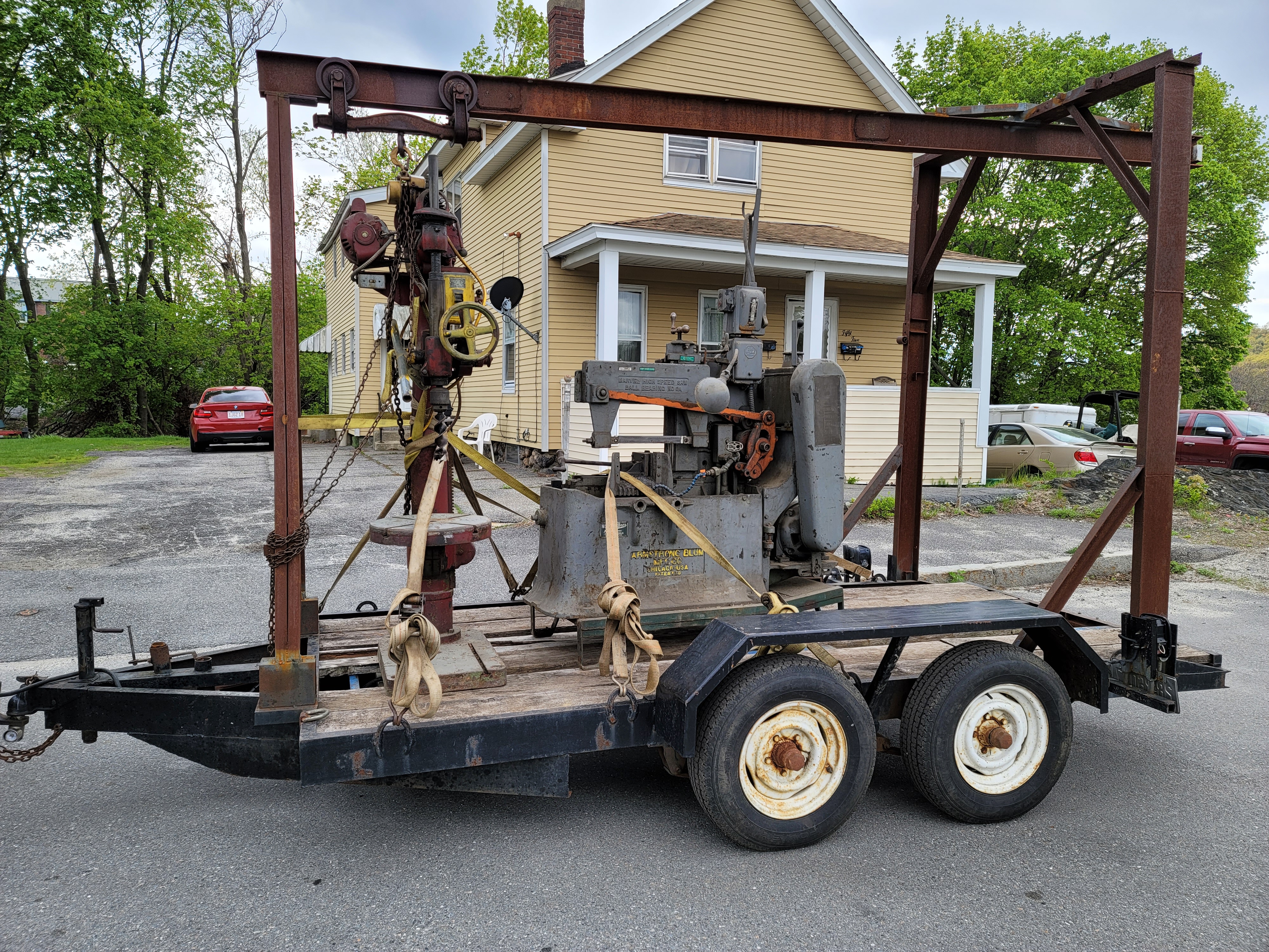

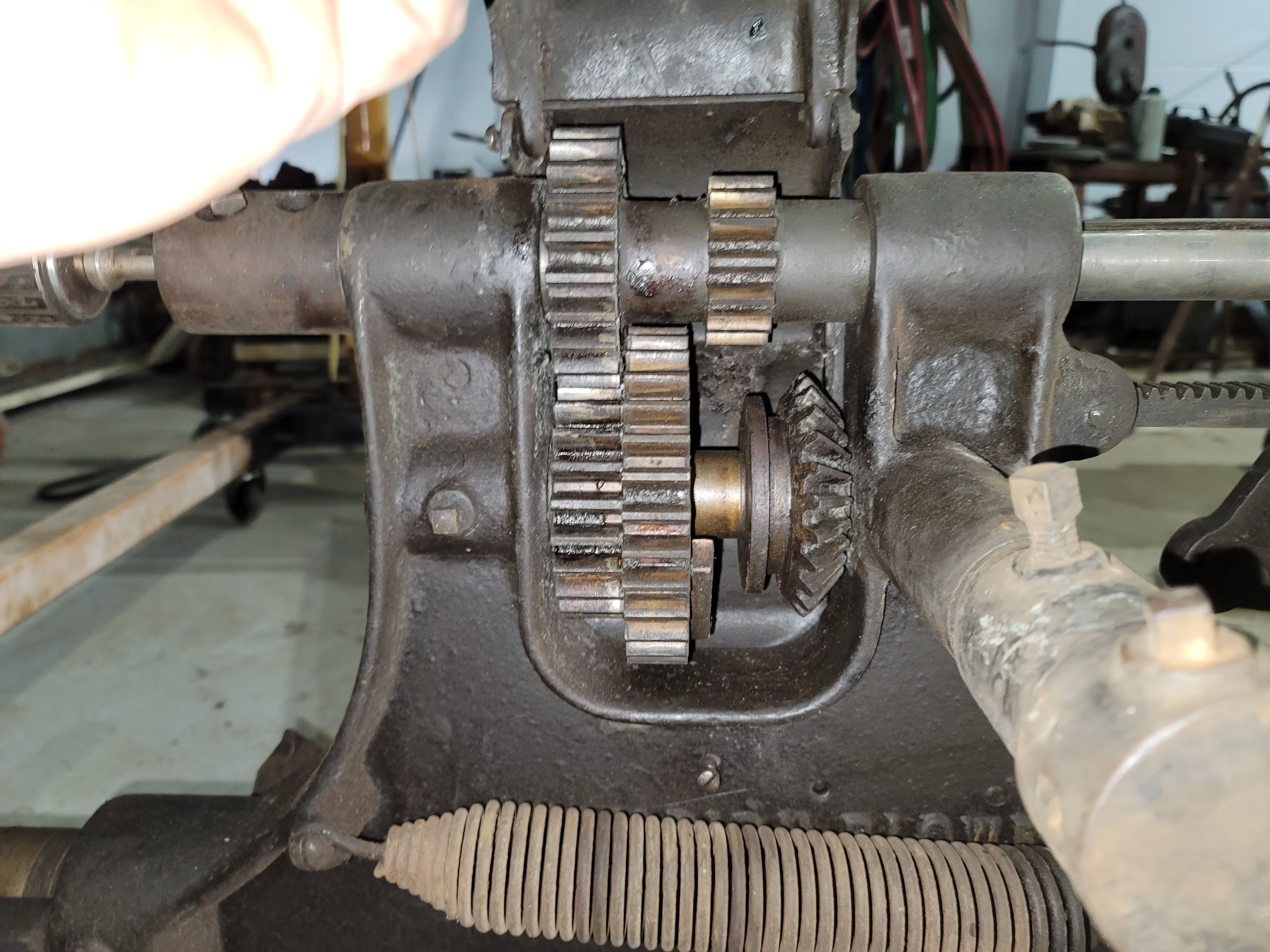

I picked up this Marvel power hacksaw 6SA and a camelback drill press that was custom modified so it would use a small car gear box to power it..
The Hacksaw is 3ph and the drill is 1ph..
Here are the manuals for the Power hacksaw.
22693.pdf 5923.pdf 5924.pdf 5925.pdf
Very cool. I'm sure those will be great additions to the shop!
Thanks.. I'm hoping they will find a perfect place..   Once I get electric installed I will start shop layout for the machine shop area and welding and metal prep areas..
The items not used will go up for sale.. At this point of my life having and extra 3 or 4 of something is not really needed anymore..   :)   Or is it????

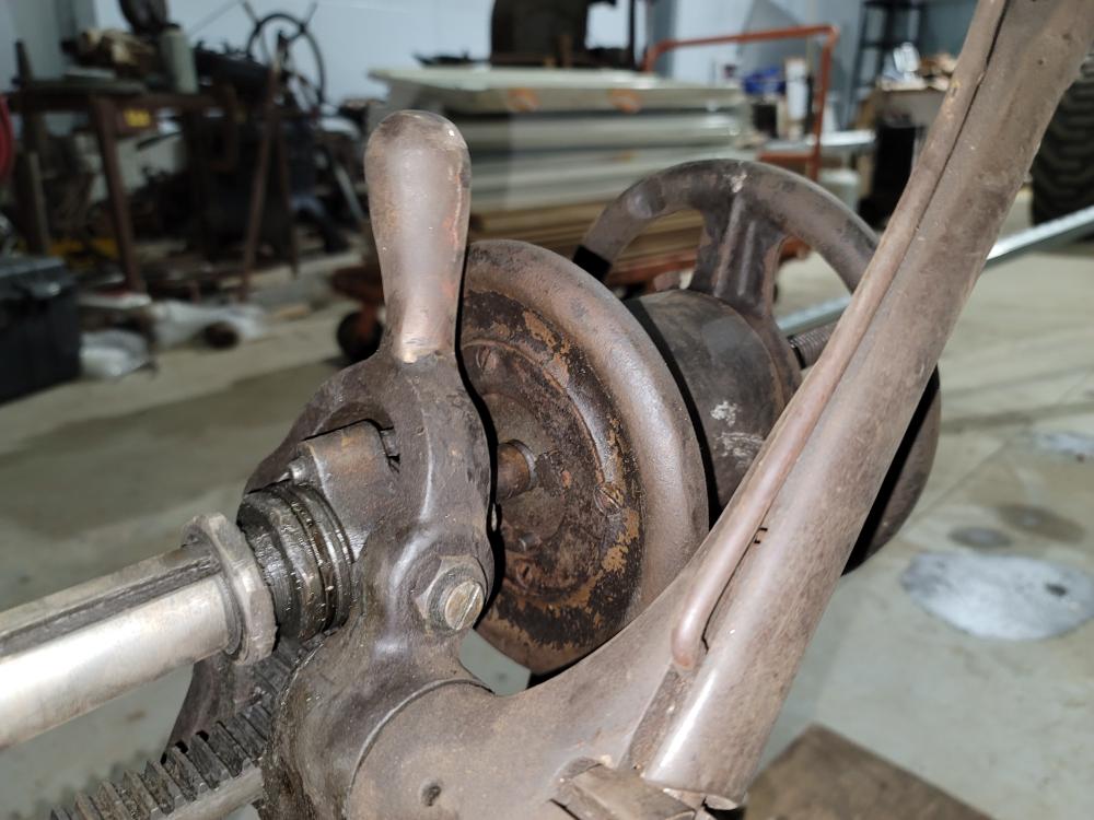

Would I love to get more stuff.. For sure.. Am I always looking..  Yes..   Just like the latest Champion Drill press..  She is a biggin..  Model 201..  I thought the Cannedy Otto New model 16 was big..  LOL..   Not even close.. 100lbs more would be my guess on the 201..
Latest addition..  Got it a few weeks ago..
Champion model 201 This one has the addiion for belt drive and electric motor..

It is amazing stout.. Very much an industrial type..
The Cannedy Otto New model 16 seems small in comparison..
I will try to get the 201 mounted where the Model 16 is and move the 16 to where the little hand crank drill is now..

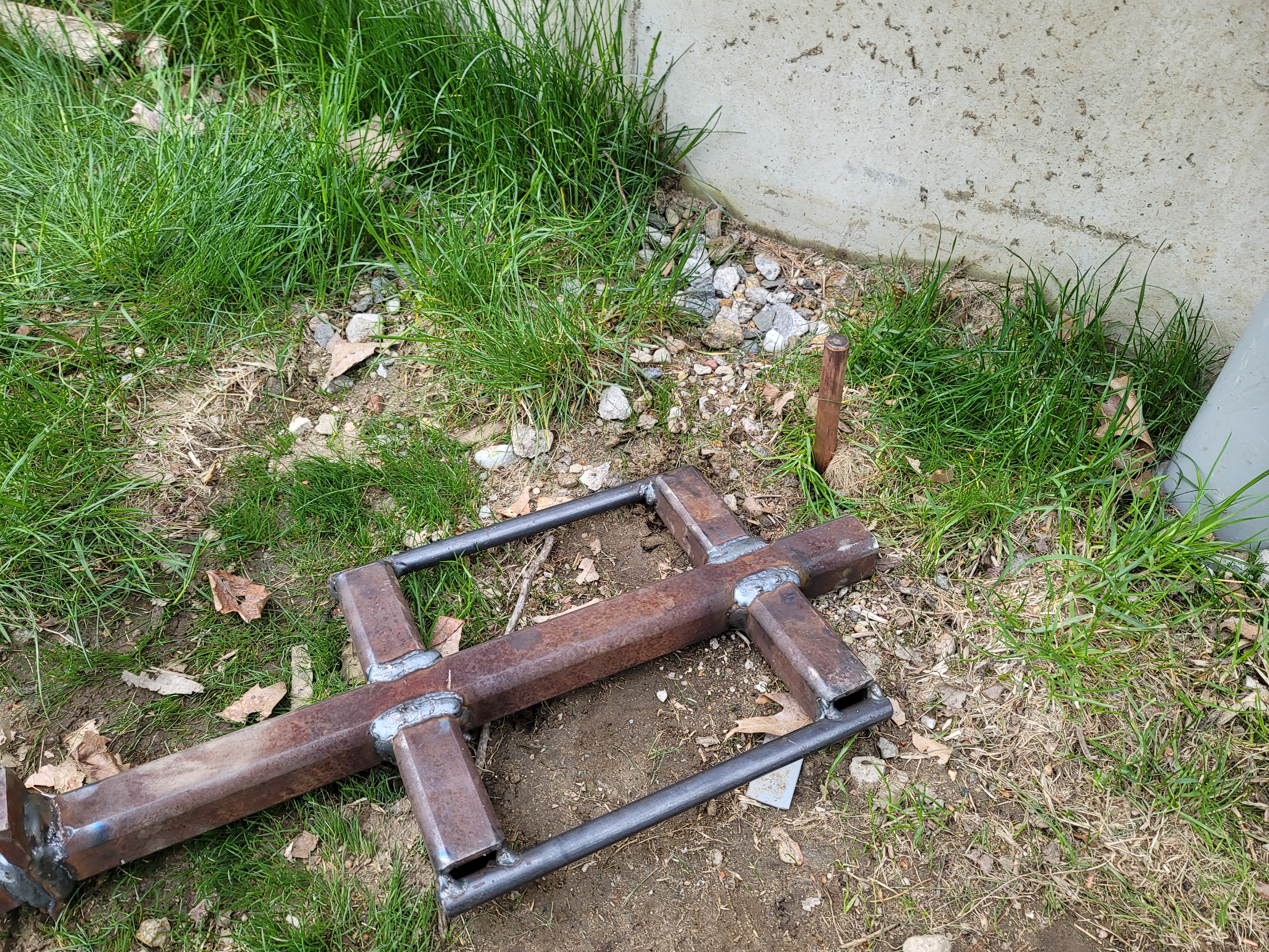

Todays progress was getting the 10ft X 3/4" grounding rods installed..      I figured I would have extra so driving them in past the 8ft mark would mean having that extra 2 ft to hammer on..
I actually worked diligently enough to get just about all the 10Ft in the ground.  I left about 4" up so I can still locate them easily..
Once I have the grounding wire in hand I will run the cable in a trench and bury them.
With the angle of the in ground conduit I was not able to put the first rod directly under the panel I ended up moving it over and out to stay away from the footing also..
I welded this driver up so I would use it to start the rods and then use it to bang on if the rod stopped moving..
It worked very well.  the short end for driving when it gets stuck or when it's in the ground..  The long side for using as a pile driver..
The weight is decent enough to have some force but not so heavy it can only be moved 5 times..
Worked like a dream with the longer rods..
When driving ground rods, it’s usually easier to “float” them in. Jam the rod into the ground by hand several times until you have ~6” of rod in the ground. With the rod in the ground, move it in a circle until you have created a “funnel.” Remove the rod (it should come out easily at this point) and fill the hole with water. Work the rod up and down in the hole without jamming it into the bottom (it will get stuck if you hit the bottom too hard), you are basically creating a water hammer to move the dirt. When the rod starts to feel “sticky” in the hole, remove and add more water. Rinse and repeat until the rod is at desired depth leaving about 6-12” extra. Drive the last little bit with a sledge to “seat” the rod in the hole.
This method works extremely well in sandy soil (I can have an 8’ rod in, in less than a minute) and better than a hammer or driver in clay soils. Rocky soil is about the only time a driver is more efficient.

Amen..  Brutal..   I knew better to make it to heavy..  Was just right..  1.25X.25" sq  Was perfect.. Even when coming into contact with rocks it would still move if only a very little but I wasn't beating myself up using it..
Between fabricating the driver pulling the manlift into position and driving the 2 rods was about 1.5hrs..

Here only 8ft is needed per code and 5/8"..
I went with 3/4" and 10ft..   I used both a 6lb and a 20lb sledge hammer when the time came..
Since I was by myself there is nothing like hitting the rod which is stuck on a rock 4ft down and there is no way to pull it back out..
The driver worked very well and once I got to the 6ft mark there was enough with the driving on it to spank it with the sledge and the tool keep the rod from moving everywhere.
Worked mint..
