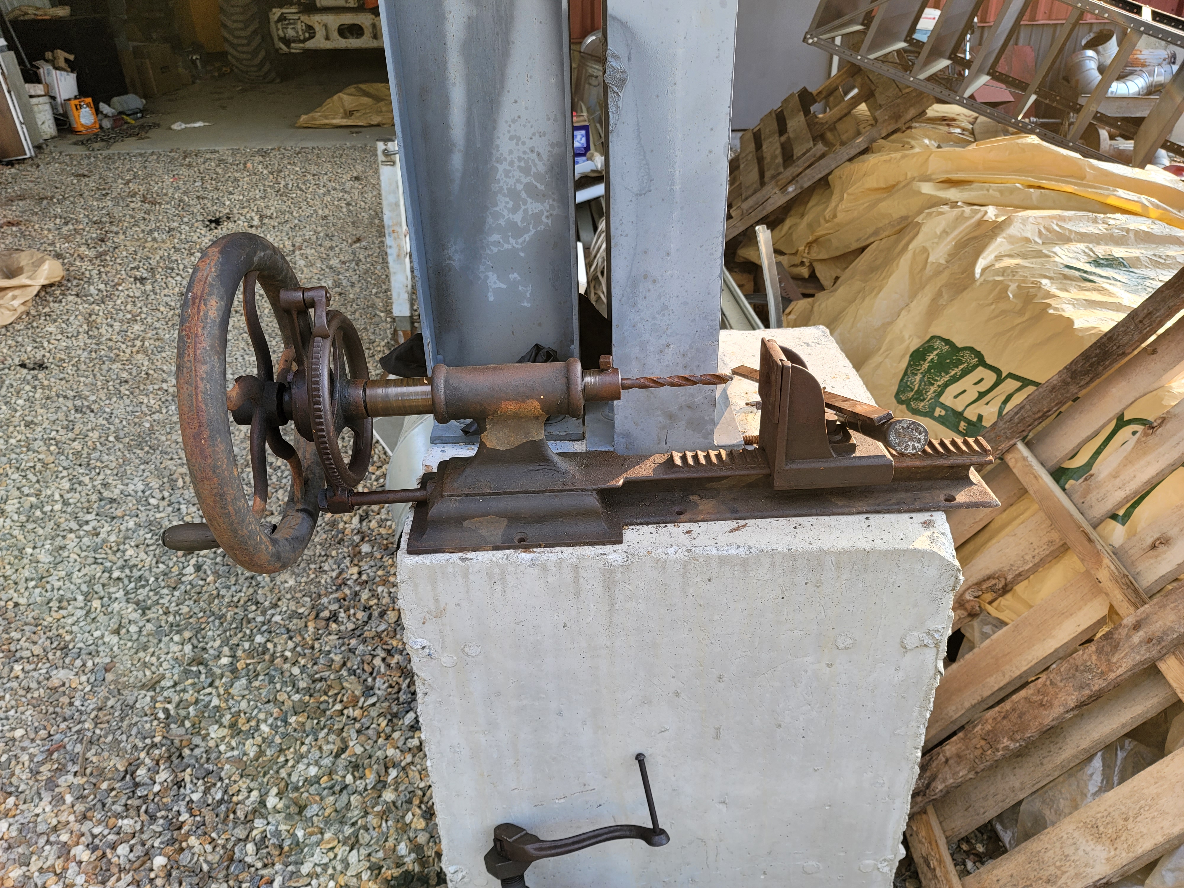

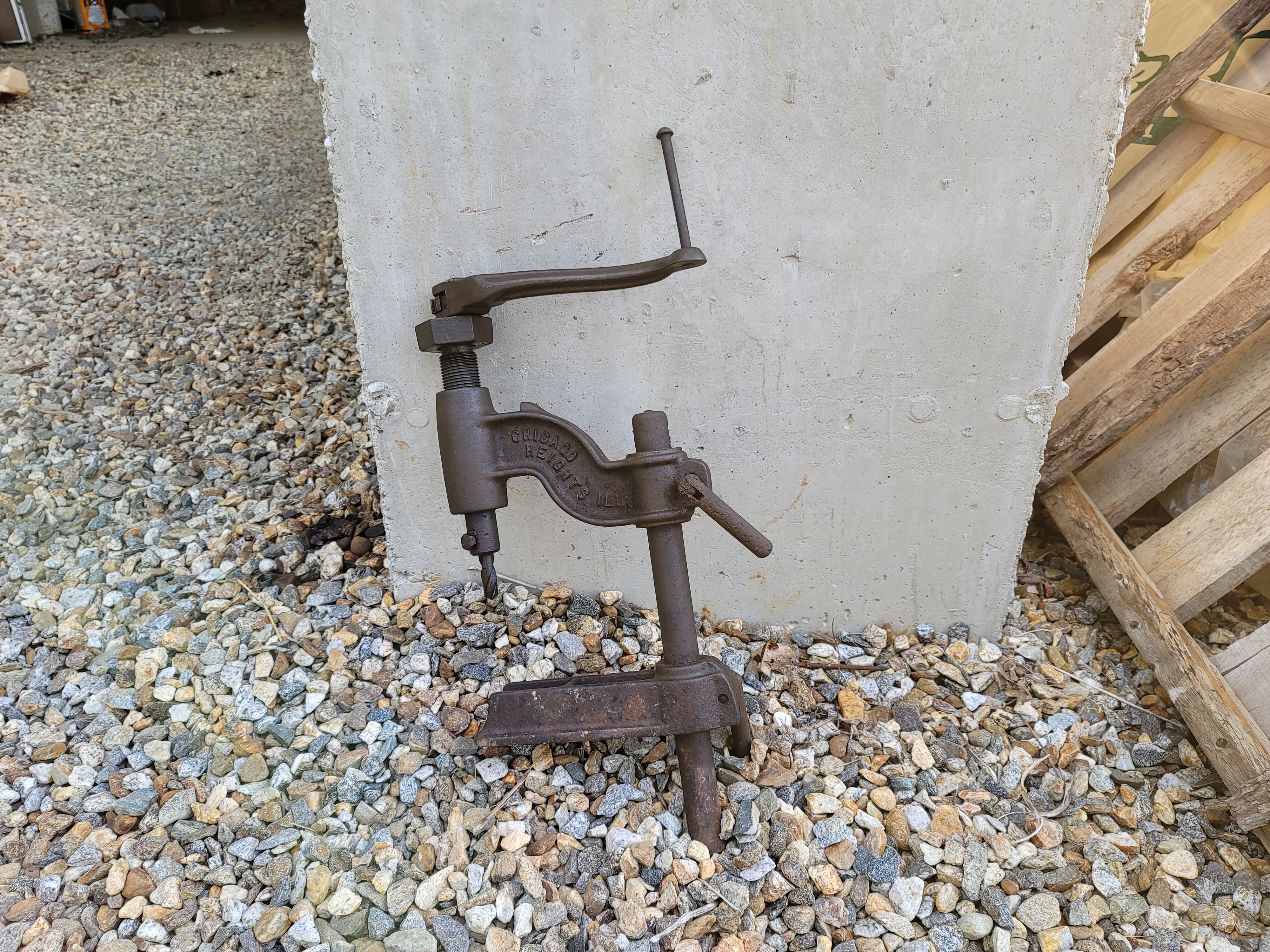

Frosty, I found a 200 series drill press up in Blandford, MA and he also had several other drills that look like they came out of a carriage shop..
The 200 is solidly frozen up..
I do a lot with old equipment including items found out in dumps from a hundred years ago and I have never had an item as frozen up at this..
The 2 smaller drills freed right up, within minutes with nearly all functions working.. Not like 2 min, but more like 30min..
I was able to get the flywheel and the speed gear freed up..  I have never seen something so seized.

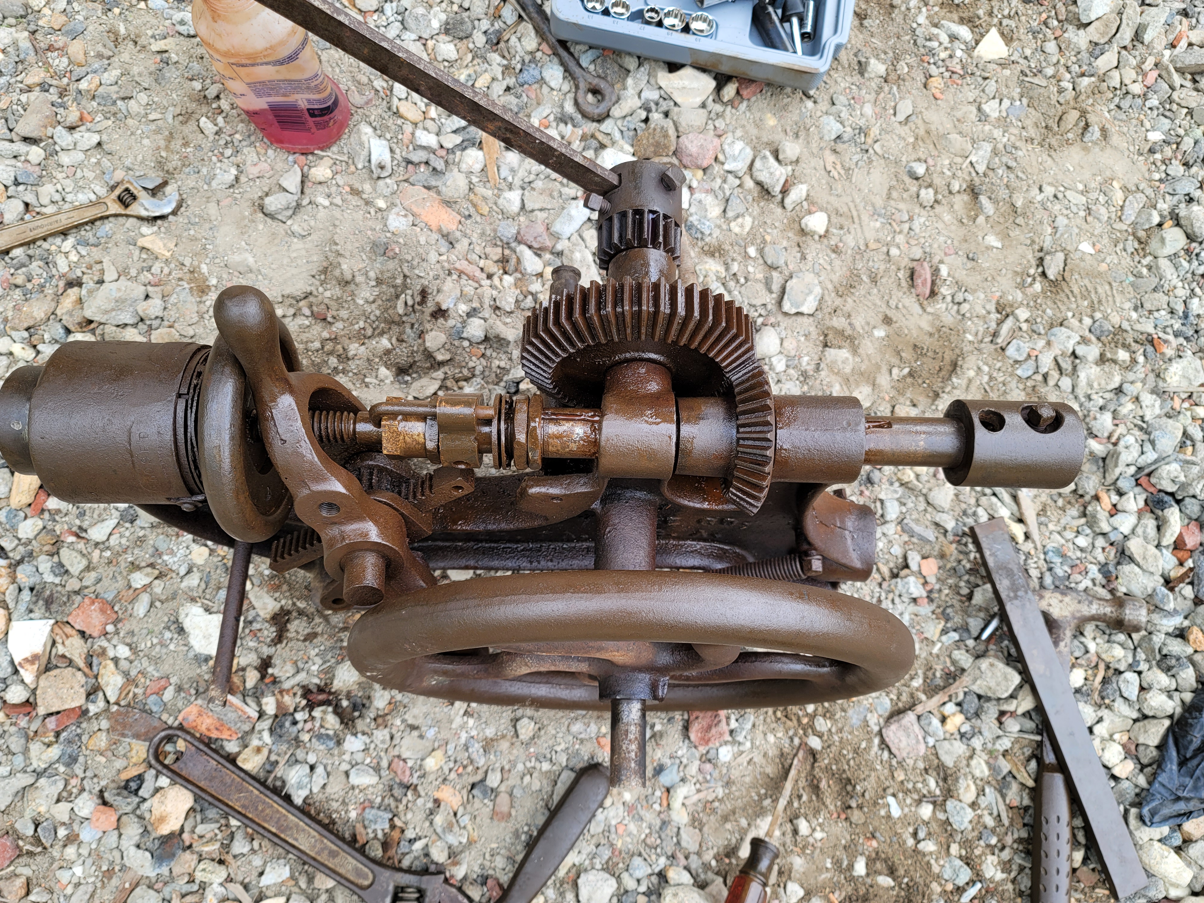

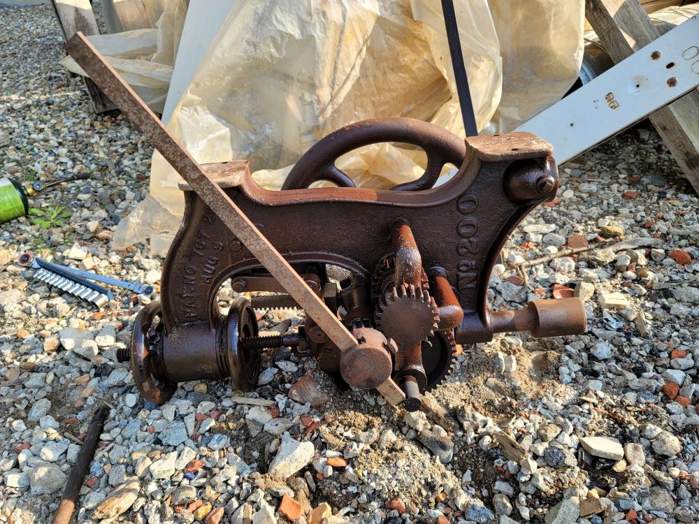

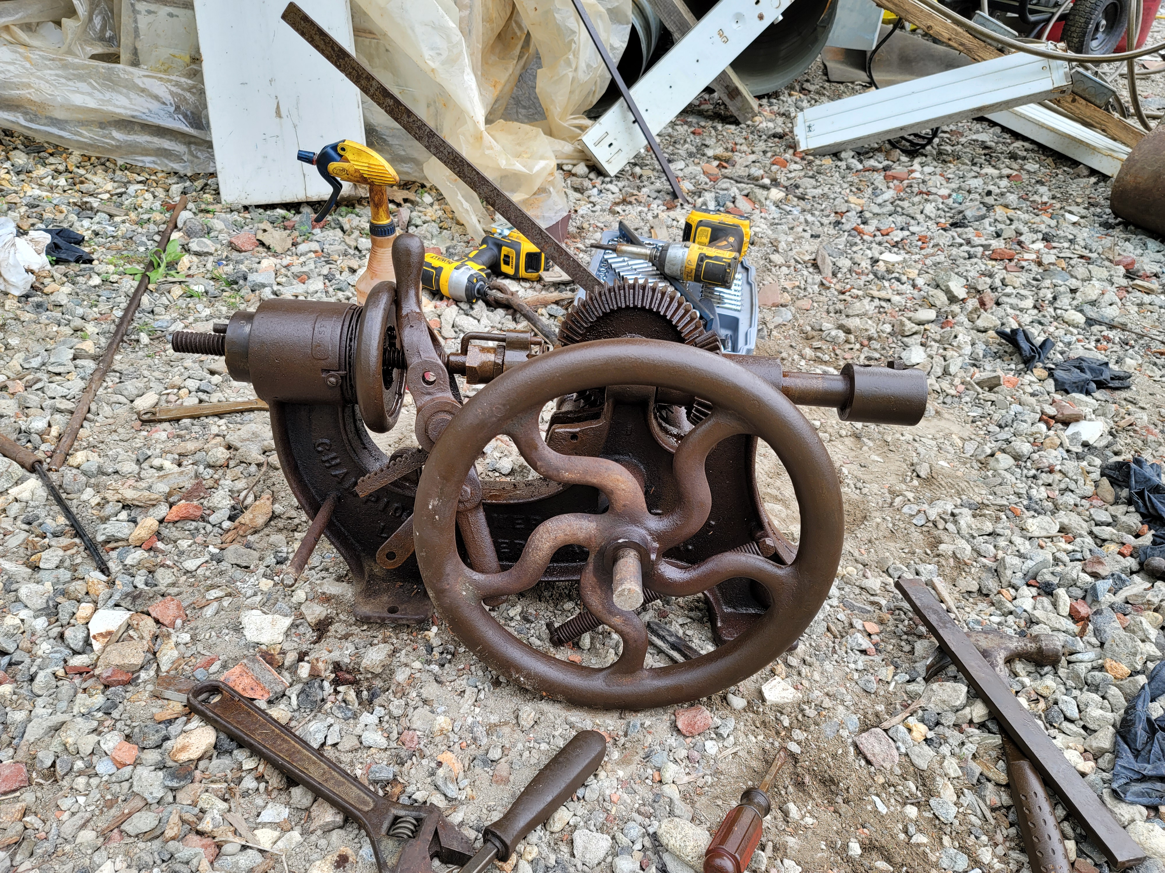

Yesterday I was able to get the hand crank gear freed up and off..  This gear is used for the 2 speed function with high speed and low speed..
I put it on the low speed/high torque spur and after heating up the shaft boss a little bit and a liberal amount of Silly Kroil it freed up the flywheel shaft enough to get just a little bit of movement..
Last night when I finished up I sprayed everything for the 1000th time and came back again to it today..
Because it has the auto feed function (which I don't know what is inside) I have been taking it extremely slow.. Having worked on 100's of old cast iron items the worst thing that can be done is not to take ones time..  Cast is a go/no go kinda thing..  It's crazy just how fast something will crack ands fall off..
So, after a few more hours with heat and kroil I was able to get the main shaft turning but no screw movement..
I was able to get a percentage of the chuck (the auto feed clutch) loosened  but was time to call it quits..  It's been very hot here last few days and I have not adjusted to the hotter more humid temps..  Takes a few weeks..
So the only things that really need loosening now are the clutch setup and the high speed shaft, and the hand lever feed gear..

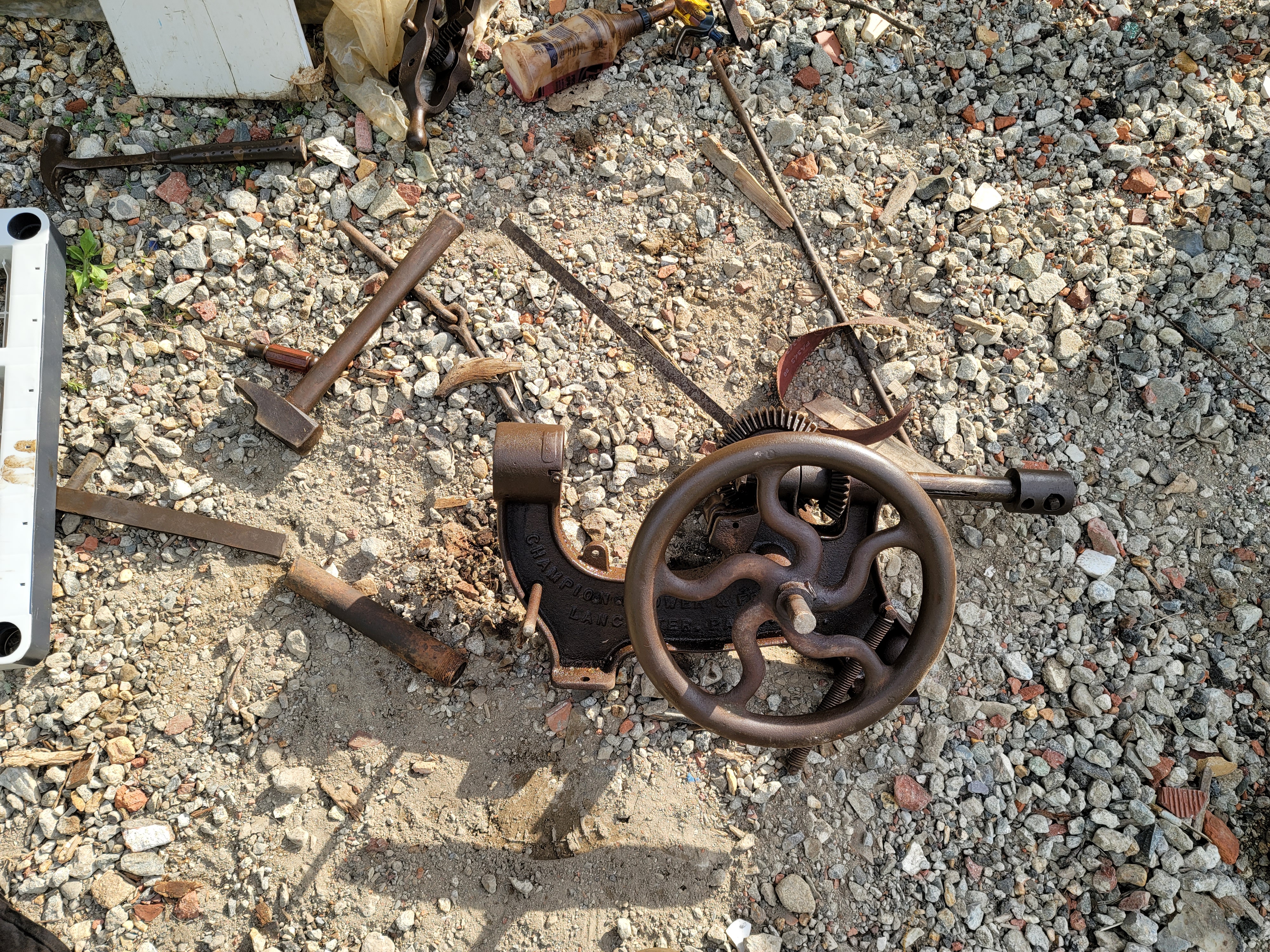

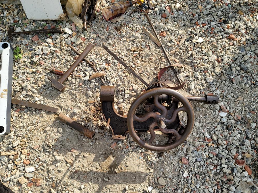

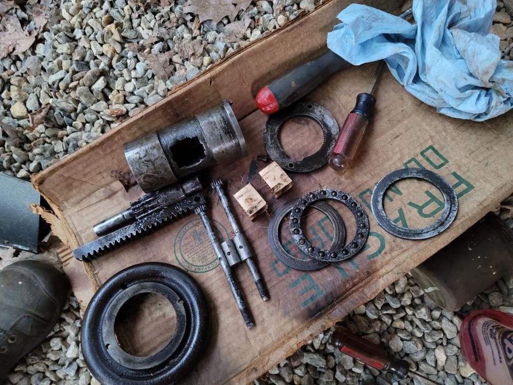

So today I was able to get 90% of it apart..
The flywheel and shaft are stuck as is the direct connected hand crank gear shaft..  These are the only 2 items still stuck..
What a neat design the auto feed is..
I will know on the next one what to be careful off and what to look for.
The thread engagement has got to be in full engagement to remove the unit.  If not the bronze thread chucks will get caught on the housing.
Also there are 2 very small screws that are used to activate the internal cams to engage and disengage the jaws..
Sadly if the jaws are stuck in the outer most position the bronze will be destroyed upon disassembly..
These are a soft bronze..  The gear head and gear bolts activate the cams which move the jaws in and out..
Really neat..
The metal used in the main unit is very soft as well. So be careful and use plenty of protective gear..
The pinion gear is pretty rusted out.. I'll have to get a new one made and a handle for the manual feed too.

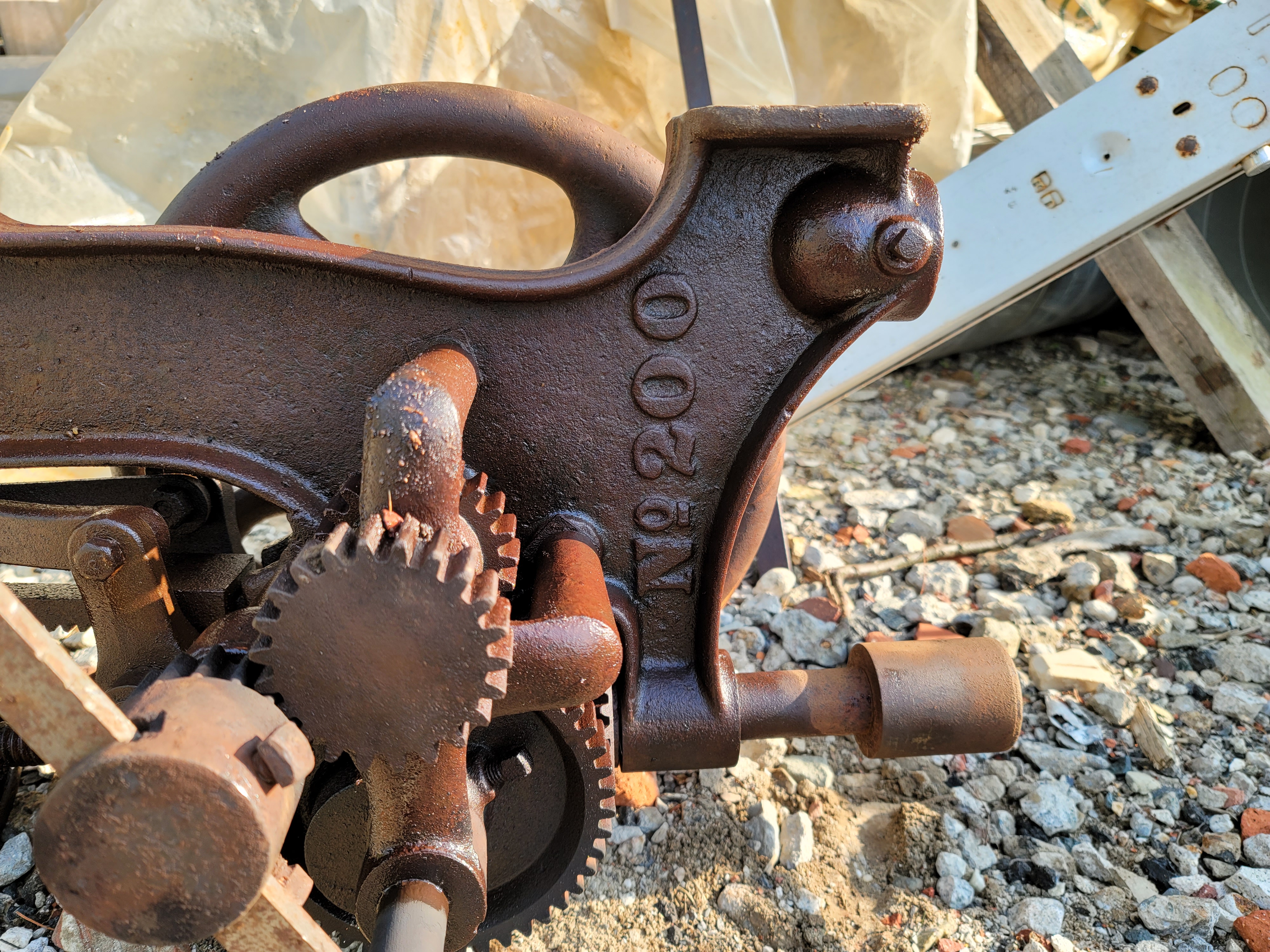

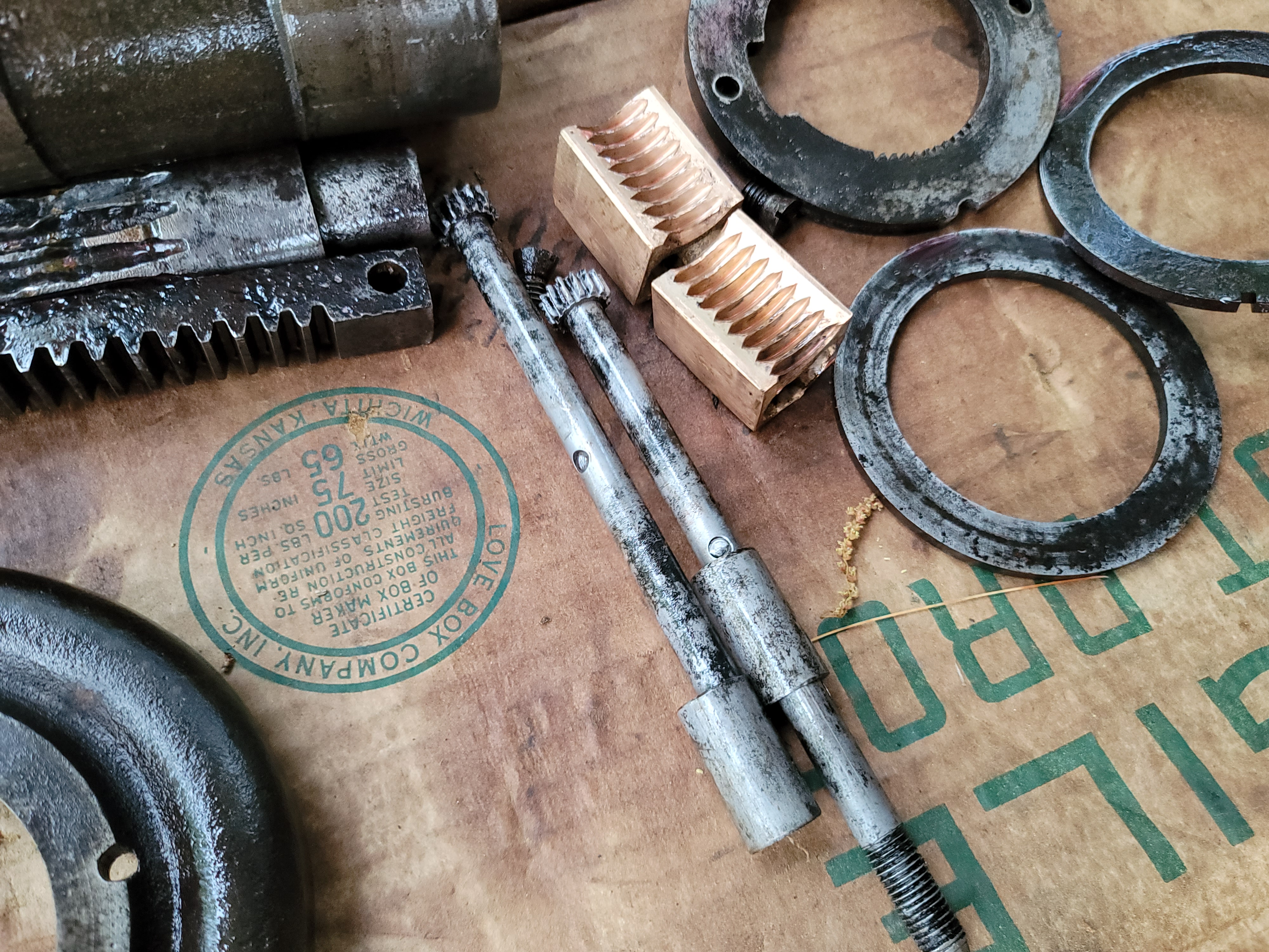

So in these photos these are ultrasonic cleaned and you can see the cam bolts and screws.. These are the main operating aspect of the gizmo..  The problem is there is not a lot of leverage to turn the cams and when the bronze blocks get stuck (rusted, damaged, etc) there is no way to move them into the inner position..
I can't stress enough how soft both the cast iron is and the bronze parts..
So, make sure the thread is fully engaged before removal.. Sacrificing the set screws in the cams might be the only option..  They are just bolts with gears on the ends so they can be driven all the way though the cast iron holder..  The little screws will shear..
