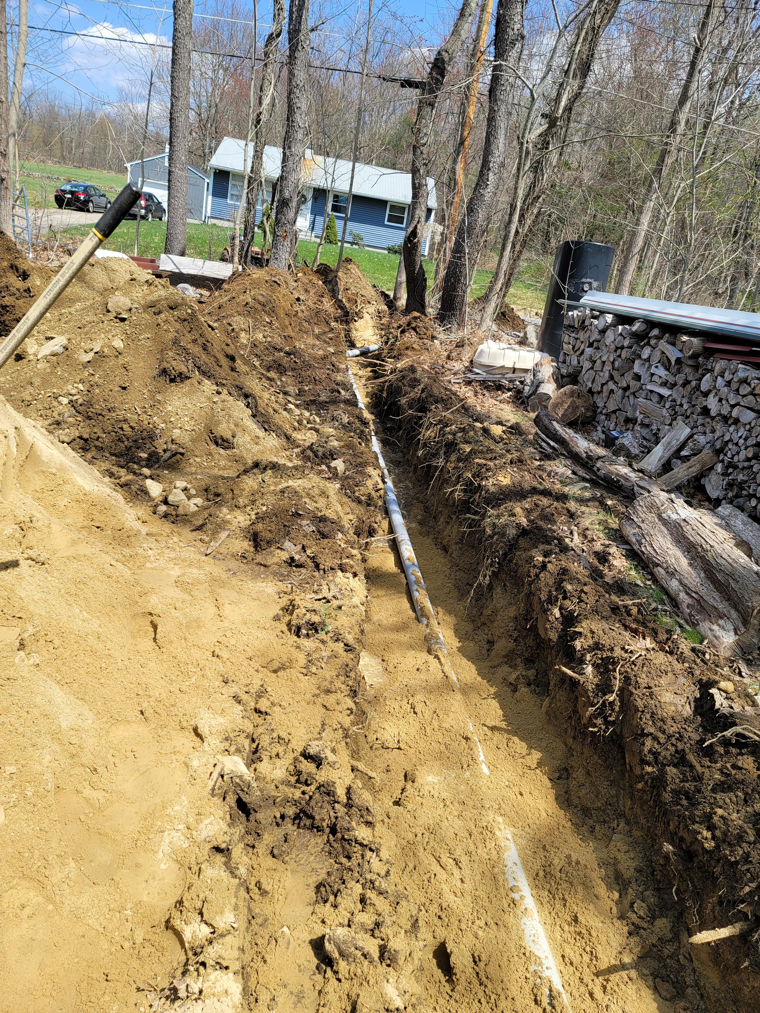

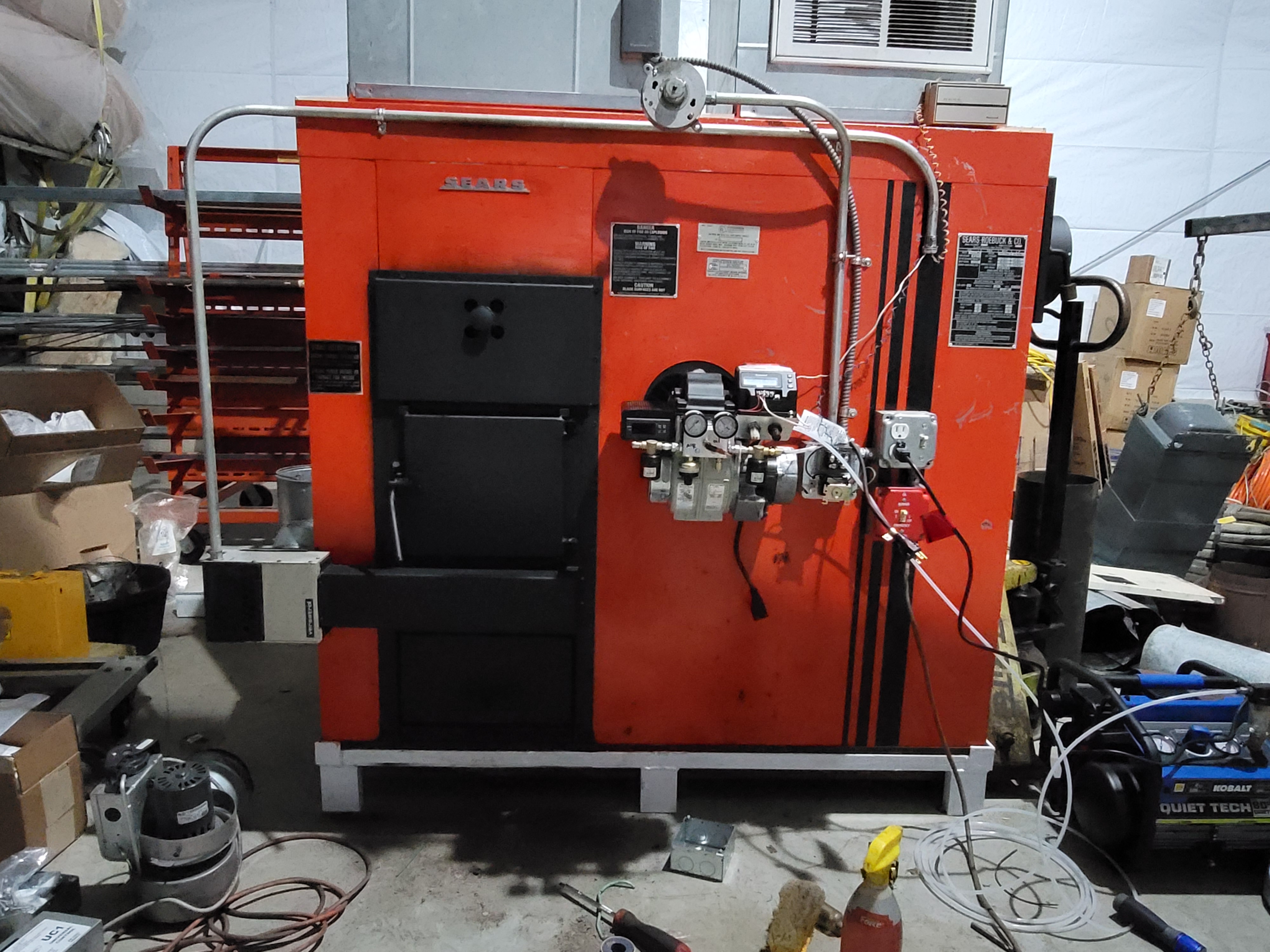

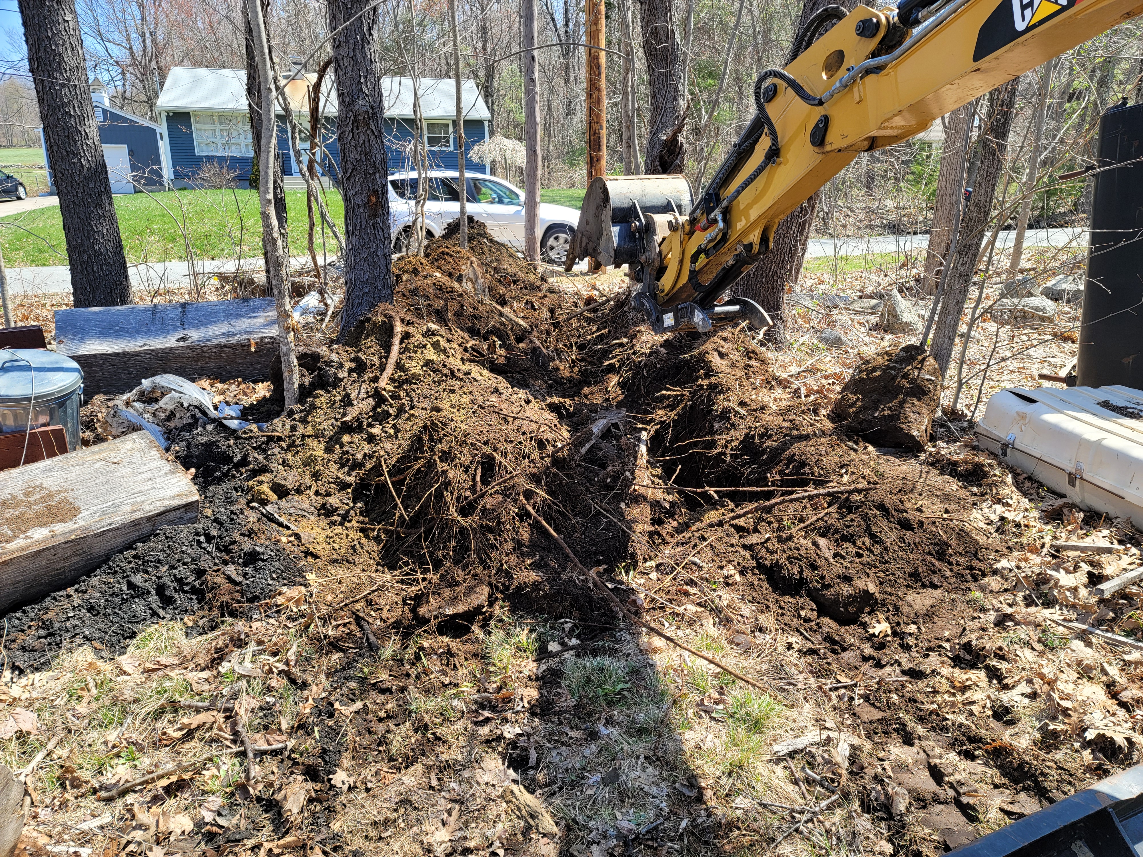

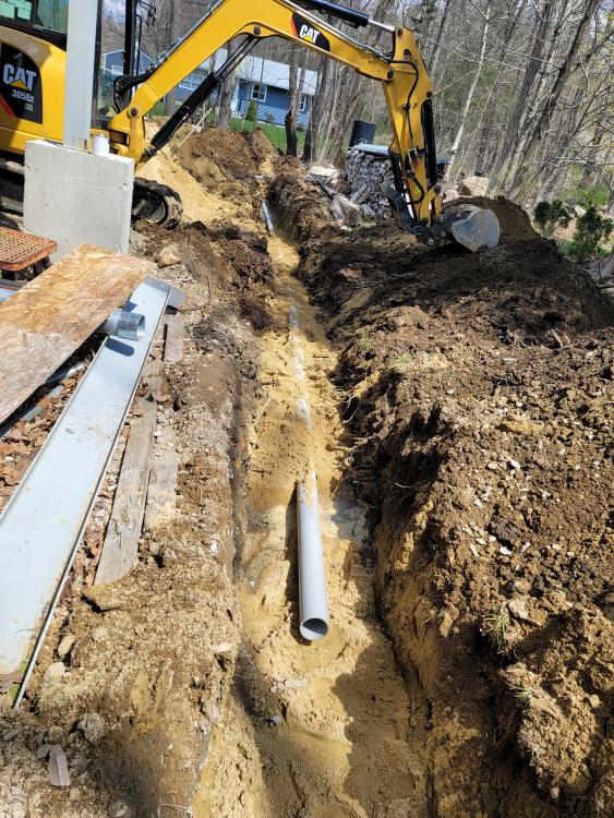

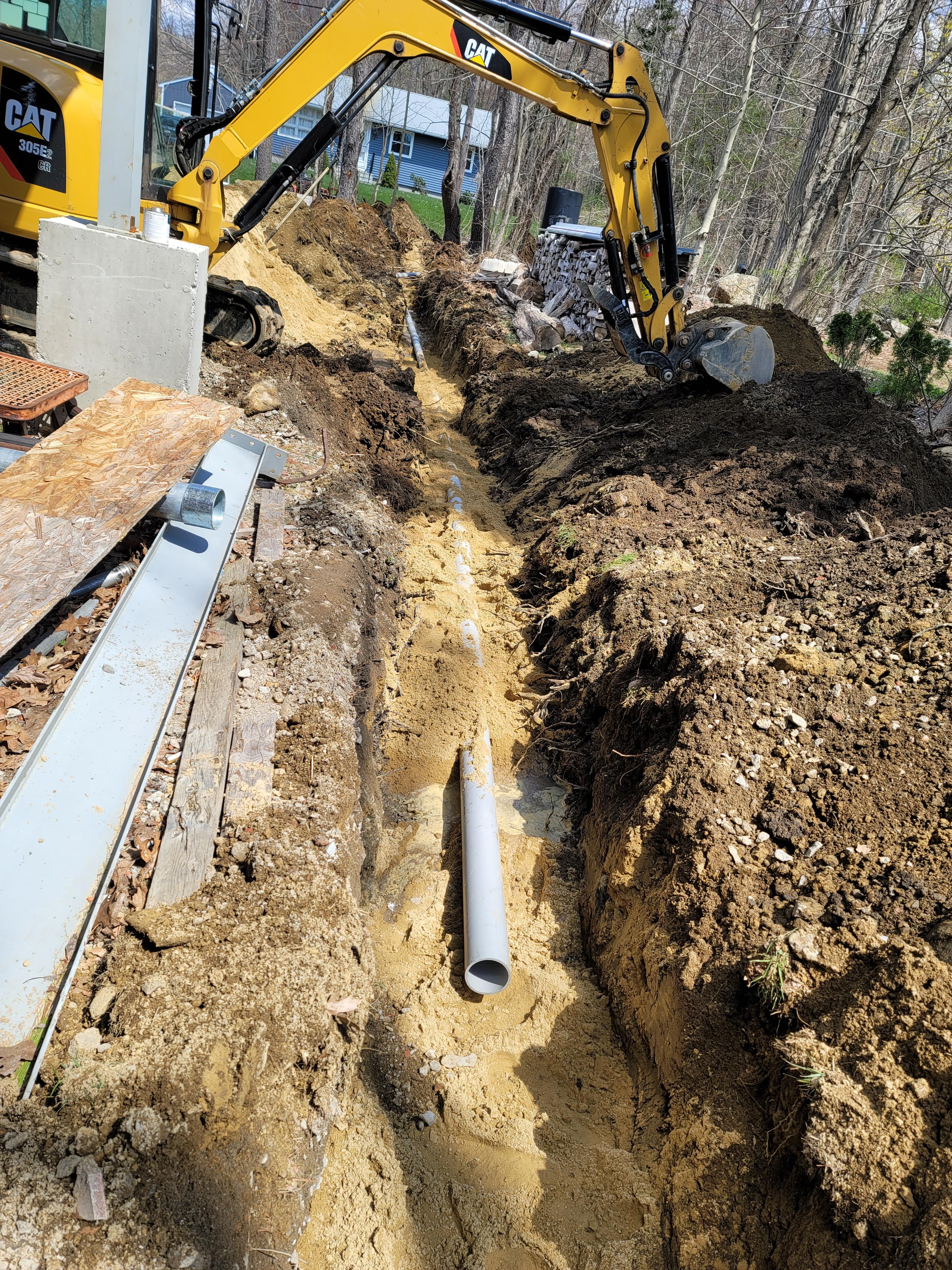

jlpservicesinc Posted April 25, 2021 Author Share Posted April 25, 2021 Arkie, if you ask me, one can never have to much heat.. With this I ended up buying a combo Wood/coal oil unit and then bought a used oil burner to go in it. It is a Sears branded 1979 with Orange and Black racing stripes.. I love the color scheme.. Funny really since it is getting warm enough not to need heat. Today was a banner day.. Got the trench for the conduit dug, the sand placed on the bottom, condiut installed, work inspected and signed off on, and trench filled back up. Crazy day.. I ended up having to put a jog in because they moved the pole further up the street.. I measured to the pole and still have enough wire to make the full run with a little extra.. Well, at least I hope so.. Quote Link to comment Share on other sites More sharing options...

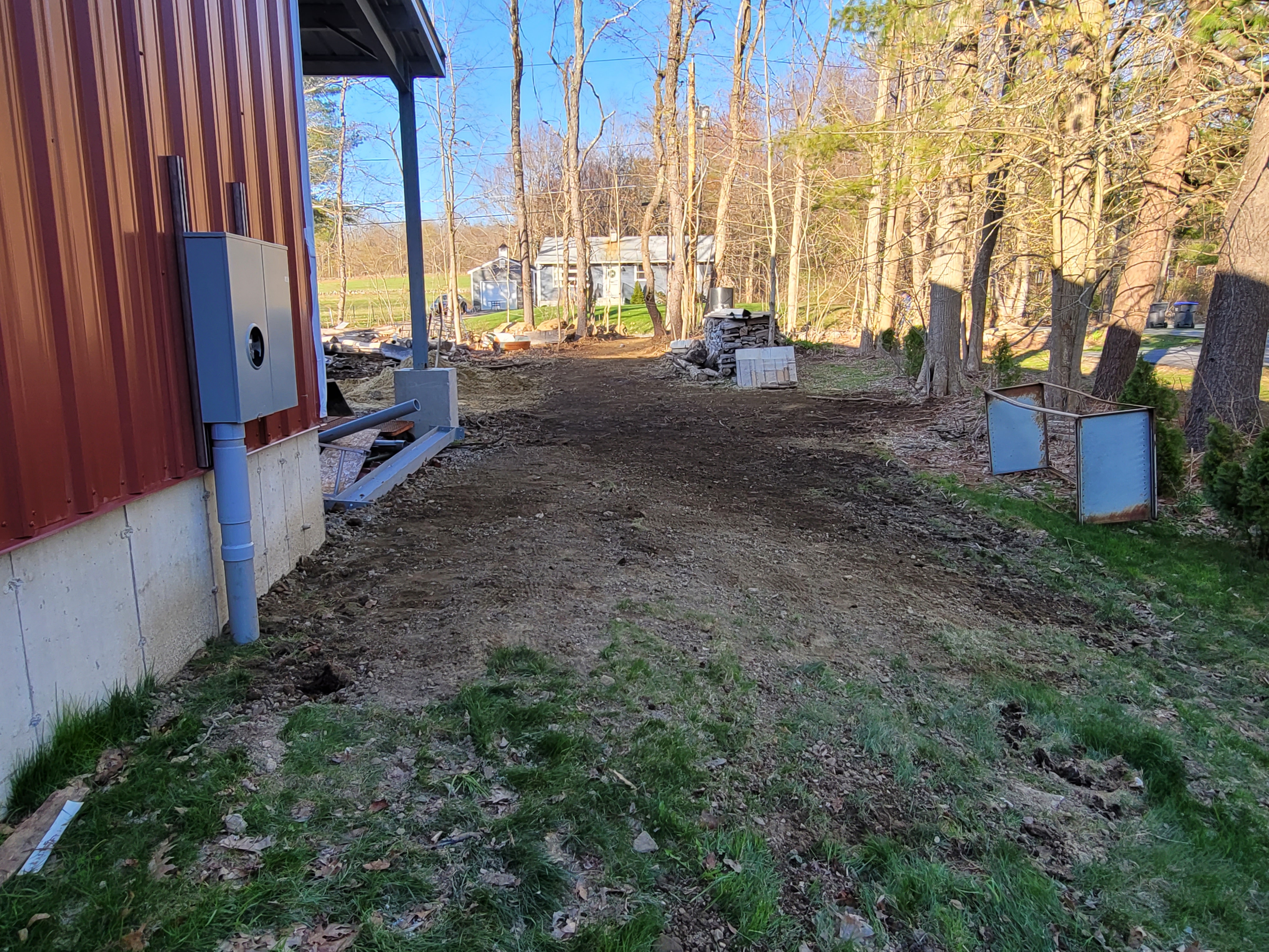

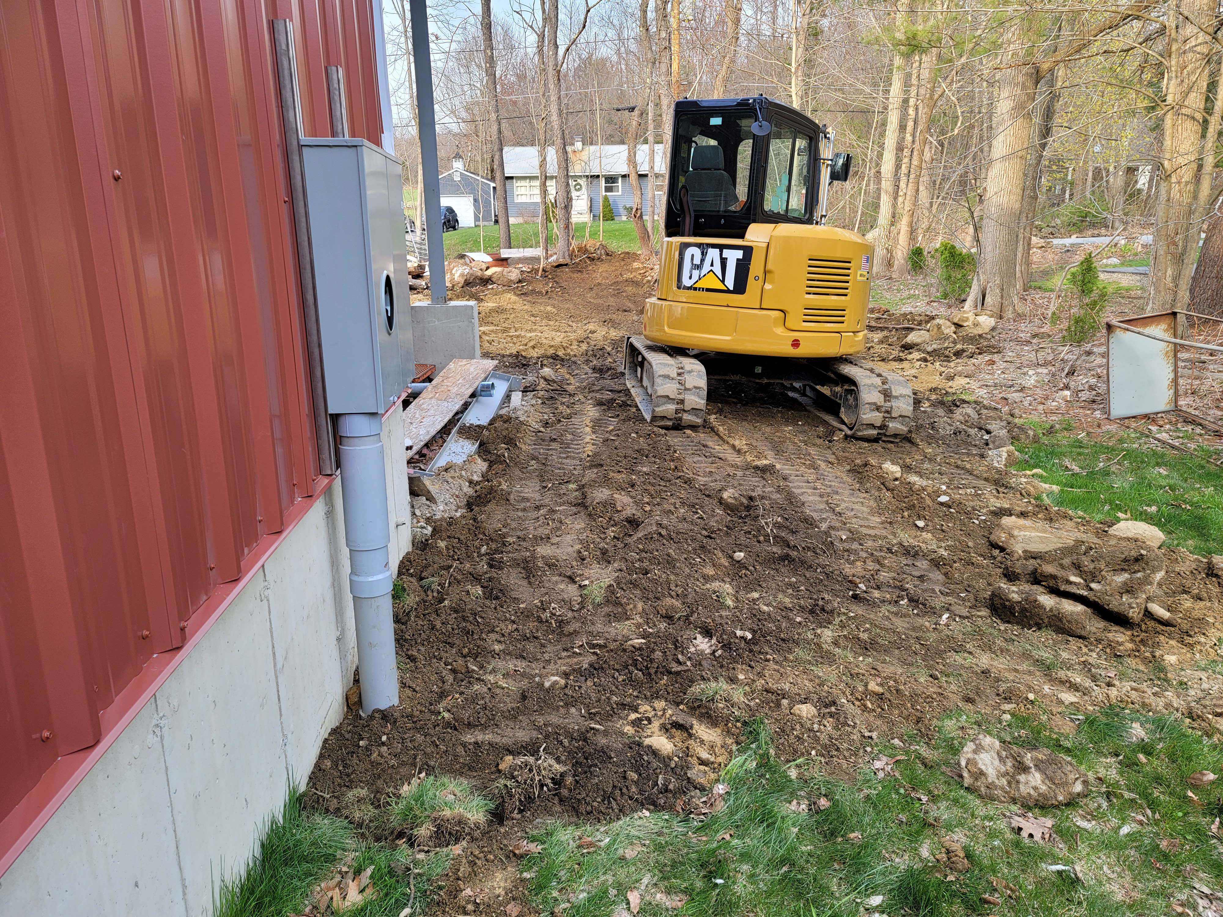

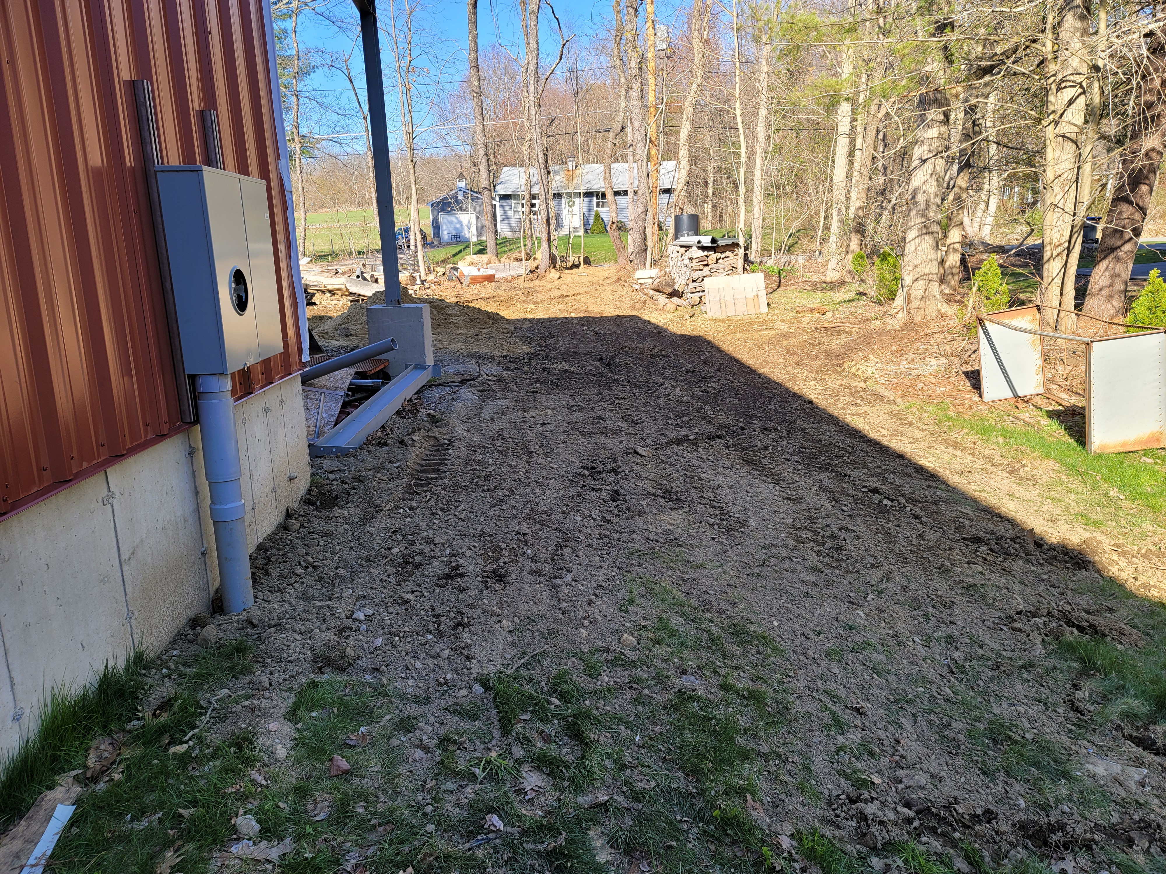

jlpservicesinc Posted April 27, 2021 Author Share Posted April 27, 2021 Today I finished smoothing out the area and picked up all the rocks.. Gave the whole area 3 engineers rake passes, then 3 passes with the leaf rake.. Smoothed out pretty nicely though some of the tractor prints did not what to fill in.. With the high clay content in the soild and high water table the soil remains compacted and has to be chopped up to pull it apart.. Before and after.. At the end of the run I will install a wrought iron gate at the road.. Not sure of the design yet, but will be a nice show piece to put there.. I do like the small classical gates on the house gardens in England.. So, maybe something along those lines.. Quote Link to comment Share on other sites More sharing options...

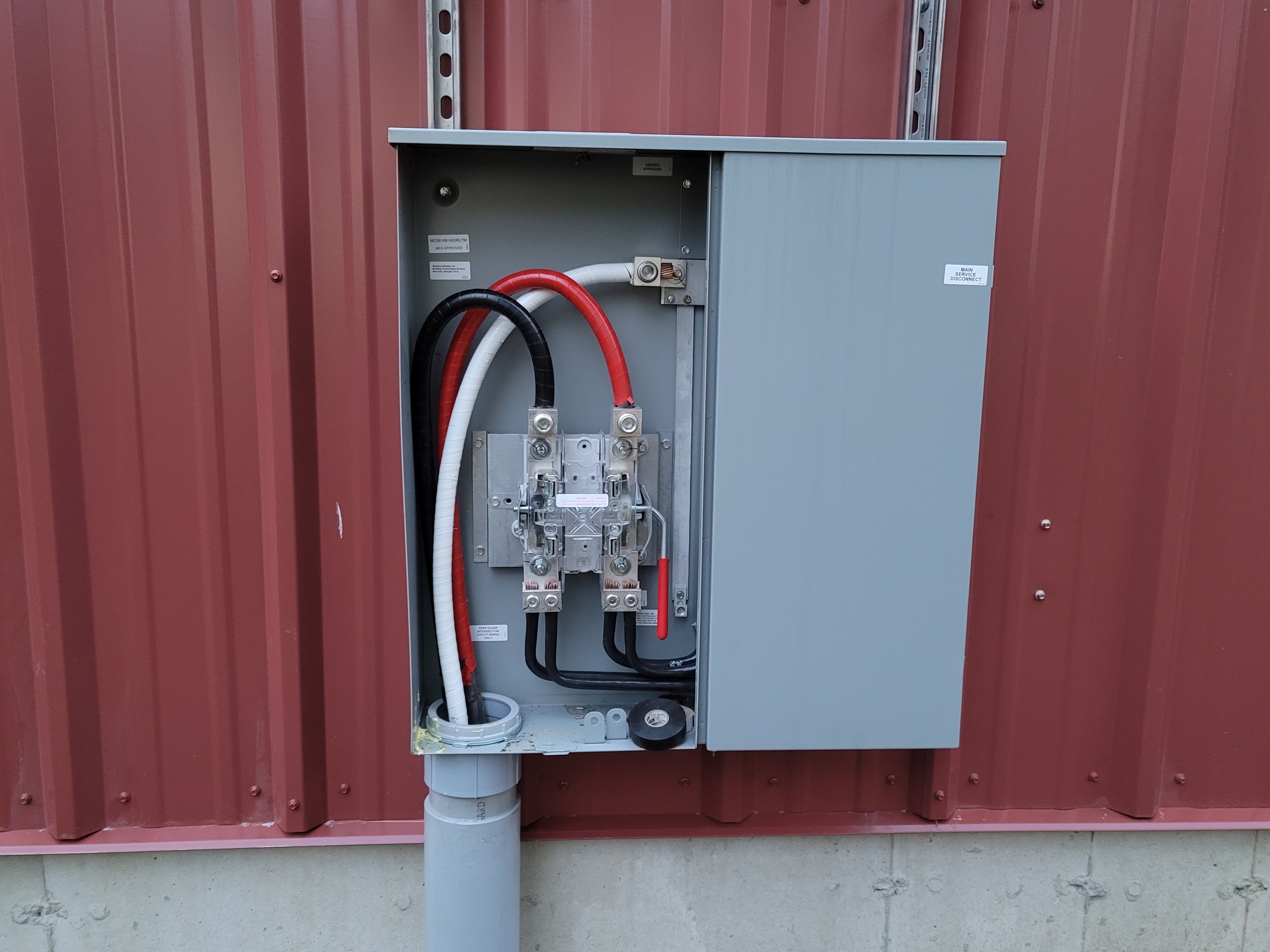

jlpservicesinc Posted April 28, 2021 Author Share Posted April 28, 2021 Thanks Steve, You were/are a big help.. Great talking electrical with you.. Next is to run the cable.. Love to be able to pull it myself but I was told it really is a 2 person job.. One feeding and 1 pulling.. Love to make a nice trumpet/bell mouth to put on top of the RMC sweep.. I'm running it in from the pole side.. The RMC 10Ft straight section will be left down so the wire can be pulled close to the ground till it gets to the Metersocket panel.. Then the 3 wires will be fed into the last 10ft RMC section and lifted into place.. I have the manlift which can lift 500lbs but with me in the basket it drops the capacity down.. Thanks Evfreek.. LOL.. Makes me want one too. It's been a very a very expensive long journey.. I'm lucky I can and have done most the work myself. Quote Link to comment Share on other sites More sharing options...
arkie Posted April 28, 2021 Share Posted April 28, 2021 Looking great, Jennifer! Spread a layer of crushed stone/gravel over the areas and the tractor marks will disappear. Quote Link to comment Share on other sites More sharing options...
jlpservicesinc Posted April 28, 2021 Author Share Posted April 28, 2021 thanks.. will the grass still come up thru the crushed stone/gravel?? That might be exactly what I have been doing wrong all these years.. Gave it one more raking yesterday and pulled out a bunch more stones.. I'm pretty happy with how it is now and the quicksand that started to gush up thru the soil stopped and got firmer over night.. With the high water content at 36" deep the water was flowing into the trench pretty well.. We got plenty of rain last night so everything is watered.. Quote Link to comment Share on other sites More sharing options...
Frazer Posted April 28, 2021 Share Posted April 28, 2021 Looking great Jennifer. It's incredible far you've come since... Quote Link to comment Share on other sites More sharing options...
arkie Posted April 28, 2021 Share Posted April 28, 2021 Jen, if you are planning on planting grass, then I would forego the gravel. It would not grow well in gravel. I spread 1" gravel all around my shop and there is no maintenance. Better to walk on than wet grass with wet clay or soil underneath. Occasionally I will spot spray environmentally friendly weed/grass killer to keep any strays at bay. Quote Link to comment Share on other sites More sharing options...
ThomasPowers Posted April 28, 2021 Share Posted April 28, 2021 In my experience: if you want grass in a graveled area it won't grow and if you don't want grass, it will flourish! I have old pieces of corrugated roofing tin around the edges of my shop and under the scrap pile for weed control---then I only need to deal with the weeds growing through the nail holes! Quote Link to comment Share on other sites More sharing options...
SinDoc Posted April 28, 2021 Share Posted April 28, 2021 Based on that meter, I assume you installed a 400A meter? Single or three phase? Hopefully your area allowed you to run aluminum wire to save some money. I just spent a bit reading the whole thread and found the electric part and it caught my attention . I am a lighting guy, so if you need any ideas for shop lights and such I would be more than happy to help! Quote Link to comment Share on other sites More sharing options...
jlpservicesinc Posted May 1, 2021 Author Share Posted May 1, 2021 SinDoc, 400amps copper per National grid regs. Though I had a new to me electrician tell me he uses aluminum all the time for service entrance. I went with 240watt high bay led ufos. Plugged one in while looking at it. Stupid.. no duh.. On that note got the electrical permit yesterday and pulled cables to the pole today.. Quote Link to comment Share on other sites More sharing options...
SinDoc Posted May 1, 2021 Share Posted May 1, 2021 Yeah it varies from place to place if they allow aluminum or not. Copper prices have been going through the roof! 240W seems pretty intense. I supply Lithonia IBG highbays a lot, though i dont remember their wattage off the top of my head. Quote Link to comment Share on other sites More sharing options...
Irondragon Forge ClayWorks Posted May 1, 2021 Share Posted May 1, 2021 The problem with aluminum wiring is the connectors have a tendency to corrode over time. I pulled aluminum wire from the pole to the house 200 amp service panel, about 100 feet in underground conduit. Used anti oxidizing compound on the connections but after 20 years the connections had to be cleaned and more compound applied. If I had of known then what I know now, I would have been happy to spend the extra for copper. Quote Link to comment Share on other sites More sharing options...

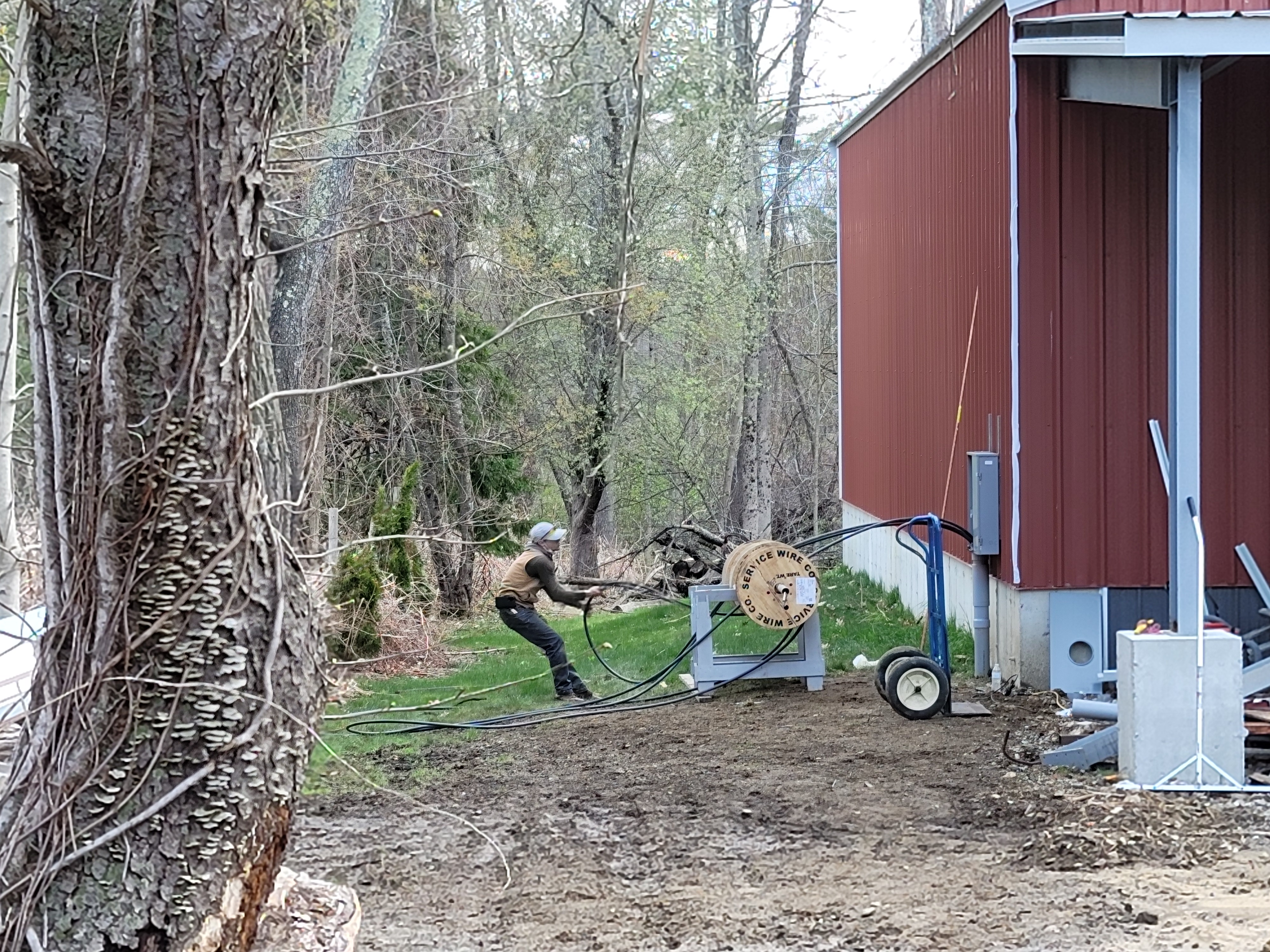

Steve Sells Posted May 1, 2021 Share Posted May 1, 2021 How did our wire length estimate turn out ? Was 2 people enough to pull it? I want details Quote Link to comment Share on other sites More sharing options...

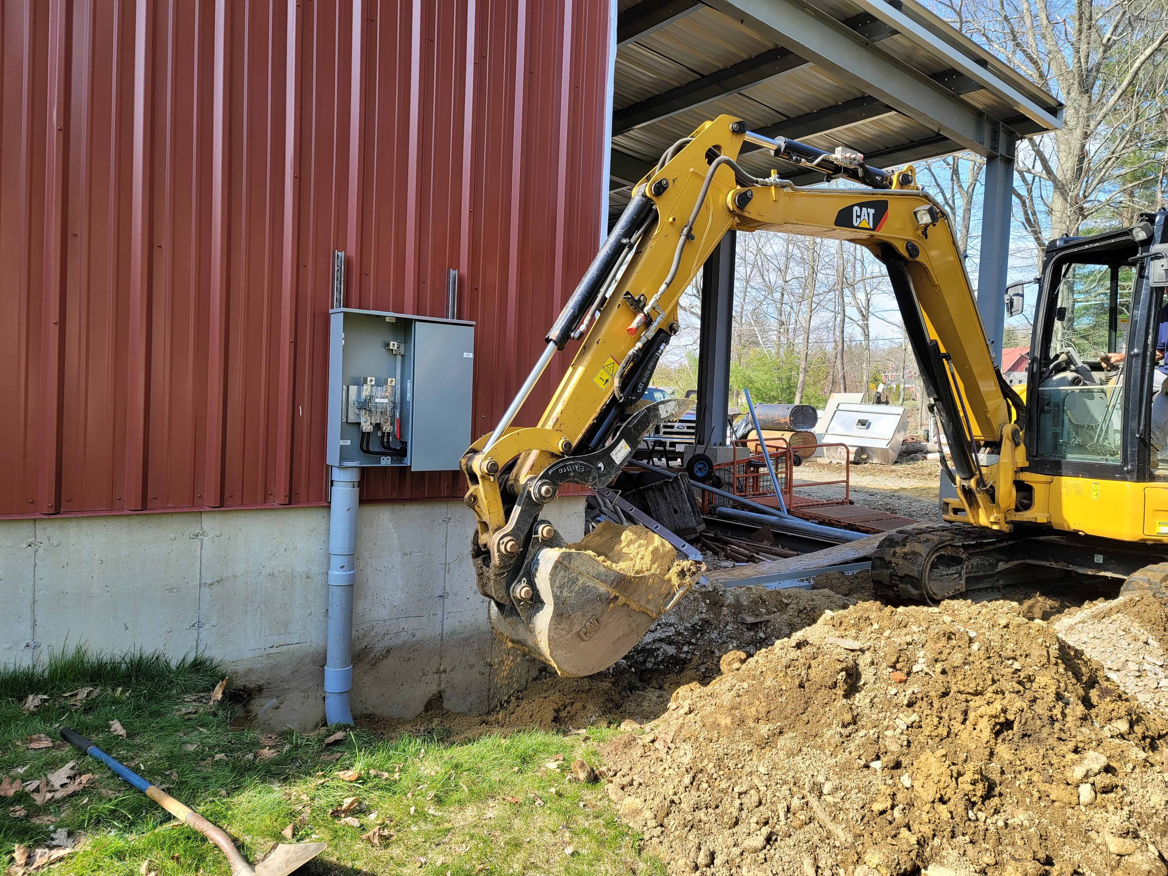

jlpservicesinc Posted May 2, 2021 Author Share Posted May 2, 2021 Steve, I had planned on pulling the cable with my buddy Jodi, but Chris was driving by and I flagged down after Jodi got busy somewhere else.. Once we established a time we had to reschedule.. Chris and I were pretty much on the same page progression wise and he let me flounder with the hand winch.. I then said ok we will use the excavator.. What I did was pull a coupling off of the RMC and thread in a Male PVC adapter.. This made it so the cable and mule tape would not get cut on the Rmc sweep at the pole.. Chris suggested running them from the panel to the pole and I followed along.. His method of getting the mule tape to the box was totally new to me.. He showed me a trick using a plastic bag and masons line and vaccum.. Worked like a charm.. Once the masons line was at the box I pulled the mule tape back to the pole while he rigged the 3 lines.. We pulled the spools over and put them on a pipe which was on saw horses.. Total weight was nearly 700lbs so we moved each spool separately.. He laid up the cable by coloring the ends with tape, then giving them a wrap with the mule tape. He staggered the ends some then using duct tape, he half hitched about 2ft worth about every 6 inches and then wrapped it all up with duct tape.. I had the pulling lube so he put some on in the beginning of the pull and then about 1/2 way thru.. Once I decided the hand winch method was going to take to long and moved the excavator over, I did 3 wraps around the thumb and held that while I worked the bucket up.. then would give it a flick to loosen it and pull the slack out when lowering the bucket back down.. Once the cable emerged with slip tied them and finished the pull with sliding the slip down and pulling again.. Once the extra was pulled up, slid the 4" RMC over the wires and then lifted the RMC up and ratchet strapped the rmc to the pole and the wires up higher.. All told it was about 2.5hrs to pull the 3 cables of 500mcm Xhhw -2. I don't have a pipe wrench large enough for the 4" so trying to figure out the next move.. Quote Link to comment Share on other sites More sharing options...
Glenn Posted May 2, 2021 Share Posted May 2, 2021 Use a chain wrench or a strap wrench. They are easy to make. Quote Link to comment Share on other sites More sharing options...
jlpservicesinc Posted May 2, 2021 Author Share Posted May 2, 2021 Glenn, I used a ratchet strap to tighten the pvc to the rmc at the sweep.. Ever since the shop build my wrists have been sore so need to figure out something that will make it easier.. I have a chain wrench that I converted to shear handle and just have to find the jaws.. Quote Link to comment Share on other sites More sharing options...
