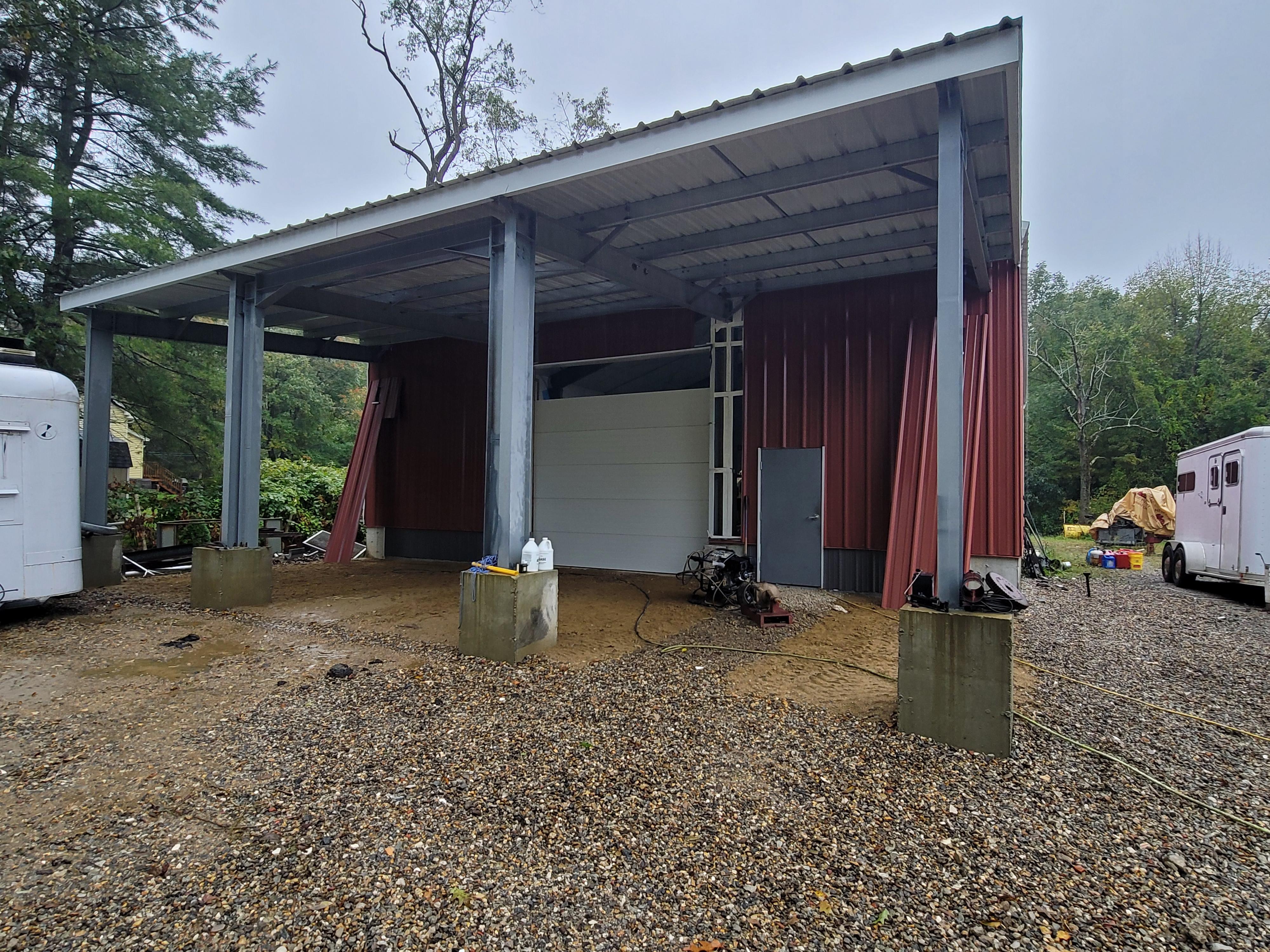

M.J.Lampert Posted October 6, 2021 Share Posted October 6, 2021 looking good Jennifer Quote Link to comment Share on other sites More sharing options...
Rojo Pedro Posted October 6, 2021 Share Posted October 6, 2021 Yes looking real good. Quote Link to comment Share on other sites More sharing options...
jlpservicesinc Posted October 7, 2021 Author Share Posted October 7, 2021 What happened to that perfectly good wall.. Huge hole in it now.. Argh.. Thanks guys.. this might be the year.. Quote Link to comment Share on other sites More sharing options...
Rojo Pedro Posted October 8, 2021 Share Posted October 8, 2021 I can see the culprit peeking out the door. Very transparent motive. The perps often hang at the scene of the crime Quote Link to comment Share on other sites More sharing options...
jlpservicesinc Posted October 8, 2021 Author Share Posted October 8, 2021 Rojo Pedro.. Should be neat if the vision happens the way I plan it.. I am looking for a new window as this 1 now has stuff in it and I broke it putting it up.. Was super tight. 9 years ago when I got the window it was like brand new.. I guess living outside though sheltered did no favors for it's longevity. I had left 1/2" for fit but once the trim went in I lost all the room.. No biggy.. Quote Link to comment Share on other sites More sharing options...

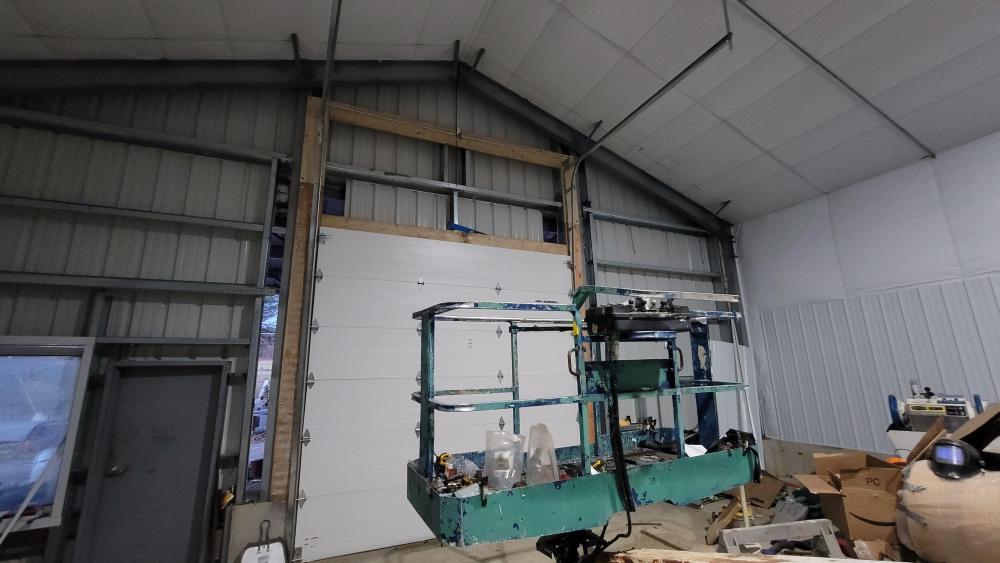

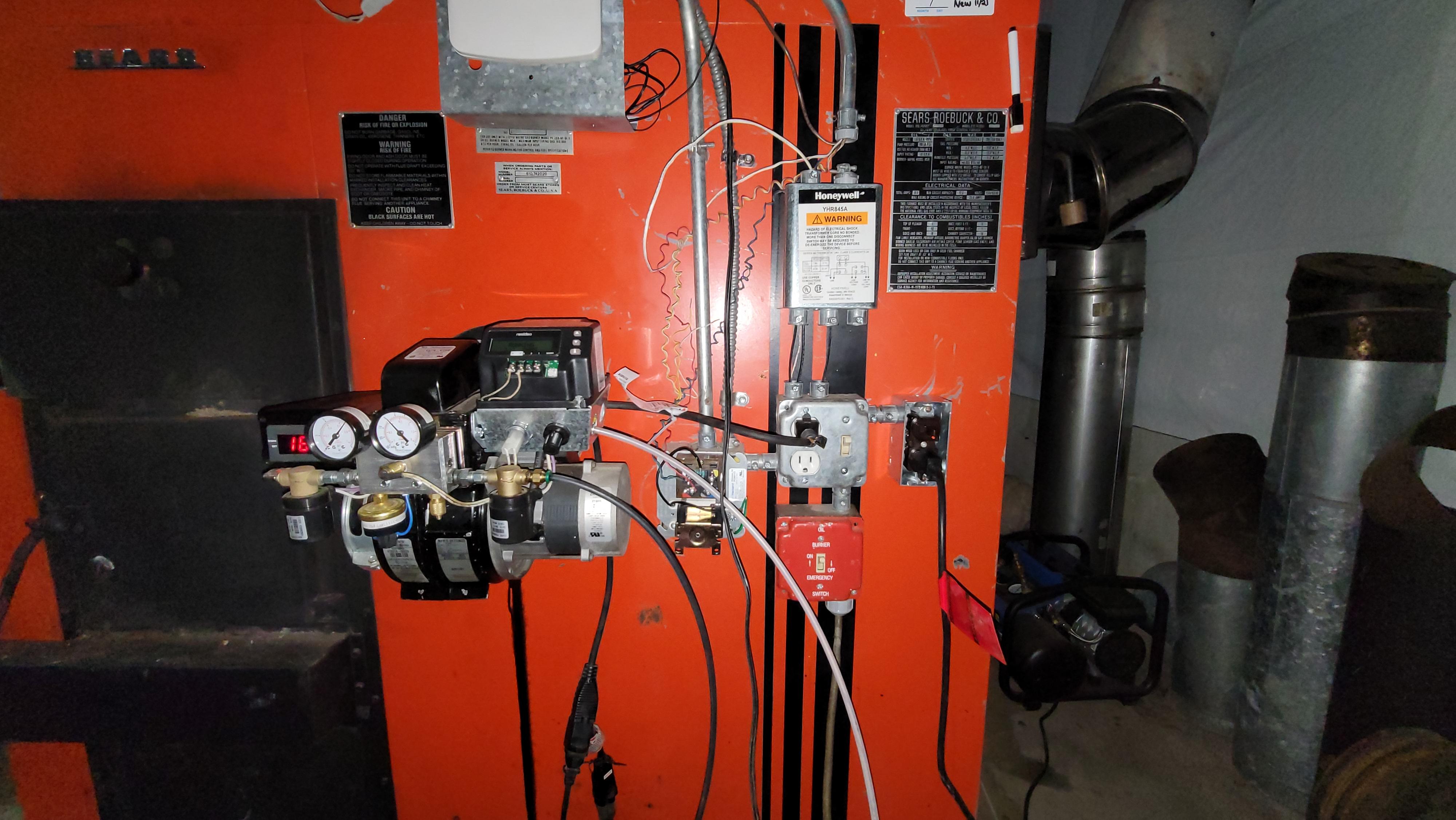

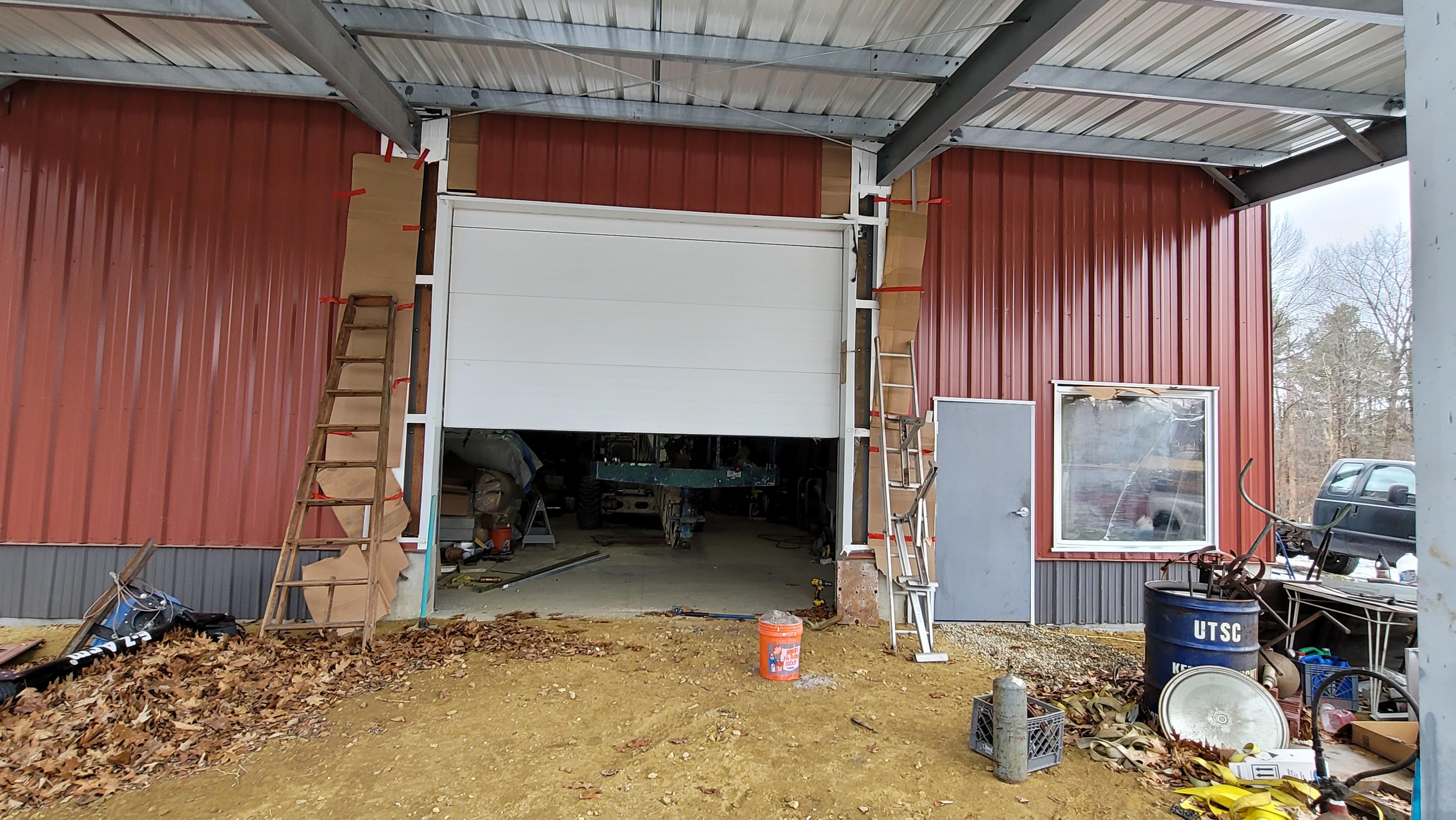

jlpservicesinc Posted November 21, 2021 Author Share Posted November 21, 2021 Over the past few weeks I have added more equipment in line with PPE.. A huge fume extractor with 27Ft arm. The used oil burner is installed in the Yukon eagle furnace and it burns about 1/2gallon per hour.. The garage door is slowly going up.. This like everything on this build the directions and instructions are terrible.. Lot more work than thought it would be.. Lots of screws and drilling holes. Arkie, was pretty amazing how the last door panel completely added another layer of warmth even with the sides around the door completely open. Got the back yard cleaned up from the remaining logs that were down. Apple, rock maple and some other wood that can not be split with axe or maul. Brought a few loads of wood as well. Thought I had about 6 cord stacked but turns out to only be about 5. Quote Link to comment Share on other sites More sharing options...

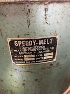

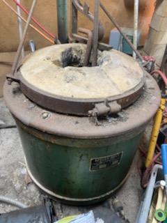

jlpservicesinc Posted November 21, 2021 Author Share Posted November 21, 2021 Today I put a down payment on a complete non ferrous foundry.. Quote Link to comment Share on other sites More sharing options...
jlpservicesinc Posted December 11, 2021 Author Share Posted December 11, 2021 Dick L. came out today and we got the door to go up and down.. Still a few little things but now it opens and closes. It's interesting how large the door is yet still goes up and down.. Now can get the manlift from inside the building to put up the outer sheets.. With heating the building for the last week or so there is going to "have" to be a large fan in the middle to push the hot air down.. At the roof it was about 85 with it 65 on the floor. Quote Link to comment Share on other sites More sharing options...

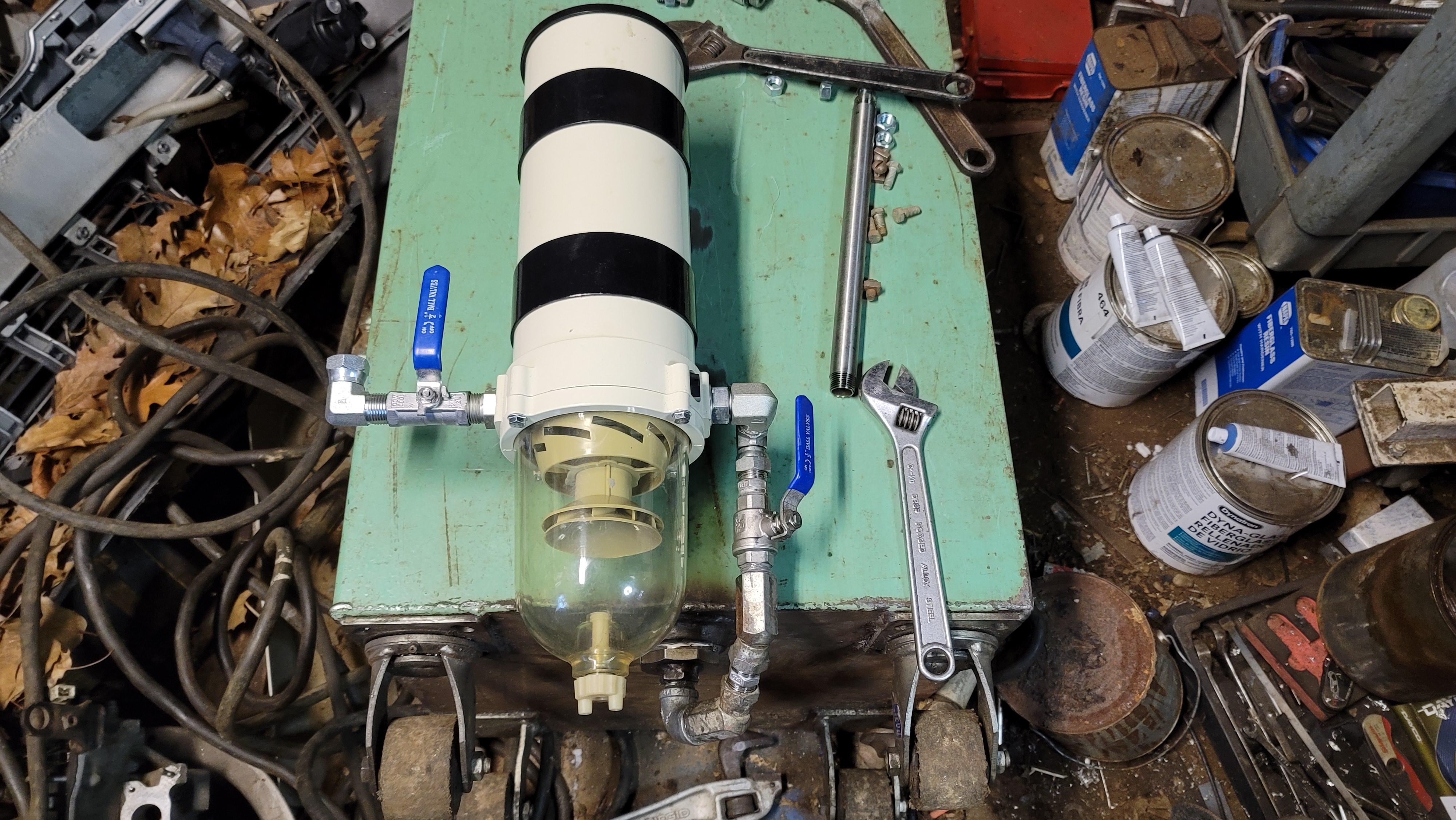

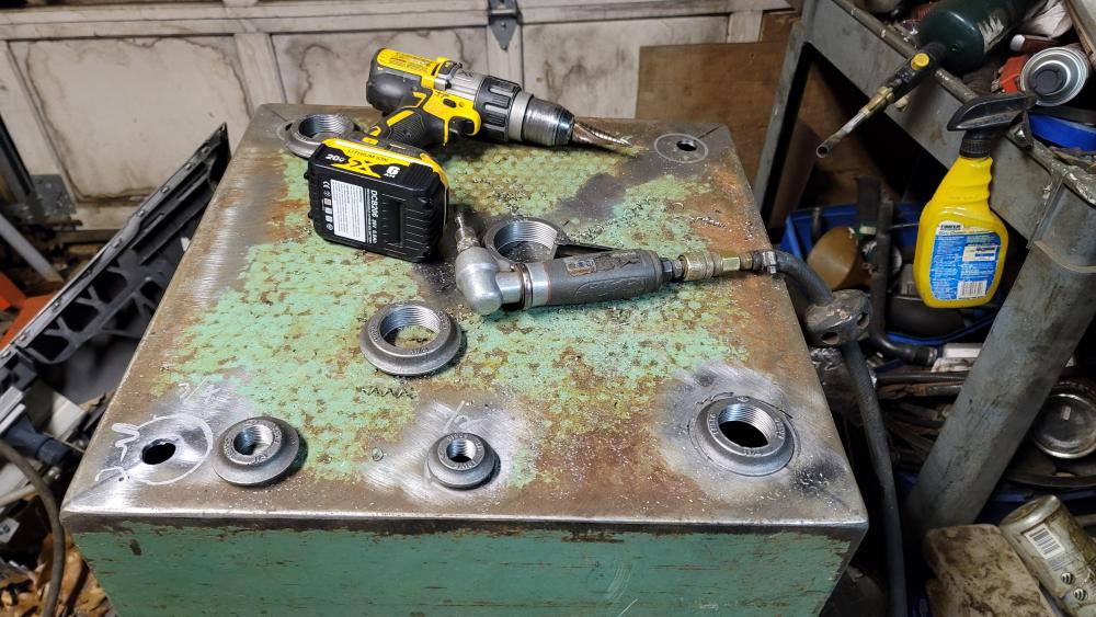

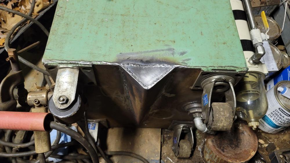

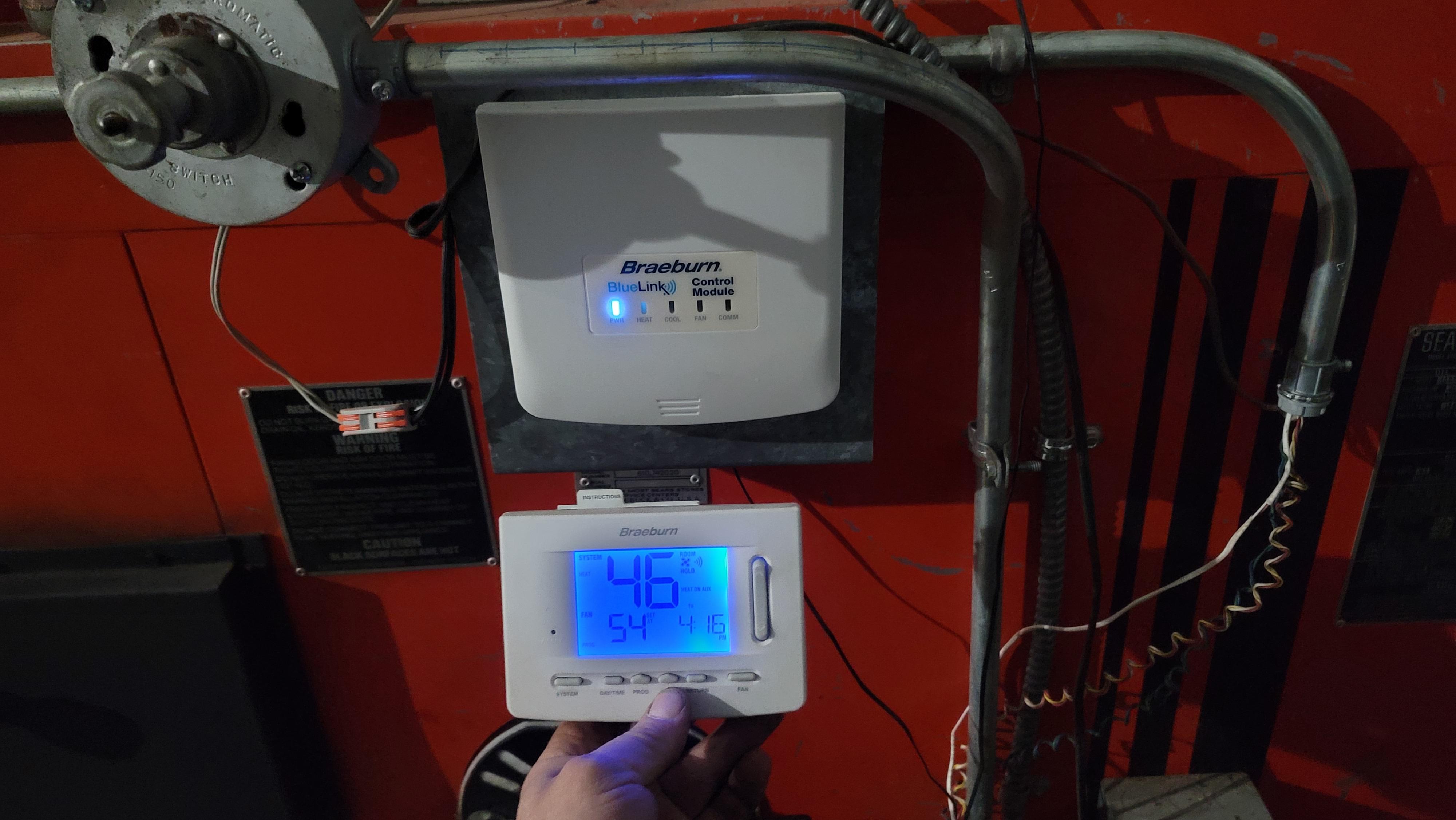

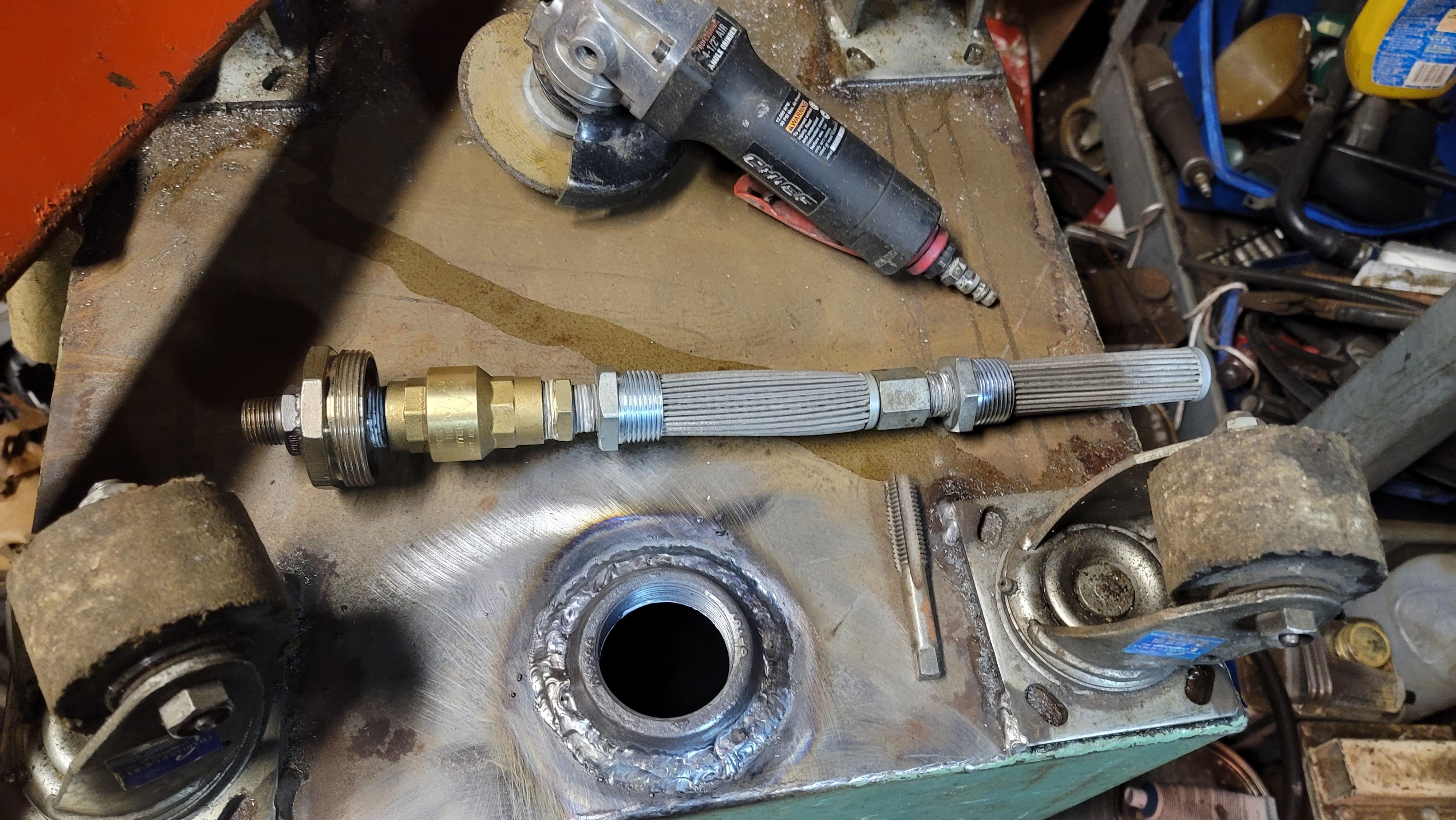

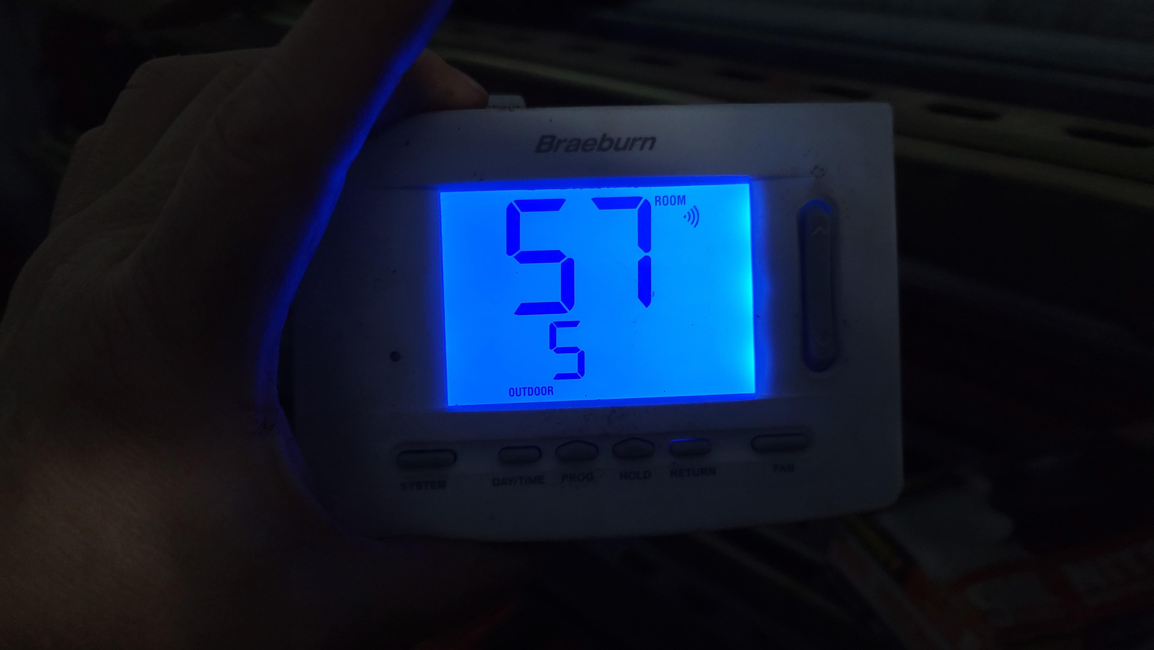

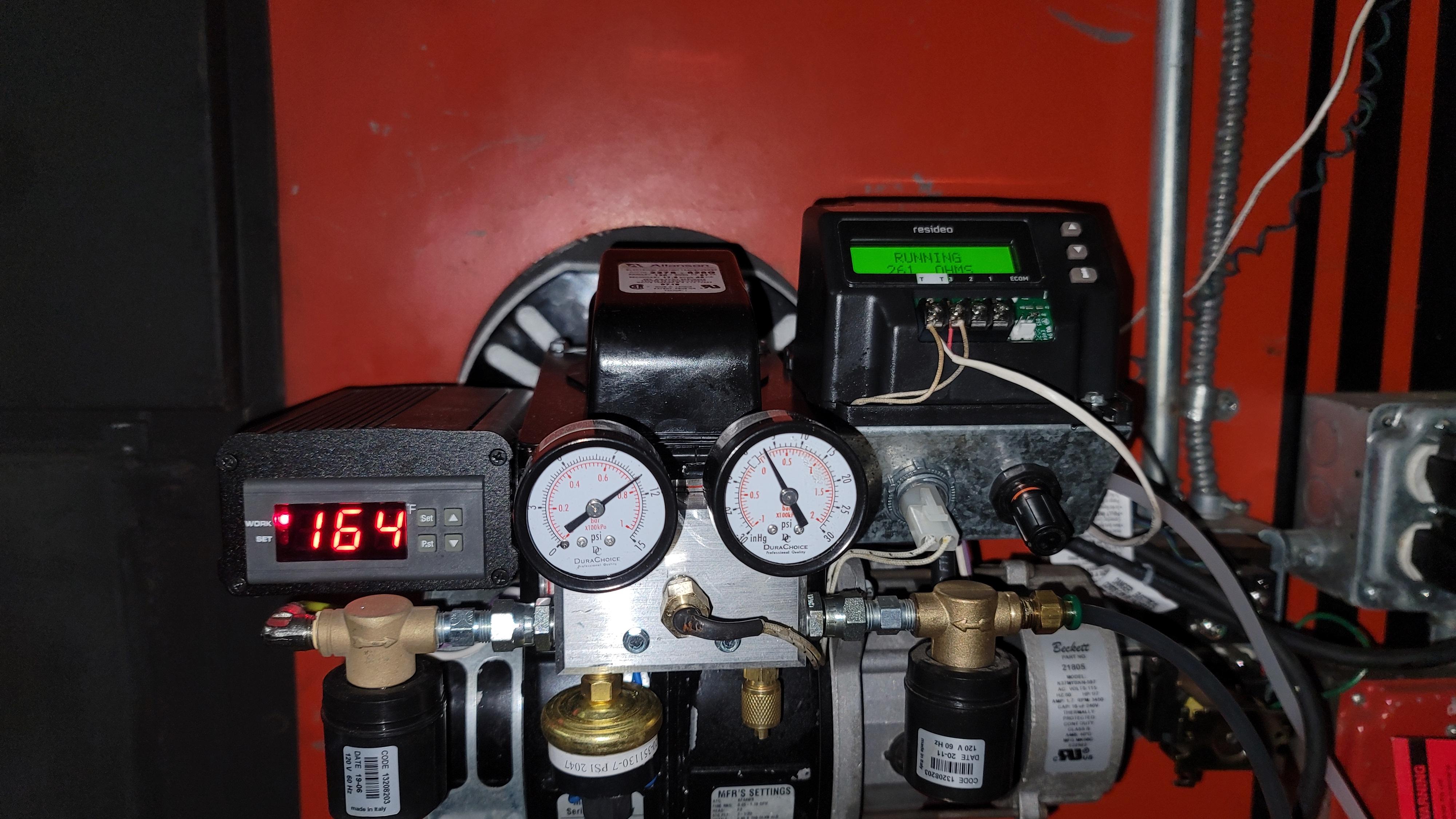

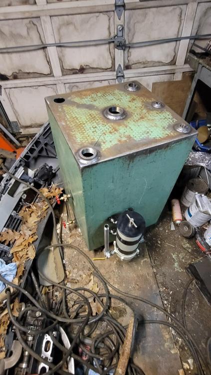

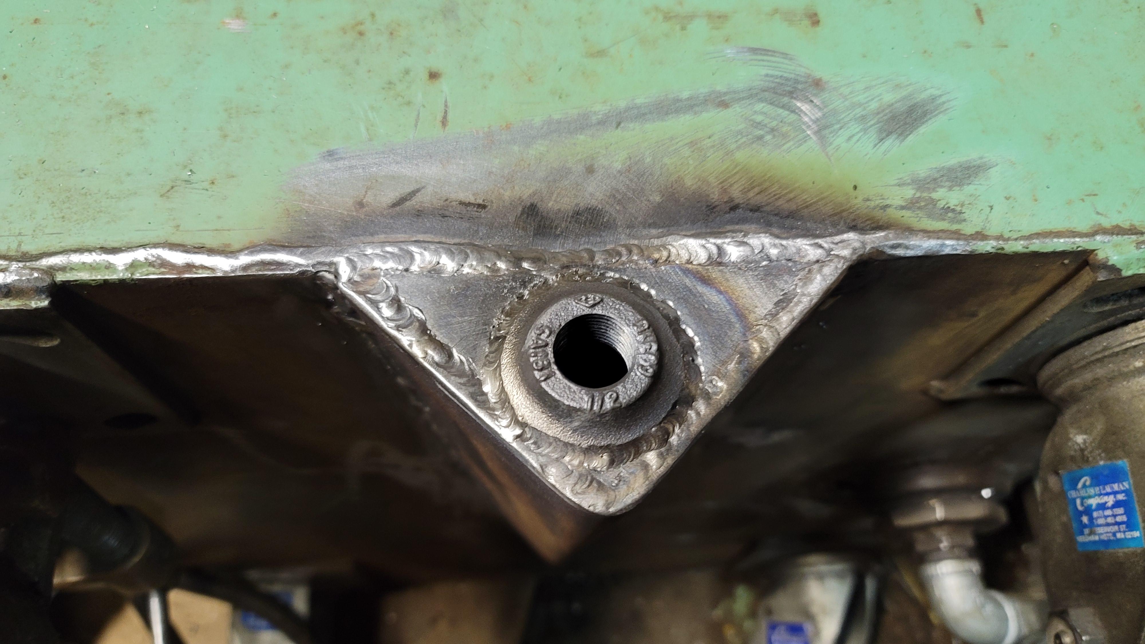

jlpservicesinc Posted January 13, 2022 Author Share Posted January 13, 2022 So lots have gone on since last post. Garage door is operational, insulation inside the east wall has started until we ran out of insulation hangers. The garage door inner seal was installed.. What a difference heat wise that made. I have an external seal also ordered should be here this week. The furnace: I installed a control relay for the used oil burner so it only comes on where there is a call to the used oil burner.. Otherwise it stays cold and this will increase the timeframe for it to have to be servided or cleaned. I also started to build a special oil storage and feeder tank for the used oil burner to simplify what I am doing now.. which is cleaning the oil of water but a series of storage tanks and sucking from about 4" off the bottom.. Oil being lighter than water will float.. Problem is the labor involved. the new tank will have all of the features built in. Drain, filters, pump, a funnel. water separator.. Tank only needs to be pressure tested for leaks and 1 more bracket welded on to hold the metering pump. The digital display is inside and outside temp.. Cold snap and it was easy to heat.. Need a fan on the ceiling for sure. Was like 90F up there. Quote Link to comment Share on other sites More sharing options...
