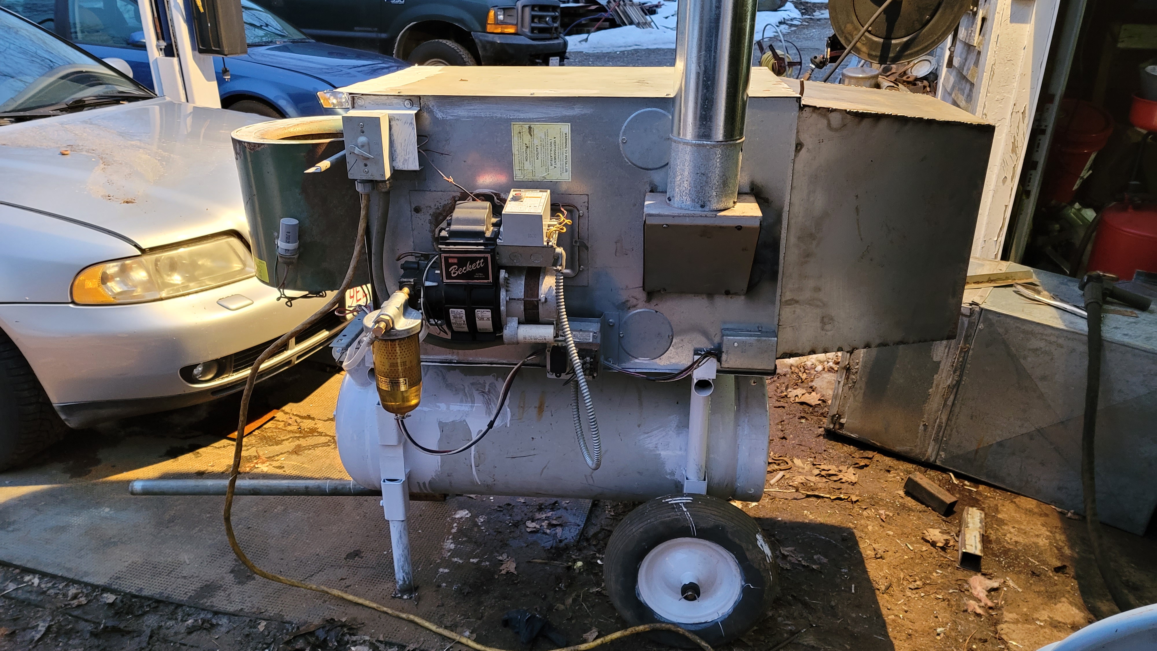

Just about done with the heater..  Started to make the afterburner..  :)
Brain should be in tomorrow.
I also ordered some insulated pipe so that will free up how close to an object it can be.

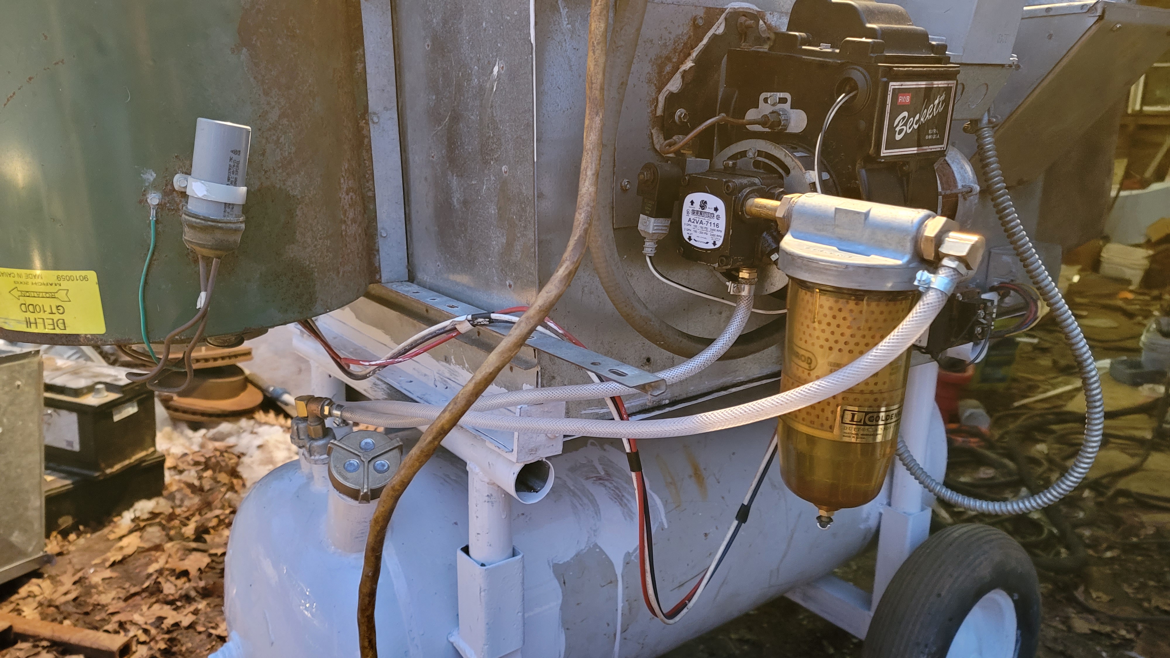

the fuel filter won't fill up.. It stays at the same height..  does this mean the supply line is to small?
I'm using 1/4" ID but can step up to 3/8" pretty easy.

"...the fuel filter won't fill up.. It stays at the same height..  does this mean the supply line is to small?
I'm using 1/4" ID but can step up to 3/8" pretty easy. "
No, it's fine -- its a volume in = volume out sort of thing, and the pump will only suck air out until the fuel gets up to the siphon tube inside the filter, then it will suck fuel.  A bigger supply hose won't change the geometry of the siphon tube out of the filter.
For the filter to be full it would have to be lower than the fuel supply or have some sort of lifter pump between supply and filter that would double as a check valve...
in essence I think the way you have it set up it will ask the pump to prime at each start and push the air through the nozzle.
Probably fine unless once the control "brain box" is in place, the time to evacuate the air and then fire is greater than the time the control allows for lack of ignition before tripping... in other words, if the control allows x seconds for flame sensor to provide input signal confirming ignition but the air pocket takes x+ seconds to be eliminated, you may have problems...
Generally oil tanks supply line and filter are at the bottom so gravity keeps themfull so when heat call happens, the pump does not have to push air out before fuel getting to it.
also, not a good idea to repeatedly run pumps dry since fuel oil also acts as a lubricant
Dave F.   comment got me thinking about pressure vs vacuum..  And it made complete sense with Dave's help..
Pressure can fill the filter full but vacuum has to create enough negative pressure before it will suck..
It's interesting to me because I would think that once there is enough vacuum that the fluid would remain at that height, if there is enough supply volume. (hence why I think the line is a little to small)..
The fuel is not syphoning out of the filter when not in use.. Even when full, it just goes down bit by bit eventually ending up at that exact level each time..
Its something new since I put the bypass in..  I think it's feeding more fuel thru then it is taking in within reason. and couple that with vacuum to draw the fuel up.
If the fuel was syphoning out, a check valve would be in the works immediately.
I had thought after reading about the burners and the pumps that by running it in bypass mode it nearly doubles the lift height and also self primes the pump..
More food for thought..
The syphon tube I was mentioning was the draw tube in the center of the filter bowl. If there are no leaks in the system, and the lower part of the filter cartridge isn't clogged,  the pump won't be able to pull any air out of the bowl once the fuel gets up to the level of the opening of the outlet tube in the bowl.
I think pressure still wouldn't drive all of the air out of the filter-- once the level got the outlet tube opening, there'd still be a bubble of air trapped in the top.  Increased pressure could compress it, but to eliminate the bubble you'd need to bleed the air out somewhere.
With the filter above the tank, if there are leaks, you'll pump a mix of air and fuel to the extent of the leak, but the level in the bowl will remain the same.
If the inlet hose is too small, vacuum will go up in the bowl and flow rate will go down, but the level will remain the same as the outlet opening.
Oh wait--as the filter clogs up, (or as you increase flow rates), the level could rise on the outside of the filter material to dynamically balance the flow through the filter material.

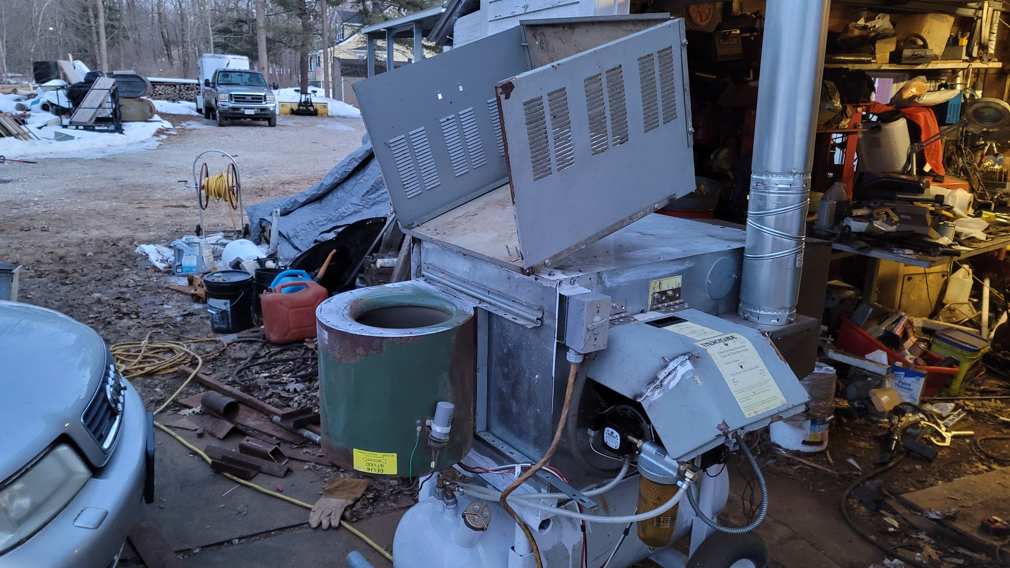

I ordered the ducting pipe today installed the double wall pipe for the chimney..  I installed an elbow at the bottom so I can pivot it down near the heater for moving it around.
I also dug out the panels to look at getting the sheet metal weather sheilds on.

Ok so today the filter filled up all within about 1/4" from the top..
I wasn't concerned with the filter flow,, I matched all the components for what I thought with research should work..
Was more of a "Why" moment..
so there is the updated stack,  got some of the sheet metal work installed.
I ran it for 4 hrs today while I worked on it..
Still have the new brain to install..
Tomorrow I'll see about finishing the burner shroud and then look at getting the after burner split into 2, 12" diameter connection points for the vent hose I ordered..

It is interesting how the filter was full when it was just normal, then over about 2 hours it went down to the level I questioned and then today after 3 hrs it creeped up just just below the upper cap..

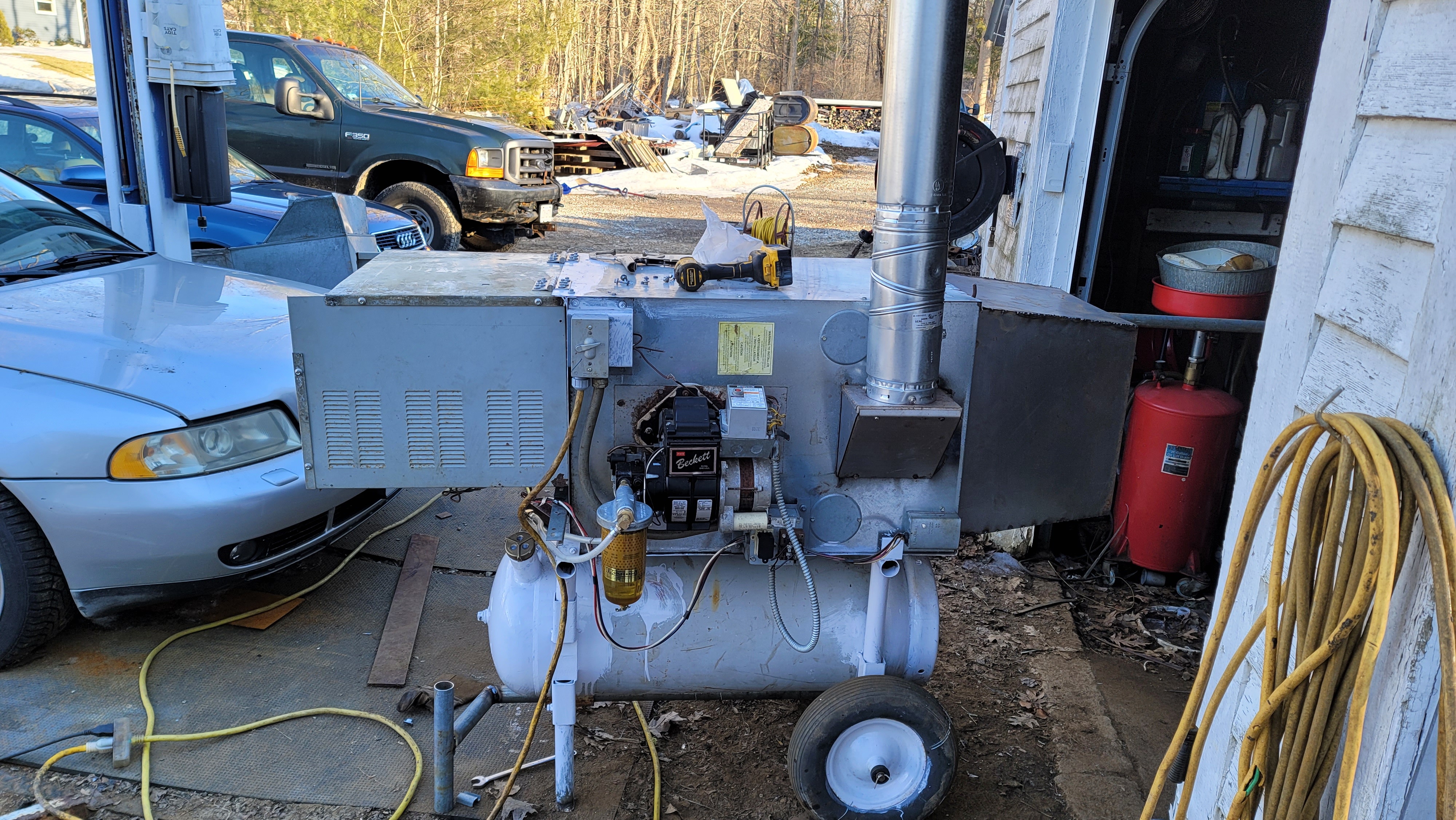

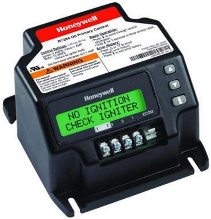

So, just an update on the heater..
I wanted to have it work like a regular furnace with built in safety features..  That way the risk of putting 21 gallons of fuel oil everywhere is minimized.. If it doesn't fire when on command it just shuts off..
Since the brain quit working last week i was just running it barebones and directly wired..  (have the new brain box and ordered a new fan switch and wireless thermostat)
I ordered the new brain which is a smart one (Honeywell R7284U-1004)   diagnostics built in and after doing a lot of video watching and lots of reading it turns out the wiring in the manual for the furnace is "Wrong".. With capital W..
It does not use a Fan control board like shown in the manual..  Sadly the schematics on the cover are barely legible because that is where the real wiring is..
So, I ended up doing a search for Olsen furnaces and this lead to glimpses of how they were setup wiring wise by watching the videos and stopping them when the control was in view..
The new Brain box is designed for Honeywells smart system and Envirocon.. So can be a bit finicky.
I also learned that there were extra wires going to the fan limit switch that energize a built in heater unit that is not needed.. So I removed all those wires and cleaned up the wiring loom..
After this I bent the dial of the fan switch so it was at 50F vs 100F when it was in the cold position and move the switches so they came on when it went over the 50f..  So, now the old switch for the fan comes on like it's supposed to and both the auto function and manual function work..  I did order a new switch and it should be here by the weekend.
Not sure when the thermostat will ship, but for the time being I can just leave it on..

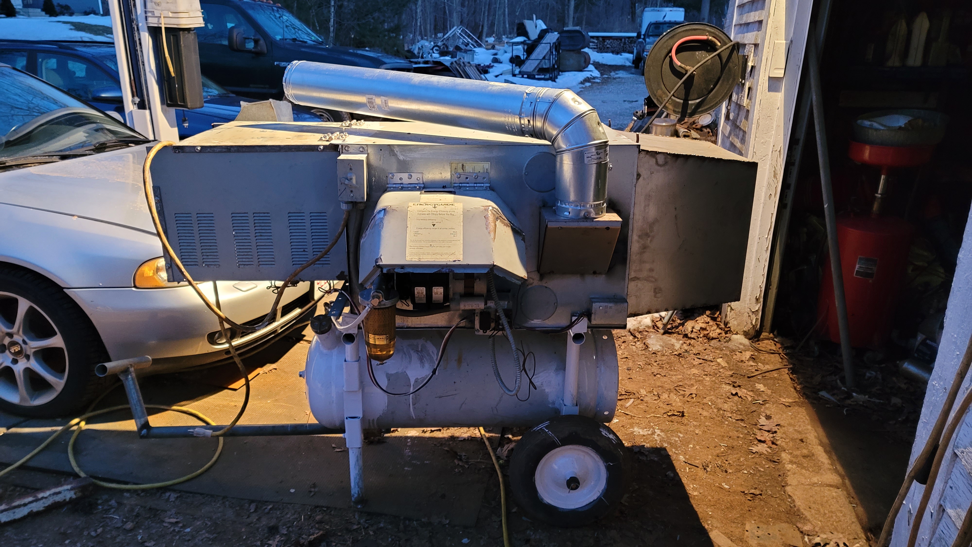

Today was the first time putting it pointed in the new school and within 1.5hrs it was warmer dramatically compared to outside and was easily 30F warmer inside from when it started.
It's been easliy 10 or 15F colder inside then outside on most days..  The insulation works both ways..
So, tomorrow will be the first day I put the portable heat on for the new shop other than a test.. :)
I ordered a resettable 120V hour meter too, so I will be able to know exactly how long a full tank of fuel lasts and keep track of maintenance and such.
Sadly the fan cover I made is to close to the blower and it restricts the intake of the blower to much..  I figured it would be close flow wise but to much resistance.. I'll need to add a top section that sticks up.
