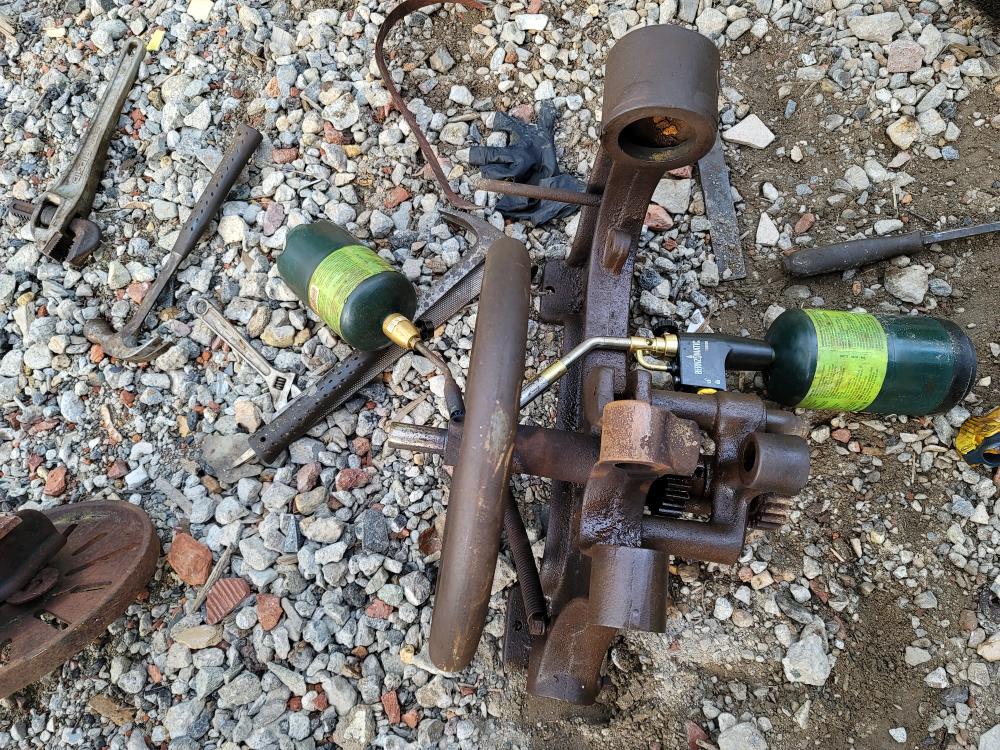

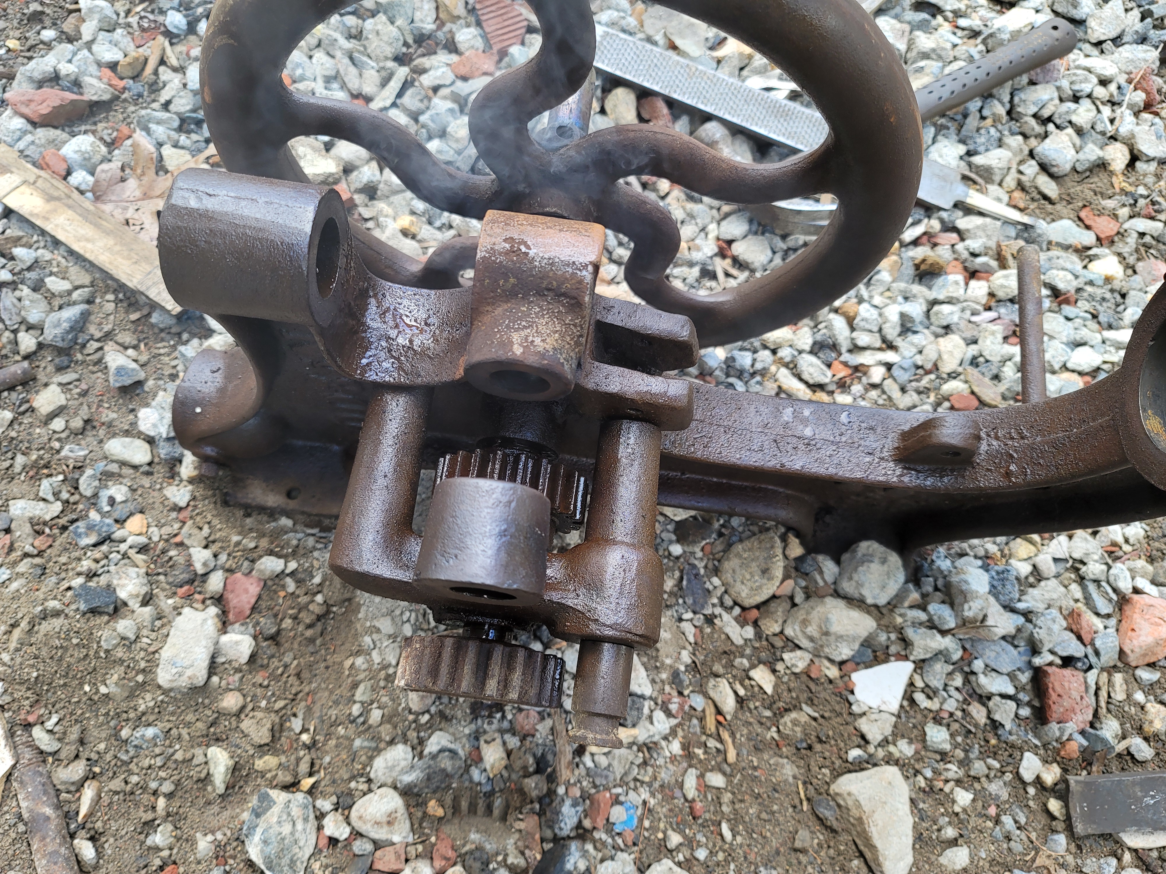

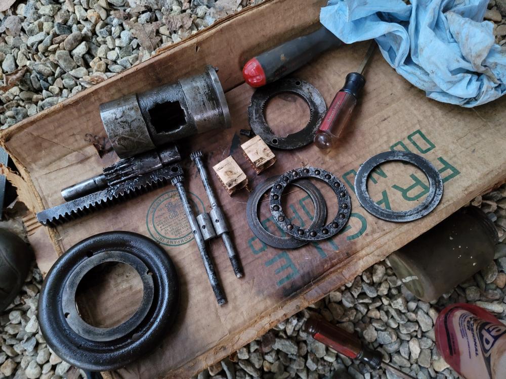

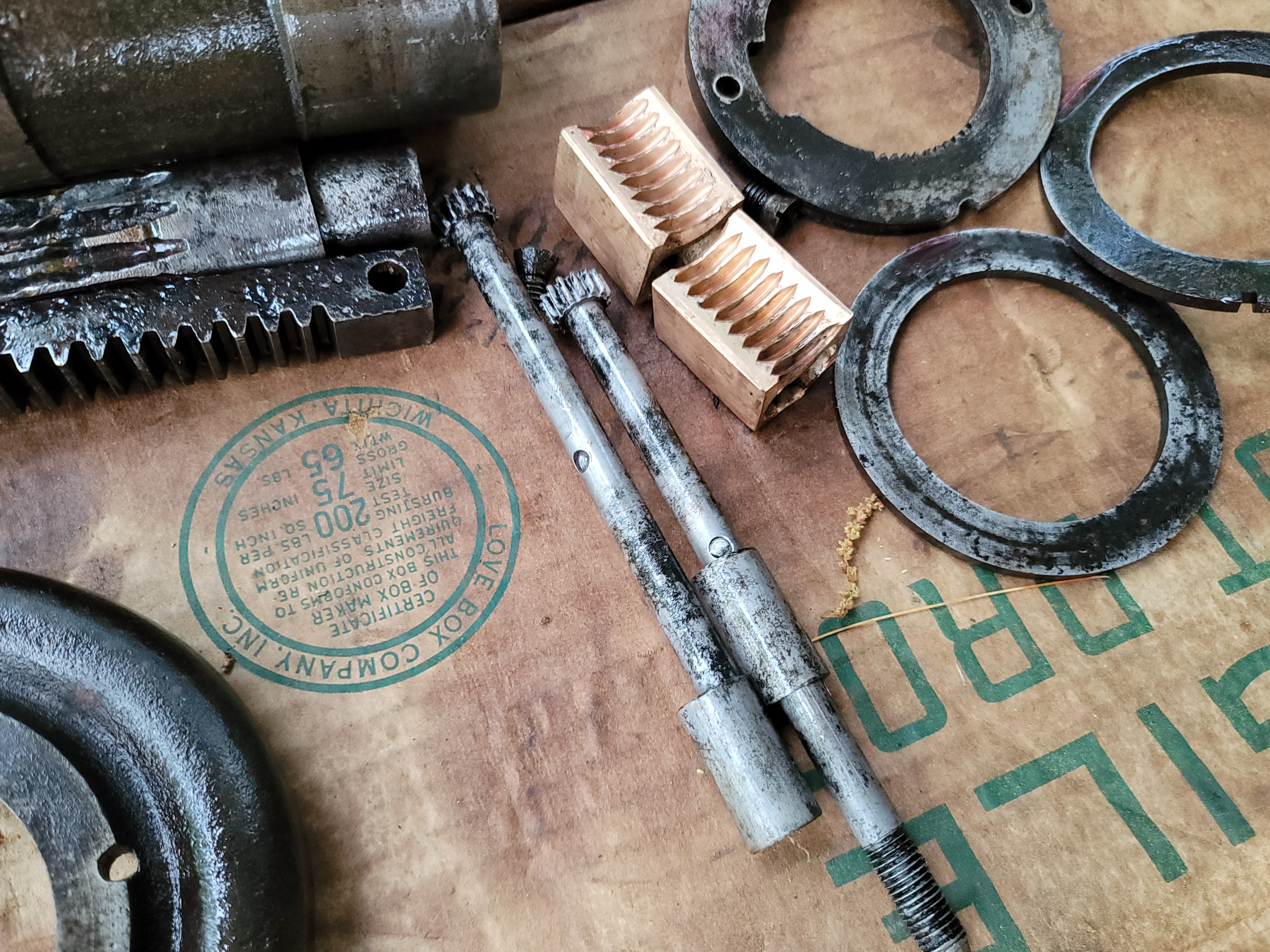

jlpservicesinc Posted May 23, 2021 Author Share Posted May 23, 2021 On the 200 model they use thrust ball bearings throughout with a few hardened metal washers as space take ups.. The auto feed clutch is kinda funny because it's designed to slide straight in or out via the cammed action with the little gear sets on the bottom of the gizmo.. (not a great mechanical advantage). It's interesting because the action of holding both the top ring (ratchet ring) and the bottom set ring is the action needed to engage and disengagement of the bronze jaws via the little gears on the ends of the bolts (planet/sun gear partial combo).. My point is, it takes nearly nothing to completely jamb up the works.. Since there is no good way to add torque via either hand wheel unless a lever or such is used to hold the top ratchet wheel.. Those tiny little gears are supposed to move the cams around that 1/2turn from in to out.. The 201 I picked up few weeks back is not working either so frankly glad to have picked up this 200 to see exactly how it works and what are the correct take down steps.. The 201 is stuck in the open jaw position so will have to figure out have to move them to the inner postion to take it apart.. One thing about all these oldies.. And these jaw thread chucks is one can actually make and use any type thread they would like.. The jaw dies could be made from a brass or bronze acme nut and then soldered together.. With a metal lathe the screw for it can be easily made or modified as well.. This model 200 does not have a ball bearing between the threaded rod and top of the drill chuck shaft.. It only has bearings that sit under the brass collar to push against.. This could be easily fixed as well.. Quote Link to comment Share on other sites More sharing options...

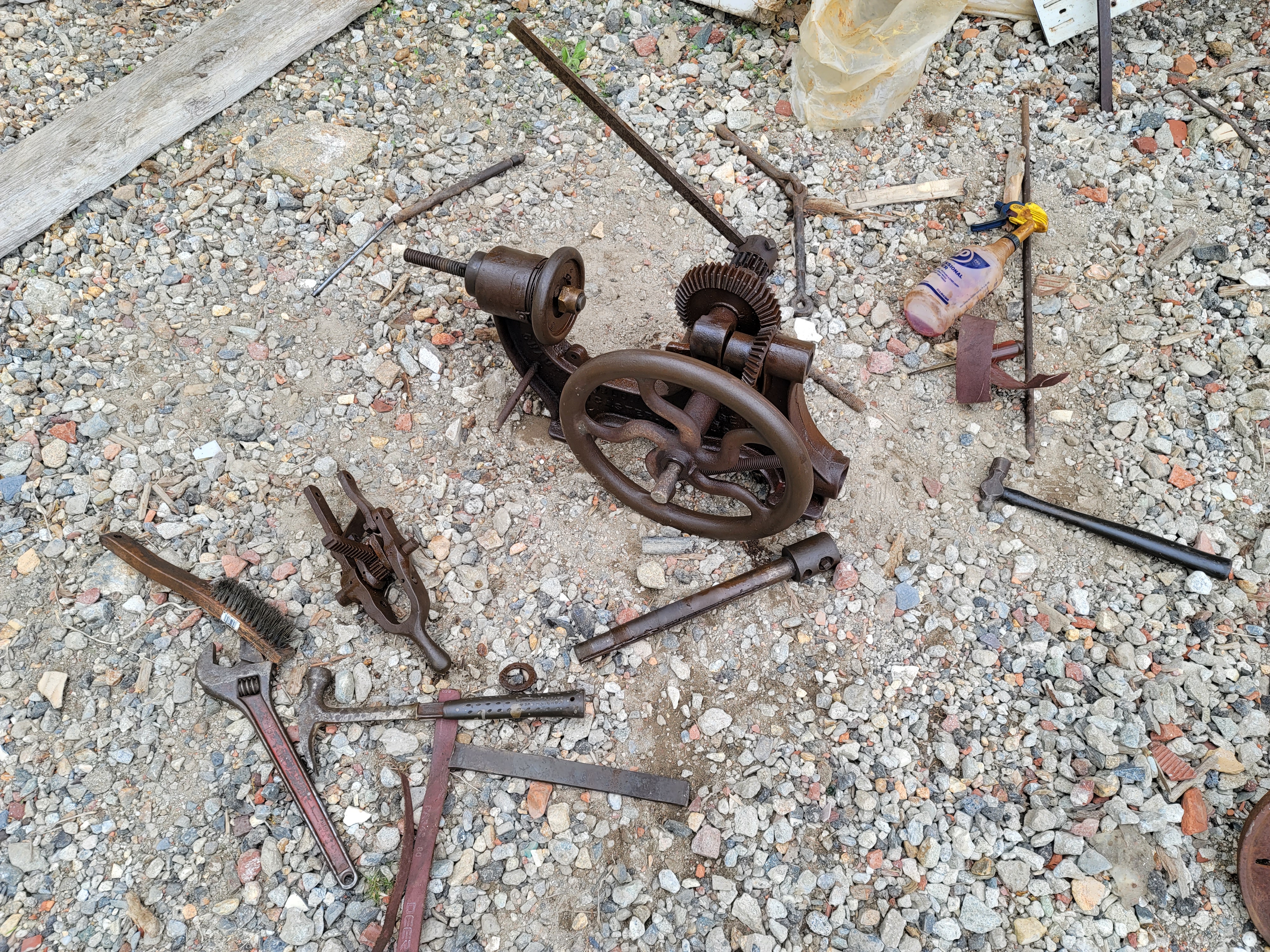

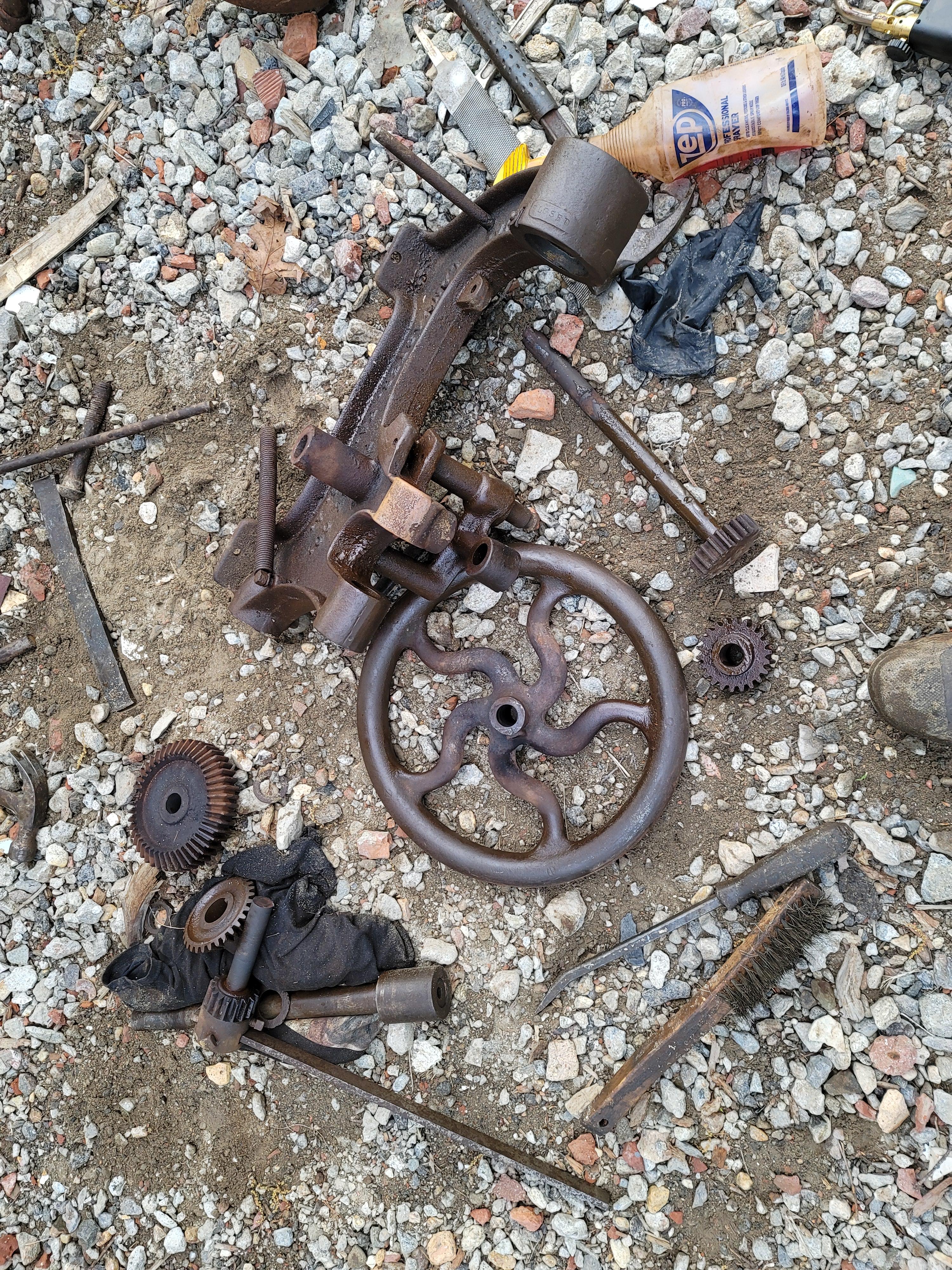

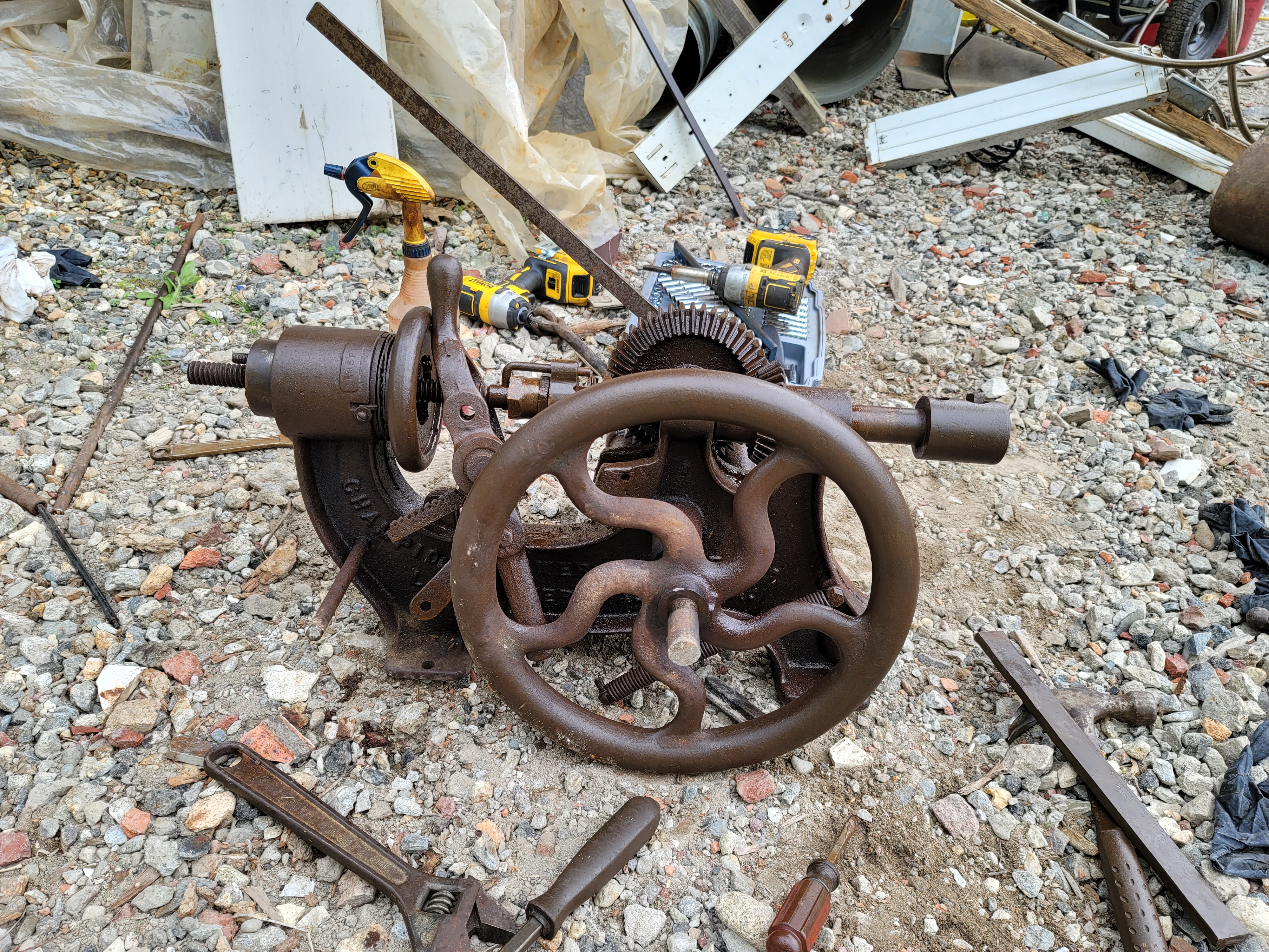

jlpservicesinc Posted May 24, 2021 Author Share Posted May 24, 2021 Got it apart today.. I have included the last photo which shows the reason why the bronze jaws need to be fully in.. Quote Link to comment Share on other sites More sharing options...

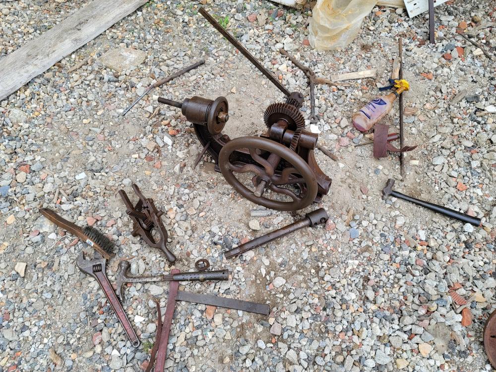

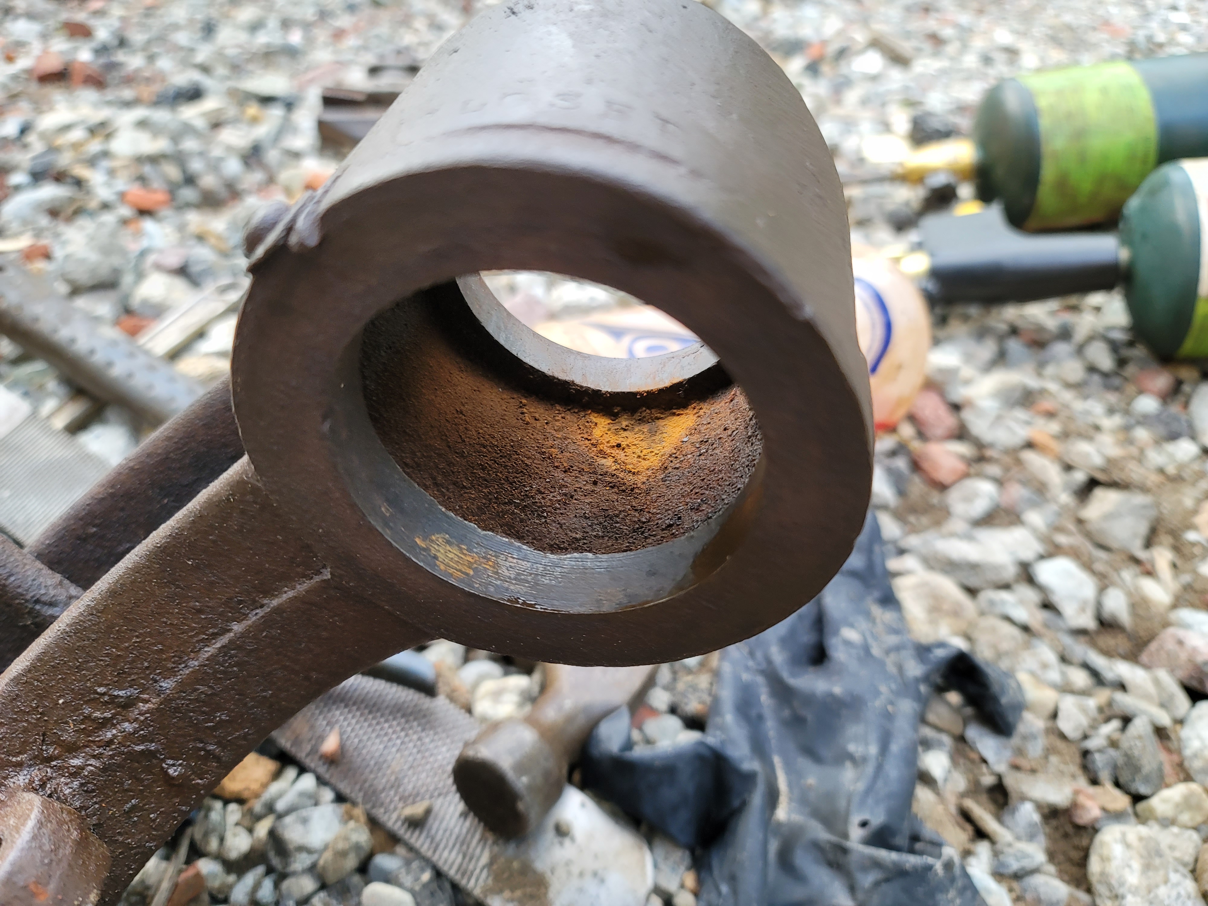

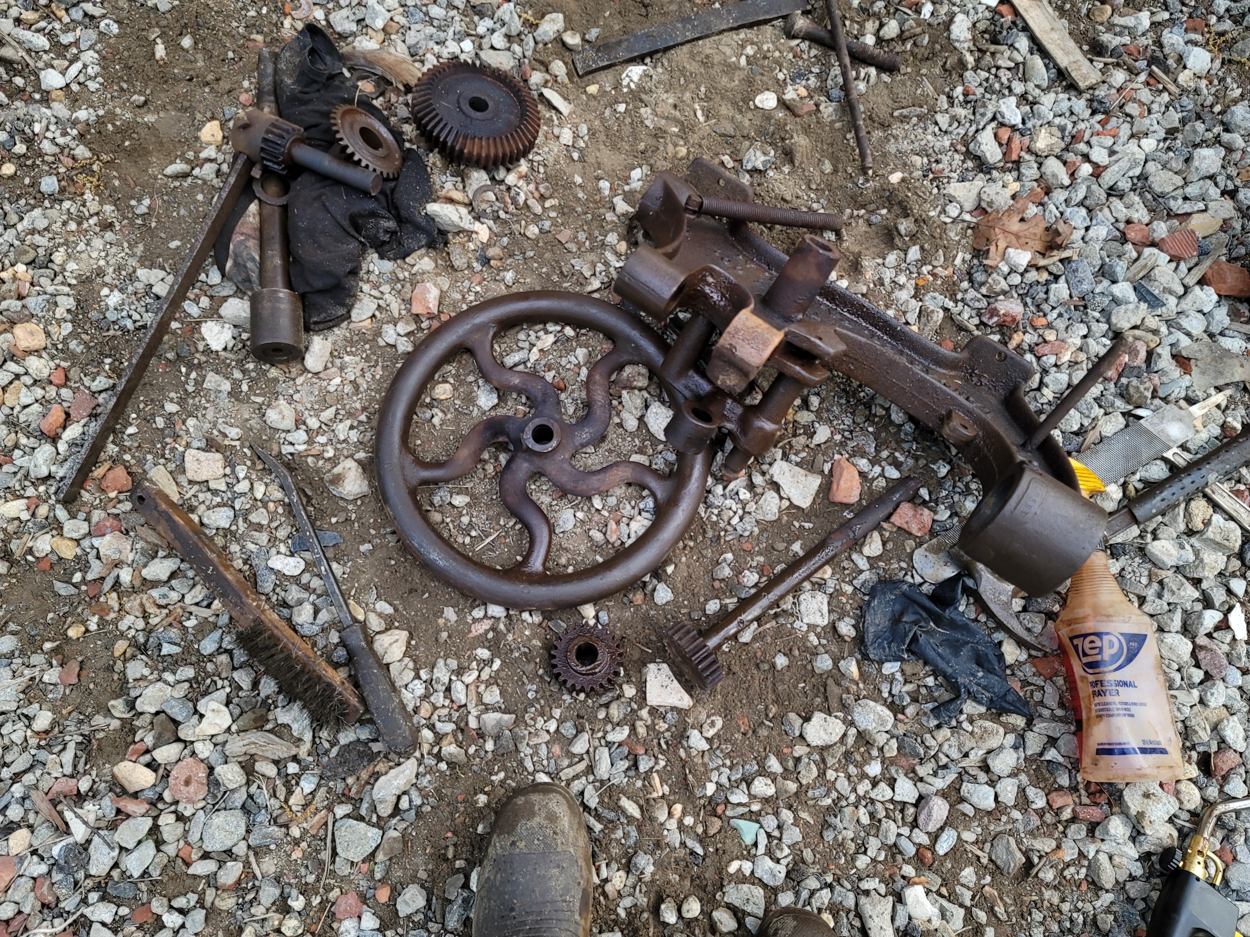

Frosty Posted May 29, 2021 Share Posted May 29, 2021 9 minutes ago, jlpservicesinc said: That will get them muscles working.. Uh HUH. More likely make them stop for a few days. I was lucky mine was heavily goobered with heavy sticky old OLD oil. I think a lot of the rust damage is just condensation over the decades. Otherwise there would be signs of immersion or where it was in contact with something, etc. An even coat of rust tells me it was uniformly in water and air contact. Says condensation to me. Frosty The Lucky. Quote Link to comment Share on other sites More sharing options...
jlpservicesinc Posted May 29, 2021 Author Share Posted May 29, 2021 Yup but for that to happen it would have to be against something and that would leave a tell tail sign.. Any object placed against wood or dirt would show up.. this thing is rusted so evenly the only thing that makes sense is it being turned or rearranged a time or 2 over the last hundred years.. the table spindle is from another drill as is the table spindle clamp.. Every joint has the same level of rusting.. While I would agree in condensate, condensate has a tendency to puddle or run off to the lowest spot.. This is very puzzling from a forensics standpoint.. The 2 older units freed up easily and don't have nearly the rust depth at the joints.. Primarily just lack of lube.. The 200 on the other hand looks like it was left in a sand blaster where every there was a hole or in-between body to shaft joints.. I'll take some better photos later. Quote Link to comment Share on other sites More sharing options...
jlpservicesinc Posted May 29, 2021 Author Share Posted May 29, 2021 It just dawned on me that the wear I am seeing could be partially in response to glass beading some point in the past and then left outside.. there was no oil or grease nor accumulated oil/dust mixture anywhere.. This would account for such high rust in between joints because they were all ready worn from blasting. Quote Link to comment Share on other sites More sharing options...
Frosty Posted May 29, 2021 Share Posted May 29, 2021 Condensation isn't always heavy enough to run and as rust develops running becomes less likely. A gravel surface doesn't produce contact surfaces like a piece of wood, dirt, concrete floor, et. A few pin points of contact where water can infiltrate easily leaves a uniform surface patina. A flat object will restrict air flow under it so the underside will develop less condensation, etc. etc. A corner that's easy to paint yourself into is thinking one effect goes for everything. Some of the rust formations you're describing only occur under certain conditions. A post drill doesn't have large flat surfaces to show the marks UNLESS its bolted to something on them. Or one is partially submerged, buried, etc. Sure I'd expect to see rust lines but wouldn't be too surprised not to. I have a small one that was on the floor of a good friend's Father's old shop for something like 50 years before Gary dug it out and brought it back for me. That one has a couple dirt lines where the paint weathered differently under the dirt. I never really thought of this kind of thing s forensics before. Thanks, I find that suitably pretentious sounding to use around new guys. Have you tried a 50/50 ATF and Acetone soak? Soaking beats spraying or brushing any day. Frosty The Lucky. Quote Link to comment Share on other sites More sharing options...
jlpservicesinc Posted May 29, 2021 Author Share Posted May 29, 2021 Frosty I guess you missed the post with photos showing it all apart. I've worked on maybe 100+ pieces of old iron blacksmithing goodies and machines over the last 40 years.. In all that time frame I've worked on items pulled out of rivers, buried in the ground, in old cellar holes, in old factories, etc, etc.. In all these years I have never seen an old blacksmithing item no matter where it was pulled from that has had the extent of rust and seized everything. You might not agree but that's ok.. All my points are valid.. I've worked with many an item with condensation damage and it's nothing like this.. I can't think of a place except maybe someplace where the dew point is low and cloud moisture is constant that this type of corrosion would be as significant as this was.. Not 1 drop of oil, grease or lubricant anywhere.. I keep writing the same thing but apparently not on the same timeline/frame.. forensic science noun Medical Definition of forensic science : the application of scientific principles and techniques to matters of criminal justice especially as relating to the collection, examination, and analysis of physical evidence : FORENSICS I'll condense the photos here for your purview.. Not one piece of it would turn. Quote Link to comment Share on other sites More sharing options...
Frosty Posted May 29, 2021 Share Posted May 29, 2021 Ah, I remember the pics and how many things you've rebuilt, I got carried away. I thought you said it was uniformly covered in rust without contact lines. I've seen that happen and was describing one of the conditions under which it can occur. Frosty The Lucky. Quote Link to comment Share on other sites More sharing options...
