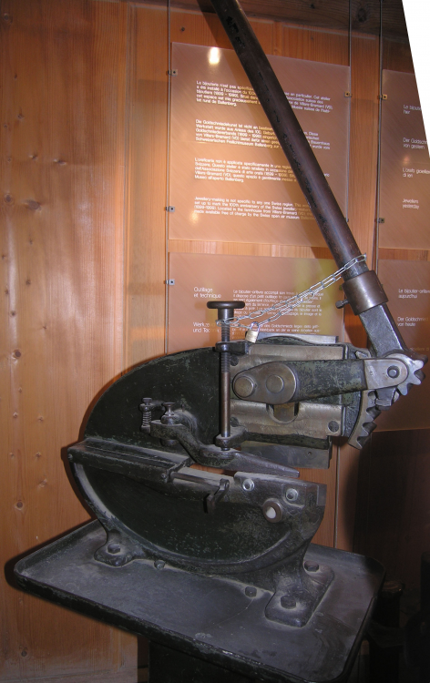

Curious how no one mentions Hand Shears ... must have gone out of fashion :)

I'll pass on hand shears, I still use my hands I'll keep them attached thank you.  I'd use hand shears if I were working light enough sheet but I rarely do and I just break out the saber saw for sheet a Beverly shear would be appropriate for. And guys with plasma cutters . . .
Hand shears.  This is just a baby one but you get the idea. You fingers are safe if you keep them away from the business end.  When I was 15, this is all we had, conceded much larger version with a rotating blade that would cut 10mm flat bar or angle, T section or round rather easily. Each had an appropriate hole in the blade.
 It was that or the hacksaw or the oxy cutter.
I love the SILENCE of using a Beverly shear and have used real hand shears with "bulldog" bits"for cutting alloy steel"---usually bandsaw blades for some reason. I generally put one handle in the vise and work the other handle.  Set up a length stop on the bench and can fill a coffee can fast with billet pieces. (Always cut from the softer back towards the hardened teeth and let the last bit break off---keeps your shears sharp longer!)
