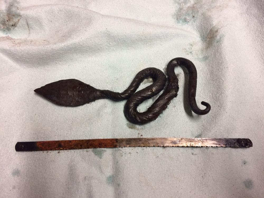

  1. for oils use wd40, just dug these items from snow (xxxxxxxx cold) when I saw this post.. (saw blade has been on rain for 6 months, other piece 2 months more, snow came week ago..) These were my test items for rust protection , saw blade other side is uncoated. Please see the difference. For my 'easy to rust' blades the wooden inner part of sheath seems to protect somehow the blade from rusting(!) , just remember to wipe the blade ALWAYS before sheathing.. And use the knife frequently For rust removing put the blade on vinegar for couple of hours, and rust is gone. [edit] Sorry for bad quality picture, the other test part has only couple of spots of rust, its also blacked on oil.
