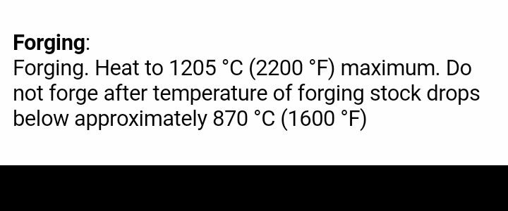

  13. The heat treaters guide app in the heat treating section gives you information on forging temperatures for various alloys, some have much smaller windows of opportunity than 5160. In fact, 5160 is quite forgiving in its forging temperatures, compared to some. What the previously mentioned app says about 5160:
